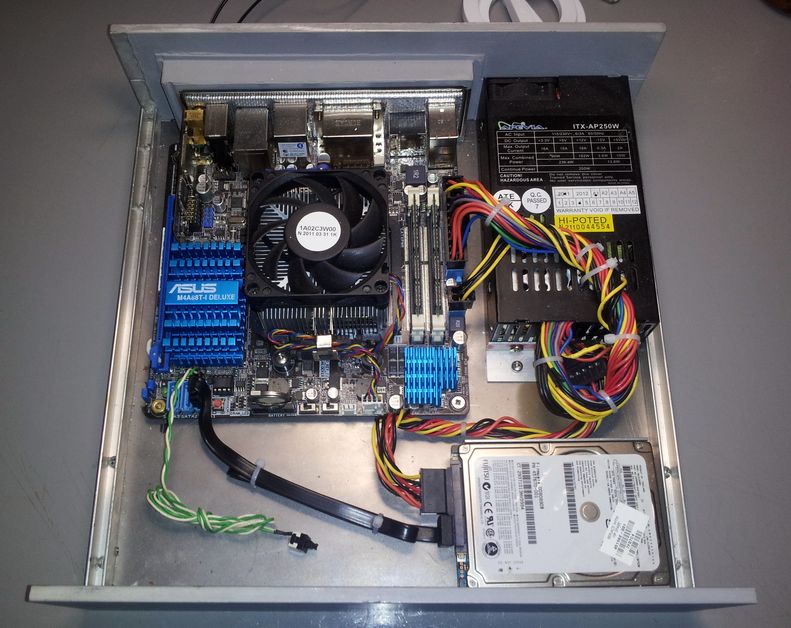

O.K. This Asus M4A88T-1 Dlx is a home brew that was intended for JRiver but will now hold Linux. Is there a recommended Linux build for audio?
I'm Jealous.. 😉 nice package. Too bad you need a cpu fan (I've had something in the works using a fanless Atom board..)

Thanks MrSlim. I do have a dual fan 40 MM liquid system in the works but the power supply is the bigger noise problem - worling on it.

If you are just planning on using this for music, you can think much lower power, with the only spinning part being the media storage disk drive. The Intel Atom board I am using has a 12V AC adapter input, using a laptop power brick (could also use a nice linear supply.. hmmmm) no fans at all

FYI, I would lose that hard drive if you want to make a quiet PC.
Hard drives make a lot of noise, when you quiet down the fans and PS.
Laptop drives are quieter, SSD is obviously the best for noise (fast too)

Thanks Randy,
I'm looking forward to my first SSD but still hoping the prices will drop a bit. The pic may not show it but that is a 2.5" drive. Media is on a USB external. Remote placement and smartphone control is another option if noise turns out to be a problem.
