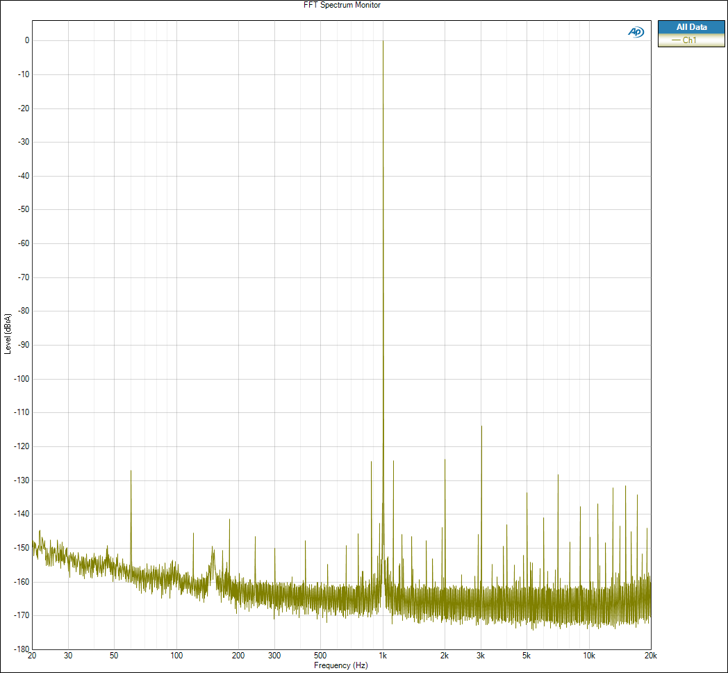

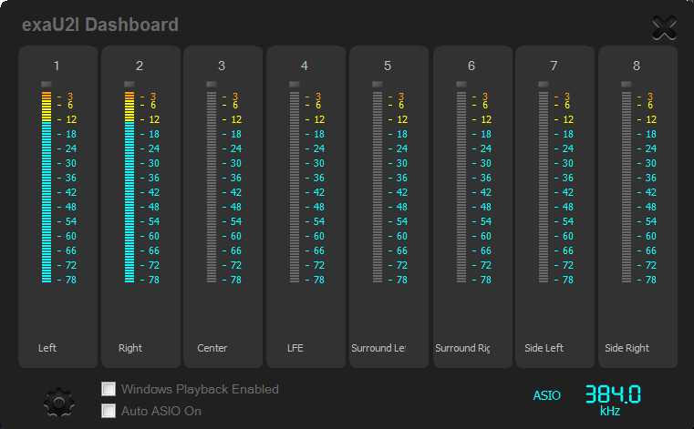

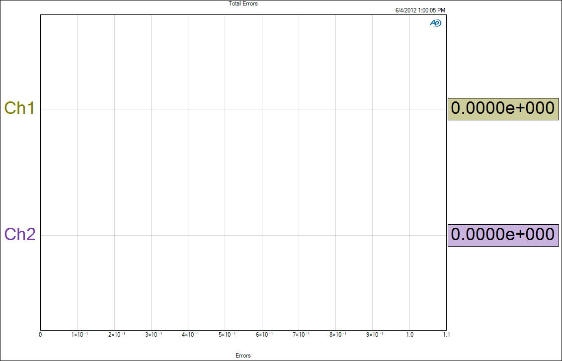

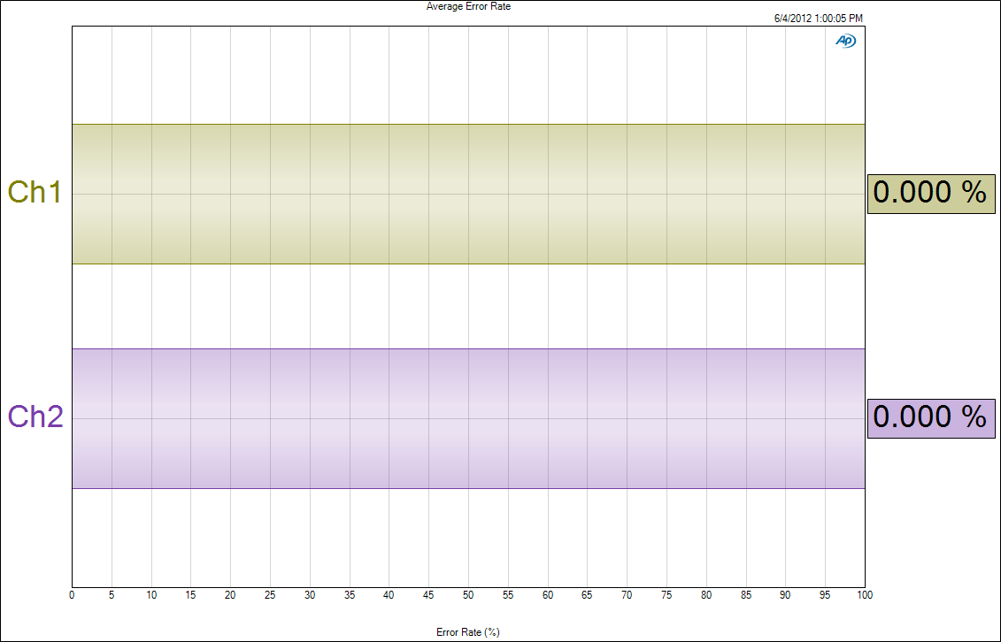

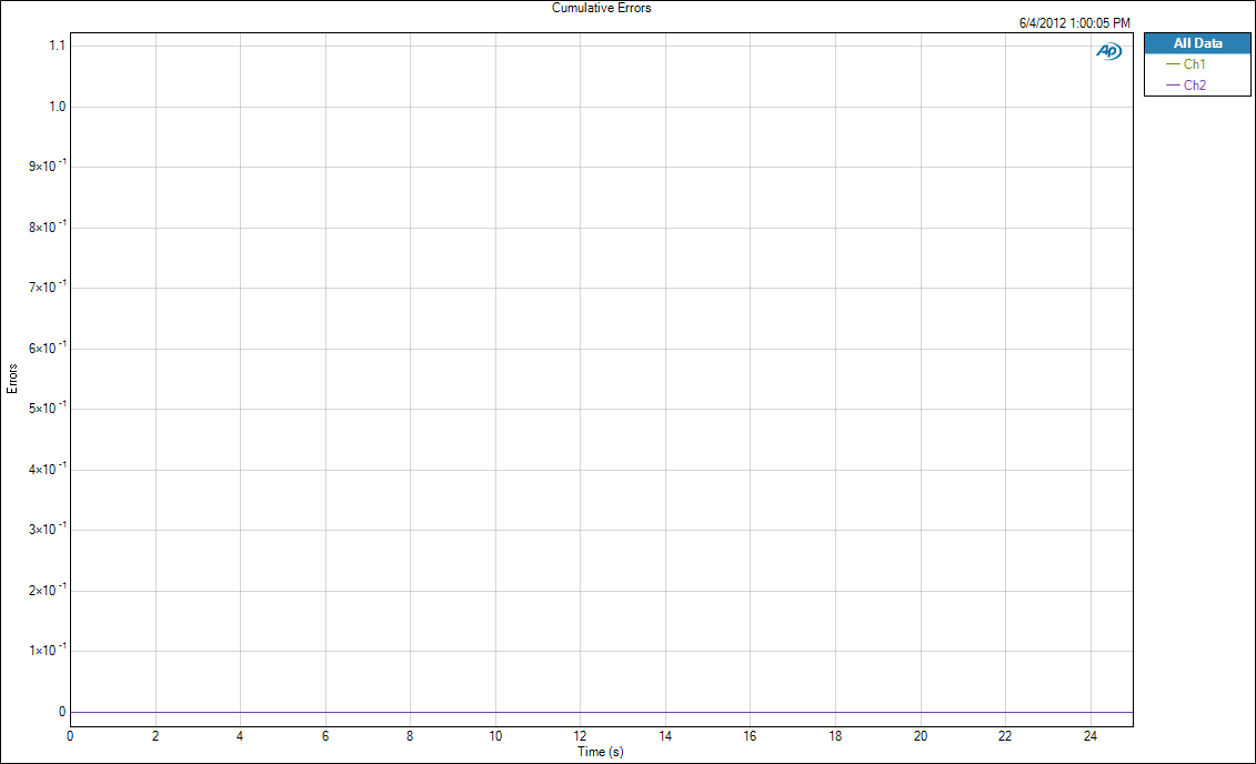

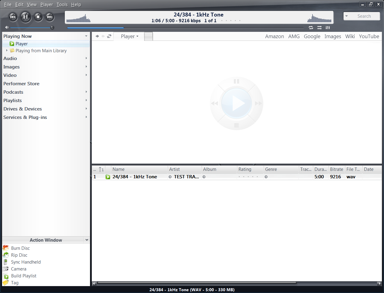

Hi Guys,
I think a few people missed the main point of what I wrote before:
I've attached a few screenshots to show that I'm not blowing smoke. The exaU2I worked perfectly fine with 32 bit files (no errors from J River) and also played 384kHz files with no noise, and no irregularities when paused. You can call it luck or whatever you like, but you cannot say the BII 80MHz doesn't support 384kHz. It does.
Parts of this could be that the exaU2I supports ASIO, and maybe it's just J River that has problems playing 32 bit files via WASAPI, but either way, it's an issue. If it says there's 32 bit support, I should not have to jump through hoops to get it to work.
It's also definitely not a Windows 7 issue. As I said before, the exaU2I played just fine on the exact same PC.

Hopefully Amanero can comment on the lack of 32 bit support using the WASAPI output more in J River.
It seems to be a J River problem. I also cannot get it to play 32 bits with the WASAPI driver. Foobar, otoh, has no problems with Amanero @ 352/32
Report this as a bug and it is very likely that they will fix it relatively quickly. They seem pretty responsive to customer input which is one of the many reasons I like and use J River.
Question is, is the bug in windows driver or j river.
That's a good question... it could be a limitation of WASAPI or the way Windows reports sound card support.
One of the many reasons I prefer ASIO. It works in all versions of windows, and seems to be the most stable implementation I've used so far in terms of getting true bit perfect reproduction.
I'm secretly hoping Amanero will consider adding ASIO support under Win 7 32/64.
I'll give it a try using Foobar just to confirm, and then I'll submit a bug to j River and see what happens.
