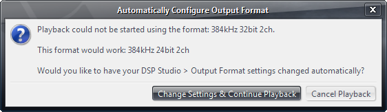

Hi Guys,

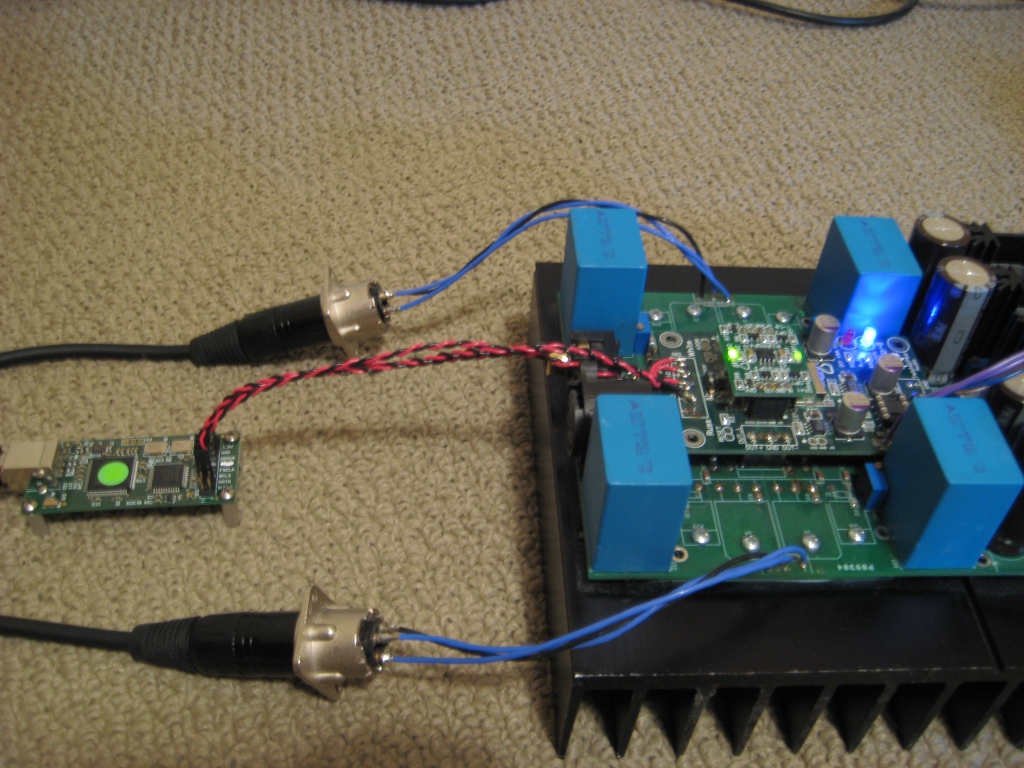

I finally got around to testing the Amanero board this morning with my Buffalo II and NTD1.
Playback is quite good for the most part, but there are a few pretty serious issues I'm hoping can be addressed:
1. There does not appear to be any support for 32-bit playback.
2. 384kHz sample rate files do play, but there is some serious instability. Background noise is elevated, and between tracks (no playback but still digital lock) there is a loud whizzing sound.

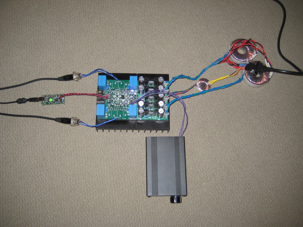

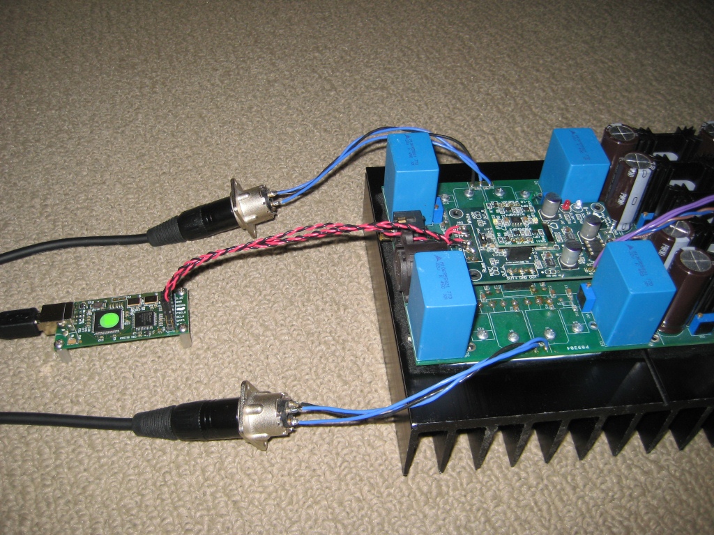

Here is the test setup:
Windows 7 64-bit Running on Asus MOBO with i5 2500k and OCZ Vertex SSD
J-River MC-18
WASAPI Event Style output to Amanero
3 ft USB with ferrite
1 ft USB without ferrite
6" Twisted Pair wires for I2S
BII with 80MHz clock and Volumite
NTD1 I/V
The Wire BAL-BAL
Denon AH-D2000 Balanced
All 24-bit and 16-bit files from 44.1kHz up to 192kHz play perfectly with no detectable background noise or hiccups.
I also tried the pin 8 to pin 7 connection suggested by chi0001 above, and there was absolutely no difference for me.
For reference, when I used an exaU2I in the exact same setup as above, playback of both 32 bit FP and 384kHz files worked perfectly, so I know the rest of the playback chain is not at fault. I have also used XMOS, Musiland, and C-Media solutions in the same set up with absolutely no issues.
Can anyone else here confirm that they are able to play 32 bit files and 384kHz sample rate files?
I have attached a few pictures of the set up below.
Owen
