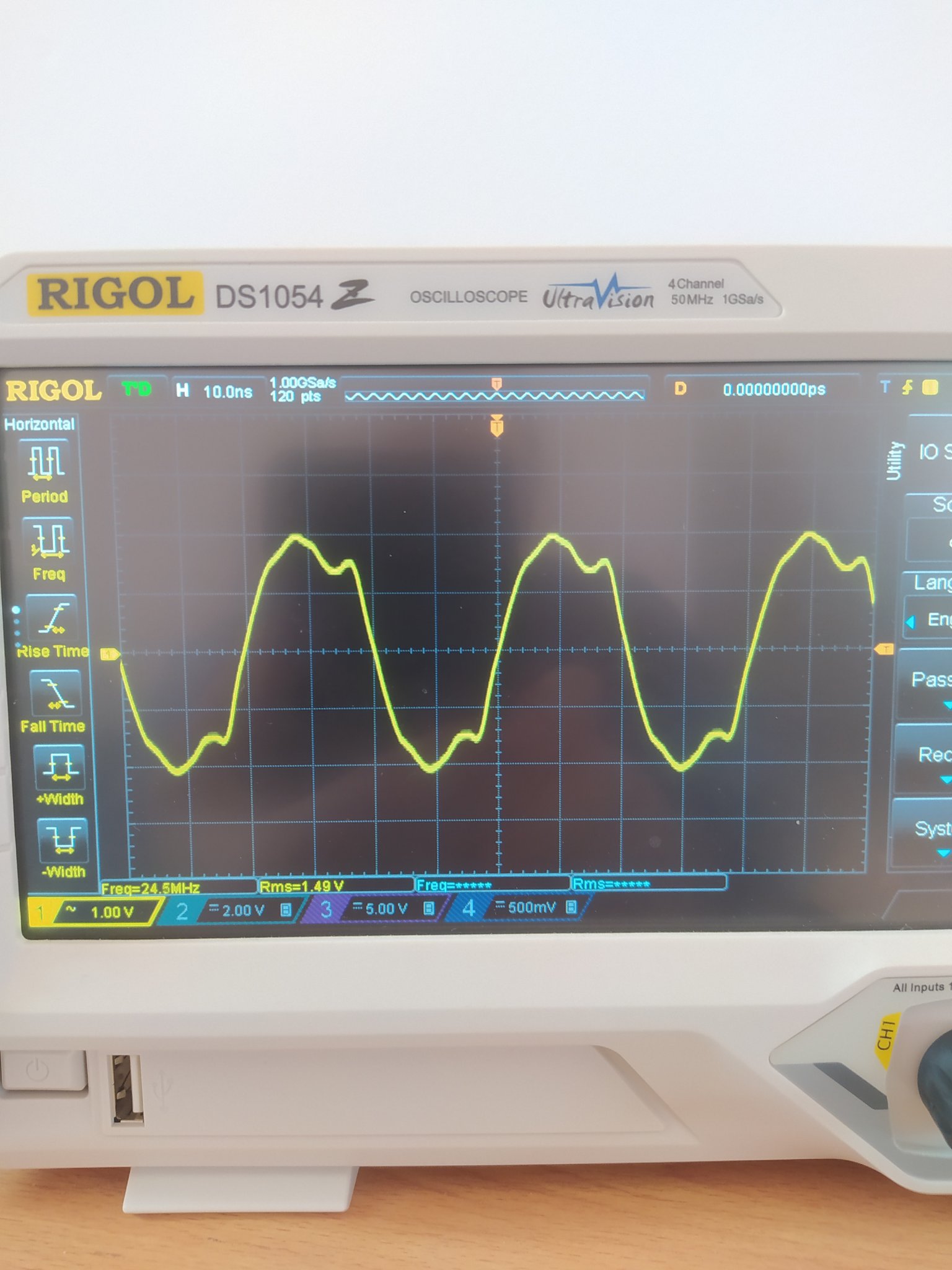

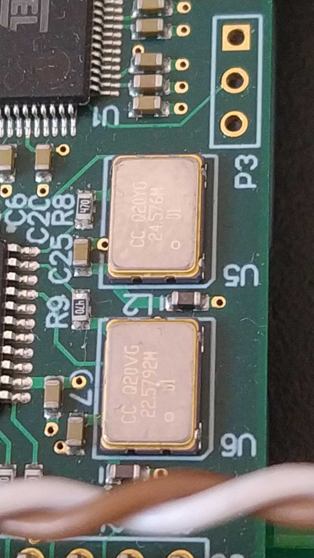

I have several original Amanero boards purchased from Audiophonics. They work fine.
All of them when I measure the output signal of the two crystals (22,579 and 24,576) in the oscilloscope, a slightly "bad" signal appears to me. The clock signal, depending on whether one or the other clock is used, looks just as bad.
Is this because of poor quality crystals?
Has anyone tried to change to other better crystals?
I no longer have sight or pulse to be able to remove the original crystals and make a new pcb with better crystals like AS338 or Cristek CCHD575
Any pcb simliar to amanero with native dsd with better quality?
