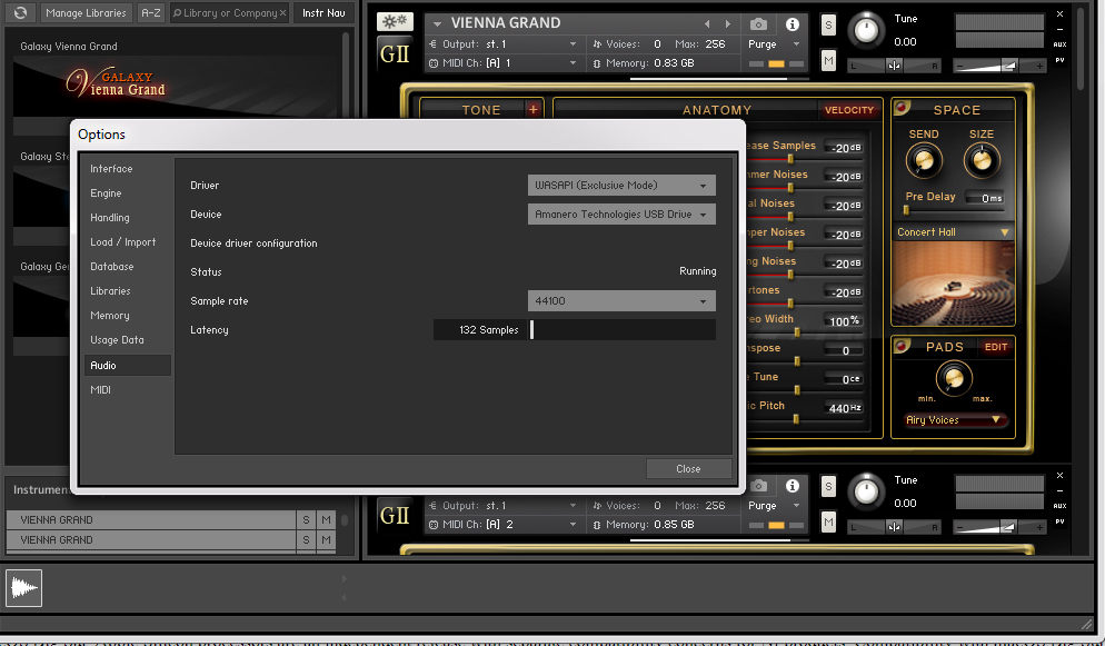

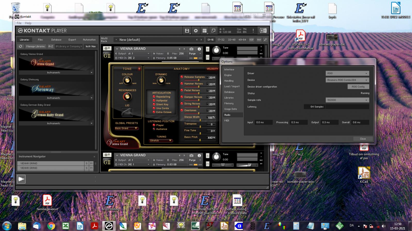

Hi all,
I have a question that I hope one of you may be able to help with ....
As it is I have been using a Combo384 for some years now and have been very satisfied with it.

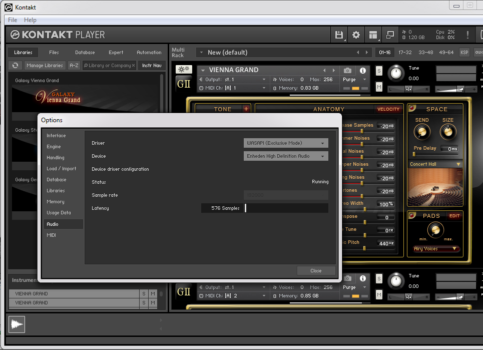

However, recently I have tried to use it in connection with Kontakt Player and something called Galaxy Pianos (a computer based Steinway/Bösendorfer/Vienna piano software), and here have experienced a very noticeable delay in the sound when trying to use the Combo384 "between" the computer & my external DAC (modified DDDAC).
On the other hand when I use my laptop's built-in hardware/software combination ("Enheden High Definition Audio) played back through the headphone output there's no delay.
FYI I have attached a couple of screendumps showing the setup of Kontakt Player in relation to Galaxy Pianos & Combo384 (Please note that the latency samples with each "soundcard" cannot be set lower).
I am using the 1.067 Combo384 driver and to my memory the OEM config tool 115 - but not entirely sure about that.
Might I be lucky that one of you know what could be the issue here?
Cheers & thanks,
Jesper

Hi Jesper, i can try to download the player if possible and check it. But typically with samples at 64 - 256 and latency between 8 - 10 ms there aren't problems.
After the update the ASIO 1.03 is not more able to access the board because the USB VID/PID are different, so it's strange you are able to use it.
Check the driver loaded double clicking the audio device in control panel -> Sound

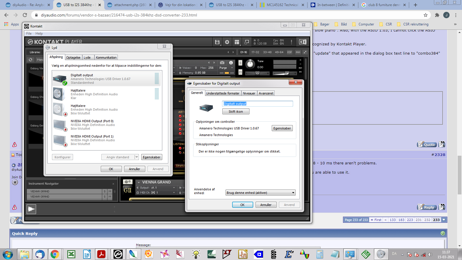

Hi Domenico - & thanks for your prompt reply ...
I hope the information you need is what is in the attached screendump? It looks as if it is a 1.067 driver (and I did play the piano again when I checked this) ...
What do you think has happened?
Jesper
Thank you Jesper, it seems the board is not updated because Windows is loading the old driver. When you run the update.zip use the oemid update on the first form shown.
I m downloading your player, it proceeds a bit slow so when finished i'll test it.
BRs,
Dom

now i haven't a way to verify but if you used oemid combo384 the update tool completed reistalling a default firmware.
When step1 completes you can just wait a bit and then press step2.
Step1 restarts automatically the board to continue on step2 so you don't need to unplug the cable or remove the power supply to reset the board.
BRs,
Dom

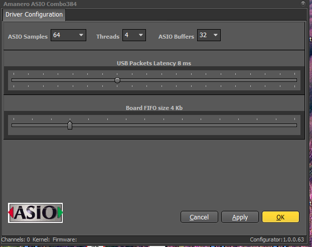

Hi again,
I tried to re-install the driver etc. you provided me with (writing "update" in the first config tool dialog box) and now the Kontakt Player recognizes the new ASIO option. And the ASIO 1.03 no longer can be selected (appears to not be present).
I am also able to play the piano with the new ASIO option, however, it is even slower than it was with the ASIO 1.03 version. Also, by default Kontakt Player sees the combo384 as "stopped" - only when I disconnect and re-connect the USB cable while the "settings" dialog box is open is it recognized as "running". Additionally, when I click the "configure ASIO" button, Kontakt Player crashes and must be restarted.
Just FYI these are the settings in the ASIO dialog box and in the Kontakt Player settings box. Apparently the latency/delay values are very low so possibly something odd is going on here ... 😕
Sorry to ask about this, Domenico ... I hoped it was a straightforward thing as I really would like to use the DAC with the piano ....
Jesper
A P.S.: Just in case it matters I cannot set the FIFO size. The slider can't be moved.

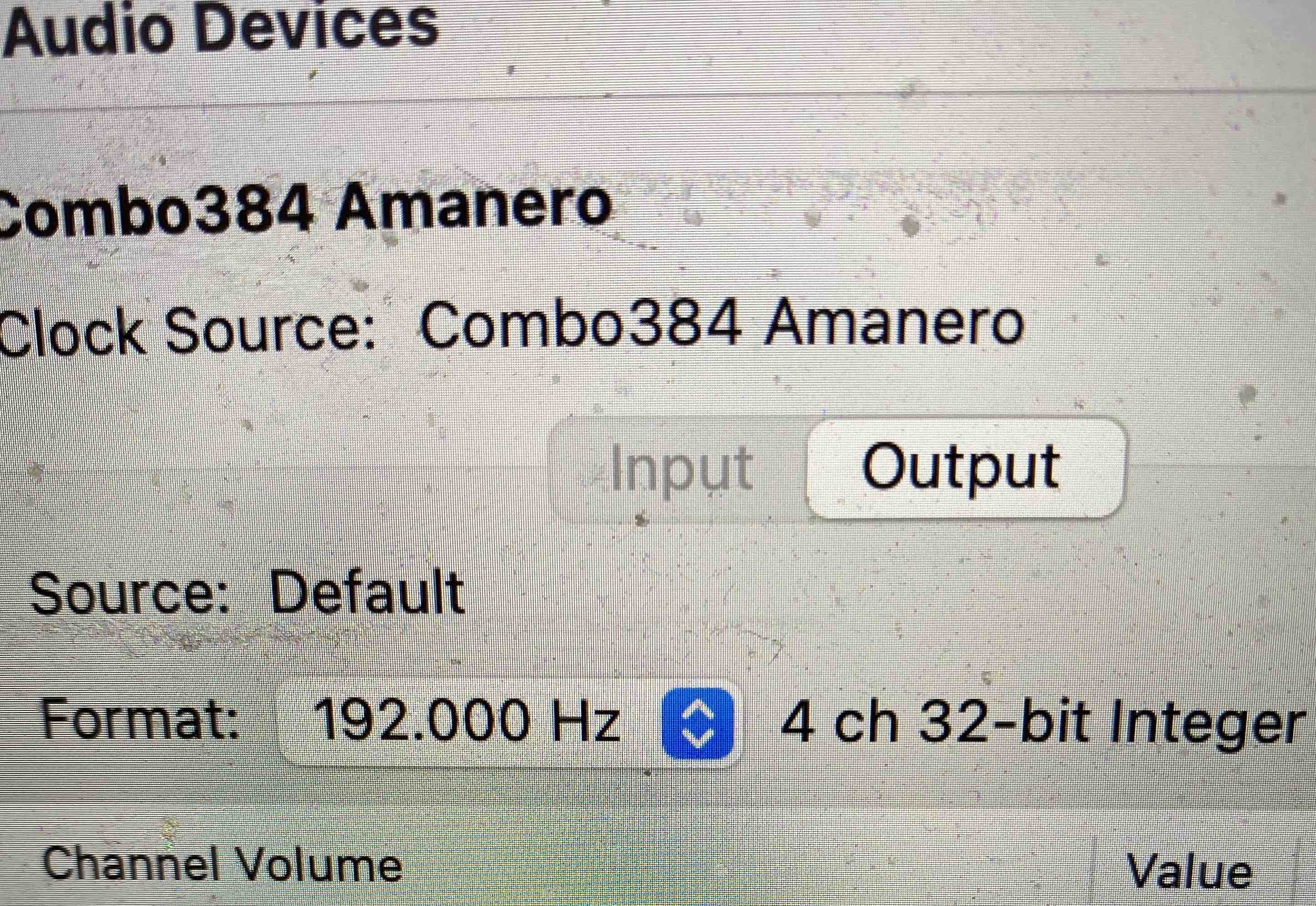

Hi Guys, i'm just wondering if anyone is actually using the 4 channel i2s firmware on mac? I had taken the note to mean that it didnt require driver (on the mac) for 4 channel on mac, but does it perhaps mean that this configuration doesnt work on mac?
you see, a few years ago, I updated the firmware to the 4 channel version and after that it stopped being mounted on my mac. I had some trouble rolling it back, so I thought I had bricked it somehow after erasing it, from doing the update in wine, rather than on a PC and had been unable to roll it back properly on PC. yesterday I came across it and plugged it in, checked all the voltages everywhere and all was good at all points on the board. so on a whim, since I now have a win laptop in the house, I mounted it in the installer, managed to erase it and roll to a 2 channel and bam! it finished the install and I was able to mount it on my mac!! I installed the 4 channel FW again, it refused to mount again. back to just about any other combo of CPU and CLPD FW and it works.
Is there a specific combo of CPU FW that I must use to use the 4 channel i2s?

Hello,
To enable 4 output channels:
- run ConfigTool.exe
- select CPLD i2s_4ch and press Flash CPLD
- when done after 1 second unplug and replug the board
- select CPU firmware i2s_4ch and press Flash CPU
- when done I2S Data output channels 1/2 and DSDOE channels 3/4
on Mac you have this www.amanero.com/4ch.jpg
Thank you!
Michael (support)

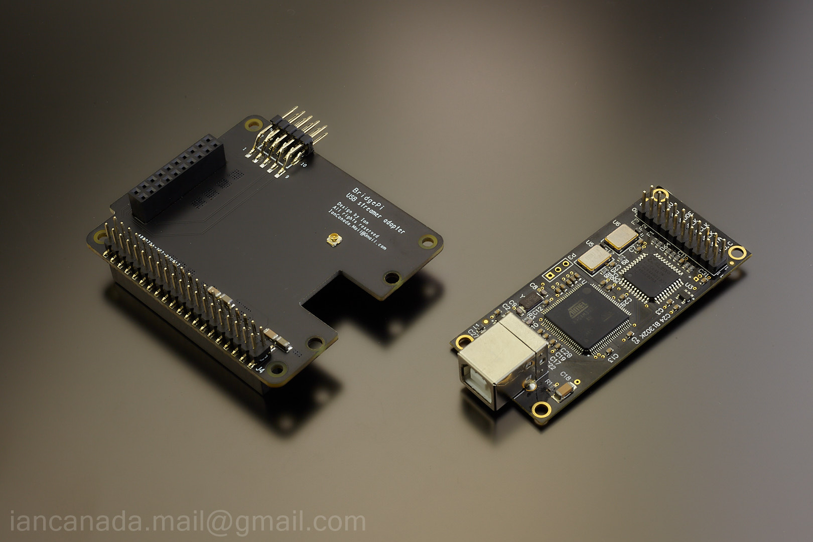

@amanero,
I'm interested in the Combo384 to use with Ian's BridgePi.
Is there a version of the Combo384 with no clocks?
The Combo384 on the main website is the only version you sell?
I'll be using Ian's stack along with Andrea's clock, so prefer the Combo384 had no clocks at all.
If there firmware to disable clocks?
Hi A123, do you need a board without mounted clocks?
or do you need the board (working in slave) with an external MCLK?
Thank you!
Michael
Thank you!
Michael
I believe without mounted clocks. Could be wrong as it's very preliminary stage ATM.
I just need the I2S feed as pure as possible, then sent on to be re-clocked.
I'll be using with Ian's BridgePi and FiFoPi reclocker (not shown) along with Andrea's clock (not shown):

OMG, did I really not see there was a 4 ch i2s CPU firmware as well as the CLPD? yes, I really didnt see that. that'll teach me to do that late at night. I either didnt see the matching 4ch i2s CPU program, or saw it and disregarded it as the CLPD as the name is exactly the same and there areso many variations. anyway, all appears to be well now. updated and 4 channels visible on my mac.
thats embarrassing.
does anyone know if it works in 4 channel mode on rpi? keen to give it a bash on moOde, now that camilladsp is bundled.
