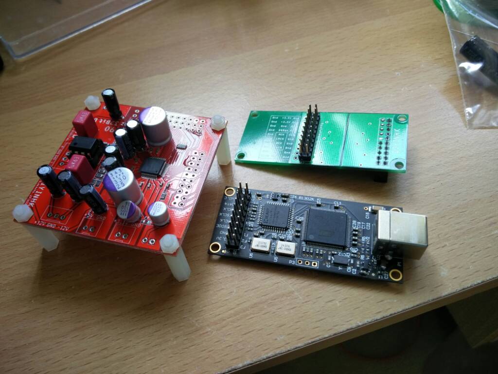

Today assembled my diyinhk ak4490 board with some mods. Looking through datasheets to figure how to connect it to amanero for dsd and pcm playback. Looking at i2c controls of amanero usb board to configure ak4490 board. How do you guys connect amanero to ak4490? Cannot find anywhere on the net for connections and software configuration of those two.

Hi birca1987,
I may suggest that you look at the datasheet for the AK4490 - available from AKM's website - and the attached amanero preliminary datasheet.
Depending on whether you run the AK4490 in Serial control mode or PCM mode you need to connect different pins. If in PCM control mode (i.e. without an external microcontroller to set internal registers in the AK4490) the pins you need to connect are MCLK, LRCK, SDATA and BICK (AK4490).
The equivalent pins on the Amanero board are pins 3 (SDATA), 4 (BICK), 5 (LRCK) & 6 (MCLK).

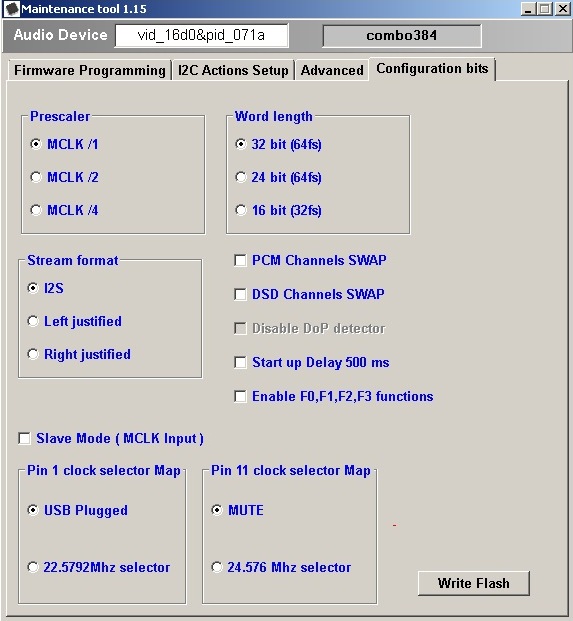

The pin called Mute has been assigned to PIN 11 and is asserted to 1 when a sample rate change is incoming or when there is a stream format change DSD / I2S you can use this pin to avoid noise when the dsd is detected.
The pin 6 is the Master Clock MCLK 22,5792Mhz or 24.576Mhz.
TWC.D is an I2C bus, i m preparing a ConfigTool that let's the user configure Events in the module. For example you can assign I2C address and values to put in the I2C bus when the volume is changing or when a sample rate is changing. blah blah

Is there a complete firmware history with complete description firmware, not abbreviated? There Amanero Technologies have a very brief description. In OEMTool117 longer firmware versions: 15 for CPLD, 21 for the CPU. We need a complete list with description.
Most likely, the versions up to 1080 had shortcomings. Older versions have some add-ons to the basic version.
Regards, Alexey
