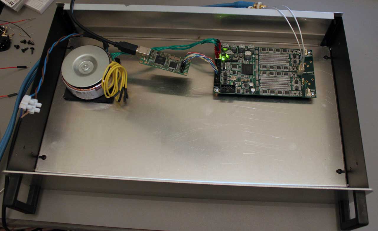

I don't think it's my software. Dies the same on Linux and Windows. Last night it looked like it wanted to lock, sort of stuttering, but never catching on.
I installed 3 inch twisted pairs and got no lock today. Getting a smaller transformer tomorrow. Will try it too. Getting a diyinhk adapter in a few weeks. Will try it and see if there's any difference.
Have a scope, but not sure how to use it. Just connect to ground and signal and see if anything appears on the scope?
I measured a few of the twisted pairs and they read 1.1uF. I don't how accurate the reading is, but I have measured know values and the meter checks out.

No way 1.1uF is accurate. It's a bunch of orders of magnitude off. I wouldn't worry about cable capacitance with short thin wires.
I had my Soekris fed from an Amanero that was literally hanging by a bunch of not-too-short UTP pairs for months with no problems. I believe the Amanero's FW was an old one, at least a couple of years back.
Went home for "lunch", walked the dog and quickly hooked up the I2S to the dam1021 with the 6 inch (150mm). Got lock on Win and Linux OS! The road did the trick.
It's sounds a little rough from a cold start, but I can hear the potential. Amp needs warm up for an hour too.
Thanks for all the tips, especially the flashing, which is real easy.
I can't seem to get a good pic with my tablet, but here's one anyway.
Now have to get in the car and drive back to work. :dead:
