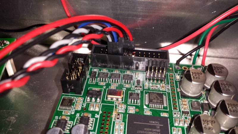

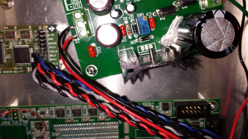

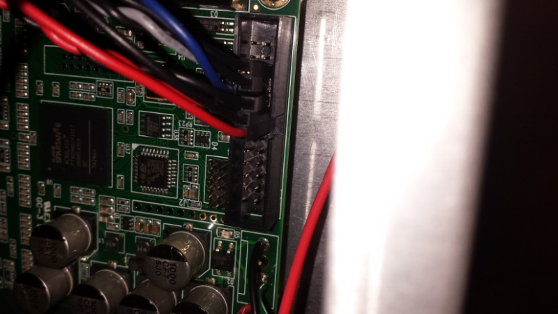

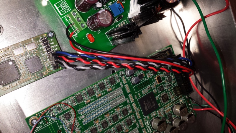

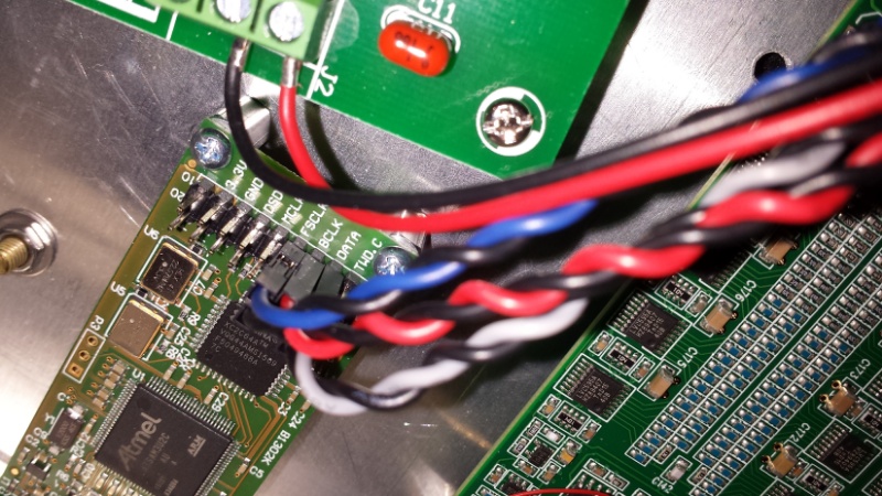

Hi All,
Just put together the latest Soekris dam1021 DAC with Amanero I2S USB adapter. Not getting a lock.
Using this web page as a build reference- https://hifiduino.wordpress.com/
- J2 Voltages are ok. Using adjustable voltage regulator set to 10v dc.
- Supplied 3.3v from Amanero I2S board to DAM1021.
- Audio output taken from raw L&R on dam1021.
- Music server Daphile software recognizes the Amanero combo board and Amanero is able to be selected in the Daphile software.
- Default auto-select of source in use.
- Tried 3 different USB cables, all non-audiophile type, probably USB 1.1.
- Tried StraighWire USB cable of better build quality.
- Tried 16 bit and 192 bit music tracks.
Does the lock happen only when it detects a track or the dam1021 detects a source?
- Added dedicated regulated 3.3v to dam1021 isolated side. Still no lock.
Twisted all pairs. No lock.
Locked for a few minute on Windows (with Windows driver). Lock is eventually lost.
Music tracks played faster, as if sped up. How's that even possible?
I've read that Amanero board isn't the best fit for Soekris 1021. Anyone have this experience? Can anyone recommend another USB to I2S adpater board? DIYinHK??
Is it possible the firmware on Amanero needs updating? This board is the latest from Soekris.
Any help would be appreciated.
Thanks,
Vince

Hi.
Amanero works fine with DAM board. Please post pics of your setup, especially the connections between Amanero and Dam.
Regards
Thanks for taking a look. It doesn't look much better in person. Difficult to see with all the black headers
blending.

Smanz, thanks for checking it out.
I was thinking it could be two things. The toroid transformer is 6.7 to 9 amp capable. Is it possible it's generating a large field? Possibly injecting noise?
Other concern is the wiring is stranded. Maybe solid core thin gauge like used in CAT 5 cable would be better suited for digital signals?
Wires are under 6 inches (150mm) or so. Soren at soekris said that length is fine if twisted.
Vince
