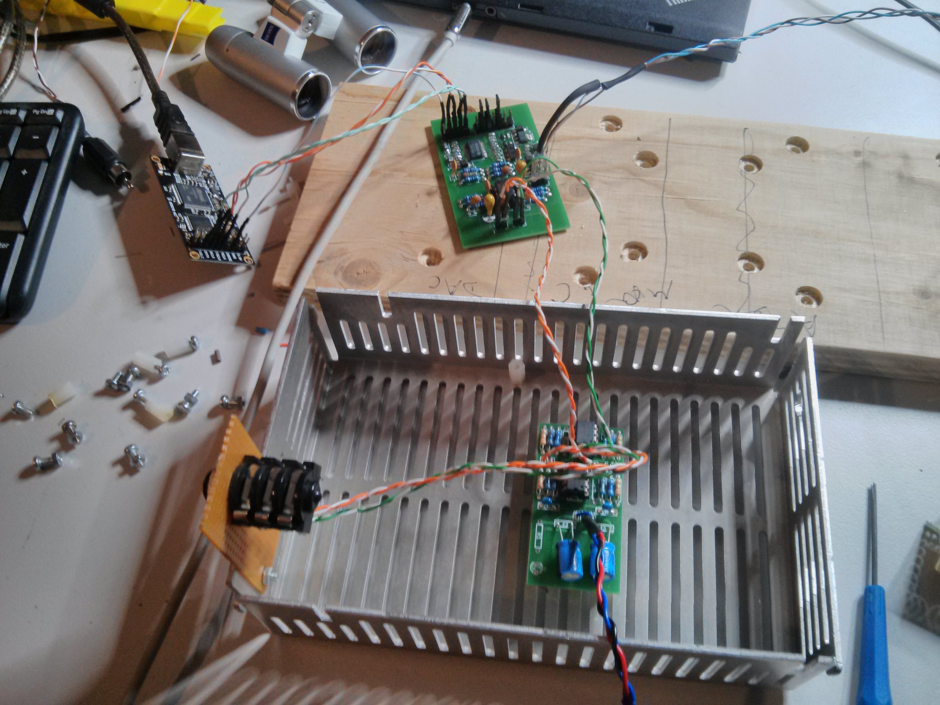

I just got me an Amanero board. Works as expected. I hooked it up with no frills to a PCM1793DAC I made. The Amanero is powered by the USB port, the DAC has an external linear power supply.
I do get quite a bit of hum in the 50Hz and its harmonics (I've measured that with an analyzer). I remember the DAC, being fed with another I2S source is much quieter.
I'll put an isolator between the DAC and the Amanero as first measure (ISO7341) to see how that goes, however, I don't mind making a power supply for the Amanero. Question is, where do I input the power, over the USB connector?
Cheers, and apologies if this has been asked before.
Albert

@gentlevoice, no offense at all, on the contrary, good advice. I don't think there's a ground loop on the DAC board, there's no spikes there when the PC is disconnected. I'll disconnect the PC though see how that goes, might help.
Thanks for the schematic, I'll have a look and play in the next couple of days.
I plan to use that Amanero finally on a Raspberry Pi 3 off a linear regulator anyway, so that's something else I have to try. I have the Pi 3 on a little box, but I'm aiming for a more complex system that includes the Amanero.
I had a proper listen the other day to the PC -> Amanero -> DAC -> Headphone amp chain. No pot based volume, direct out, full blast. Software controlled volume on VLC to keep my ears from ringing though. It sounded very good, very good indeed. At pause, when the Amanero sends only "0" (zero), there was really a minor, minor background noise to be detected, but only on a very close and dedicated listen. Play some music and I didn't even notice.
And of course, my current setup is far away from optimal...

@Betocool: Hi again ... just a brief comment to your setup ... Looking at your wiring from the amanero to what I reckon is your DAC I notice that additional to your twisted pair wires there's a single wire a bit away from the twisted pairs. Might this wire somehow pick up/be part of a ground loop?
Jesper

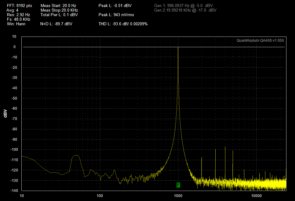

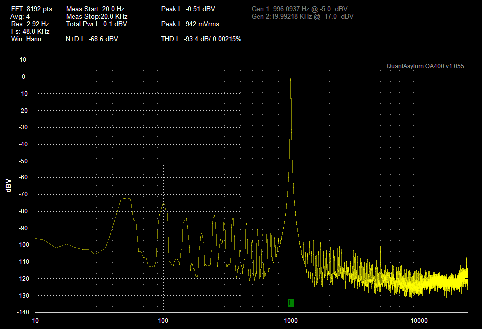

Thanks for all the advice so far. The ground loop issue advice was spot on. I did some measurements.
First, connect a microcontroller that outputs 1KHz I2S signal into the DAC. Clean as a whistle. All those circuits run from the same power supply (uc-DAC.png)
Then, connect the Amanero to the DAC. Lots of noise in the 50Hz area. Bugger! Disconnect the power supply from the laptop where the Amanero is connected. Still same. Bugger twice! (Amanero-DAC-PC.png)
But wait, the measurement system, is PC based as well, on another laptop. Disconnect the power to the laptop and let it run on battery. Now we're talking! That's the last image, laptop -> Amanero -> PCM1793DAC. I'm pretty happy with it now. (Amanero-DAC.png)
I guess I'll not bother with the isolator at this point in time. Especially if the end will be connected to a RaspPi3 all on linear regulators.
Thanks for all the comments so far!
Alberto

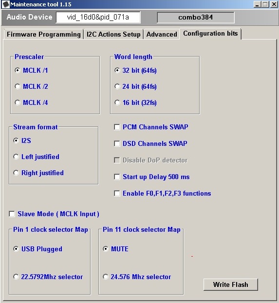

Hi All
I have an inetresting problem with my Amanero board that I hope someone can help me with. I need it to talk to my Pmd100 decoder chip in my Dac I am building. The PMD100 uses left justified data and my clock (xti input on pmd100 chip)needs to be between 8-14MHz.
I have used the Amanero config tool software to create a left justified output and it will work(well just) but it has a lot of crackle as I am using the standard MCK rate of 25MHz.
If I use the MCK/2 prescaler, I then get sound at half speed. Adele sounds like a horrible man and the chipmunks sound like Barry White. Well not quite. I notice also at the MCK/2 rate that the actual time shown on Jriver software is also going at half speed.
Does anyone here know what is wrong here or may have some suggestions to try and fix it?

The MCLK of PMD100 must be synchronized with LRCK / BCK / DATA,non-synchronized will produce pop noise or murmurs.
I think you miss read my post Keevlin.
My pmd100 works well as I can get it to work with my cs8414 receiver chip using coax digital or optical digital inputs.
It doesnt work well (crackle) at high mck rate of 25MHz as the chip can not handle such high frequencies.
When I use the MCK/2 pre scaler, it works with no crackles, but at slow speed (low pitch) like a record player on slow speed.
At the slow speed I notice that the timer counter in my player software (jriver) is also counting at half speed (maybe driver needs to be changed?)
Cheers
Simon
I have solved the issue with the Amanero talking to the PMD100 chip. There was a firmware update for a DF1704 filter chip with reduced clock speeds in the list. I tried that and all is ok. Thanks to Domenico and his multitude of software options, this usb-i2s converter has got to be one of the most versatile of all the current popular converters available at the moment.
