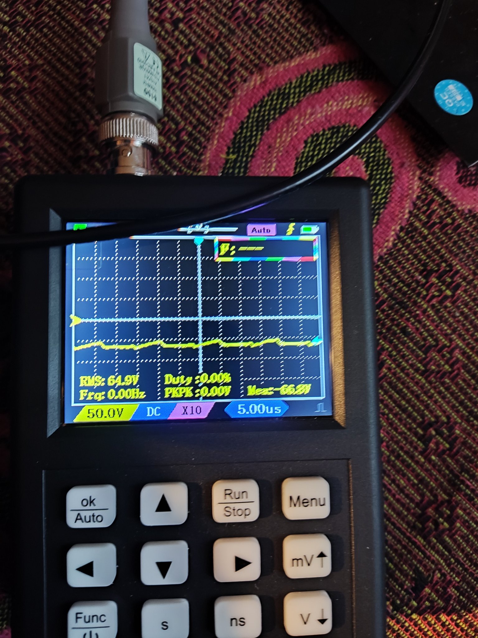

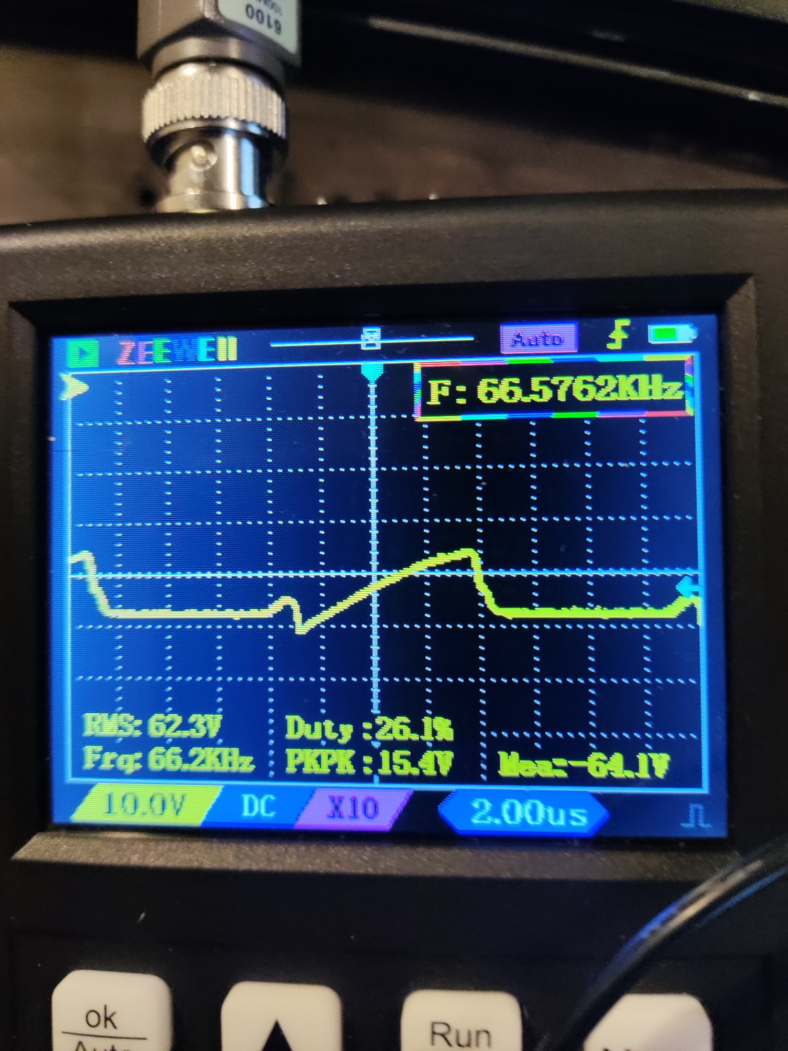

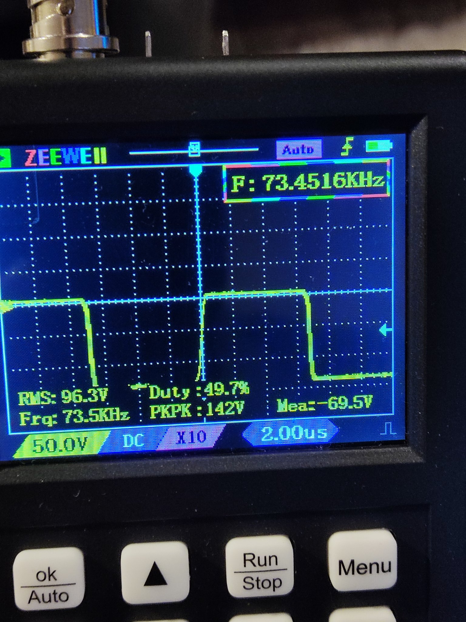

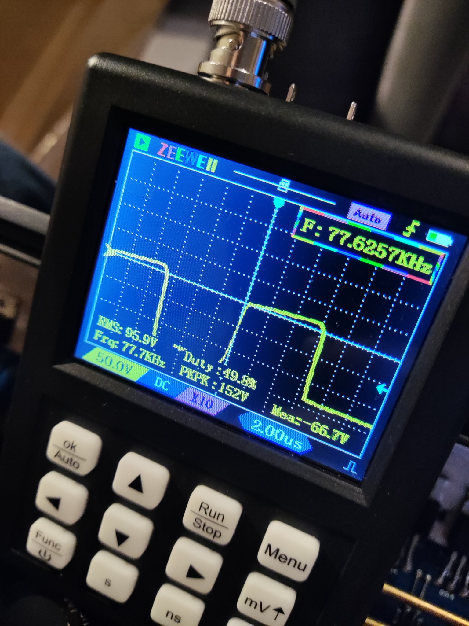

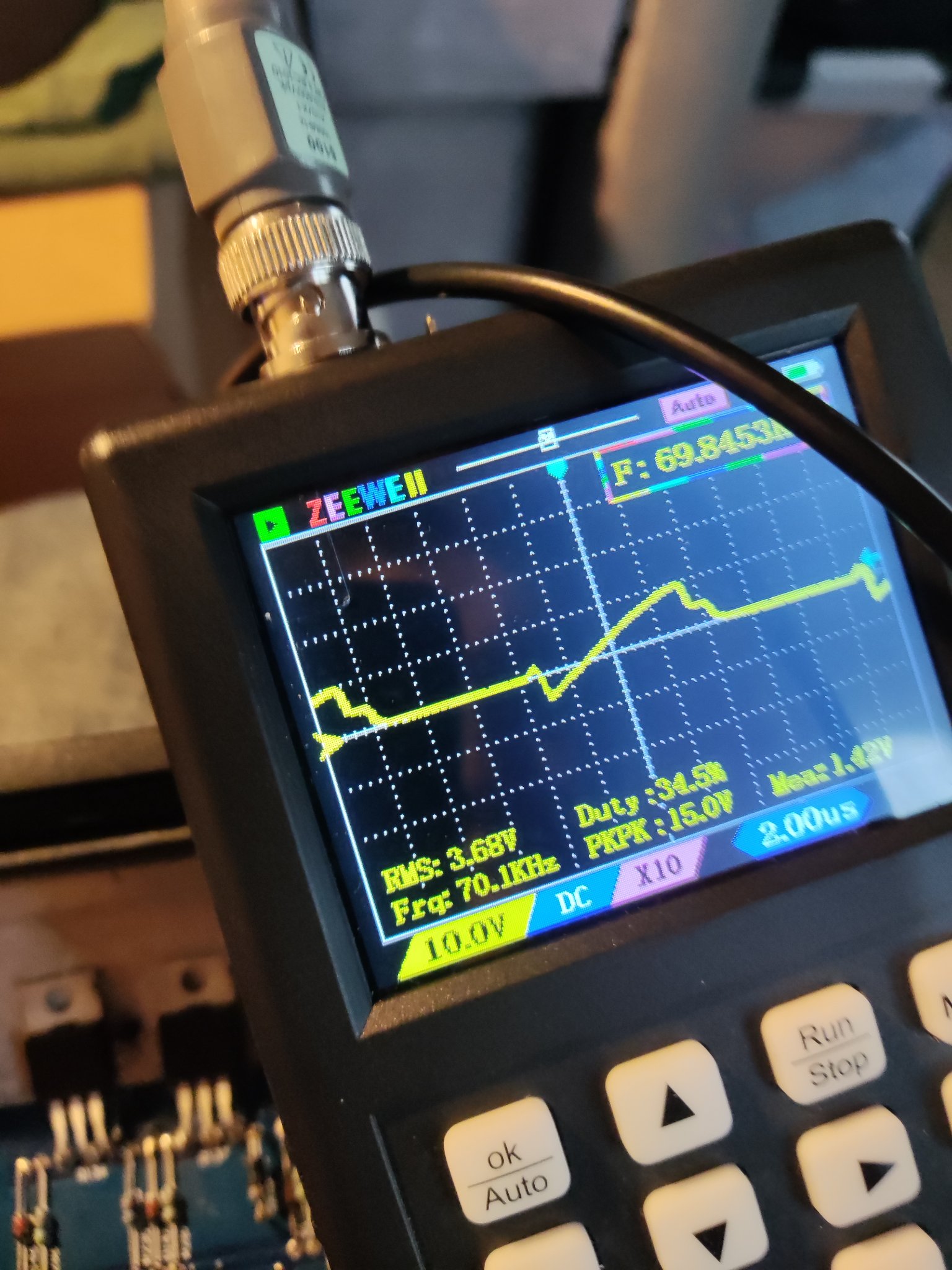

I am very confused, it powers on, no DC on the terminals

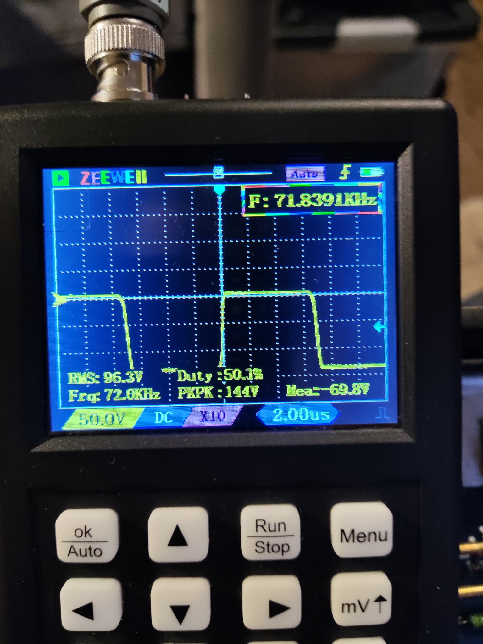

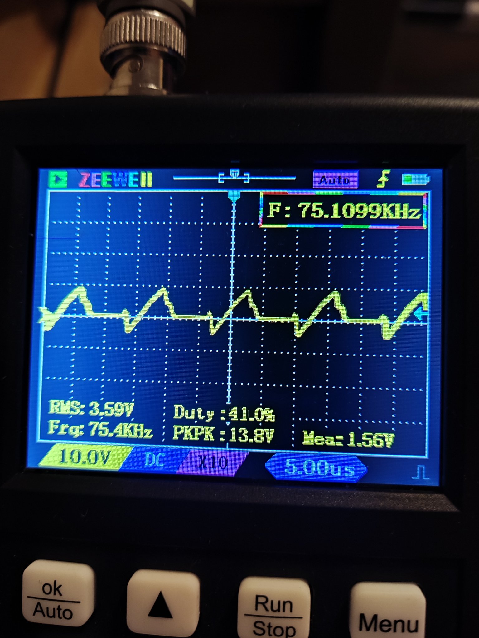

Measured with ground on battery for now, but one side has switching on the output gate, other doesn't seem to have any (no signal)

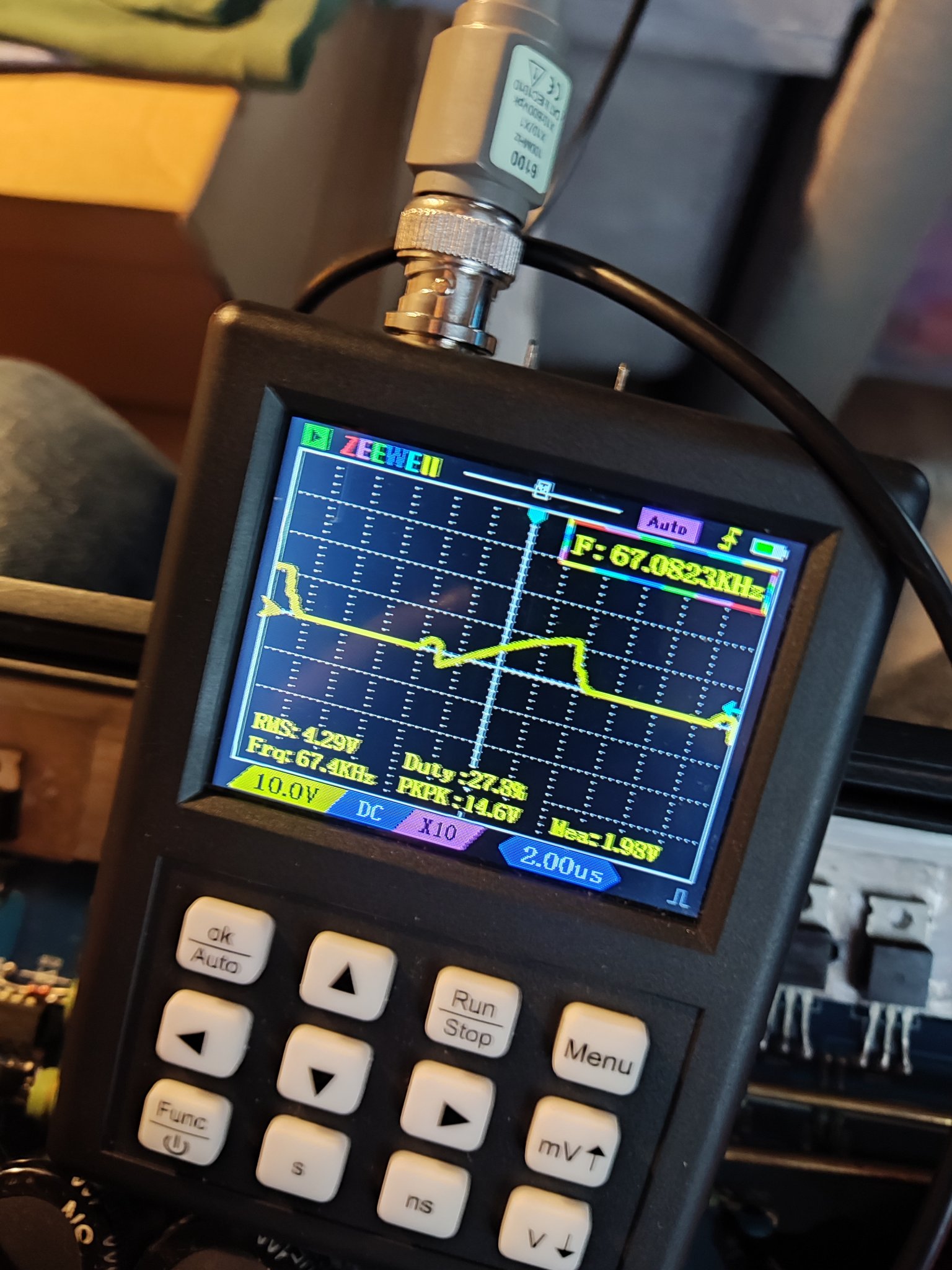

Other side gate:

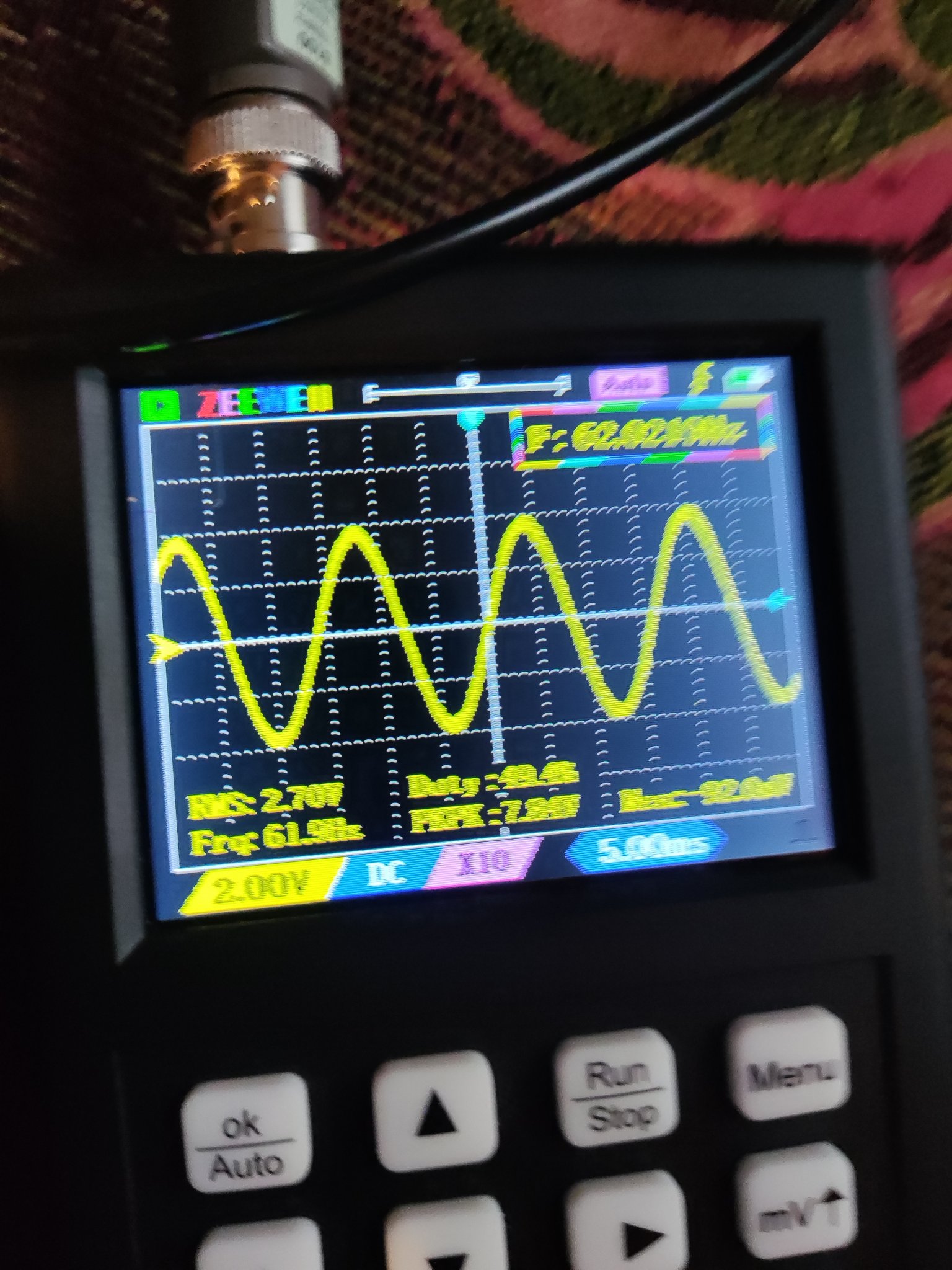

Output seems to have a small triangle wave at 72khz, same freq as the 1 output fet
Edit:
I don't get how it generates this on the output terminals

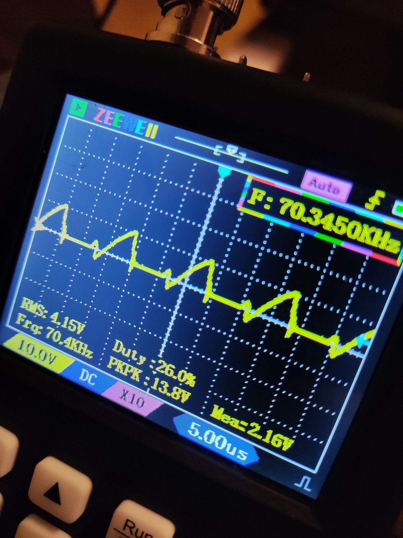

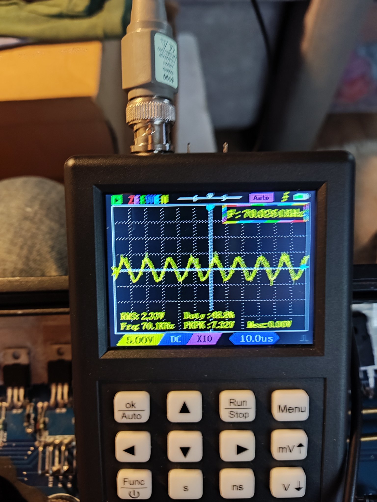

When measured with the black on source, gate looks like this
With ground on battery -

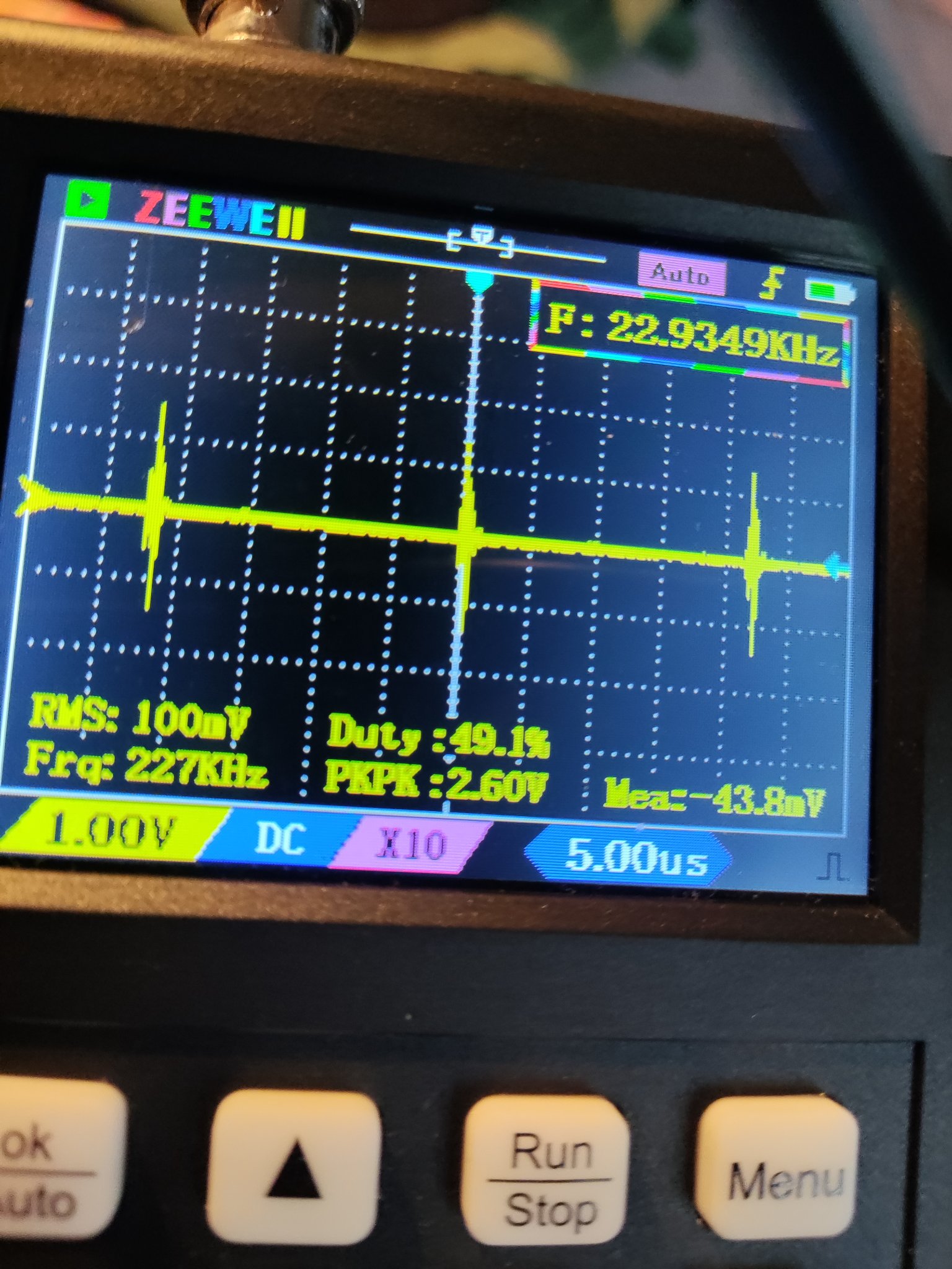

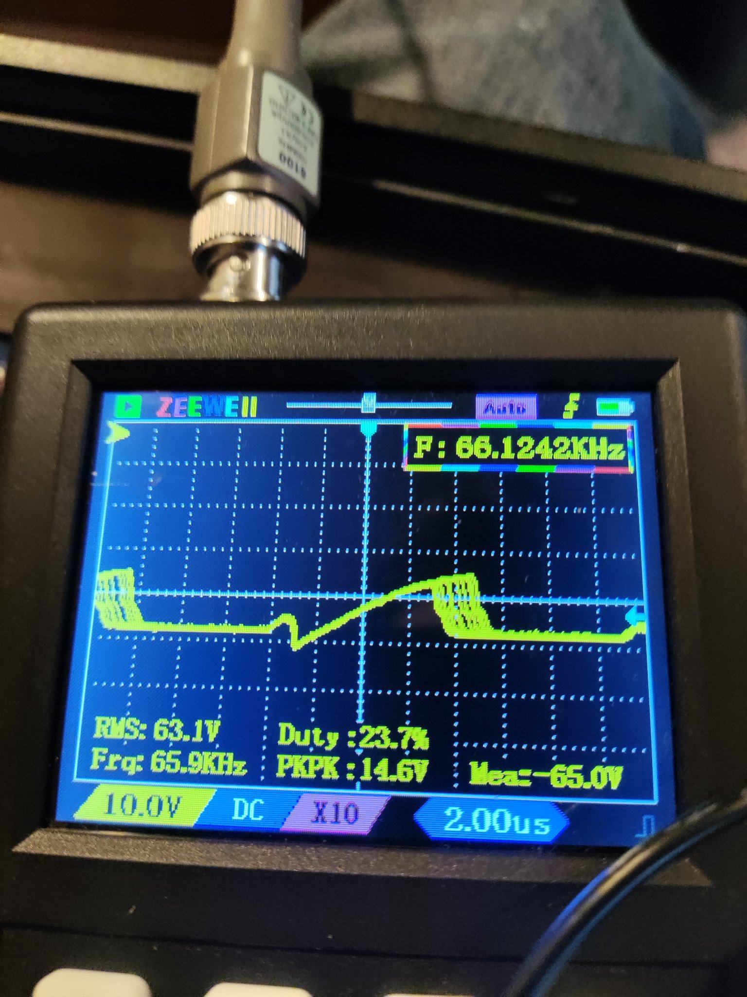

Driver chip pin 7:
No signal:
Driver chip pin 1:
No signal:

The output FETs on 1 side get warm, I'd say like 30c, other side stays cool

I'm only interested in waveforms that are gate to source. Post one of each bank. 5v/div, DC coupling, 5us.
Are all of the gate resistors and output transistors original values?
When you said you have FETs heating, are all in the same bank heating evenly?
