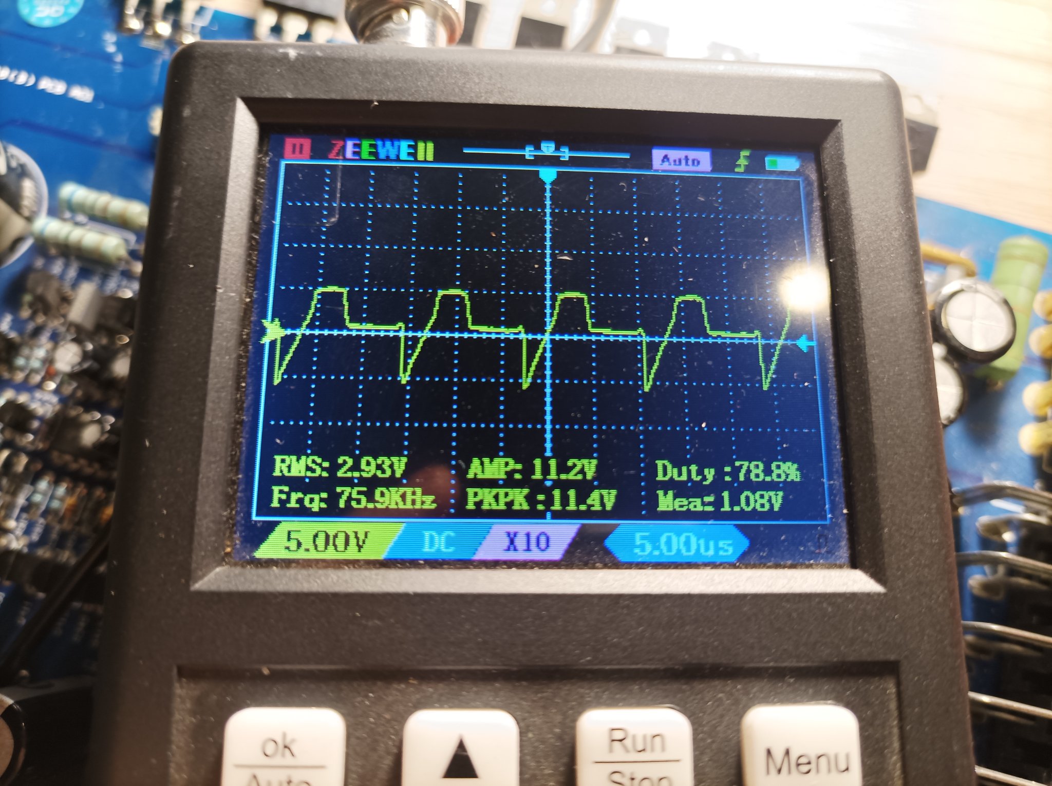

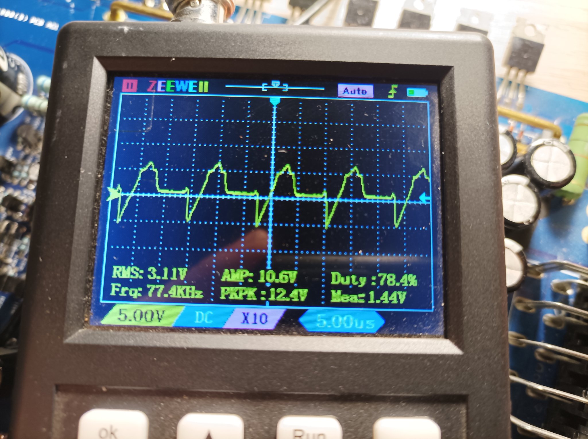

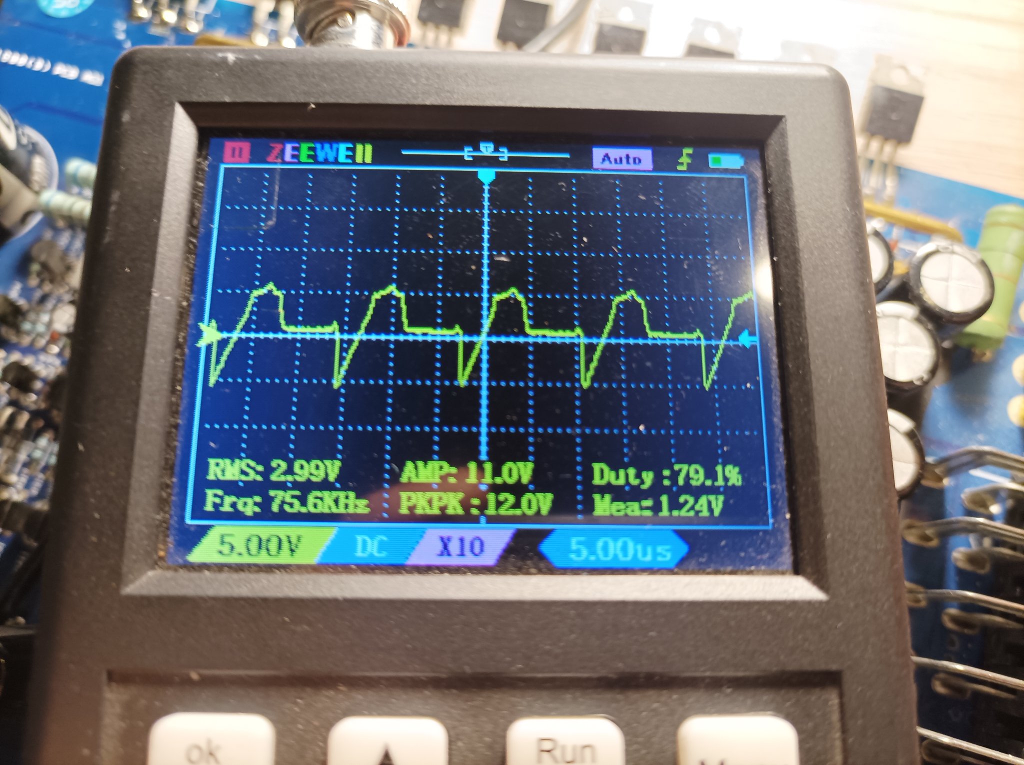

The factory 820ohm resistor, about 1.61A of current draw, but when clamped they seem to heat up less than I remember, barely detectable temperature change in 1min of running.

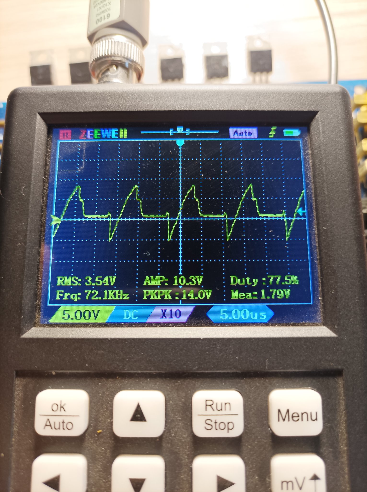

Proceeding free air, With a potentiometer set to ~100ohm in series with the R175 820ohm resistor, current draw is 1.59A and heating is about the same as before

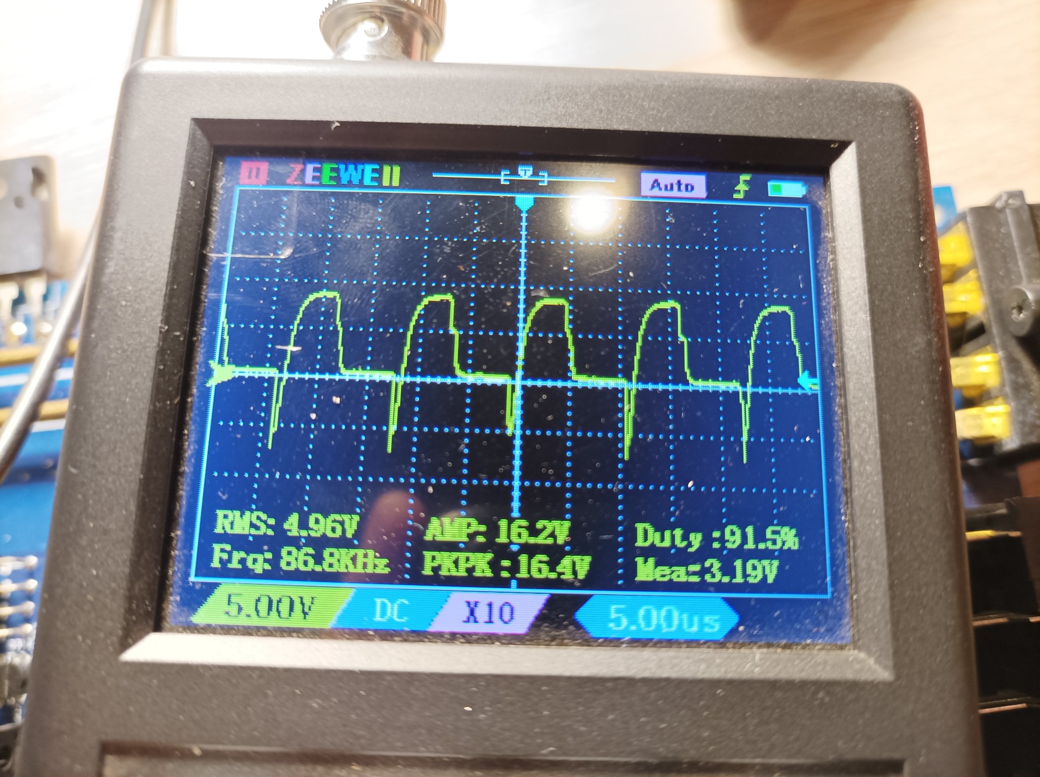

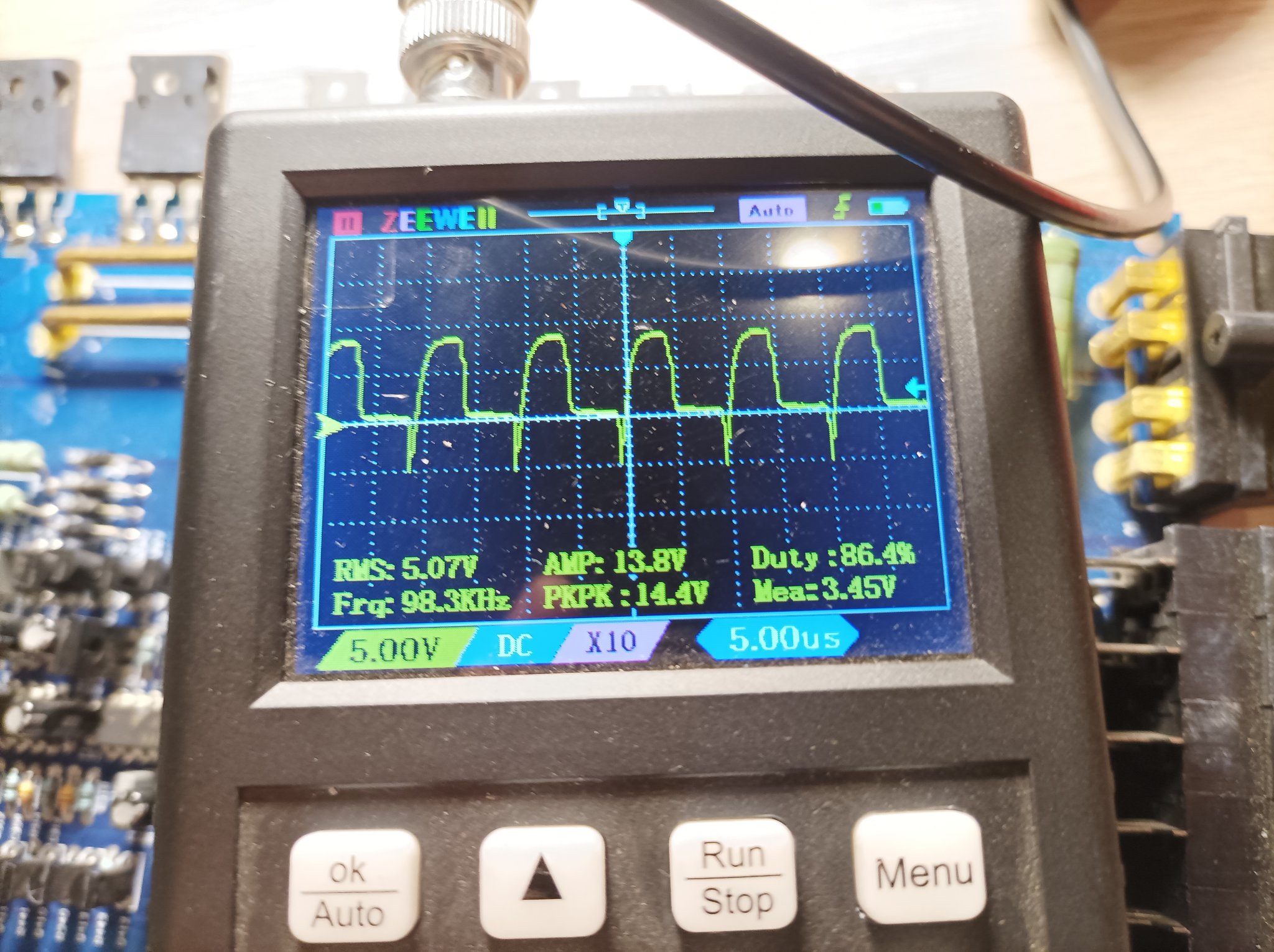

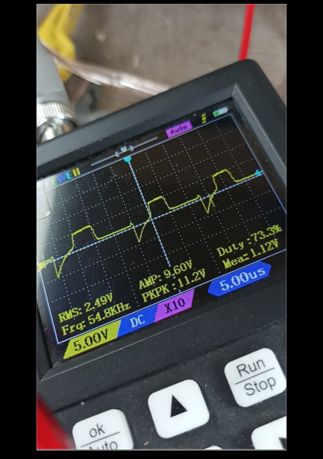

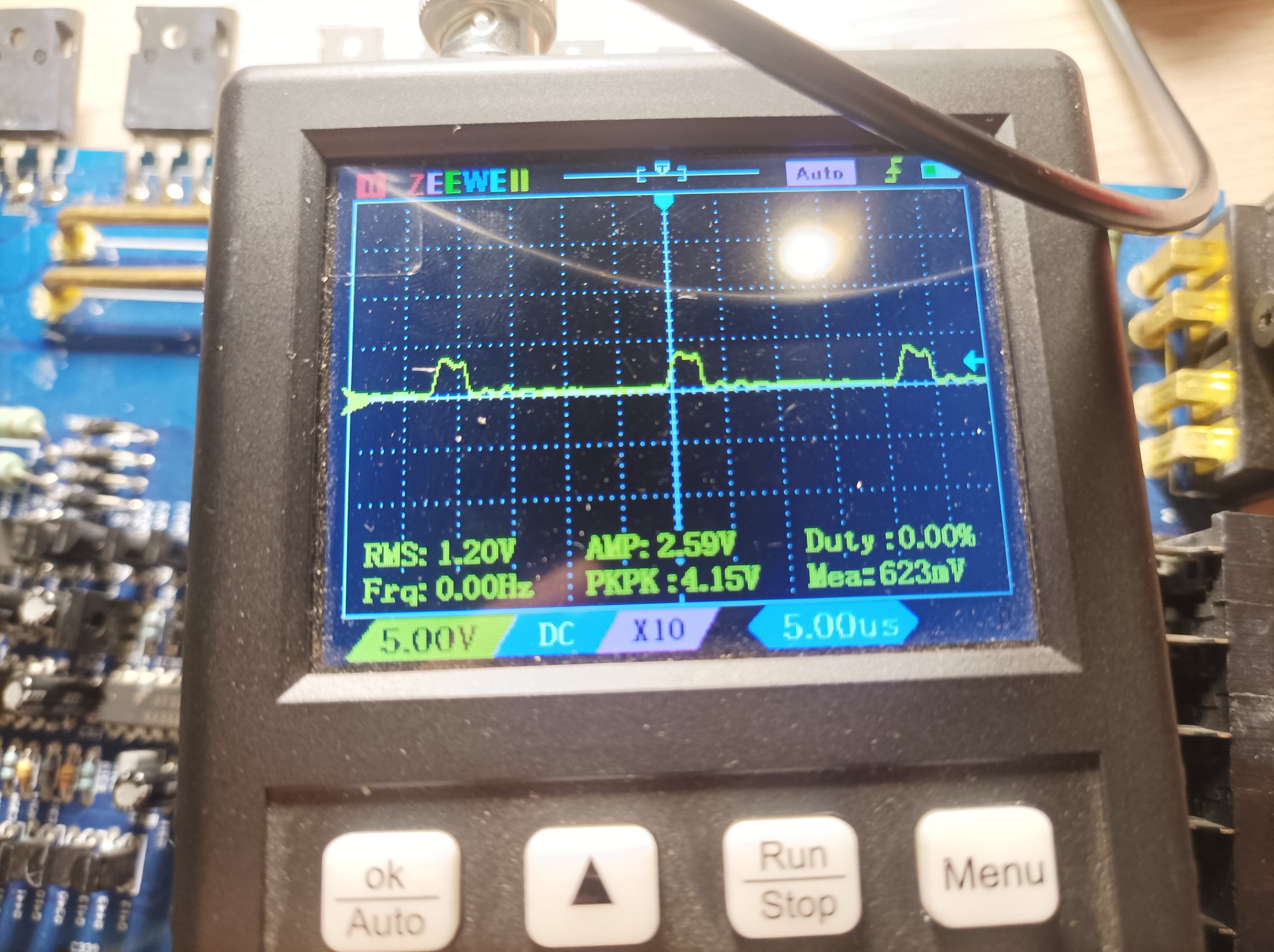

waveform looks like this:
source to gate (negative on source)
