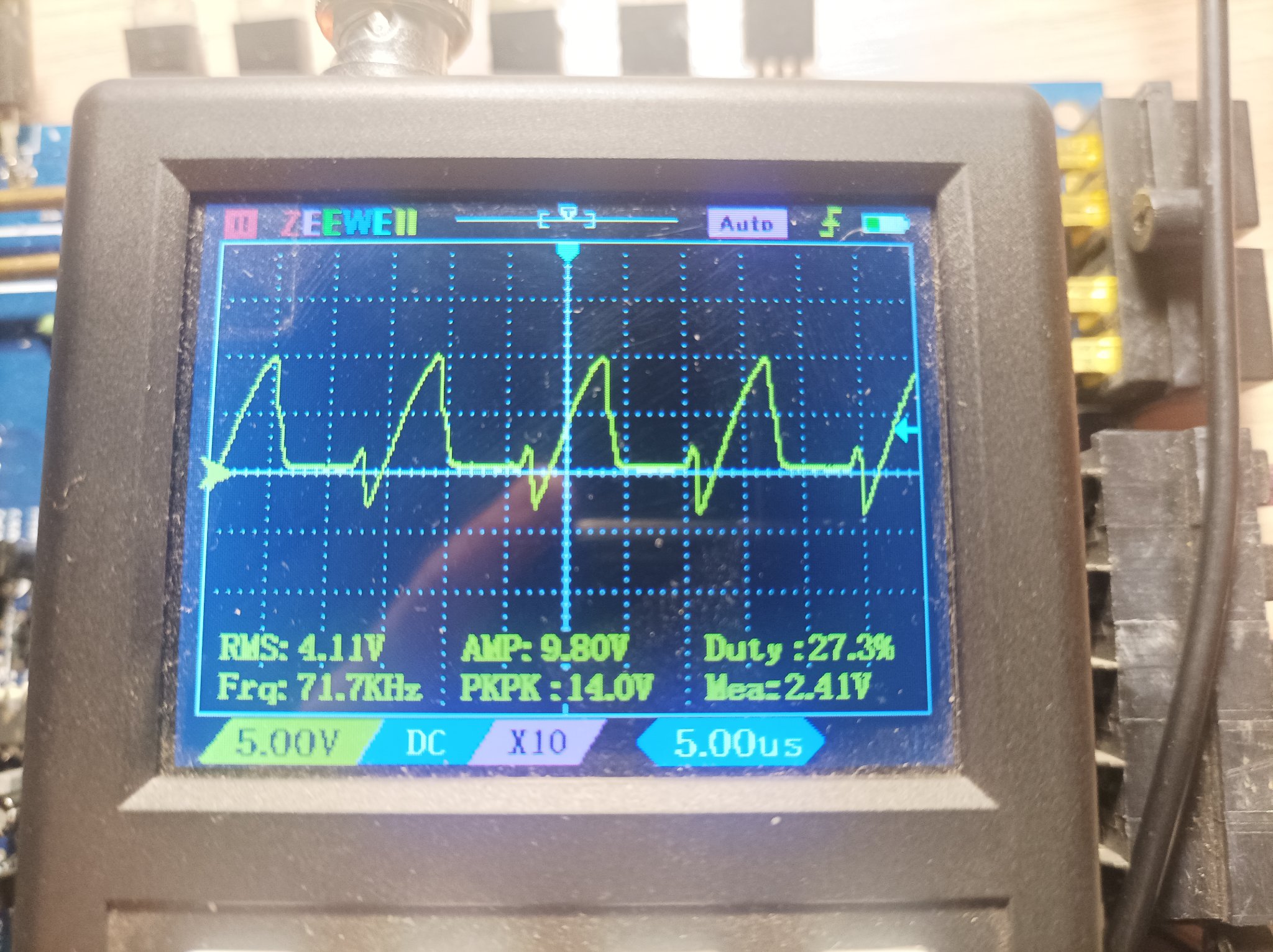

If you clamp the FETs to a heatsink (temporary heatsink is likely good enough), will the amp produce rail-rail oscillation and if so, does it produce audio?
That's OK.
DC coupling
5us/div
5v/div
negative probe on leg 3
probe tip on pin 1

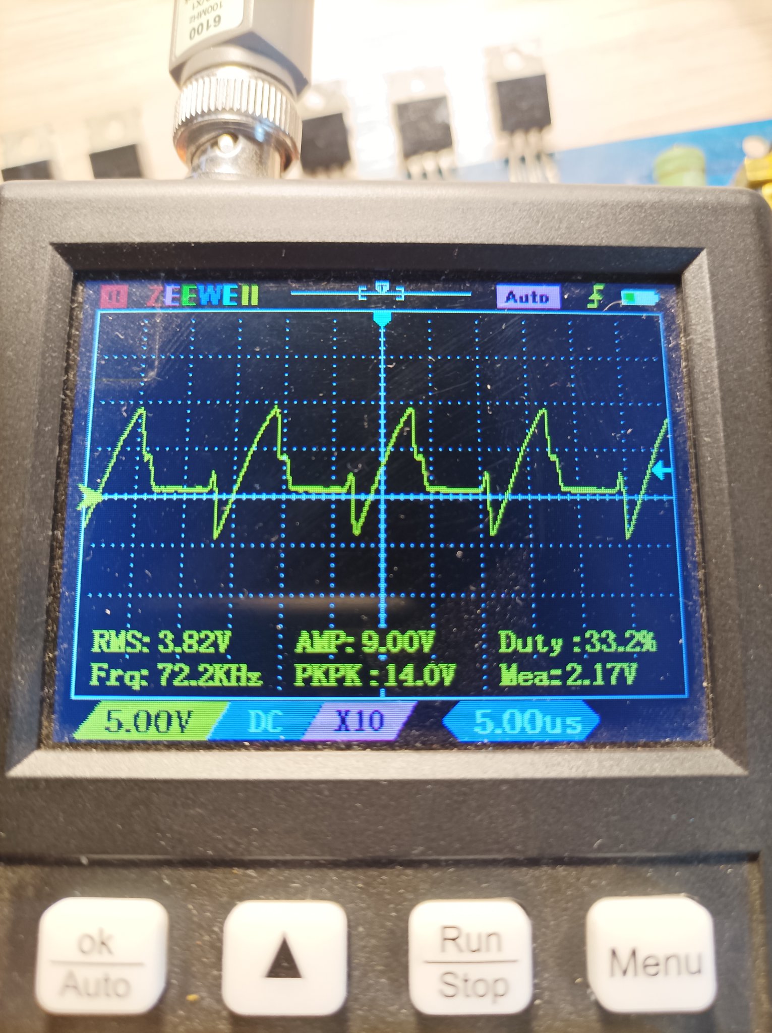

post the waveforms you see on one of the cool low-side FETs and the waveform you have on one of the heating high-side FETs.
DC coupling
5us/div
5v/div
probe tip on pin 1

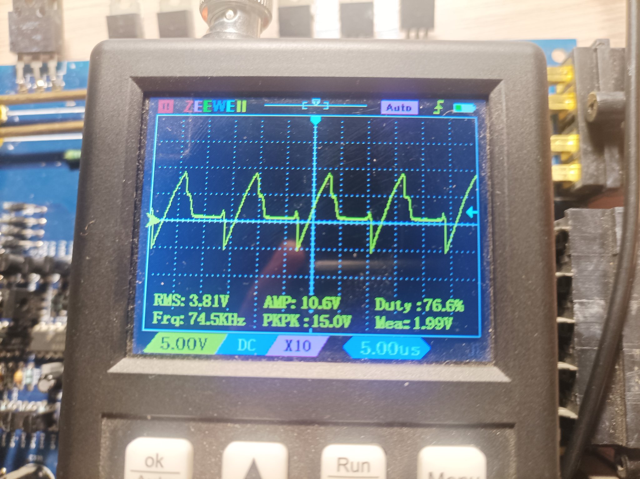

Both seem to be rising too slowly. Are the output FETs and gate resistors the original values and from reliable distributors?
The high-side has a step in the falling edge. This is OK in some instances but this one has too much amplitude at the top of that step because it's above the threshold voltage of the FETs.
What does the gate drive look like on the other side of the high-side gate resistors.

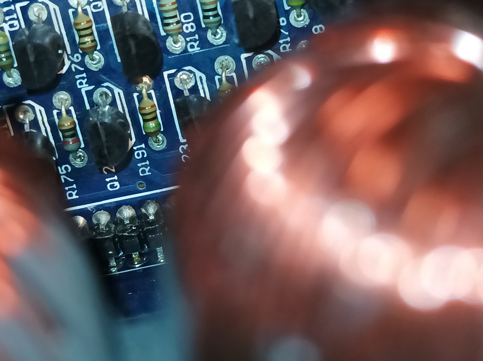

Confirm that R189 is within tolerance.
Desolder (at least) one terminal of R175 and recheck it. Yours looks like 1k but 820 is a possibility.
R175 indeed is a 820ohm, the grey band is on the bottom, barely visible, so it is within tolerance.
R189 also is within tolerance at 1.2k ohm
