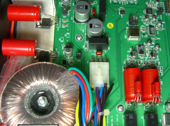

Thanks for the update salas! Amazing how much one cap affects the Benchmark's sound, isn't it? Beyond anything in my experience. It's one of only two coupling caps in my system when playing digital sources yet appears far more sensitive than the cap in my amp.
I went back to the Blackgates. My system hasn't the bottom end to comment on slam but otherwise I agree pretty much 100% with your description. Overall though it was too much of a good thing in my tube SE / Tannoy Gold system. The effect is inadequately described as robbing the sound of life and jump factor. The Auricaps sounded great – smooth, big, expansive imaging, zero grit - but never startled. Perhaps the 0.22uF Auricap was too small. To misapply an engineering term, the net effect was 'over-damped'. Oddly, I had the same impression using them in my amp. And while unquestionably smoother up top the Auricaps (in my system again) err towards smoothing over some of the natural ugliness of real sibilance while the 100uF Blackgates added an odd 'hissy' texture to it. Adding a pair of 0.1 uF Blackgates in Super-E connection (engineering disclaimer #2, the manufacturer's description of Super-E reads as pure bunk. however it either has an effect or has none at all, so there was nothing to lose by using their recommendation. I didn't try the reverse) may have reduced this texture. I say 'may have' because it could have been the BG's notoriously long charge-up/break-in factor as well but it's improving. My suspicion is the 100uF BG N is the limiting factor and I'm hoping the NX Hi-Q selection, with their smaller physical sizes and voltage ratings more appropriate to this low voltage offset (based on Rubycon's claim of a charge up requirement), work better. Cheap enough to find out and I can always try the 2uF Auricaps later.
Note: pic below shows the caps tacked in for trial. The final install will place the bypasses where they belong, tight to the traces in place of the ceramics.
Edit: Oops, forgot to mention the BG bypasses on the supply. Had the extra caps in the junk box, tossed them in post-regulator to see if it had any effect. None that I could hear.

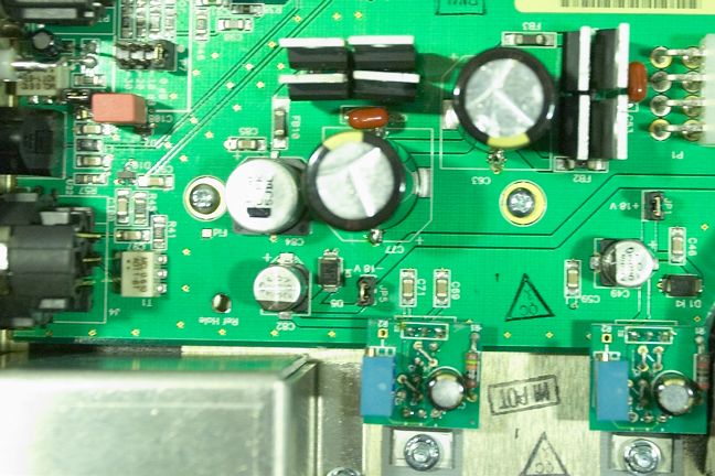

some upgrades
The attached picture shows some of the upgrades in my DAC1. In the lower right you can see new adjustable regulators (LT317 and LT337 using Eddie's boards). Now my opamps get +/-15.00V 🙂 In the upper left corner you can see new caps on the digital input (a BG NX Hi-Q and a red Wima, both 100nf). In the upper right are new soft recovery rectifiers from CREE. I changed also the main filtering caps (Panasonic FM 1800uf/35V). I intend to change the other SMD electrolytic caps as well, to lower the ESR. I also replaced all the six 10uf caps in the digital section with BG NX Hi-Q 22uf/6.3V to minimize the digital noise.
Now my DAC1 sounds pretty good. I had to replace my transport (Denon DVD player) with a MAC + Edirol UA-5 to fully appreciate all the changes 🙂 I intend to try a PC version as well, based on Steve's advice.
Marin

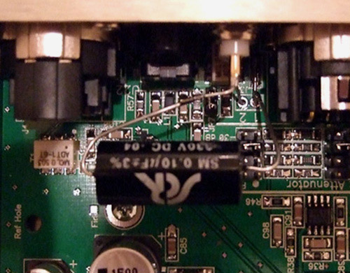

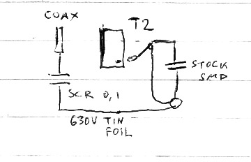

Listened to the coax input cap and C108 (after transformer near JP7, in signal path too) substitution with SCR 0.1uF 630V Tin Foil.
They bring some more clarity in. A welcome notch up. Using the jumper for bypassing the digital input switch, fixed to coax helps a little too.
DAC-1 sounds top class when with very good output signal coupling caps and fast digital input caps. Highly recommended substitutions.
