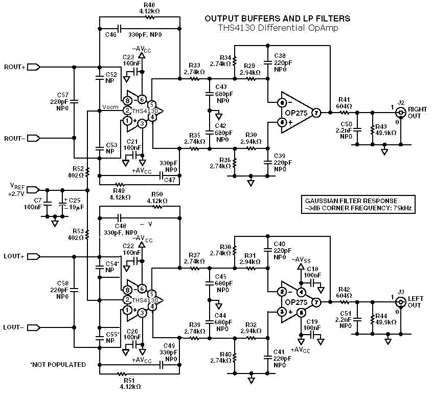

Could the THS4130 sub for the I/V OpAmps?
Hope someone could advise on this.
Would the THS4130 be a good
substitute for the I/V opamps ?
The last opamp, OP275, might also
be subbed by a THS4130 to
drive a balanced output if needed?
Not sure if the Vocm input would
null the offset negating the need
for a DC blocking capatitor?
Has anyone drawn up a schematic
from the dac outputs to RCA outputs
{and balanced outputs} ?
ref: Post #61 for original schematic
http://www.diyaudio.com/forums/showthread.php?postid=1087454#post1087454

Re: Could the THS4130 sub for the I/V OpAmps?
You may want to take a look at the following opamp list.
For many other opamps, you will also have to change the 7818/7918 regulators. I intend to try LM340T-15/LM7915CT (National Semiconductor) or LT317AT/LT337AT by using Eddie's adaptors. Does anyone have better alternatives (need to accept 30V input)?
Marin

Marin, as I have suggested before, I would just measure current draw and use an R drop like we do in tube circuits.
Lets say you lift 3rd reg pin and restore the circuit with your multimeter in current mode, you get the draw in mA. If it is 100mA for example, a 30R in place of the multimeter, will drop 3V. You get 15V, plus a time constant is formed with the following capacitor already installed there that further filters PSU by several dB. Passive, noiseless and easy. 2W resistors will do fine. Rdrop=I(A)*R(Ohm).
Salas, I will try your suggestion if I will find the resistors. DAC1 draws about 190mA (very easy to check by removing JP1 or JP5), so I need something around 15.78ohm. But I might end up paying almost as much as for new regulators 🙂
