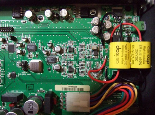

I changed the coupling caps to Auricap 2uF/200V. They are about the biggest fitting above the headphone jack ( I used hot glue, and attached them on it). I don't recommend a lower value in the V2 DAC1 with the 1000uF stock couplers because I saw less impedance in the following stage than the 99K that RDF saw in his V1 (with 22uF stock couplers). Auricaps have long flying leads that make it practical to replace the stock caps and find a place to attach them too. I believe that the certain space and position led other tweakers automatically to Blackgates. I don't know if BGs are the best for that because the Auricaps unlocked the DAC1 with so much balance and sweetness that I doubt any special lytic can match.
There is so much resolution and balance in this Benchmark that the stock couplers are a proven bottleneck as it turned out.
After the Auricap tweak, music unclogged. Slam, sweetness, resolution, highs, imaging, and everything really, unleashed but stayed locked and lost edge and grain. Sibilance is natural now.
I don't find DAC1 needing anything more after that. Since it retained its balance and did not transform. It merely unlocked.
For those seeking to change the DAC by changing op-amps and the like, I recommend very careful one by one steps. Because as I listen to it, its perfectly balanced for a broad musical spectrum. The wholesale upgrade that the Auricaps bring is much noticeable over headphones too. My Grados sound like ones again. Slam and sweetness is back. Much needed after 2 long nights of live music on a mixing desk 20m from a splitting loud stage.
I give some pics about the simple tweak.
