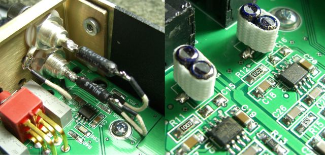

Hi salas. A quick update, replacing the output connectors with Audionote silver wasn't a scorching success. At this stage the DAC1 had the 100uF BG N-types as above and 150 ohm Mill resistors in series with the output bypassing the stock SMD resistive divider. To my ear it went dry as Death Valley, pushing the overall balance light and playing havoc with sibilance. Once again the change was so irrational I was checking and rechecking wiring and solder joints.
With extended listening the realization occured it was the same sound I thought had been partially addressed by adding the double 0.1uF BG N bypasses. Yanking the older, red BGs and replacing them with an extreme opposite, 0.1uF silver micas from the junk box, confirmed them as the cause. Dry is one way to describe is, slurring esses with a 'sshhh' texture is another. It becomes harder to differentiate the natural differences between male and female sibilants and fricatives. No wonder these caps are so divisive.
47uF BG NX Hi-Q which had been charging at ~2 volts for a couple days were next and a definite improvement. The top-end texture was reduced but still more than I want to live with. Replacing each with a pair of parallel 0.47uF BG NX Hi-Q was another jump up. Now the texture is audible but not at the level of being offensive. Bypass those with 0.1uF BG NX Hi-Q pairs made little difference so I left it as-is for now.
You're probably wondering, if I find the top end so inadequate why stick with them? Well, first because I bought them and want to see it through. 😉 More importantly, in most other aspects they're amazing. With the sum changes movies, nearly all recent movies, seamlessly fill the room ahead of the listening chair with sound. The sense of space is massive. Minimally mic'd musical recordings capture a great deal of that. Multi-mic'd pop mash remains a clothesline of sound from speaker to speaker so I'm quite certain it's not an 'enhanced effect'. Top of the list though is through the midrange down sounds can have a spooky, almost disorienting sense of realism like nothing I've heard. Elsewhere Jonathon Carr calls them 'coloured but spectacular'. My hope is that the smaller BG packages are more suited to the low offset voltage in this position (again, going entirely on the manufacturer's say about a charging requirement) and that with time the top end coulration will tame itself. From what I hear throughout the rest of the range it's worth the wait and see.

Thanks again for suggestion Bob! The pic below shows the mods so far (Mills wiring is temp until I decide on a final config), minus the Blu Tak. The sleeves around the cap pairs were used to hold them for soldering and I just didn't bother to remove them.

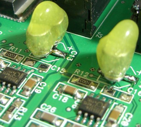

Bobken looks to have hit on another way. His recommendation was taken to an extreme by skinning the caps, cleaning the metal surfaces (only!) with methyl hydrate to assure a solid stick and encasing pairs completely in standard epoxy. See the not-pretty pic below. The sound remains spectacular and the colourations drop through the floor. The only quibble I have with Bob's original description is it's too cautious. Damping these things would appear to retain all the positives while removing huge swaths of texture top to bottom. The sound is now incredibly detailed and fast-fast-fast without punishing you when the source material gets rough.
I'm not going into elaborate much because it I know how daft it sounds. However, taking advantage of the flu and a day off work I listened to a number of very familiar recordings for the first time since these mods began. The different microphones used on various tracks of the Cash recordings, for example, stand out in bold relief. Yep, hearing things I've never heard before after hundreds of listens too. The overall sound is far more natural while differences between recordings are far more obvious, which has one downside. The Benchmark DAC1 has a reputation for being a 'space master', throwing huge soudscapes. At this point I think it's part colouration, a combination of an overall dark resentation coupled with fast transients that come out of the 'black' (which to my mind is another, popular, colouration.) These mods will reduce the depth of image of typical multi-mic pop recordings to pancake flat if that's how it was recorded. Conversely dual or simply mic'd recordings in natural spaces blow the back wall out better than ever and heavily DSP'd movie surround tracks reproduced over two speakers take the rest of the room with it. (Yes, I know how that sounds.)
All in all I'm delighted with the results and more than glad to leave cap-skinning behind and return to biasing, load lines and harmonic spectra. One caveat, the mods I describe relate to the V1 version of the DAC1 only. From salas' measurements later versions have lower interstage input impedances and require much larger cap values. On the other hand V1's can be had at fire sale prices now, a tremendous value when combined with $50 worth of parts.

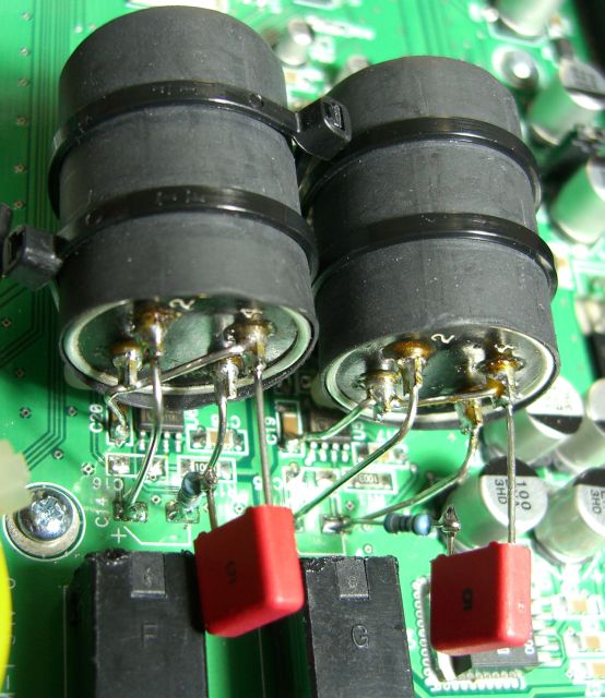

Hi salas. Thought you might enjoy the next experiment, transformer coupling. In decommissioning one of our broadcast facilities I found a pair of UTC Ouncer isolation transformers. The impedance ratio is 600:500, an early concern, but a 5532-full M-Audio Firewire had no problem generating very impressive numbers from it. Installed for testing below. At maximum SPDIF input level THD worsens to 0.012%, IMD to 0.007%. The output RC network was tuned on the bench for flat to 100 kHz response, mostly used to pull down a small peak. In other words from any know measured criteria for audibility the UTC is transparent in this application.
Interesting contrast to a cap for sure, especially since this change halves the number of coupling caps in my playback system. At first I thought the small DC trickle current on the primary was causing a bottom end roll-off in such a small trannie but it's 0.5 dB down at 10 Hz. Not as razzle-dazzle as the BGs, cleaner up top, movie surround effects opened up again. Unsure if they'll stay yet, if not it'll be more for system matching reasons than lack of performance.
