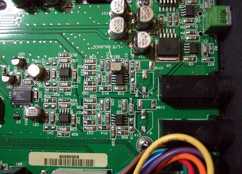

Finally ordered caps...went with Sonicap Platinum .1uf for the digital input and Sonicap 3.3ufs bypassed with .1uf Platinums. Little Christmas present for myself. Then get these to my guy who is doing the solder slinging...I'm not too confident with SMD and surface mount boards. We are doing everything but the opamp and regulator swap.
Was still torn between the Black Gates and the film caps...rolled the dice on the film caps right now.
I have the BB 2107s, but when/if I do opamps, probably will be the AD 8599s.
Oh, and special thanks to Danny at GR Research for the advice on the caps.

The stock caps are a real compromise. It really unlocks with good films. Here is where 'upgrade' ends. After that, 'modification' starts.

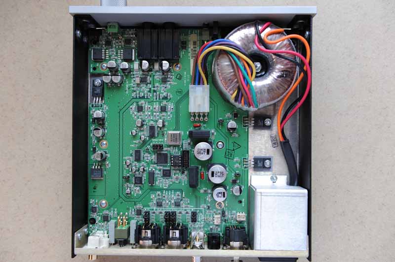

I have a Benchmark DAC1 USB (purchased a few months ago).
I'm thinking of doing a little mod. Is a 2uF Auricap still the best recommendation for changing the bypass cap? I doubted that changing opamps or power supply caps will have as big of an impact as your change.
I'm attaching the internals of the DAC1 USB.
PS - I found that this little DAC is very sensitive to the powercord. I tried 5 different cords and get 5 different results! Could the power supply section be the weak link to cause this sensitivity to the powercord??

Given its sonic traits and successful marriage I would still recommend the same cap type. I don't see a photo with your post. If there was space I would use more uF.
It has an excellent layout that helps the very strong power supply rejection. Maybe because its so silent you hear more. I would not modify the psu unit, it becomes a new thing. I would just find the best wires combination.

I'm uploading the internal pic again, as the first one I uploaded is probably too large and the server rejected.

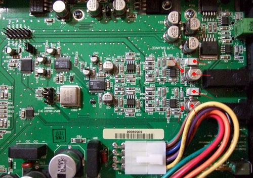

Can you detail the steps on which caps to remove and the solder points? I gathered they are the caps near the headphone jacks?
Where do I find 2uF or larger Auricaps?

Look at page 5 of the thread, I have detailed pictures there. Yes these are the caps to remove. 1000uF ones next to the headphone jacks.
Google for Auricap vendors.
Mate your power cable after you substitute the capacitors, because the harshness will go and the mating will be different.
So I need to remove 4 caps and replace them with Auricap, 2uF 200V each?

There are 6 caps missing in the pictures. 2 smd lytics an 4 smd ceramic bypasses.

Haven't tried them. The clarity gains for substituting the digital input caps are secondary to the main coupling caps substitution. I have used SCR tin foil there.
