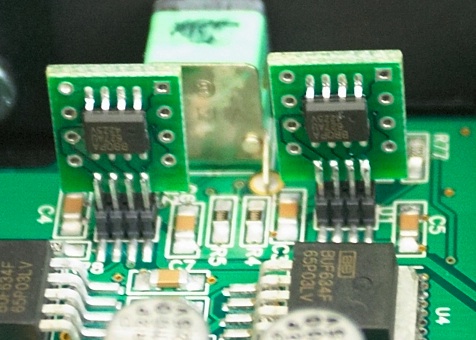

salas, did you upgrade your DAC1? I consider upgrading the opamps to OPA627 (by using single to dual adapters from cimarrontechnology.com). What regulators would you suggest instead of 78xx?

After replacing 2 opamps (in the headphone of DAC1) with 4 OPA627, three people noticed an improvement by using a pair of AKG K701 headphones. I would say the sound is more "liquid" with a better transient response (and not "thin" at all). I did not expect such a significant change since several opamps between the DAC and the headphone amp have not been replaced (yet).
As soon as I will receive the other parts (black gates and CREE CSD06060A), I will do the full replacement of 11 opamps, caps and rectifiers.
Attached is a pic of the OPA627 mounted on browndog adapters in the headphone amp section of DAC1.
