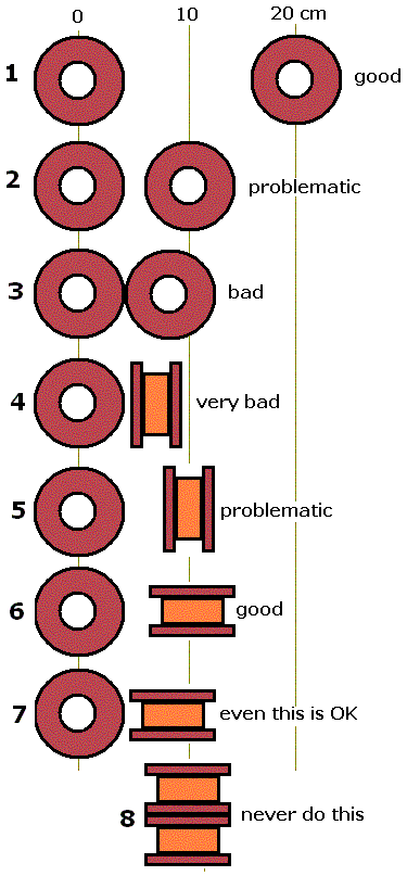

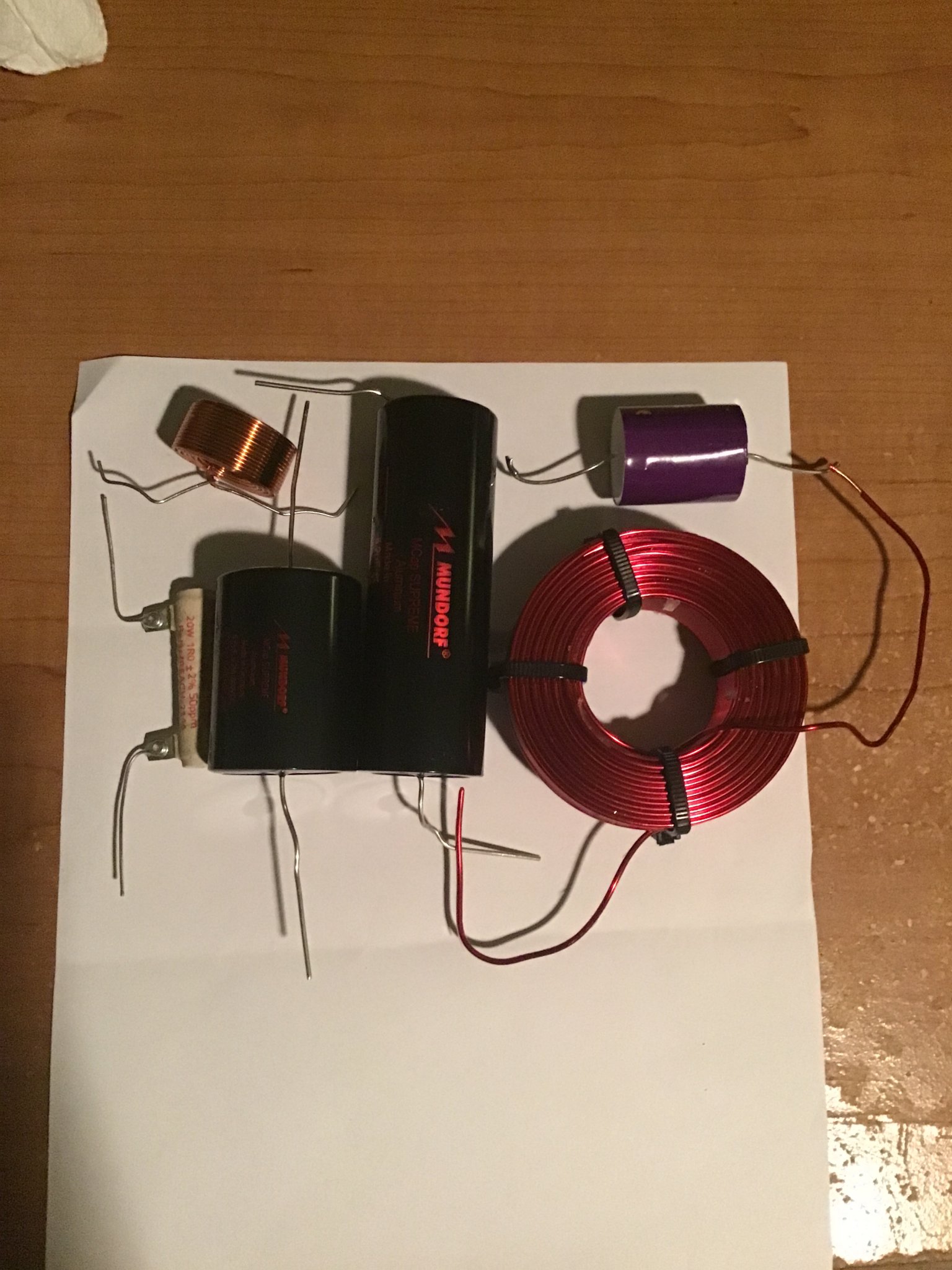

Back to your external crossover board component arrangement.
I would keep the bass components separate from the treble components to minimise any interaction between the two sections.
And I am sure, because it will get warm in use, that you will space the resistor away from the capacitor.

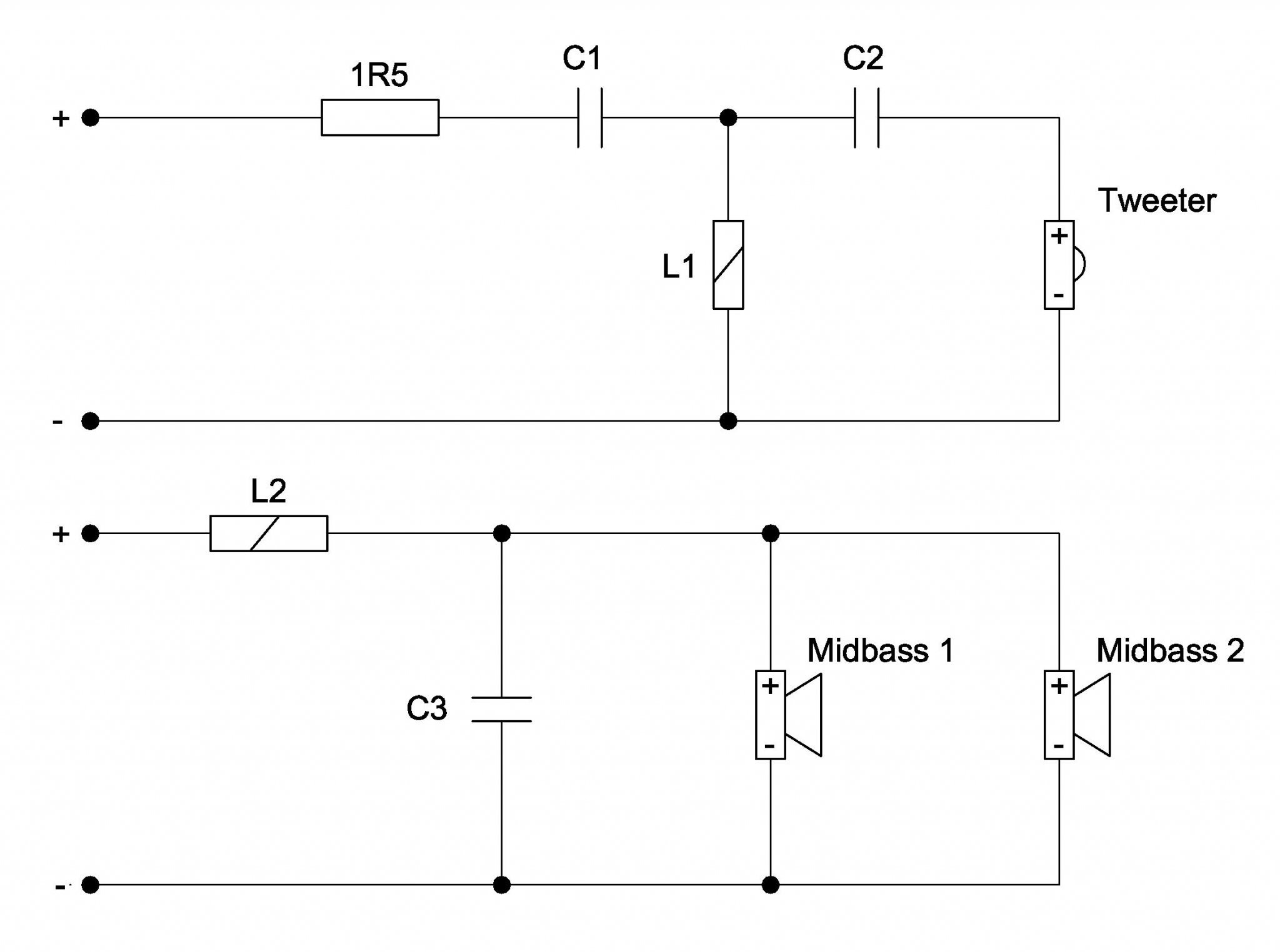

Reactions: tone?

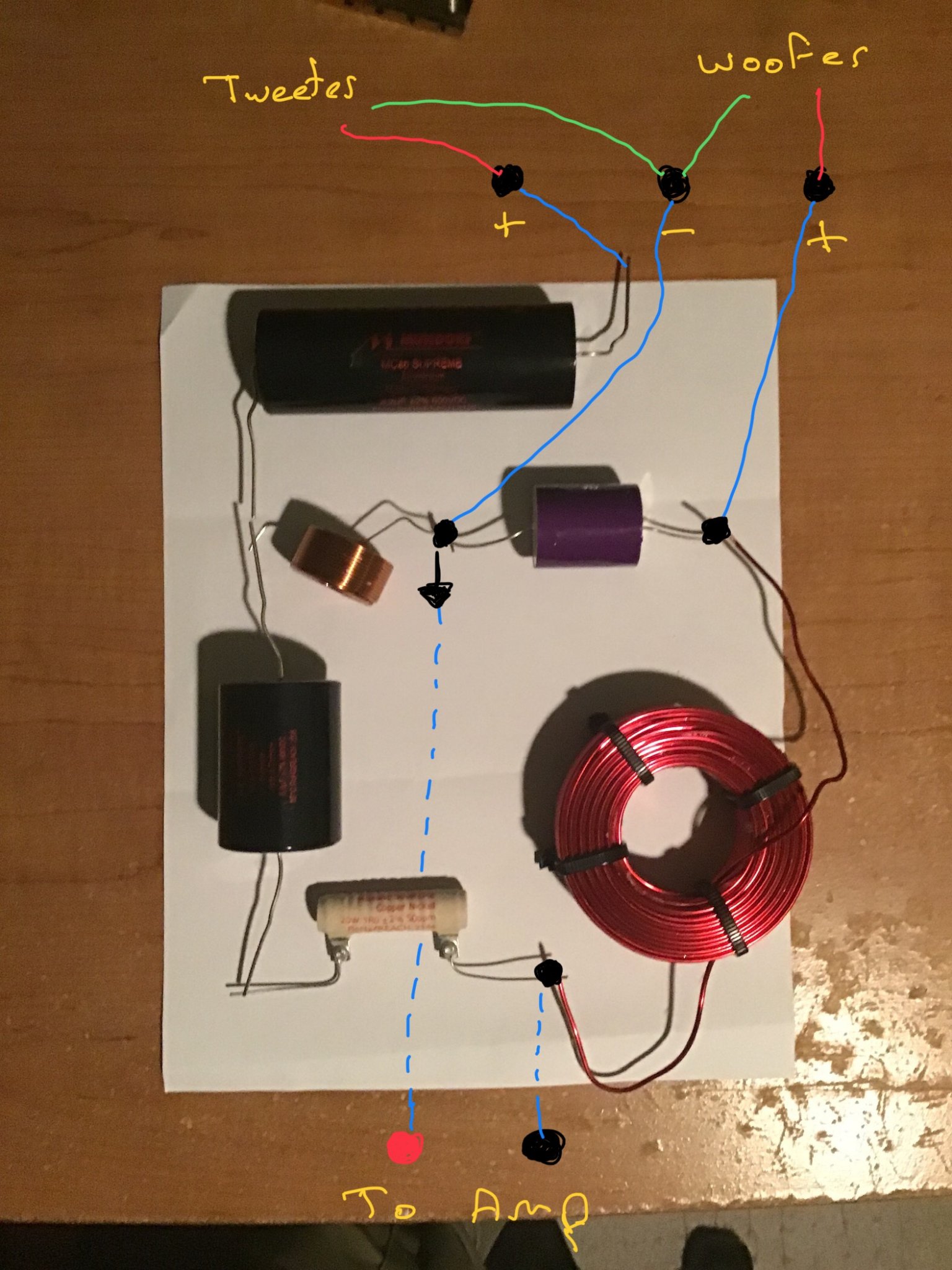

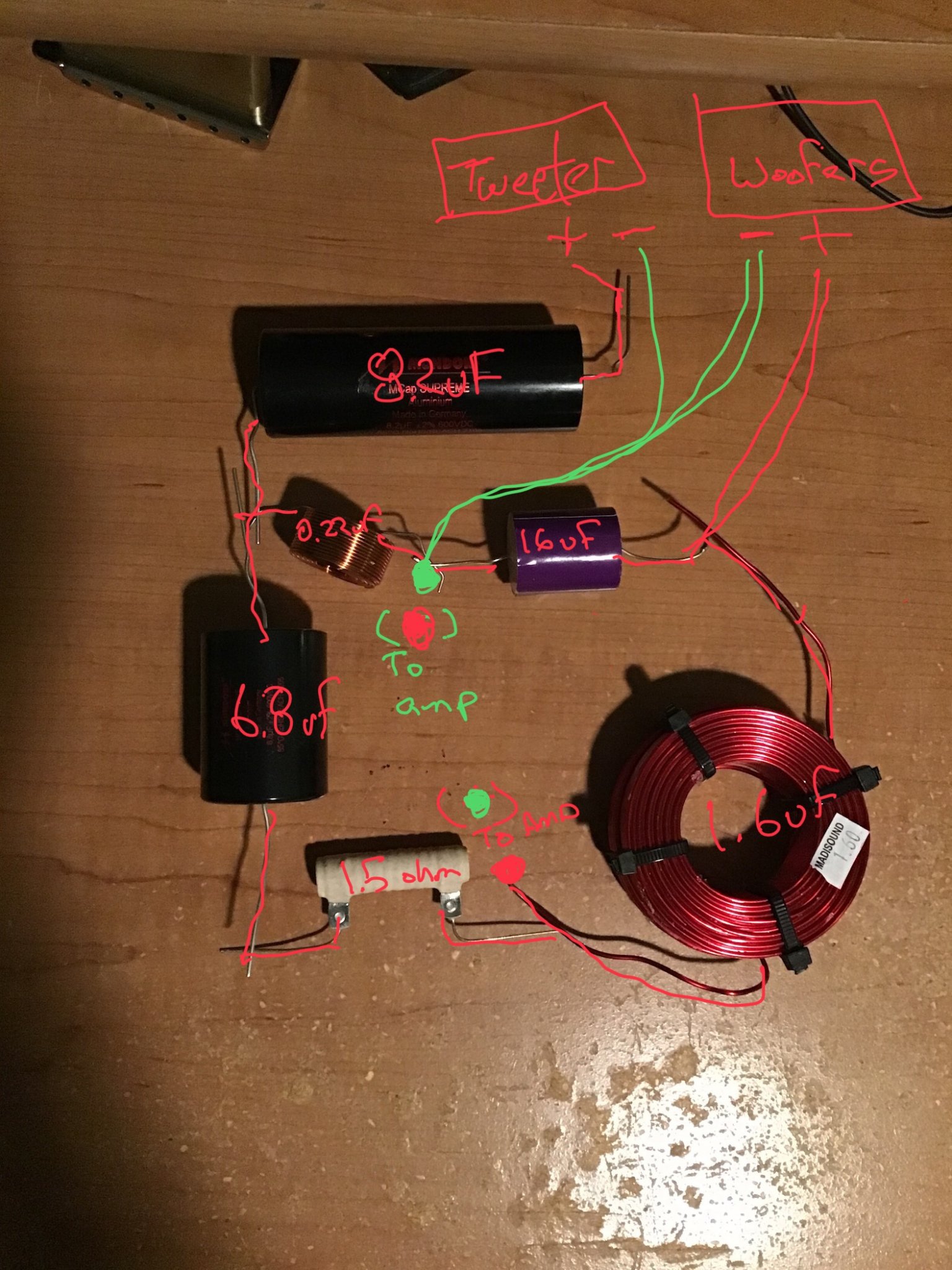

I'm attaching the iteration with the component values marked.
The component arrangement looks OK to me, a humble amateur speaker builder.
Get the small coil totally 'horizontal' of course.
Reactions: tone?
Not in my humble opinion, but others may have pertinent suggestions.
P.S. I only commented on the layout, I have not checked that it is all wired up correctly.
An updated crossover schematic, indicating the polarities of the terminals and drivers would be useful.
i.e. Can you revise the attached crossover schematic for us in the light of the previous polarity discussions?
