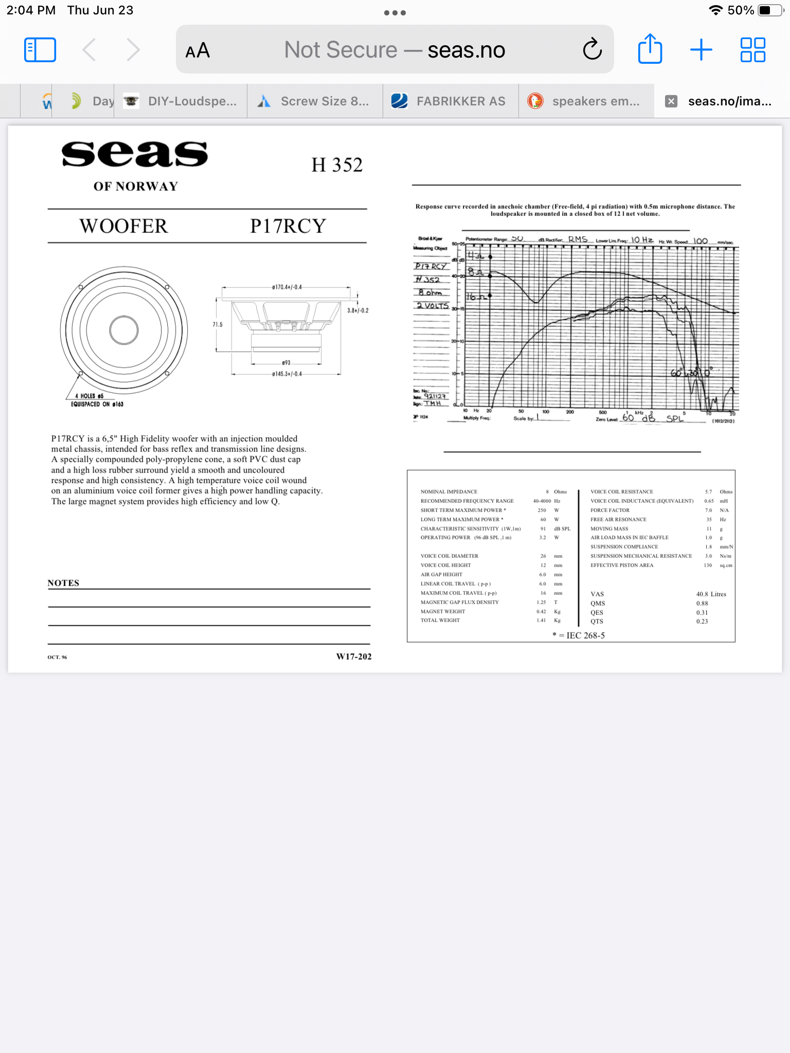

yes my drivers are very very smooth and have hardly any resonances. They roll off very smoothly.

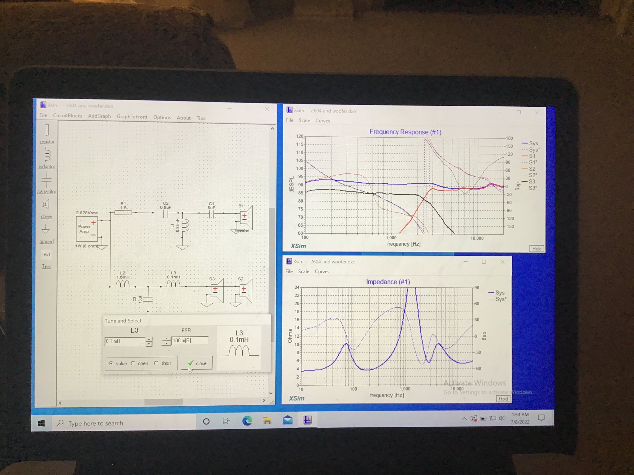

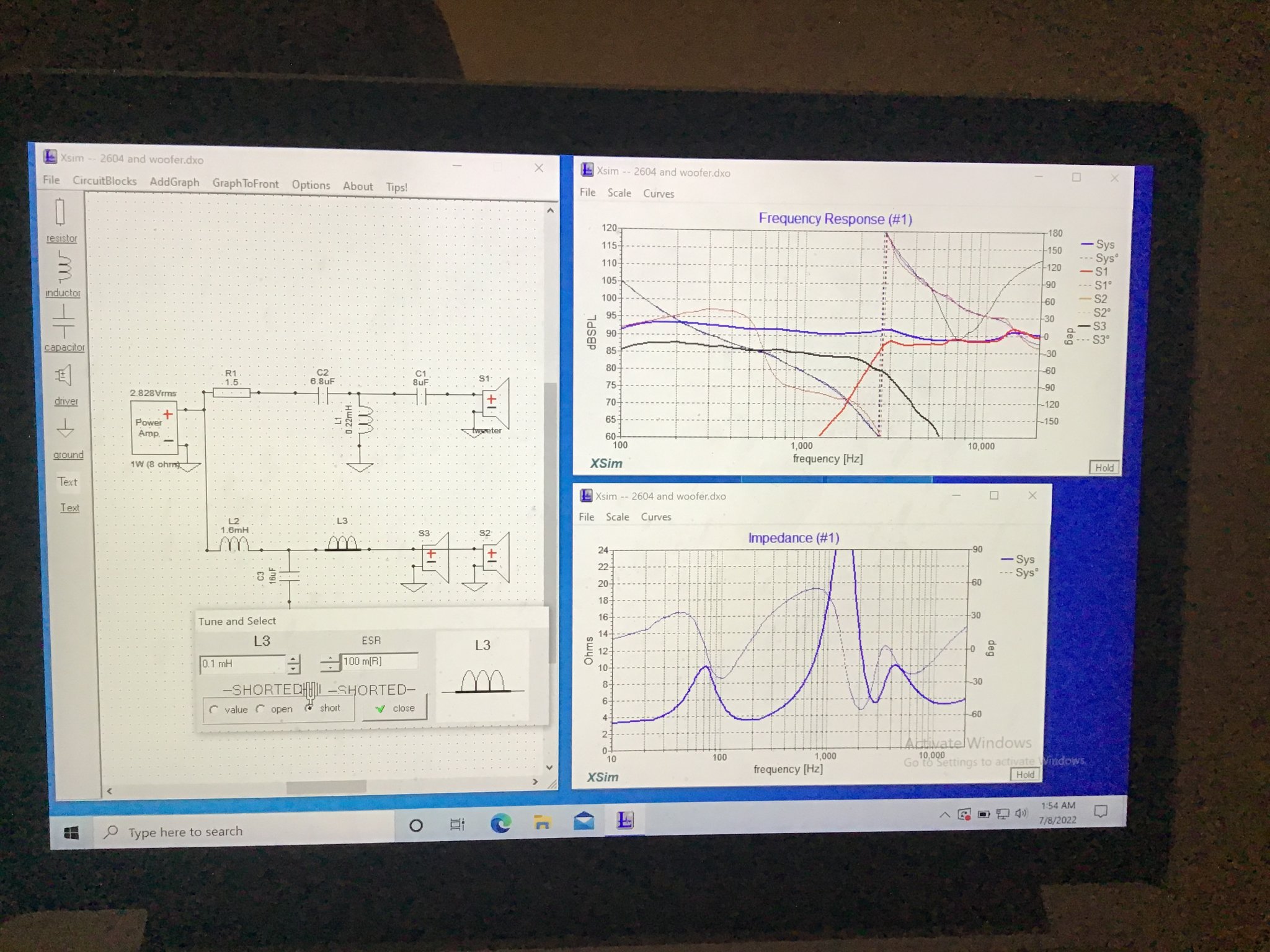

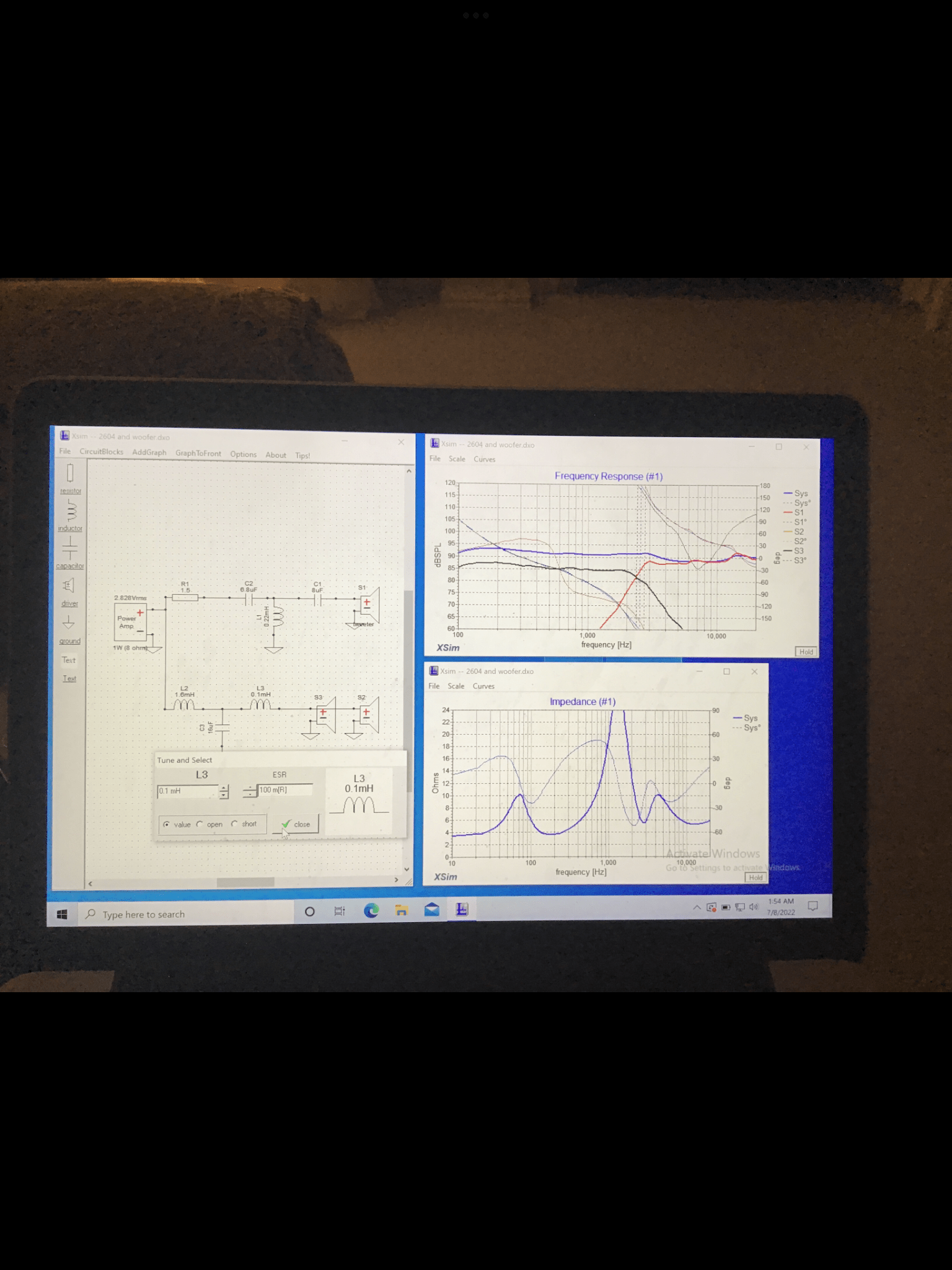

here is what I was thinking of trying.
adding a second inductor ( 0.1uf) in series in the woofer circuit.
one pic shows it will the added inductor and the other shows it without ( stock).
of course this is a simulation. But I see that the second inductor makes a steeper rolloff and a ‘ tighter, cross.
I want to see how that sound.
super cheap to try.

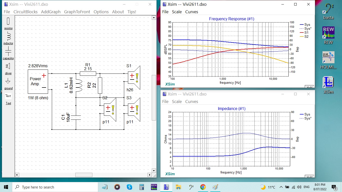

This is what a 1st order series xo looks like, it's a different project with different drivers but the idea is the same.
Actually I think if you try your speakers with the same xo values as per that file the result will be quite good. Then you can optimise.
Of course if you want to try high order filters go ahead and do it. I've been there and done that, long, long time ago.
you mean if I add the second inductor in series in the woofer circuit as in the pic I attached With the component values?
this one?

not at allyou mean if I add the second inductor in series in the woofer circuit as in the pic I attached With the component values?
this one?
look carefully at the files, completely different topology although electrically they behave in a similar way
