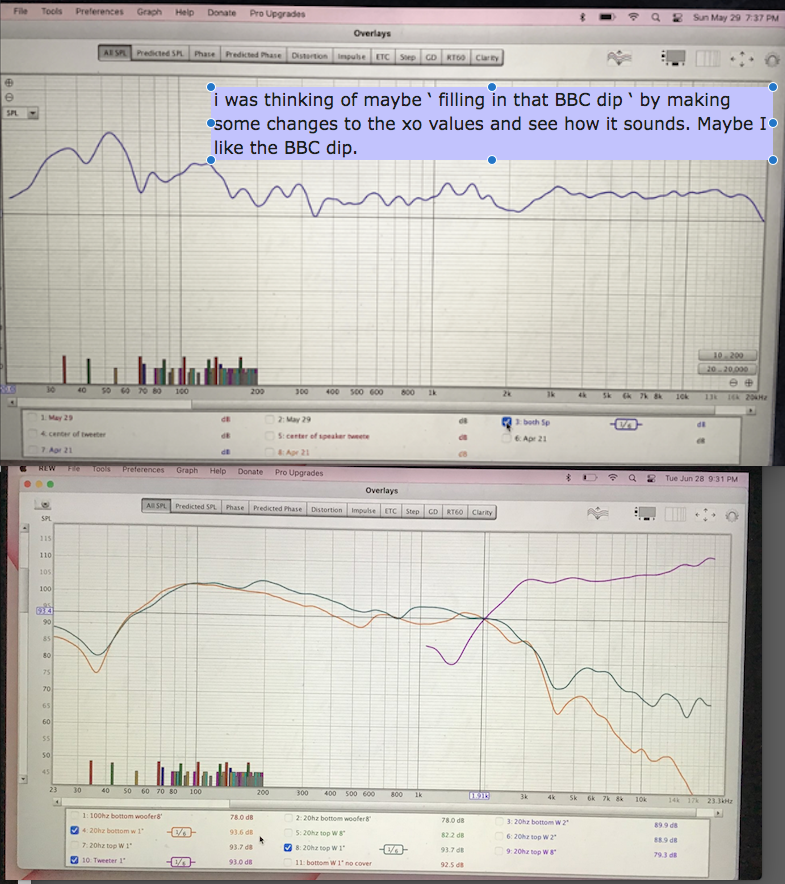

And that interaction of woofers and tweeter really, REALLY matters. As Proac might (and should) have optimized not only on axis response, but power response and lobing too, you only should mess with the crossover if you’re prepared to do the full set of measurements on and off axis. You can import that all in VituixCAD and optimize further. But don’t go changing component values randomly, judging by your ears. They will fool you.
thanks so much Mark
i am in reality making once super minor adjustment.
i don’t want to make major changes because as I mentioned I already like the speakers. Just small small adjustments.
Arent MTMs one big plus having a great dispersion which solves a lot of lobing no matter what order filter you use?
that is what I have read and how it works.
i understand and you are correct that to make any changes I would have to take many measurements. And possibly have to buy something like DATS v3 so I can take accurate impedance sweeps of my actual drivers.
From what you posted previously, it appears your speakers are not summing flat on axis around the acoustic crossover point, which may be destructive interference. MTM lobing... you may be calling that a "BBC dip".what do you mean about separate wires for both woofers and experiment with that?
yes they are separate.
you mean make slight variations on one woofer ?
2kHz appears to be roughly the acoustic crossover point, there should be no dip at that point.
Rather than slight variations, I'd suggest rolling off the bottom woofer an octave or two lower.
That could level off the acoustic crossover dip, and also reduce the peaks in the 1000 to 1600 range.
IIRC, you have purchased new coils and caps, using series or parallel combinations you have enough parts for (near) endless possible combinations.
Putting two coils in series side by side, or on top of each other opposite winding or the same direction gives three different inductance possibilities without any unwinding. Putting steel bolts in the coils adds inductance- for low volume testing (or apartment volume...) there is no worry about core saturation.
Measure, listen, compare, have fun!
