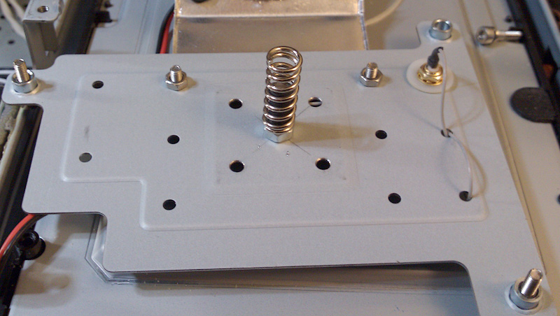

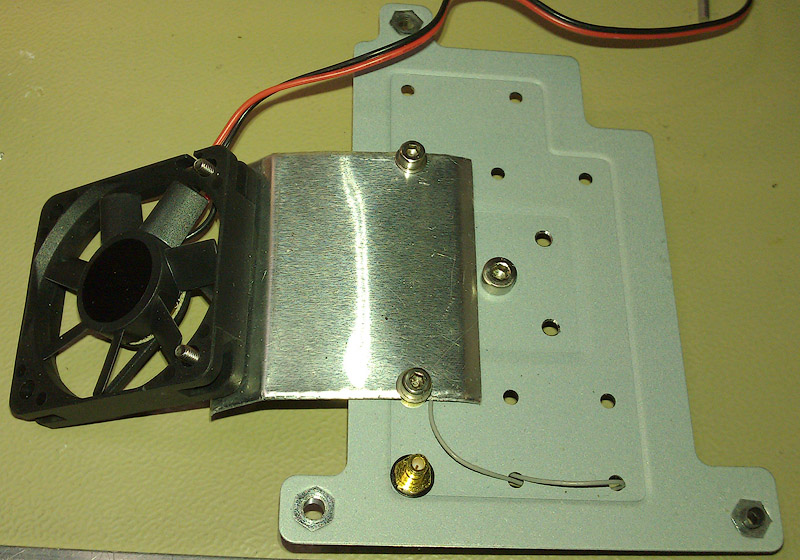

Hello people this is my first post
Found this post very enlightening and in fact I think oppo company should hire some of you, at least Cory for sure as most surely this r&d would benefit from your findings as well as us the end customers
I will be getting a 95EU soon. My main concern will be fan noise / trigger.
Incidentally I thought of the fan controller even before I found this post as I have one of those to control my computer psu, made by thermaltake
Will not be doing (not knowledge on electronics at that level) or hiring big mods at first, but being an IT person used to build my own computers I would like to just replace the heat sink (no one would use a plate with thermal stickers on top of a cpu that is a fact) with the setup you conceived Cory

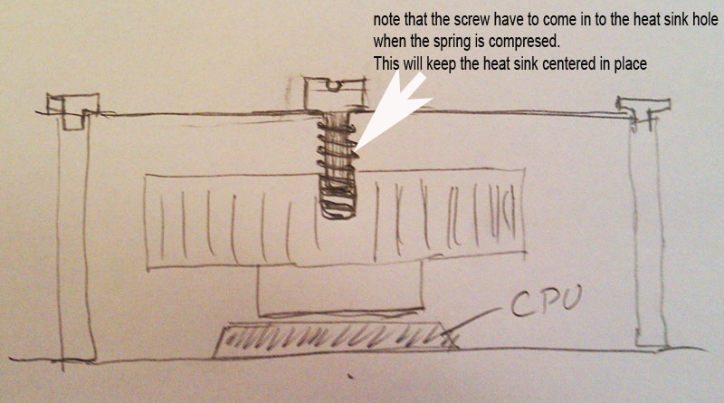

From a photo back up I see you raised the plate to accommodate the larger finned (makes sense) heat sink so I´d like to ask you this if you please (thks in advance for the great concept):
- which heat sink is it, any brand ref / model, which cpu is it for ?
- did you use thermal compound or thermal self adhesive stickers ?
- are you pushing it in using the plate as pressure point and some threaded metal headers ?
- how are you able to pressure in the heat sink center ?
- how did you get those threaded headers or where from ?
- a parts list would be most helpful !
- Do you have any idea where is located on the board the temp sensor that triggers the fan ?
- For the fan speed/voltage regulator what did you have to bypass to not trigger the temp sensor, if any ?
Dont know about the quality of the stock fan but maybe will also try to find a higher grade ball bearing fan or higher flow/lower speed one, what do you think ?
sorry for all the questions and thks in advance for you help
best rgds
Nuno from Portugal

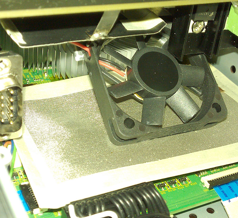

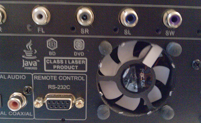

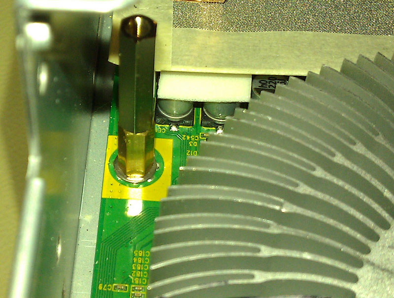

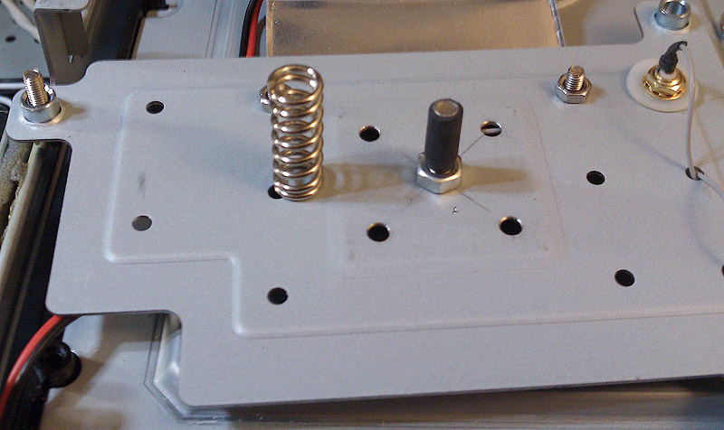

Maybe I made a mistake, I see now you where able to up the plate because you do not have the top board anymore.. but still hope to improve the heat sink anyway..
Hi
Yes, the fan is to be a quite big concern... It had also an well audible noise for my ears, from that original Oppo`s fan... Is just not possible to enjoy the music with that running... The original one is not running all the time, but when is running is to be heard..
First action to get rid of the fan noise is to cut that cover in front of it (as to be seen in the picture). The cover in front of that fan generate much turbulence in to the air flow, and then generate the noise... Cutting it that out will help much to lower the noise of that fan.
The temp sensor for that fan is inside the main CPU... Here is something stupid from the Oppo`s designers part. They chosen to run hot that CPU to make it easy to trigger that fan to run it... So, that fan run only when the CPU`s temp is to high. This is very often... And this fan do not help very much at all to cool that CPU.... This make that it is a quite high temp inside the BDP95 box. If you will install that heat sink on the CPU first, you will notice that the fan do not run any more... This is bad too! It have to be ventilation inside that box....
So, that fan it have to run all the time, but in that way to not be audible.
To make it running all the time, just disconnected from its connector, and coupled it to a dedicated power supply. I used an very small (but enough power) consumer PSU (which is to be coupled in to the wall). Removed its plastic box and installed that small transformer (it have to be that type PSU with transformer, not a switching one!) inside the Oppo`s switching PSU (as to be seen here in the picture). Is enough an such 6vDC PSU for that fan. Is better to use also in between an "fan silencer" from the computer world. In this way just set the speed of that fan so to be efficient at the lowest (disturbing) noise. As is to be seen in another picture, I have now a second fan coupled in parallel with that original one, through the same silencer, to ensure the air flow over the CPU heat sink. In this way, the ventilation is very effective inside the box. The fan for the CPU heat sink is set to an lower working tension than another one, only for assure a movement of the air inside the box, over the CPU heat sink. I`ve used also so called low noise fans for both (not ball bearing ones). Quite easy to find those as computer spare components.
When about CPU heat sink, I used an P4 processor one. I think is possible to use another type so long is good for that place/space. You know? Those Oppos`s designers intended in the beginning to use an such heat sink for that CPU. The board is designed to this! There is good place inside for using a such heat sink over that CPU. This heat sink have to be "adjusted" a little bit to not come "in conflict" with the flat cable/connector beside... Is not difficult to cut it as in the pictures. One have to find a spring which is accordingly to the purpose. I used one from an old computer CPU cooler system. Make a hole, a little bit bigger (0,5 - 1mm) than the spring diameter in to that heat sink. Just in the centre of it. Is to be noticed here that the presure of the heat sink on the main CPU do not have to be very high. Not to low either... It is difficult for me now to say how much... Just enough😉 I`ve used that spacers (pictures) to assure the right distance for the (original) plate, to have the right pressure over the heat sink when the screws are screwed in completely and the spring compressed (a little bit). Note that the screw through the original plate (which will hold in place the spring and the whole system) have to be right in the centrer of that plate. You can see in the pictures how to find that centrer... In this way the whole system is placed right in to the centrer of that CPU surface.
One have to take in to consideration that the heat sink keep its position quite good when whole the air in between it self and the CPU is out (when pressed). Yes, is to be used cooling compound here. Just use that compound only before final mounting. Note that is quite difficult to take out the heat sink after it was pressed in to the CPU chip, and is not any air in between... I think one can understand quite well what about from those pictures.
VERY IMPORTANT: connect your self to the ground in one (good) way to avoid ESD problems with the components inside the player, when is to tear it down. Care match about this aspect!
This modification (and another) void the warranty of your player!

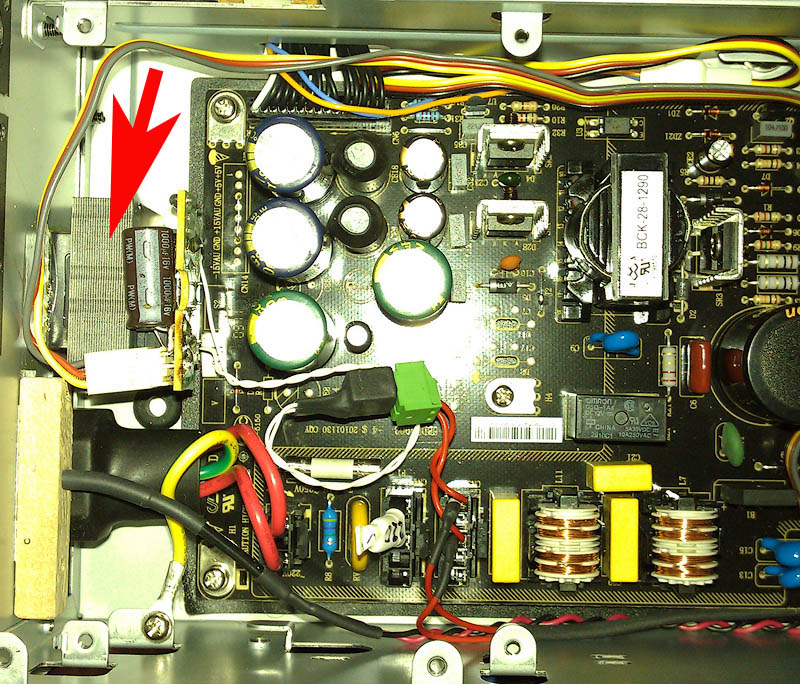

My guess is the rotel power supply dos get warm too, right ? I suppose it has to, these electronics are made up to work in an ideal temp which is warm of course
Could you comment just a bit more on the last posted photo with a drawn arrow, is that an additional heat sink fo the ac/dc stage area, or the condenser close to it? does it get warm ?

The analogue PSU dedicated to the audio board of the player get warm. Is normal that the components with heat sink do it so. The abnormal thing here is that get warm the capacitors involved in this PSU. This is bad and is about design faults. Or the Rotel transformer is not well dimensioned to deliver the necessary power... Or, anyway... I just removed that power supply and the famous Rotel transformer. I have my own designed PSU with an R type trafo for the audio board. It work much better than original one. It`s work normal I mean...
The last photo shows (the red arrow) where is the PSU/transformer (as described in previous post) for the fans. That`s all. There is coupled the speed controller for the fans. Is no any warm problem in this switching PSU. Here is only to be changed out some capacitors to have a quite big impact in video/image stage of the player.
