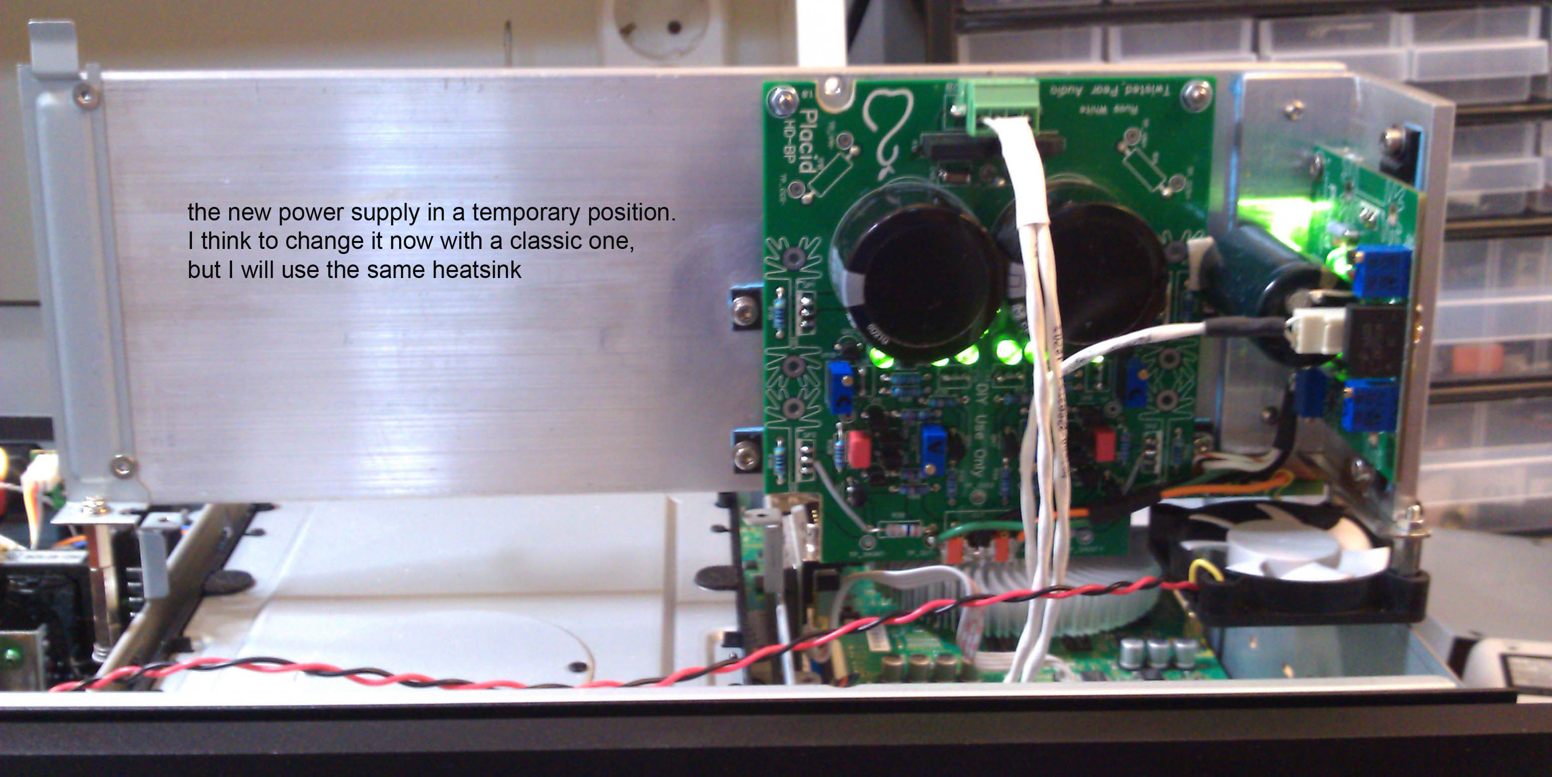

You know? I just removed it...It is possible I will use it again, but modified accordingly...
I`ve used instead the Twisted Pear shunt regulators power supplies. I replaced too the Rotel toroid, with two separate toroids. It was fine to have the Rotel trafo in his place, but I need 3 AC sources (for +/-15v PSU and +9v (12v).
Those TP shunt power supplies are very good, but it seems that are not quite in right place in this case. They get too hot for the volume of this player enclosure. So, I think I will go back to the classic regulators as primary PSUs, and then I will use shunt regulators locally, near every stage. I think this is a much better solution, and a less heat dissipation.
Please note that in case the original PSU is changed with another one, one have to simulate the signal used by Oppos designers to give to the main processor the message that the power is OK, or something like this (I`ve not investigated yet this very close. I have other priorities...). This signal is an 1,5v DC level (OVP-test). I`ve used an potmeter to create this level from the 9v new PSU. Is not necessary to be exactly 1,5v. It works well for me even with an half of this level...

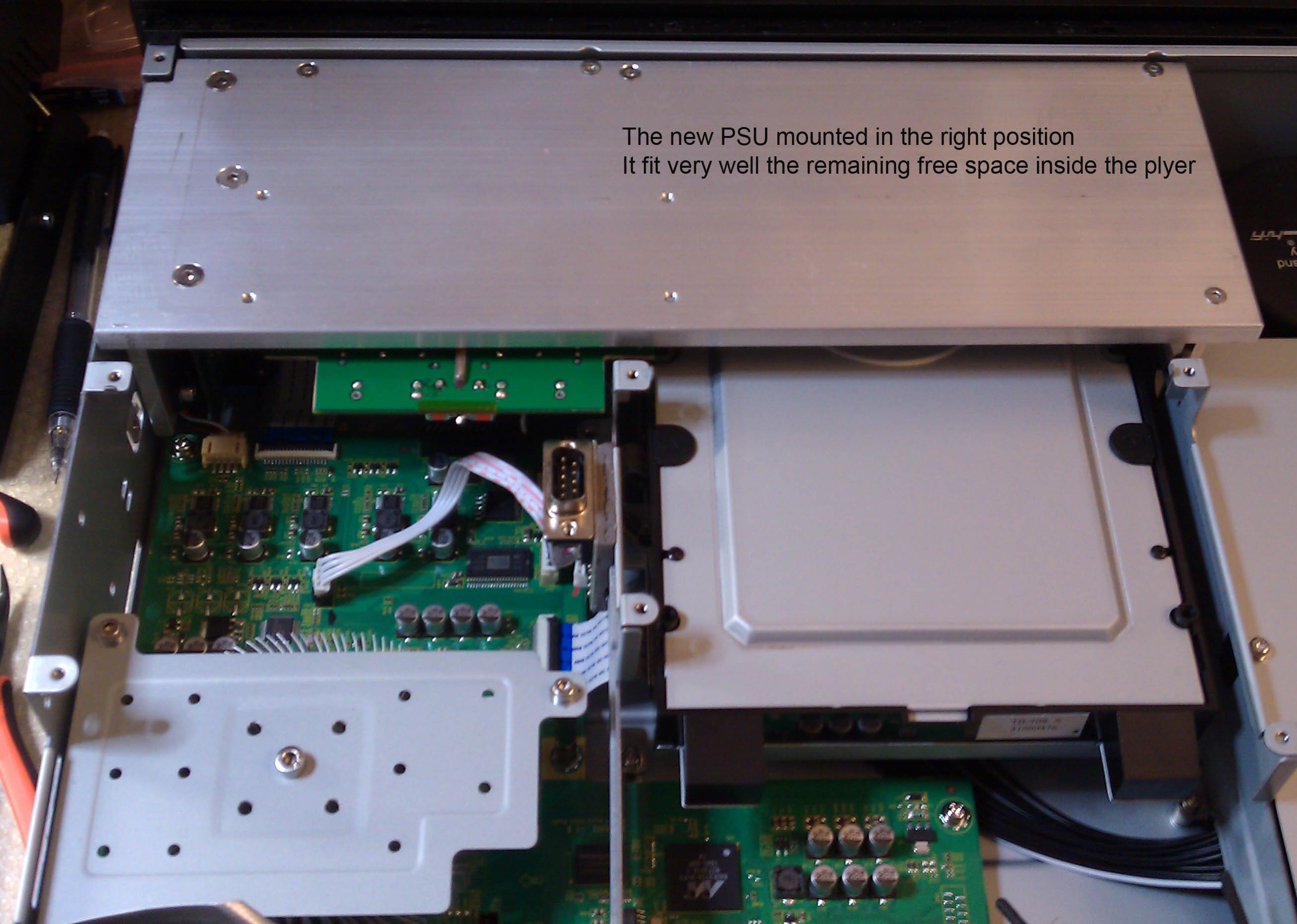

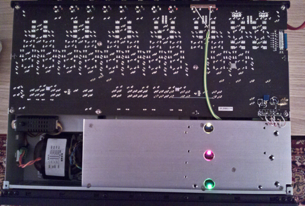

Referring to my previous posts and attached pictures.
I have to say that I`ve abandoned the idea to use the shunt regulator power supplies for my BDP95. At last two of the earlier pictures here do not reflect the reality for today...
These shunt power supplies are good enough, but not in this case, when the enclosure is quite full and the ventilation is not adequate for such heat dissipation.
I just build it from scratch two another (serial) power supplies based on LM2991/2941 and placed then on the same aluminium plate. I found an R core 40W transformer which deliver 2x15v/9v AC. I have now +/-15v for the output stage. I used the on board regulators, modified for adjustable output, and I feed the I/V stage with +/-12v. +9,5v for the rest.
These new power supplies provide a very good stabilization and the temperature on the heat sink do not exceed now 28 degree. This is very well! Before I had to struggle with 50 degree...
With a fine tuning of these supplies and right set up for the offset level in I/V stage, I have now an offset on the RCA output as low as 0,2mV.
I think now that the best solution for power supplies in this case is to use as primary supplies the serial one, and have local shunt regulators right beside every stage involved in audio processing (digital/analogue).

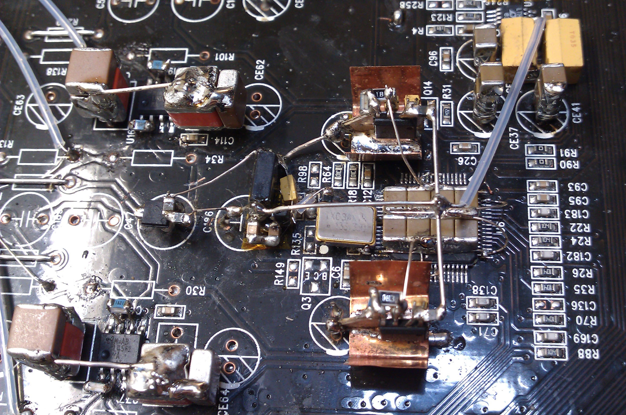

By the way, I use now a 133,3 Mhz clock for ESS9018 and local shunt regulators for AVCC of the chip and an shunt regulator too for the clock oscillator. The I/V and output stages are also modified...
Now, the finally result of the audio stage is not so easy to describe, but in one word is just unbelievable.

I`m using TL431 and schematics are right out from the datasheet. Nothing very special this time. But I have to make a correction referring to my previous post and after reviewing my papers... I actually have been using for ESS9018 - AVCC two low noise regulators (L/R) based on MIC5209, also schematic from datasheet. In my opinion, very important is decoupling/bypassing capacitors soldered closest as possible to the load/chip pins.
