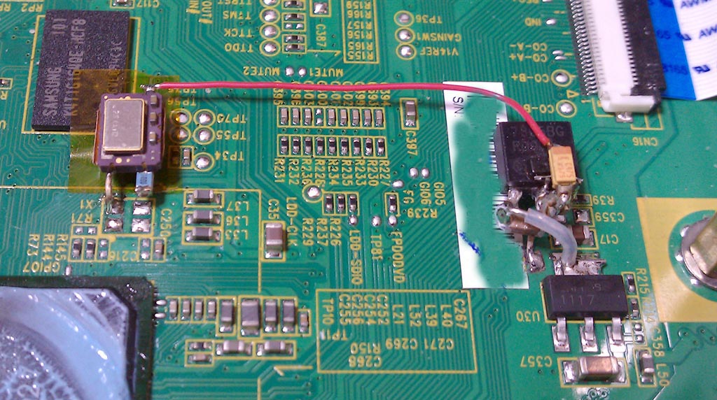

Oppo 93 - simple starter power supply mods all on the Power Supply board
a) add 1 of 3uf X2 rated 275 VAC UL listed cap to the AC line filter - drill a couple of small holes to mount it on the board next to one of the original AC filter caps.
b) get rid of the undersized original electrolytics on the power supply board
- replace the main input cap with 30 mm diameter 220uf /450 VDC 105C - add a 600v .01uf film bypass under the board.
5 volt supply - replace all 4 electrolytics with 12mm diameter 3300uf /16 vdc 105C
15 volt supplies - change all 6 caps to 12mm diameter 2200uf/25 vdc 105C
bypass all 5 of the 5 and 15 volt ouput caps with small .1uf film caps underneath the board.
Change the 15 carbon film quarter watt resistors to cheap 1% 1/4 watt metal films - no need for anything audiophile here
Change the 7 large electrolytics on the audio DAC board to whatever value Elna Silmic II fits the diameter and voltage rating
Now you are ready to play with clocks and improved local regulators

If you want to re-clock BDP-93, then the Master Clock (25MHz) has to be done.
The NuForce Extreme upgrade adds a second clock on the new daughter/audio board.
For the BDP-95 it is a different situation on paper, but in reality not so clear. But it does what the NuForce does to the '93, Oppo has added a second Xtal clock 54 MHz.
What is not so clearly understood is that if the very best clock available, then the HDMI and other digital clocks can be improved markedly - not just the analogue outputs.
But back to BDP-95, I have replaced the 25 MHz Master Clock and you most certainly can hear it even if the 54 MHz remains unchanged (and you hear it on all outputs, digital too - some even tells me video output is also better). But I do intend to try re-clocking both.

I have a '95 here with the 25 MHz mainboard Master Clock done. I now have in mind to do the 54MHz, but I have an 80 MHz oscillator I will use.
I suspect on it's own that doing 54/80MHz would make a big of difference, but I also suspect that the improvement will be less because the 25 MHz clock has already done and already brought a significant improvement.
As I said before, this is not totally understood, but we have done this in the past with other players using similar arrangement, and yes, we don't fully understand, but we do it because it gets the results we want.
Cheers, Joe R.

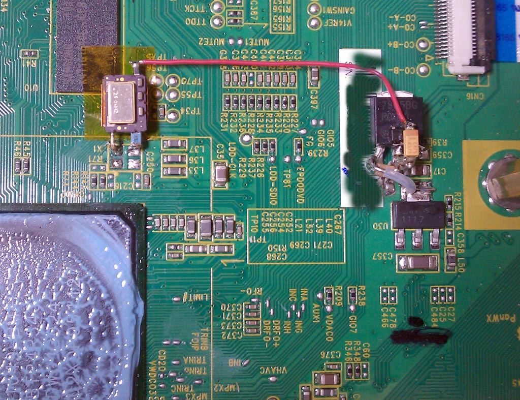

I have now fitted two clocks on the BDP-95.
I have the 25MHz on the main/digital board and now replaced the 54MHz on the daughter board with an 80MHz clock.
I can attest to the fact that doing both clocks makes a significant difference.
Did you used something special oscillator as replacement for that 54Mhz one, or an standard one? What about to use an f. ex. 125Mhz clock in the place of that 80Mhz? Just try it...
A couple of things...
I used the Terra Firma Power Supply and it has a limited max current it can provide. So adding an extra oscillator presented a problem.
Most oscillators require increased current as the frequency increases. Just look up a few datasheets and you'll find that out. But I was able to source an 80MHz oscillator and measured 17mA - so that was just low enough to get by.
BTW, the chief purpose of the power supply is to supply low noise down to even sub-1Hertz - and this is even more important than the quality of the oscillator itself (but not recommending rubbish here). We've found that doing both clocks is necessary.
Cheers, Joe R.

You can feed those oscillators from dedicated power supplies... I didn`t get exactly what you refer about problems because extra oscillators. It is also the best to build an dedicated power supply for that oscillator you want to use, in that place it have to be used... There are many low noise chips/regulators which can very well do this job.
Else, I just heard the sound difference when used in a DAC an 100ppm oscillator, and when used an 0,3ppm oscillator (with the same frequency and the power supply). I can tell you that is huge...

The new clock supply has a totally independent power supply (even has its own power transformer wired straight to the IEC AC Input) that in this particular instance takes 30 Minutes to come on. No, nothing of the player's internals are used. And both 25MHz and 80MHz oscillators are our choice and wired in.

IT IS RIGHT!
Changing the main clock 25Mhz of the main processor, leads to a big general improvement. The biggest improvement is in the image/video quality. A big increase in gradients, tonal details, colour details and details in general in both pictures and film/video. A big surprise!
Not at least a big improvement in sound. The same, more details and wider sound stage. More volume in the sound. Is hard to define... The clearness of every single sound is astonish.
I`ve used an so called standard oscillator, but a high precision one. An 0,5ppm from Digikey. Very low noise single chip 3,3v regulator dedicated to the oscillator and feed it from 8v original regulator as seen in the pictures here by.
I still have an 125Mhz clock on the audio board (ES9018)... It sounds just superb!

Many people do this already. Look at the last pics of Coris's DAC. A ton of large value ceramics directly on top of the DAC chip.
<SNIP>
Question for Coris actually... what capacitors, make, model, package, and value, did you use for bypassing on top of the DAC back in post 49?
THANKS!
Greg in Mississippi
THANKS!
Greg in Mississippi
Hi
I`ve used in that place quite normal ceramic capacitors 100µ/6v. Is not a very special capacitor model/package in that case. I will not recommend to use an only one (big) capacitor for decoupling. A pack made of many small caps as shown in the picture is the best way...
Else, I`m not so satisfied about that arrangement right on the top of the chip, because the chip get warm a little bit, and that type of capacitors are not so happy to get warm in that way... But is quite difficult to find a better position in that design.... It think now that is better to mount the capacitor pack 1-2mm above the chip, not right on the chip.
I have now there 2x1000µ. The picture is a little bit old now... There is improvement in this way, but is not spectacular, if the another mods are not done yet... If we talk about this particular case (BDP95). The best over all result is when decoupling in this way too the I/V stage and specially the final stage... One can see a also the decoupling on I/V stage in that picture. For I/V stage I`ve used tantalum caps 220µ/20v (the orange ones) together with ceramics (100µ/16v). The tantalum caps (very low ESR) are a better choice for the I/V & final stage. Local regulators (with appropriate capacitors) are a must of course in this case, for best result.
One have to take in to consideration that large decoupling capacities mean some problems at power start up and shut down. There is a large start up current for the regulator (if a local regulator is use), and a large energy which left stored in that capacitors after power down. An adequate local voltage regulator with current limit protection will solve this very well.
This decoupling do not represent a issue for the main power supply.
If you want to go this "decoupling" way, you may want to do the another important mods before this one. This should be my choice, but you can of course chose another way...
Nice to hear from you about the finally results...
