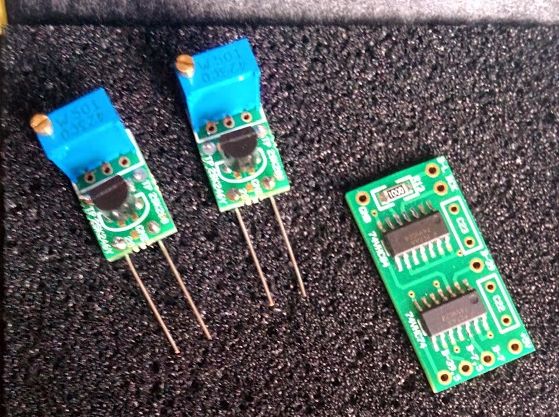

Welcome Bas,Look what the mailman brought!! Thanks Enrico.
Glad to know that you receive your parts

Hi Enrico my CCS boards arrived as well, thanks very much.
James
