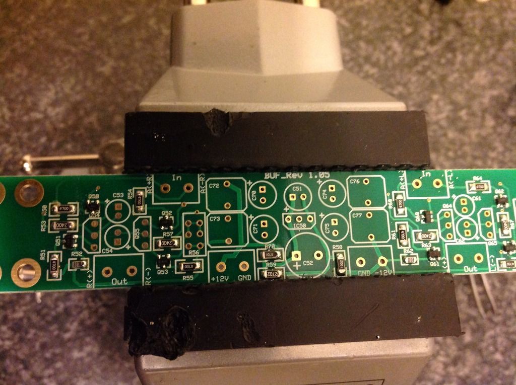

I wonder how you, Ross, fixed JFETs to test them. I have got about 100 JFETs with the idea to test them for IDSS but they are so tiny so I have no idea how to fix them in place to test. What are resistor values for CCS Board , btw?
Can someone please advise the total resistance used to set the current in CCS?
If you go in the first page at the post #2 carlsor is explaining in detail the values needed for both the Jfets that can be used in the CCS circuit.
Enrico
zz1969
It appears that you purchased 100 2SK208 JFETs so post #2 isn't going to help you much.
You will have to test each JFET to determine what source resistance will give you 0.40ma at 2.4V. You can always install 470 ohms in the fixed resistor position plus a 1K bourns trimmer pot which should work for over 90% of your JFETS if they are the "O" type. Adjust the pot until you measure 0.188V across the 2 TP points.
If you bought 100 JFETs with the idea of finding matched pairs or ones that would work with one or two SMD available resistor values without a pot - you have created quite a task for yourself.
I bought and tested 325 of these using a 6-pin SOIC fixture that I bought on ebay for about $35. I set up a breadboard and PS to provide the 2.4V and a way to measure the 0.40ma. A pot is put in the source position and adjusted until 0.40ma is obtained. Measure and record the pot resistance.

Buffer Oscillation
I have been in communication with persons whose buffers went into high frequency oscillation using a remote power supply. Symptoms are a hard, brittle sound and DC voltage measurements that don't make sense.
Now that I am back in Illinois, USA for the summer I will buy one of the "economy" power supplies that many of you have been using and try to duplicate the problem. I will then look for solutions to the oscillation. I have a scope here which should make this easier.
