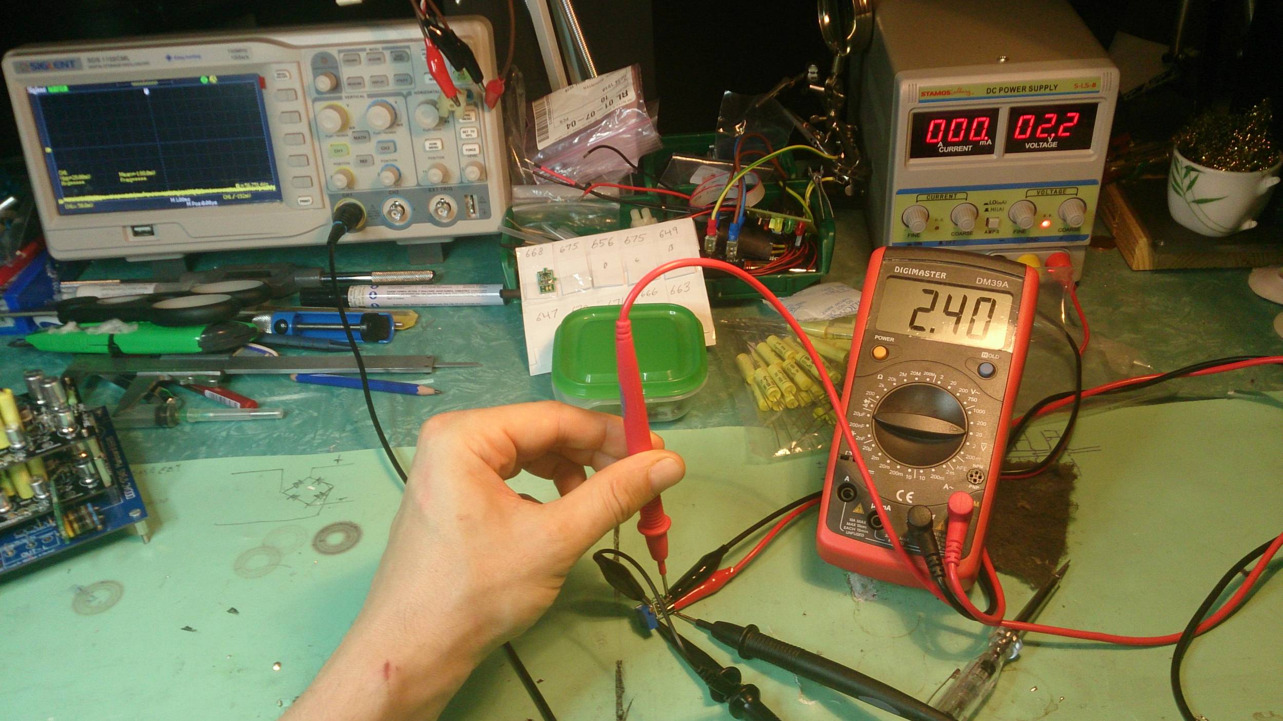

New dac boards to be mounted, so new CCS to be made. This time we do as the book says 🙂. Any tiny voltage peaks you see on the scope come from my mains. Don't have separation transformer for my bench yet. This small CCS board gives current smooth like a silk!

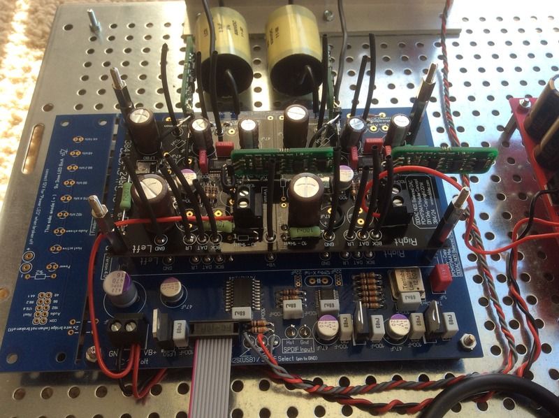

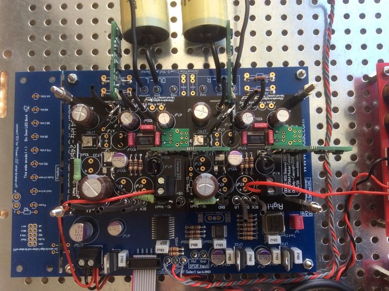

I can see you took your time and effort to find fixed resistance falues for CCS. Second dac board for Cinemags is a must, don't wait too long 🙂
Update
Ups, I thought that were cinemags but are caps. I hope this will change soon too 🙂
Update

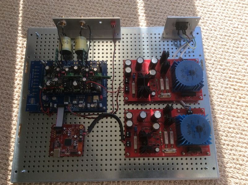

Thanks and yes second DAC board is being built now as adding and why you see the black wires poking up like you did 😉
Also cinemags are here too and can't wait to try. After that is done choke PSU then case.
Ross was the kind man to define the CSS fix resistors and he got it spot on thanks Ross!
