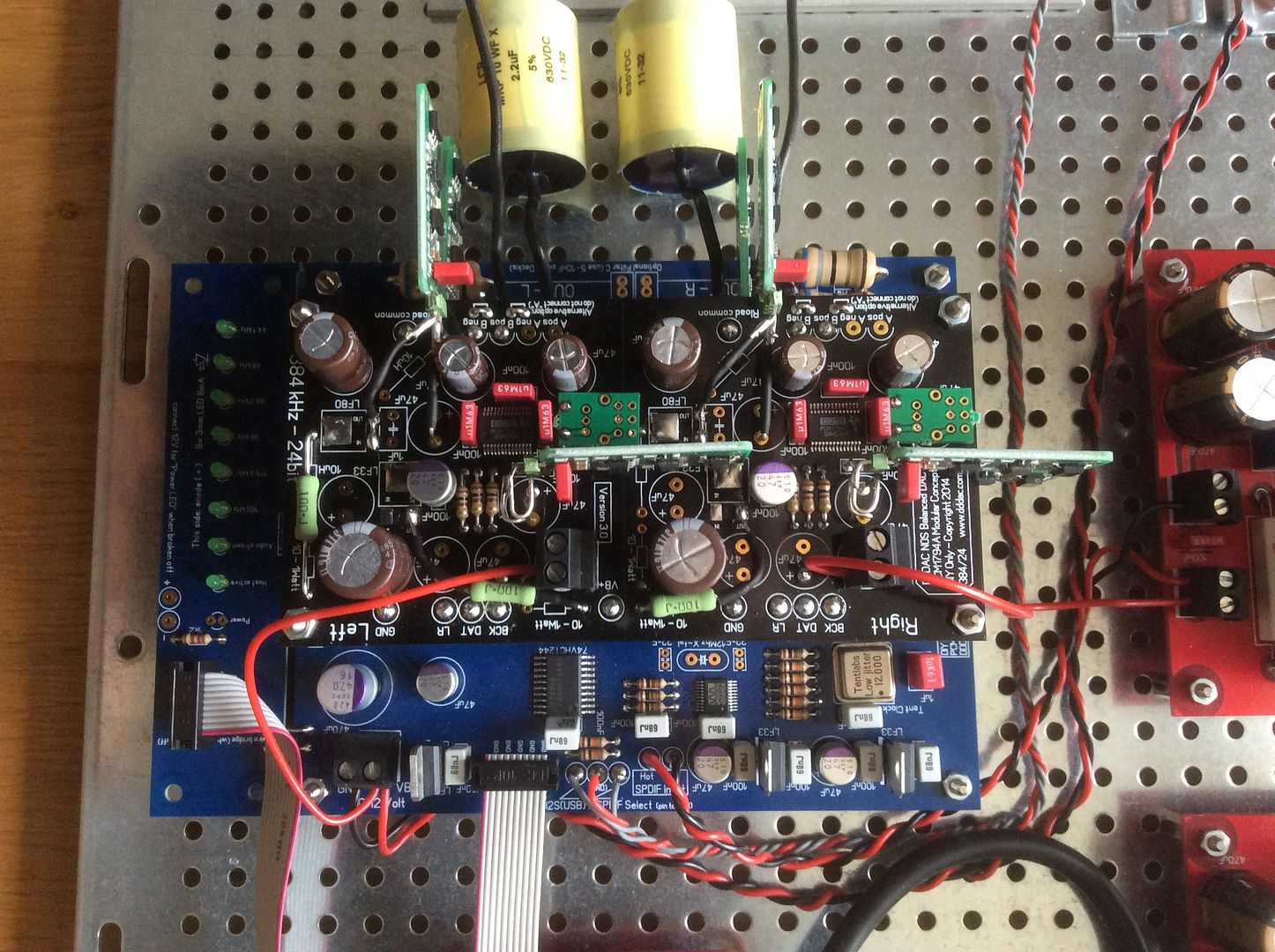

I got some brief time to have a look at my buffer board this evening and made a quick video of the strangeness.
https://youtu.be/F2EClf0rnrA
Can anyone suggest any reason for this behaviour? Both channels give identical readings. I have 2.81v dc offset between the pos output and gnd and also between the neg output and gnd, but if I measure between pos and neg I get roughly 0.7v. If I change the range on my meter I get a varying reading. I assumed a faulty meter, but I have another which reads around the same...
Any ideas or suggestions gratefully received.

Fixed! I tried a different power supply for the buffer and got the exact same symptoms up until I was unplugging it and removed the ground wire joining the buffer power supply Gnd to the star Gnd the other supplies share. But I knew from first fitting the buffer that it sounds horrid without that. So I clearly have a grounding and Interference issue. So I did a bit of reading around and had a couple of things to try and doing this fixed it.
I used a spare wire in my multi connector between the two chassis to earth the chassis to each other. I also added a 10r resistor in the wire joining the buffer supply Gnd to the star Gnd, just to provide some small level of separation. Don't know if that's technically recommended or correct, but it made sense to me.. And now it's all behaving nicely and I get to hear my dddac via the buffer for the first time in about 6 months. And it sounds full and glorious 🙂
This is more or less correct. As long as you are using the balanced outputs and not ground, the offset cancels itself out. 0.7V between outputs is a bit high though. That's the nice thing about balanced outputs: you can have a DC offset on both but you still don't have to use DC blocking caps on the output because it cancels out (as long as it's equal on both).
To further clarify, the PCM1794 will create DC offset in the I/V unless it is removed somehow in the I/V. The exact DC offset will be 4ma times the size of your I/V resistors, if you are doing passive I/V. Any mismatch between I/V resistors will cause a mismatch in offset, creating an offset between positive and negative outputs, like the 0.7V you are seeing.
Thanks Redshift, but the dc offset of my outputs after the i/v resistors was less than a couple of mV as my resistors are very accurately matched. The buffer issue I had was a grounding and Interference problem. Both my buffer outputs were showing the same dc offset voltage from Gnd, but were measuring as 700mV difference between them, which was varying as I moved my meter leads.
Since I sorted my grounding out, I've dialed in the dc offset to be less than 1mV between each pair of buffer outputs and it's totally stable.

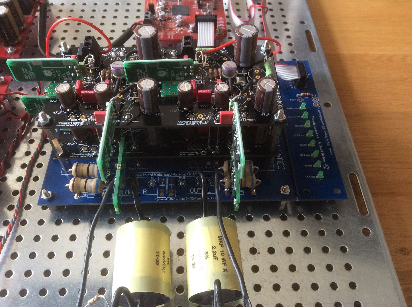

I connected the oscilloscope last night... the measurements clearly have shown (as Doede suggested long time ago) the need for little filter capacitors across DAC outputs.
With 4 decker version, I had best results with 4 X 0.01uF, each installed across Apos and Aneg, and Bpos and Bneg on both channels. These values will get rid-off all nasties, while providing negligible attenuation at 20kHz. For those really pedantic ones amongst us, the minimal attenuation at high frequencies can be compensated for in JRiver parametric equalizer. In fact, the curve can be adjusted to be perfectly flat from 20Hz - 20kHz.
The best place to solder capacitors is in fact on the top deck, i.e. not on the motherboard -> the attenuation of (what looked pretty bad on the oscilloscope) oscillations is much better if the caps are installed at the top deck, compared with the (0.01uF X 2) per each channel installed on the motherboard.

I installed the caps across pos and neg, and the effect was an immediate tightening of the sound. I hope someone can confirm this, as I have learned to be extremely wary of autosuggestion🙂
OK I just removed the caps and put them (a pos)>(a neg) / (b pos)>(b neg) as suggested.
Maybe I don't have noise problem after all, as I cannot be sure it has made any difference.
The caps I am using are Wima 4.7nF and I have a single deck DDDAC. Are those even the correct caps for this application?
