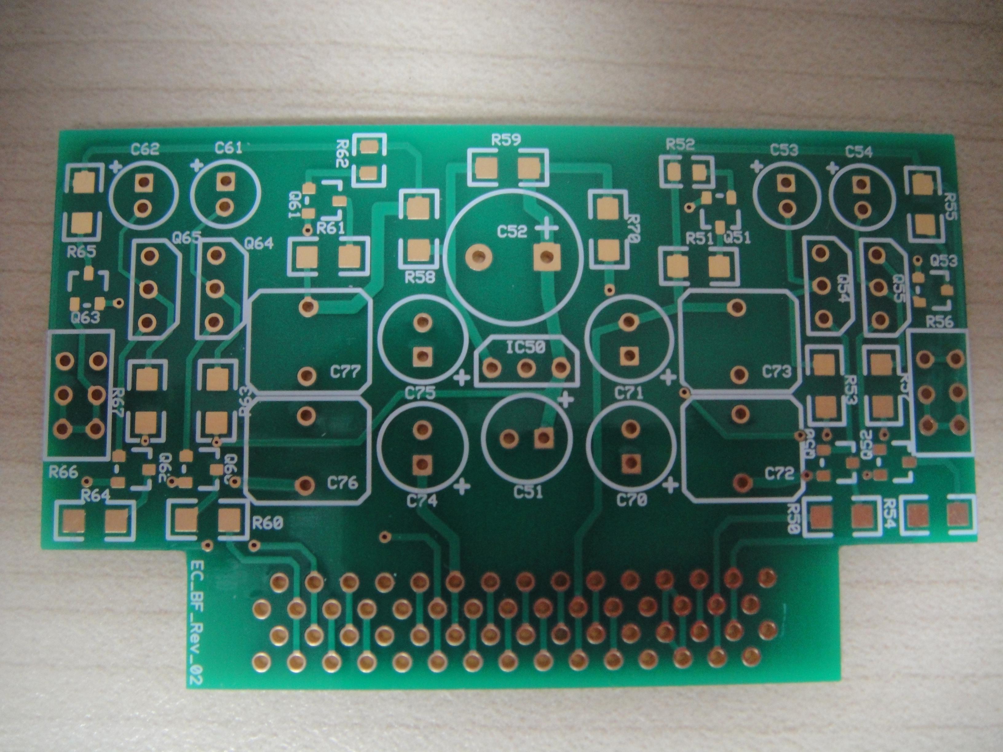

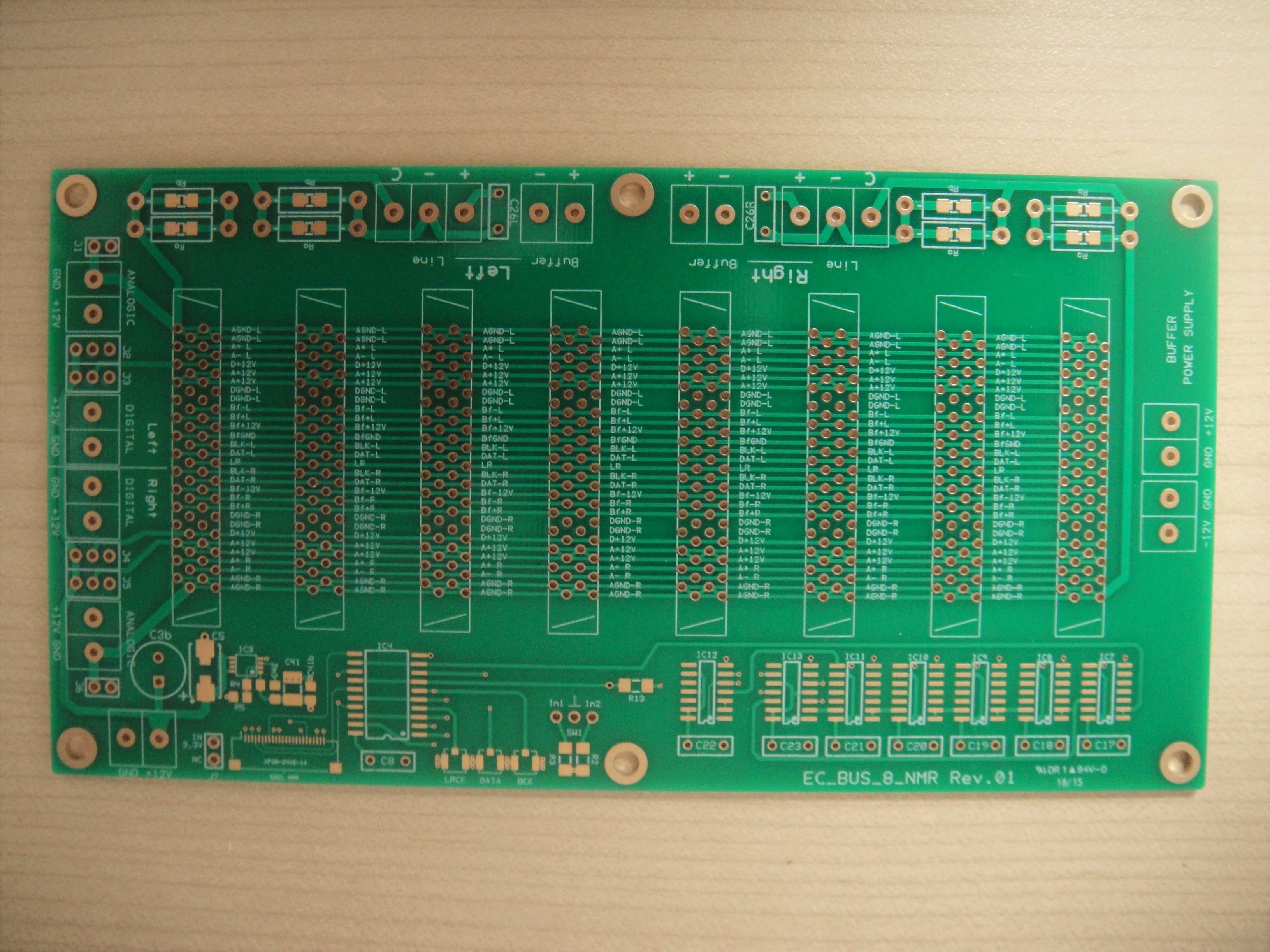

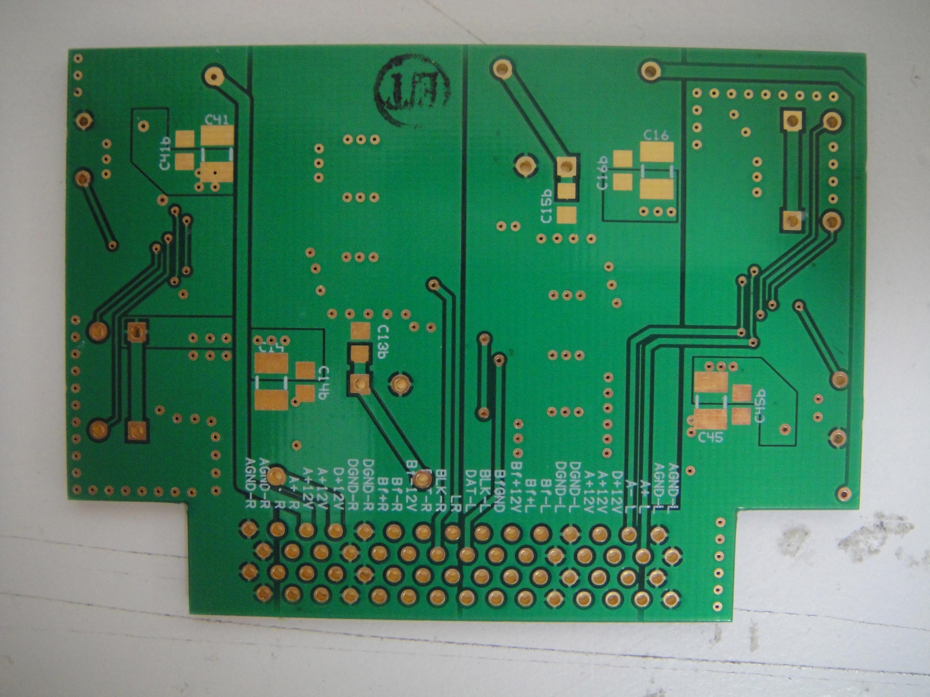

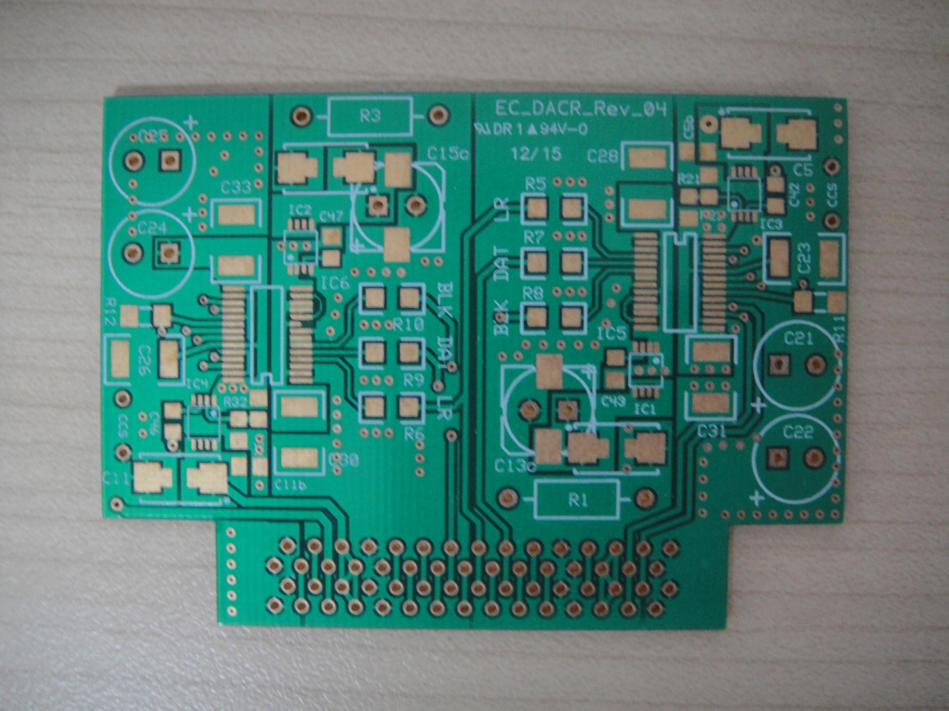

Attached are some more pictures of the motherboard, the DAC and the buffer boards
The main improvements in the motherboard:
- Dedicated LT1762 LDO for the 5V for the logic part
- Separated 12V for Analogic and Digital circuit of the DAC boards. They are optional through pin selectors. The 4 terminal blocks are in the left side (Left A-D and Right A-D). Each one of them can be selected through the J2-J3-J4-J5. I.e. you can choose to separate the 12V for the Analogic and use the Main 12V for the Digital or use only the Main 12V
- Option to separate the GND for the Analogic part through J1 and J6
- Dedicated terminal blocks for the + and - 12V of the Buffer (right side of the picture)
- Dedicated terminal blocks for the Buffer output
- Additional pads for the SMD 0805 SUSUMU as highlighted by Ross
- The 2 input are the 24 pins FFC connector for the EDEL and the 3 UFL connectors for the I2S.
- The bus connectors are the Hirose 60 poles FX2CA serie
The DAC board:
- The 4 GND (Left A-D and Right A-D) are separated. The Digital GND will be connected only to the motherboard. The analogic as I said above can be separated from the motherboard (only in case you use the separated 12V for the Analogic)
- 2 dedicated LDOs for each PCM1794. One trimmed at 8V for the analogic side and one fix 3.3V for the digital. As you can see in the picture the LDOs are designed right near to the VCC and VDD pins of the chip. In the digital LDOs there are different pads for the input caps. Linear D/S is very detailed regarding the decoupling caps and there are 10uF and 100nF X7R in the input and the outupt of the LDO. The output caps are installed in the back side of the board to be near to the LDO pins.
- Dedicated pads for the CCS circuit (the pads for 6.04K are still there , R11 and R12)
- Particular care to the distribution of +8V and +3.3V to the chip pins.
About the buffer board there in no much to say, is exactly the same circuit with same parts that everybody know.
I think that i didn't forget nothing... 🙂
