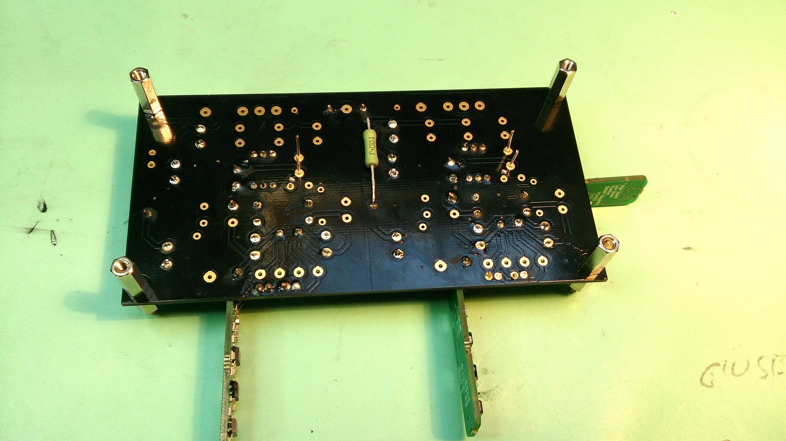

Very shiny, why did you out the two caps at the bottom of the board?
Thanks stijn001. These Kemet caps are little taller and wider than originals. On the dac board there is a resistor mounted underneath to accomodate shunt board. Resistor also is bigger than original and collide with Kemet caps in that very spot. So I had to move two of the Kemets underneath the mb as well.
