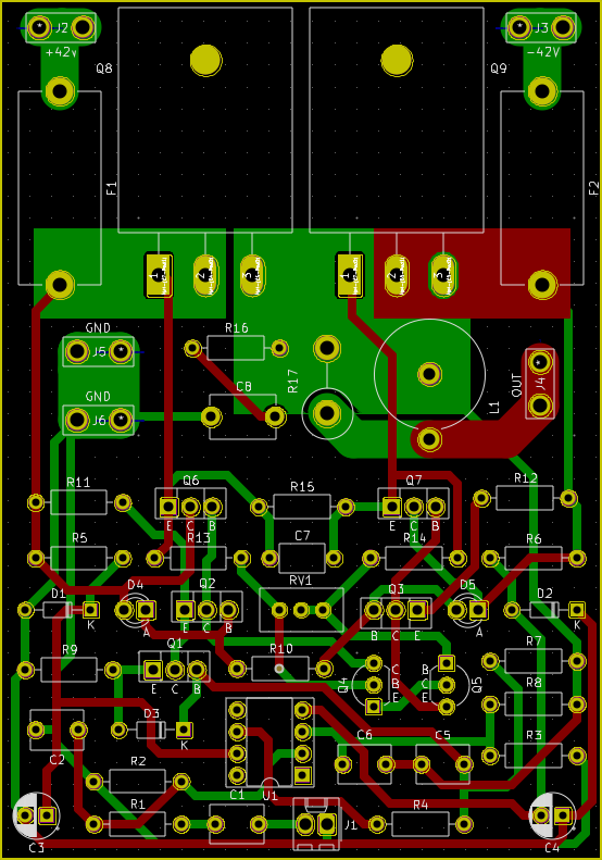

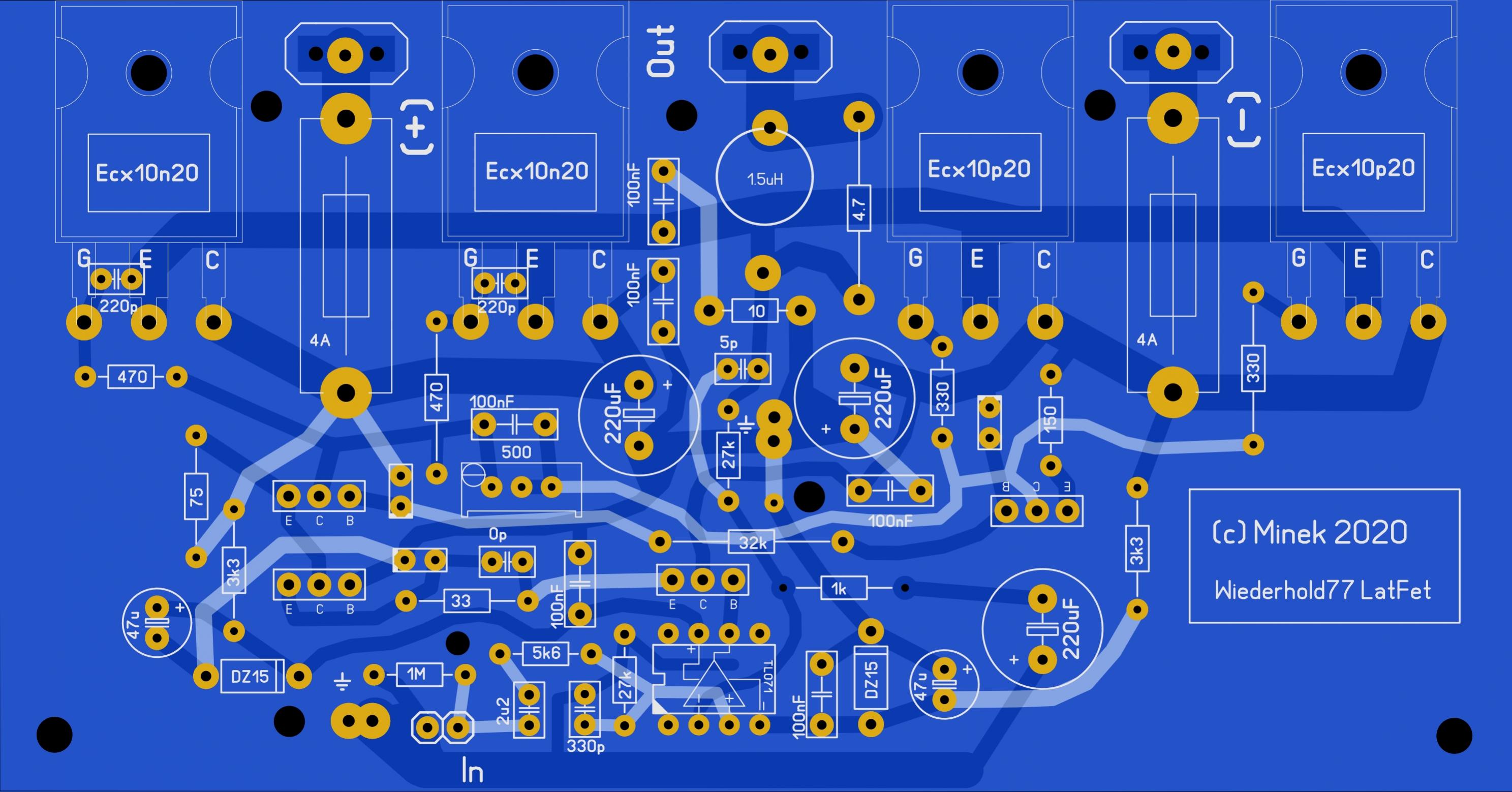

Here is the corrected version, hope this is OK now.
I don't have either of these parts, I will have to order them anyway once done with the PCB.
Instead of GT308, you can use GT322 or AG128

You mean AC128 ?
GT322 has 4 pins, I guess one of them is ground?
Q6/Q7 will be mounted on small heatsink(s) - like in my photos.
The size of my small heatsink was adequate, but it wouldn't hurt making it little bit bigger,
so you may want to plan this ahead of finalizing the PCB.
E.g. this coil sitting right in front of Q7, may be obstructive, if you have to screw/unscrew the bolt for the heatsink.

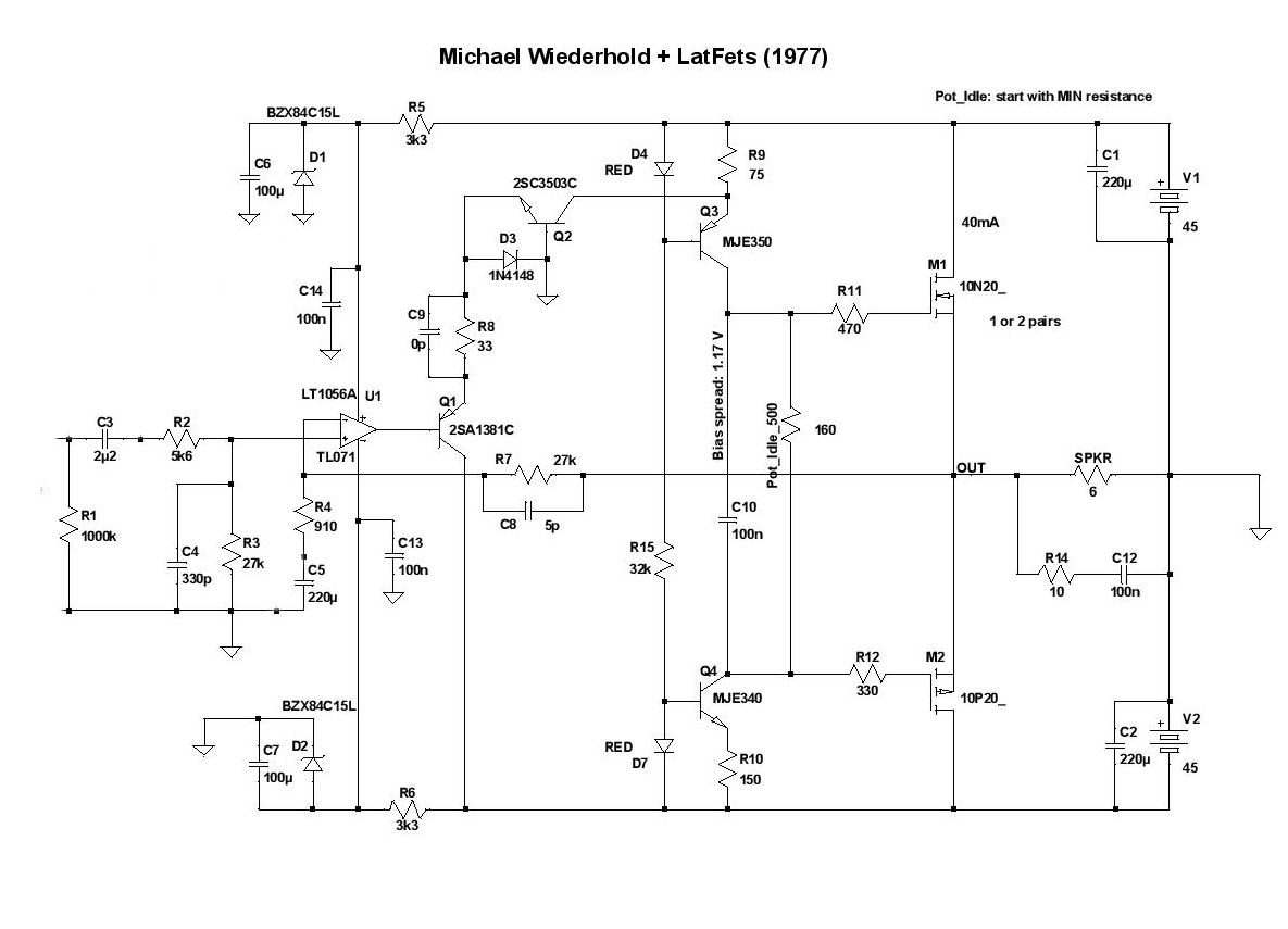

Wiederhold 1977 amp
Now going back to the grandfather of the Lomakin & Parshin amp:
original design from 1977 by Michael Wiederhold - already mentioned in post #25.
Original article from German "Radio Fernsehen Elektronik" zipped and attached. The same design was one year later published in Russian "Radio", and in Czechoslovakian "Ameterske Radio".

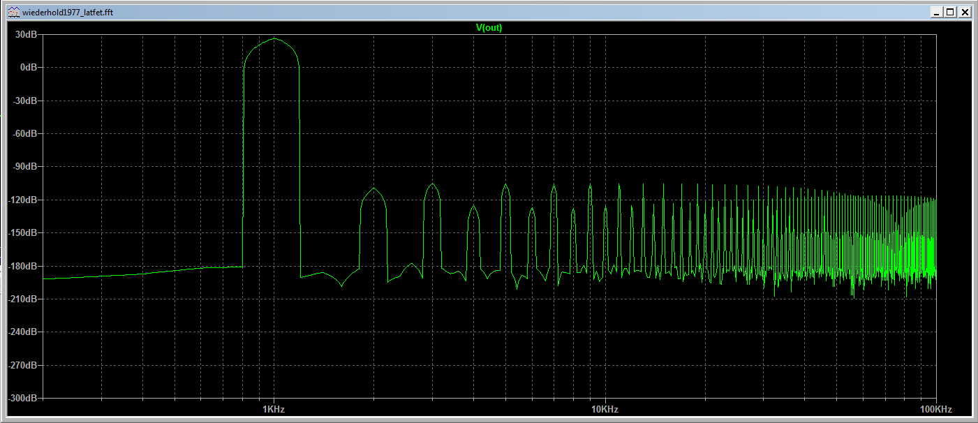

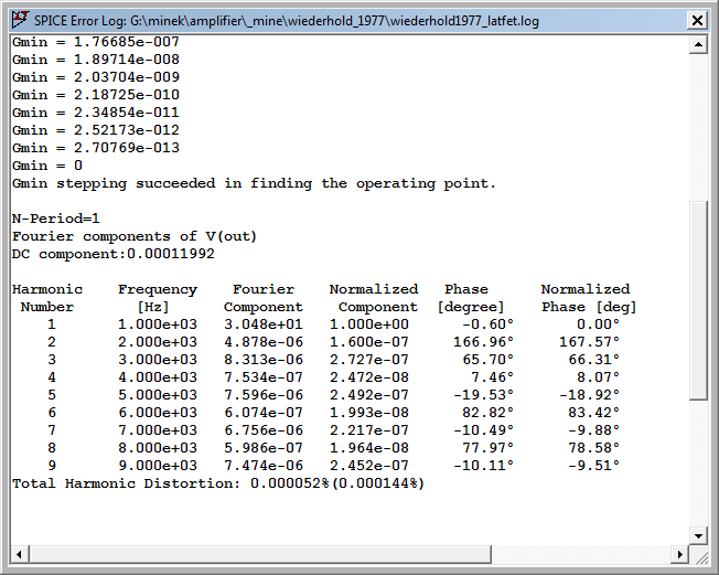

I tested several variations of Wiederhold amp in Ltspice:
BJT, Quasi, Hexfet, Latfet (Latfet version ASC file attached).
Here is Latfet version - the simplest one, yet it gives excellent results. I'm working on the prototype right now, and will post updates here.
Next version to be built after Latfet - Hexfet quasi

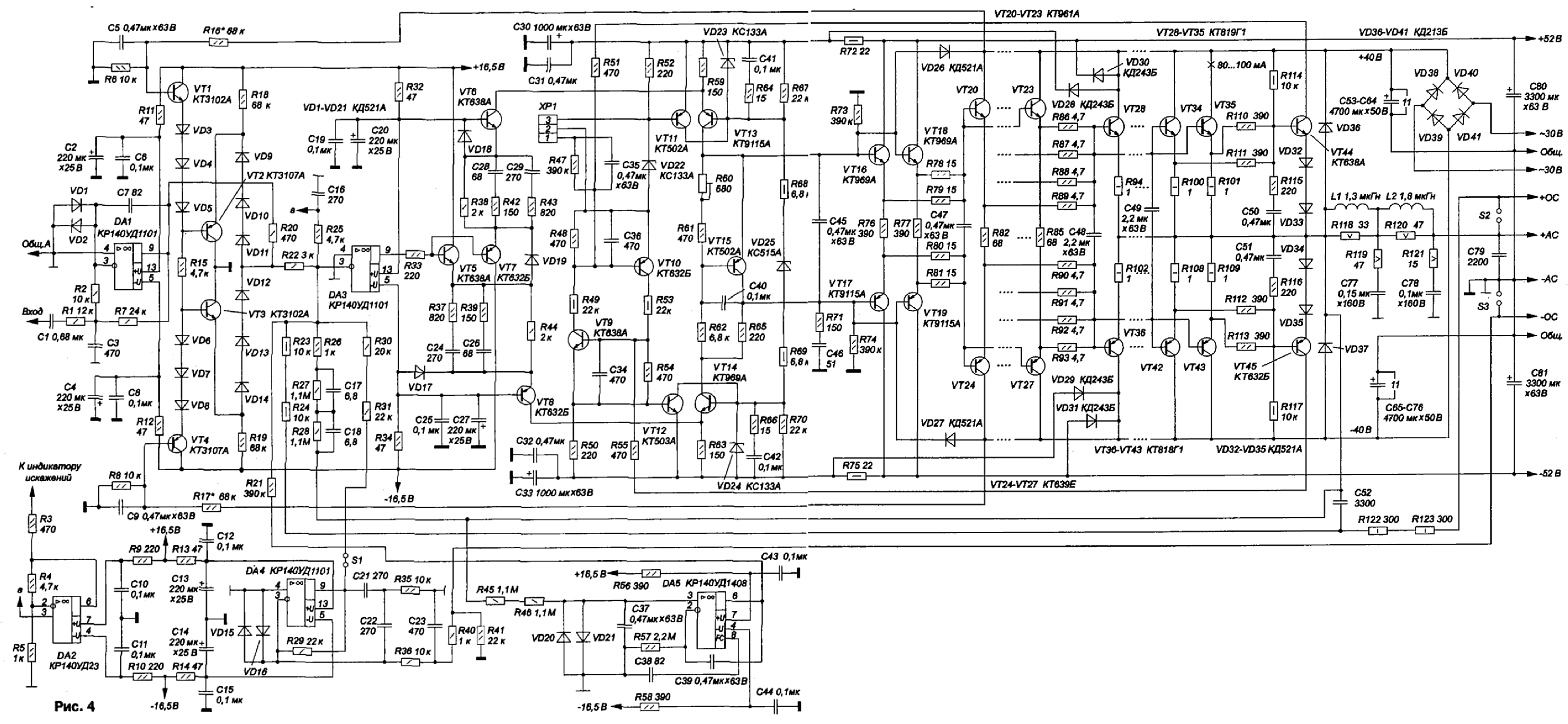

Sukhov Amplifier
Hi Stanislav,

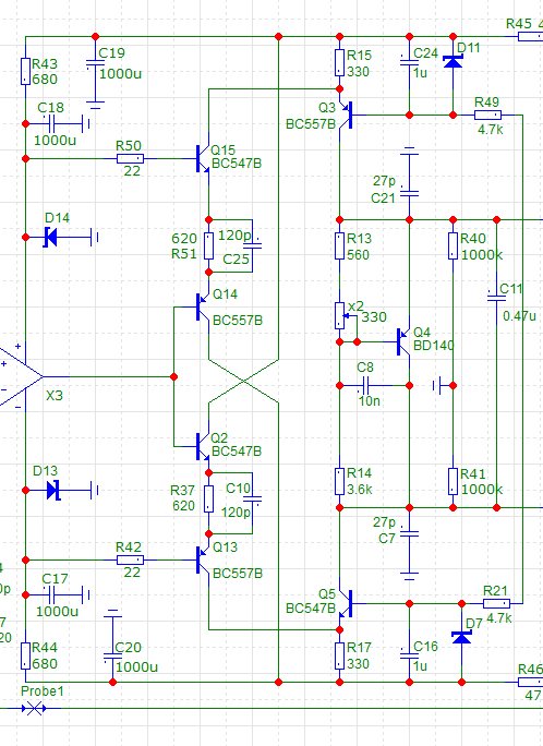

I look at his amplifier and wonder whether making it fully symmetrical would bring a simple and possibly effective improvement in performance? It seems a shame not to, to my mind
Edit: wonder if this topology would lend itself to an NDFL scheme?

I’m an LTSpice man. Going to fire this schematic into this tomorrow. Then I can have a play. The rush cascode part does make nested feedback an option even just as a technical exercise. As you can guess nested feedback has my interest at present.

There are no nested feedbacks in this scheme
Thank you. Hopefully, in today’s Information Age Some sort of rough translation to English is possible. I like this sukhov amplifier.
No nesting in this scheme but it does start to look like the compensation in the PGP amplifier could be grafted on.
PGP Amplifier
In effect a simplified PGP.
