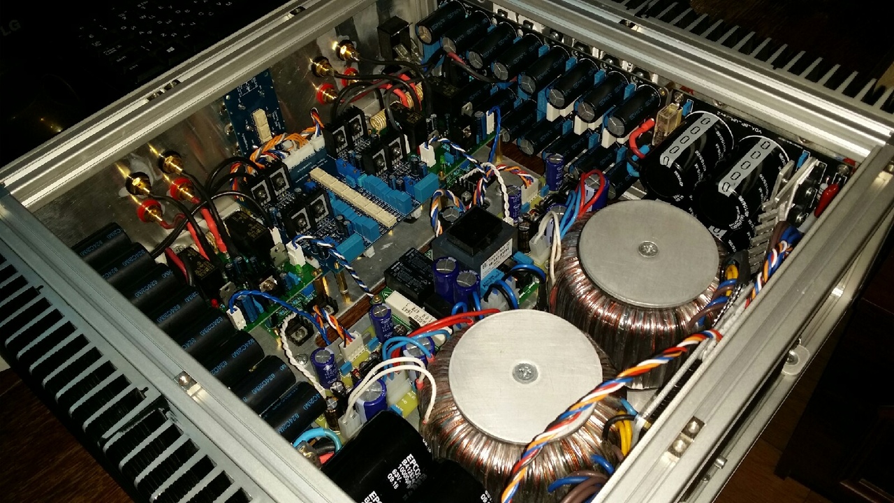

After almost 2 days of listening to this amp, I think it gives very nice sound.
Definitely on par (or slightly below) with my "reference" amplifier - Circlophone by Elvee, which I consider (so far) the best sounding amp, of these that I built.
This amp (Lomakin Parshin) is not very complex and it's cheap to build.
Biasing can be simplified, if Si/Ge scheme is abandoned, and replaced by 'traditional' Si Vbe multiplier.
For reference - album with photos:

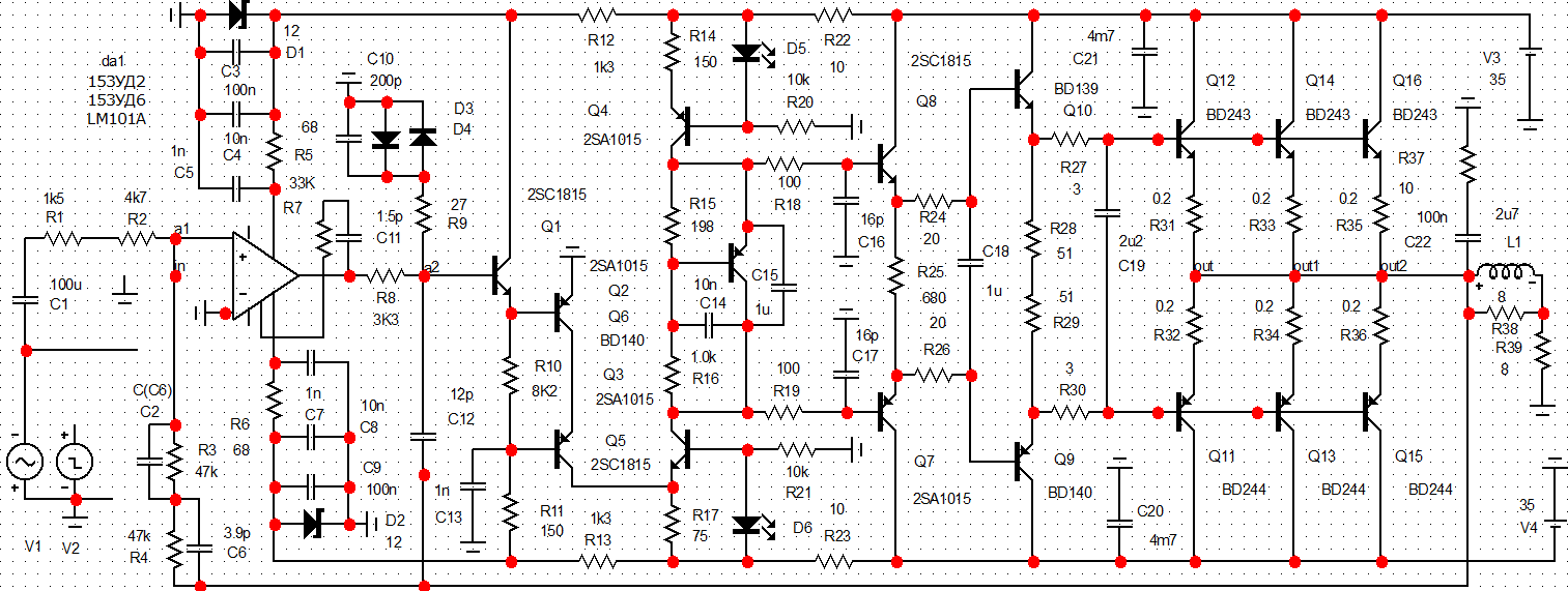

So this one you haven't built yet, right?
The only real differences are:
a) use output triple instead of the double
b) use 3 transistors instead of one at the output of the op-amp. Not sure how to call it?
It's not VAS, I guess "level shifter" ?
I'm assuming you don't have spice sim file for it?

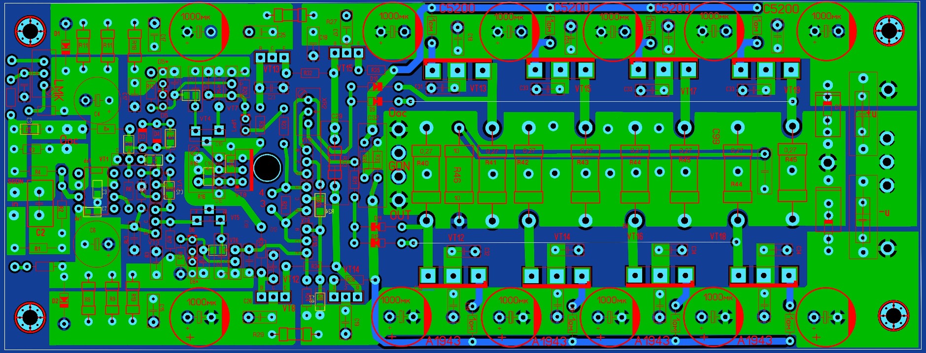

> Build. The signet must be ordered in China.
So you have built a prototype, and now you need to order PCBs
from China, correct?
And the build was working fine?

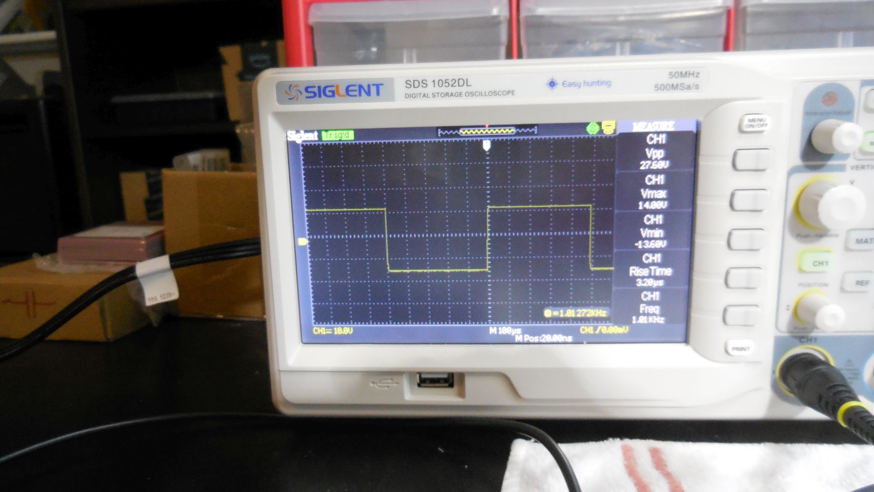

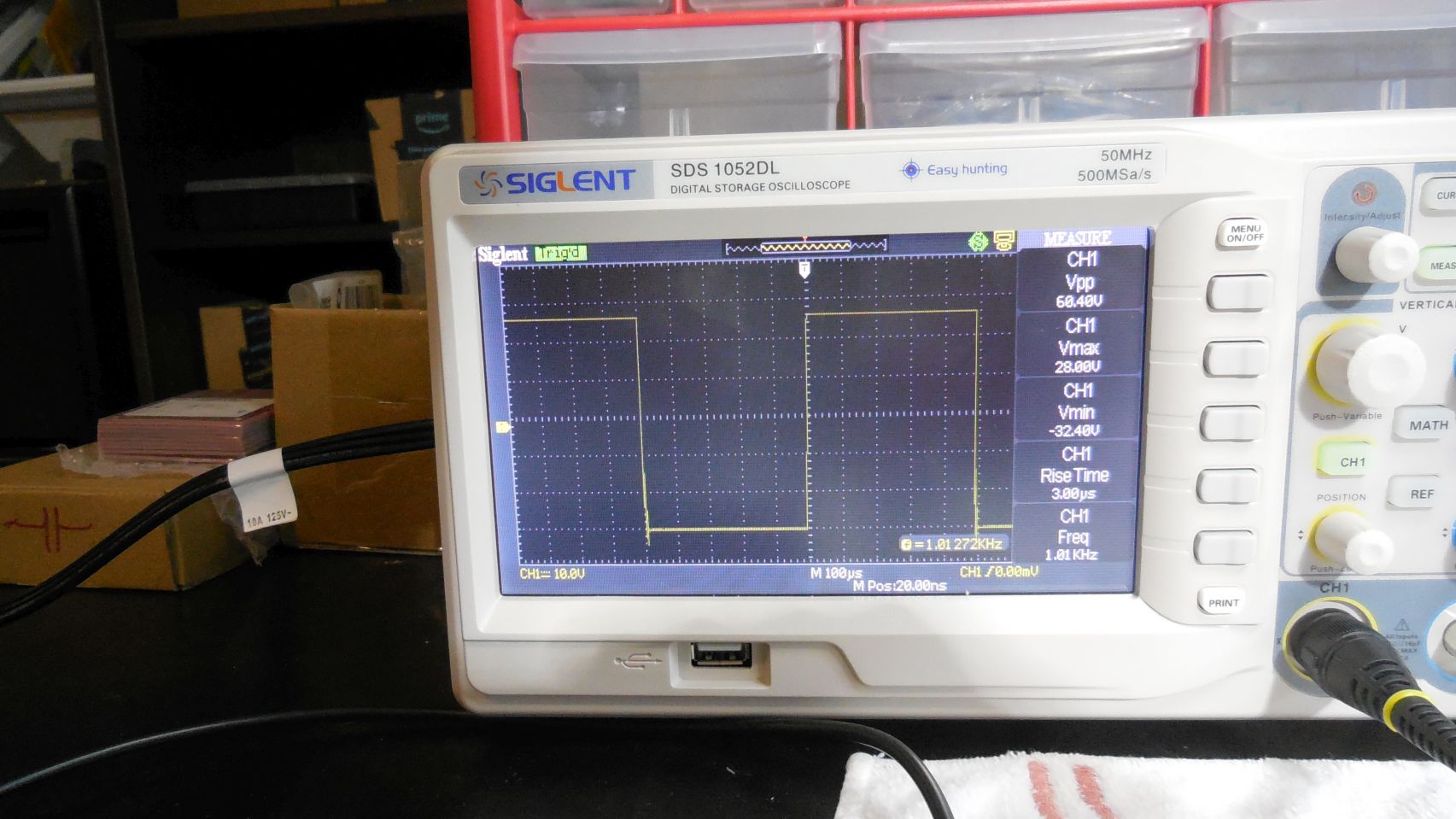

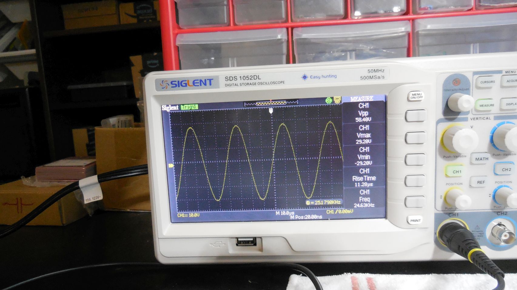

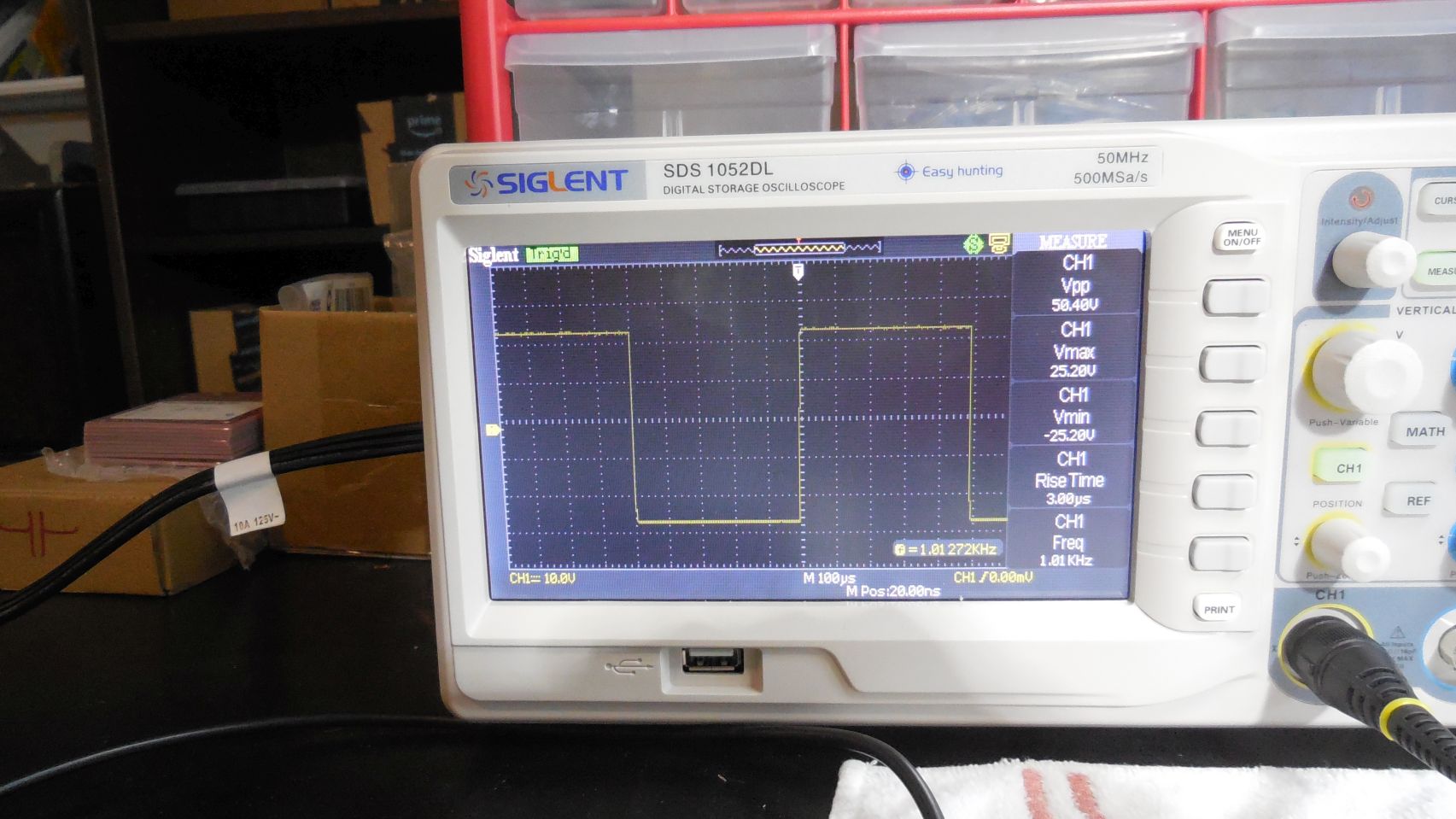

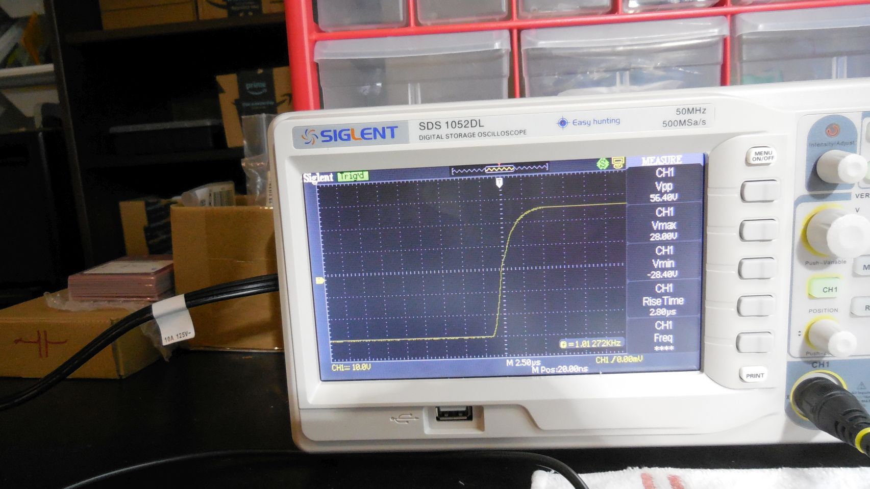

Tweaked few component values for the hexFet version, Thd is significantly lower..
I guess it won't hurt. Will try this is in my build tomorrow.
In the sim, these changes also improve BJT version..

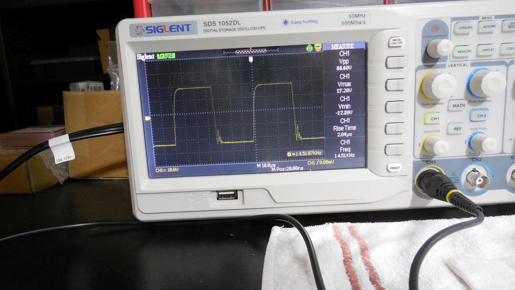

Tested these tweaks in the actual build (schematic in post #116)
On oscilloscope everything looks the same or slightly better than before.
Amp very stable. Tested with 40V rails, 50mA per Fet, 8 Ohm resistive load.
So at least I didn't make it worse.
Slew rate seems to be around 17V/us, so it's acceptable.
Next step - listening to the music.

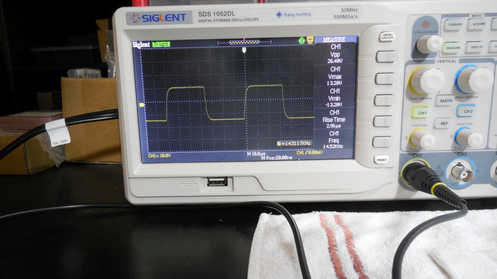

The last photo that shows some oscillations at the bottom of the square, is at 14kHz, 56Vpp.
Vpp is blurred in the photo for some strange reason.. Didn't want to re-do this test, to avoid smoke..
This might be due to lab PSU running out of amps... It tends to trigger oscillations or strange behavior when current limiter kicks in..

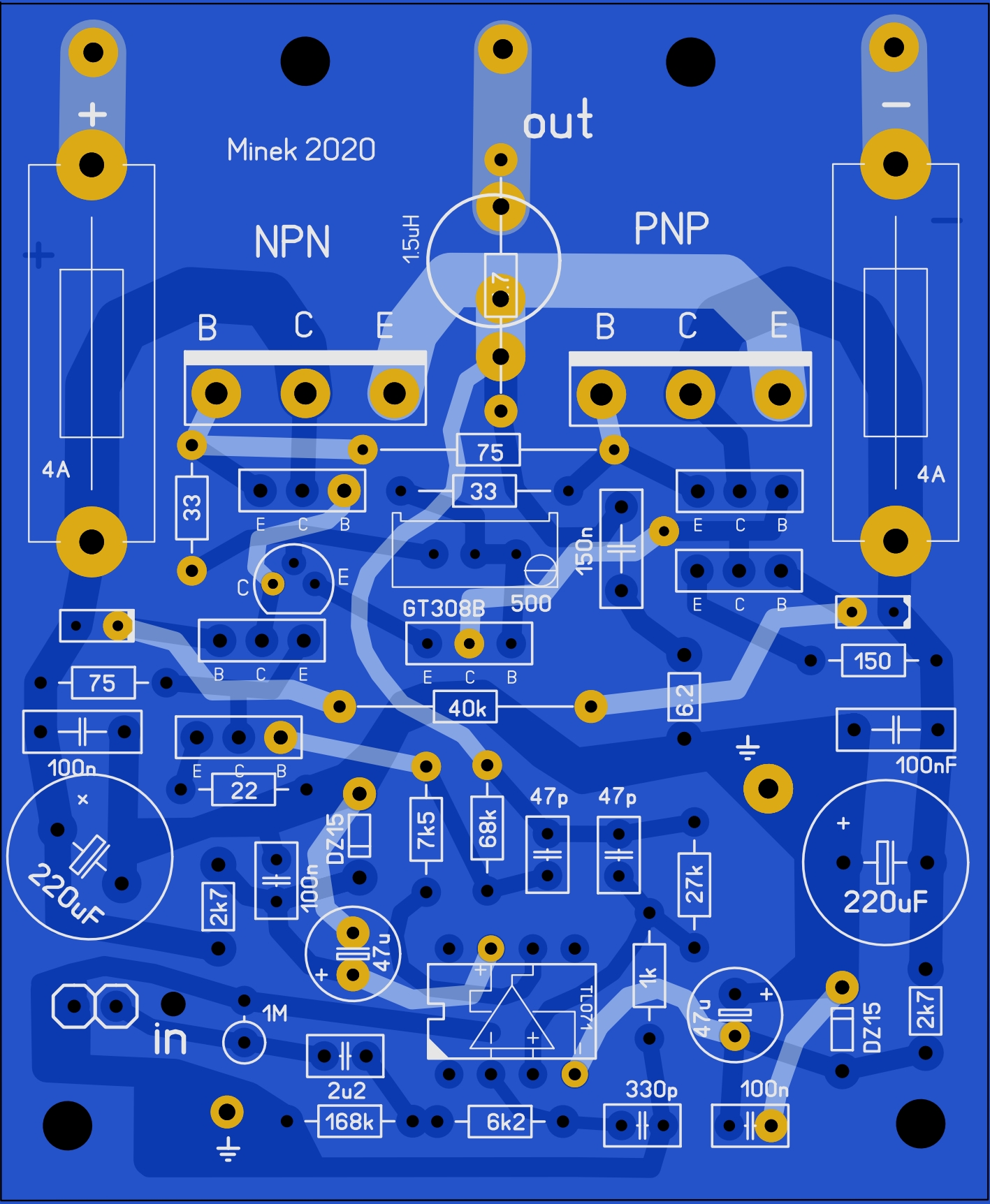

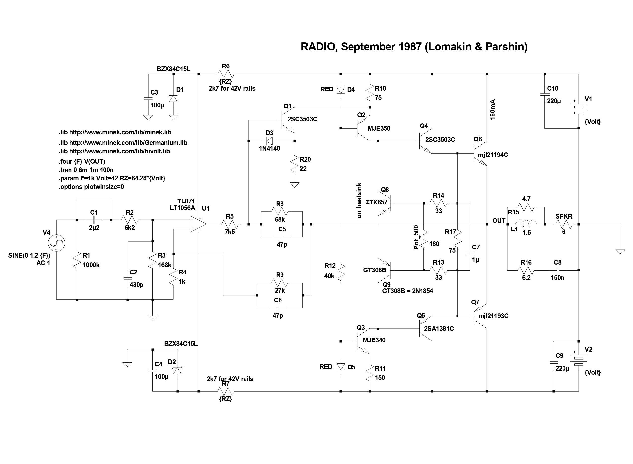

I'm considering the BJT version as 'completed'.
Here is the final schematic (as built), and PCB SprintLayout file.
D3 and C7 were added after PCB was designed, and both were soldered under the PCB.
Q8 must be in contact with heatsink, and was also soldered under the board.
Tested with rails 35V - 42V.
Q8 can be replaced with MJE 340.
Op-amp: TL071
R6/R7: 0.5W, R15: 2W, R16: 2W, R12: 0.5W
Drivers should have their own small heatsink(s) - Q8 should be tracking temperature of the output devices only.
