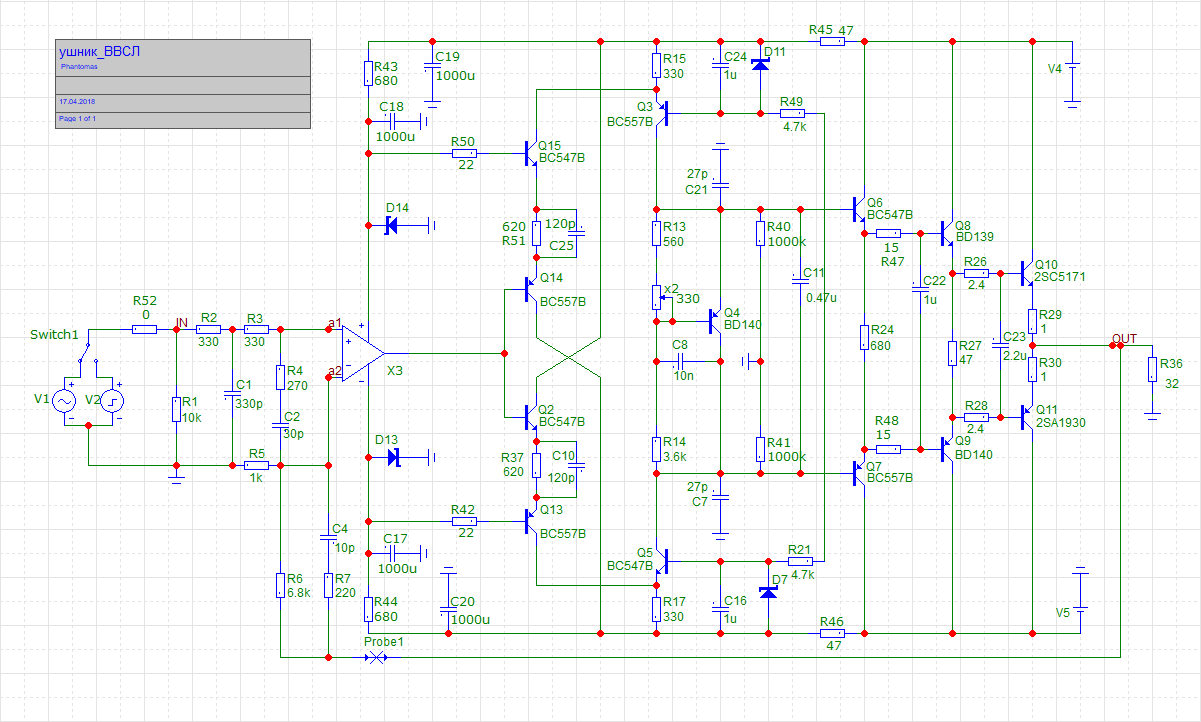

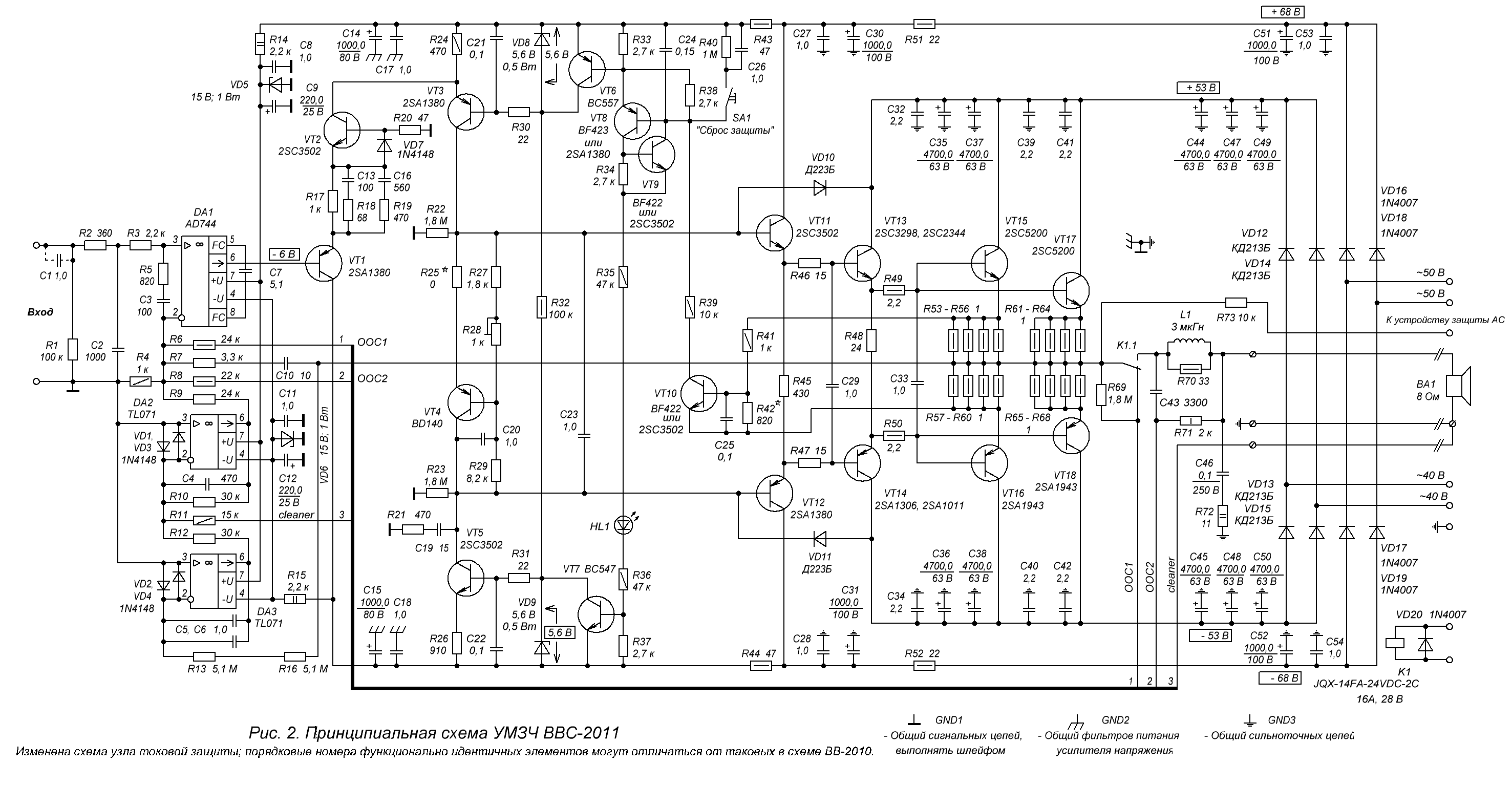

Tomorrow I will only be able to throw off the material of the symmetrical version with the drawing of the Board. I prefer other schemes, also cascading.From a monster and another with OE in cascade.
Утром скину ,по московскому времени
As promised

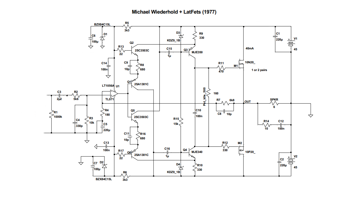

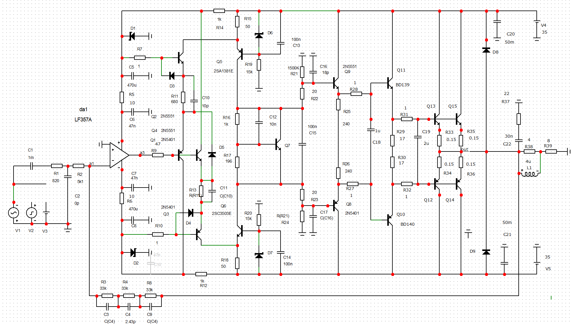

Symmetrical Wiederhold amp

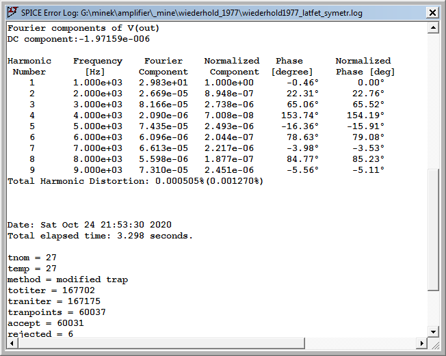

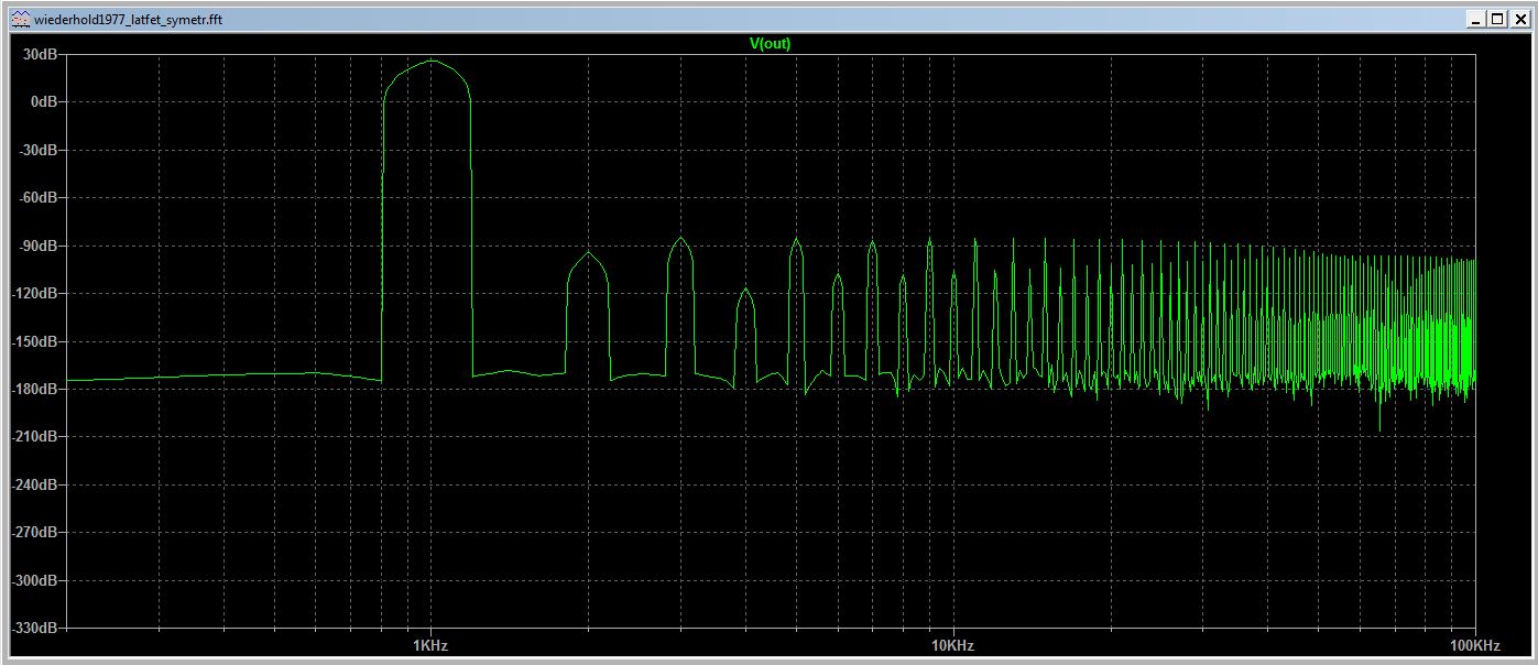

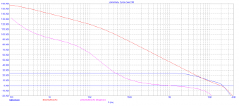

Did the sim in LTSpice.
Doesn't look like it's doing better than asymmetrical version.
Slightly worse, at least from the Thd point of view.
Asc file attached.
