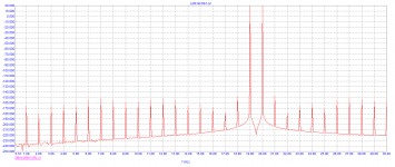

Так и должно бытьOnly a few in 20kHz, as you can see on attachment pix. At 1kHz is nothing.
Это так и должно быть. Интемодуляционные искажения 19/20кгц с одной парой выходных транзисторов во вложении . С 2 парами выходных транзисторов еще лучше

This version gives not the lowest distortion, however have the most beautiful fft spectrum.

Well, your attachment has a primitive amplifier, and my attachment shows linear amplifiers with a large loop gain

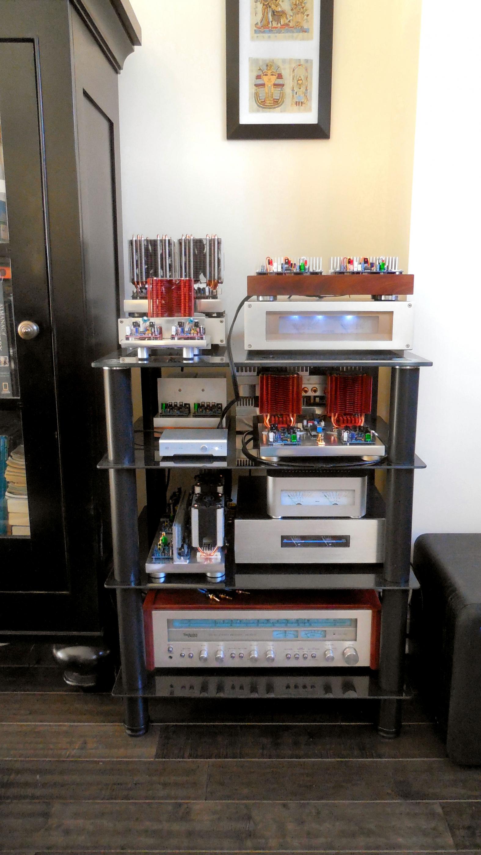

Testing Wiederhold amp at higher power 🙂
Works beautifully. Especially playing Vivaldi's "Winter"..
Running low-warm, so heatsinking is definitely adequate.
In the pic - my rack with some of the recently built amps 🙂
