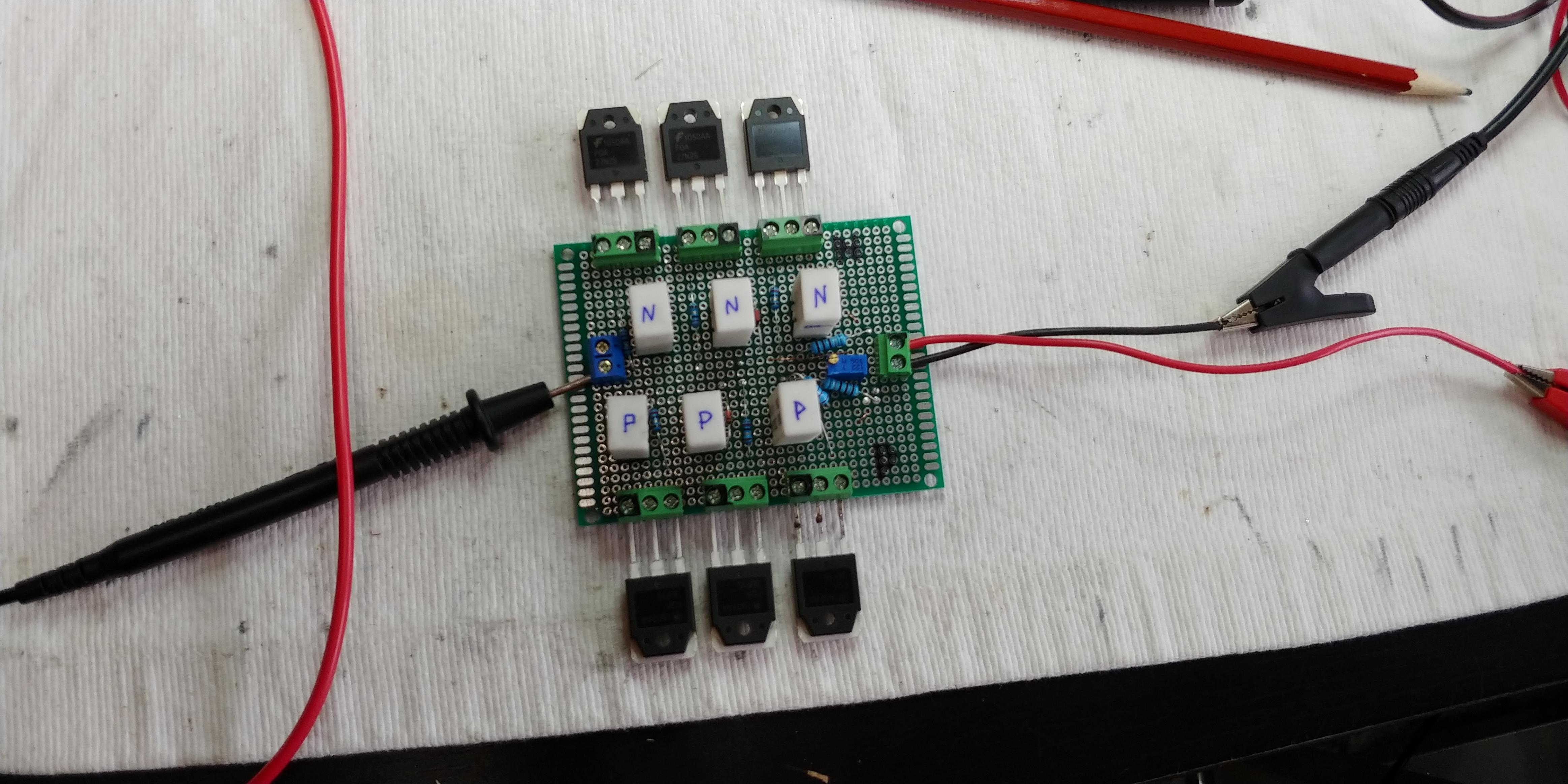

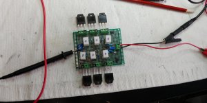

After 3 hours of matching mosfets, finally came up with 2 sets of triples for N mosfets.
They still not perfect, but they will work. My new part-time job - human curve tracer 🙂
Now trying to get P ones matched..

I have modified my theory.
After spending 2 days with different methods of matching mosftes, the conclusion is that the mosfets WERE matched OK.
More or less. Perhaps not perfect, but definitely they should nicely co-operate sharing current.
They didn't.
Observations:
1) amp with 1 pair worked flawlessly
2) amp with 2 pairs wasn't tested
3) matching rig from post #1516, when used to match 2 mosfets was showing acceptably close match for most of the pairs.
4) same rig - when used to match 3 mosfets was showing strange behavior - sometimes 1 mosfet hogging 75% of the current
5) same behavior could be observed in the amp, when 3 pairs supposedly matched mosfets were installed.
1 or 2 pairs - good, 3 pairs - bad.
So, since the matching was more or less correct, the only explanation would be that SOME mosfets were wildly oscillating.
None of these oscillations were observable on the oscilloscope.
Amp was always working fine, showing accurate waves.
What is to be done?
I guess first I will try increase gate stoppers to higher values, say 100 Ohm.
While at it, it seems that N and P devices have 33% difference in input capacitance (according to the sheet). This I'll verify by measurements, especially that I remember seeing much higher Ciss number than the sheet shows, last time I measured them. I guess sheet's number might be too optimistic..
So N gate stopper gonna be 125 Ohms, and P stopper 80 Ohms.
Let's see if this helps.

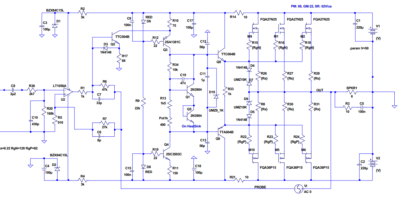

With an increase in the number of transistors, the nonlinear capacitive load of the Vas (drivers) increases. This can lead to generation at frequencies up to tens of MHz. Radio emission can be detected using the simplest "bug" indicator.
I like this design because it keeps the drive to the VAS single ended.
This promotes H2 over H3, and MOST people prefer dominant H2.

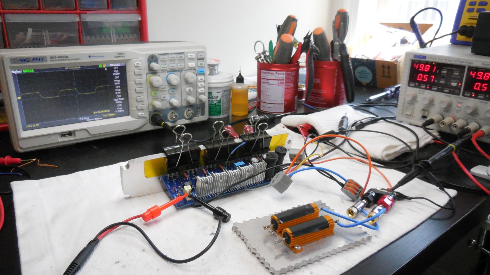

Ok, so I changed the gate stoppers (120 and 82 Ohms), and also removed 'speed-up cap' between emitters of the drivers.
Amp has been idling for 3 hours, current sharing is ok - within 20% on each fet.
So far so good. Idle current very stable, while temperature changes.
The new spreader works like a champ.
This afternoon will continue tests with waves and more power.
Not sure about this 'speed-up' cap. Does it even belong to mosfet OS?
I see some designs use it, most don't.

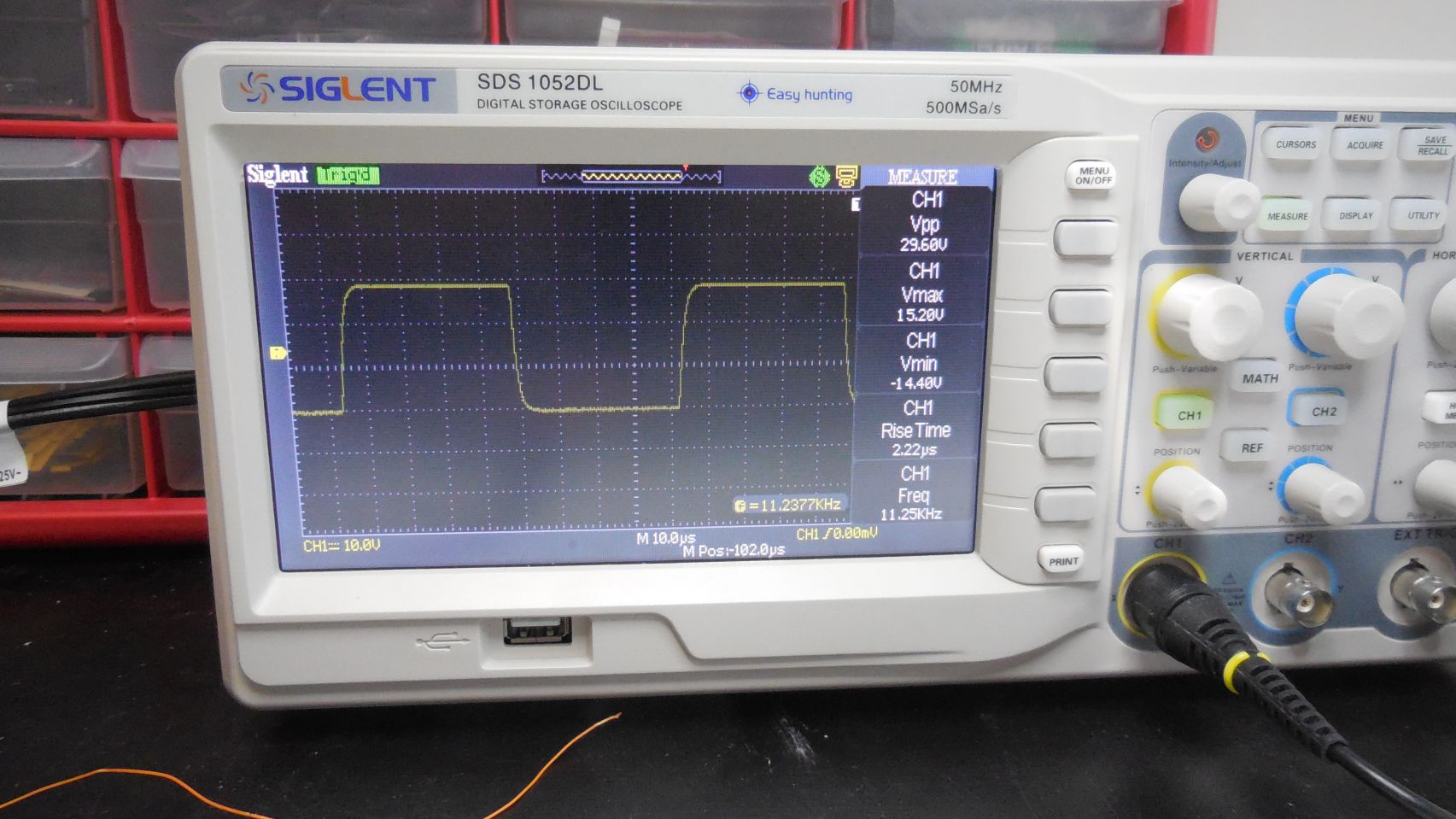

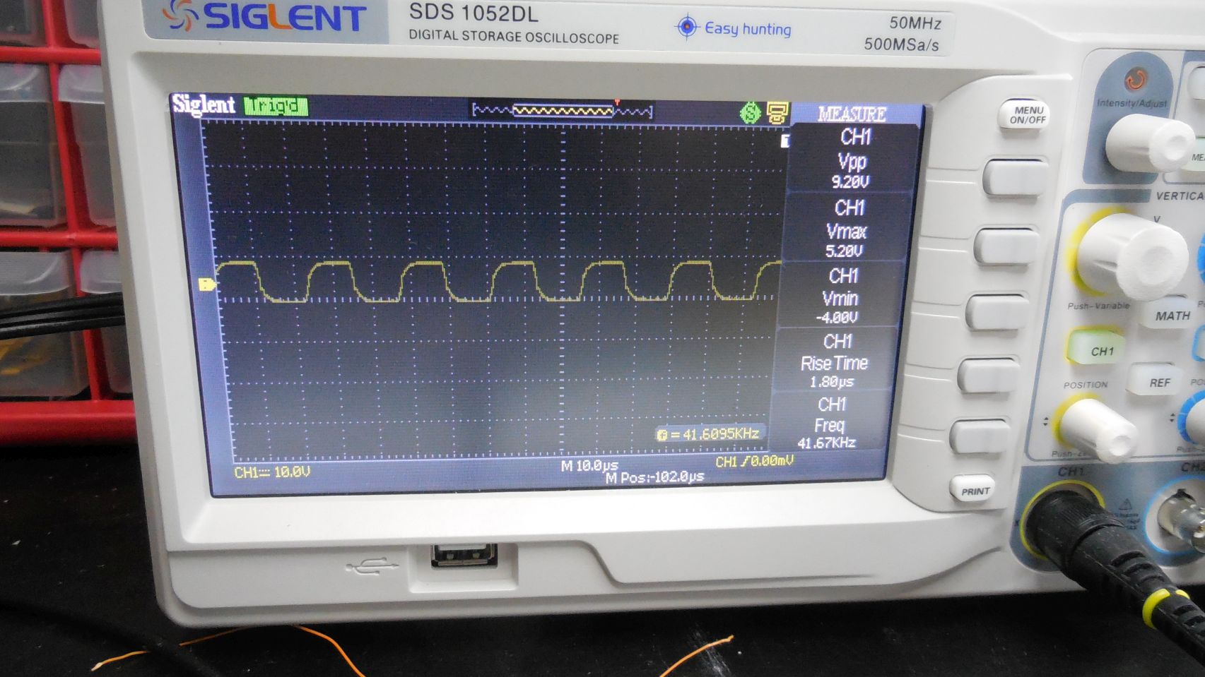

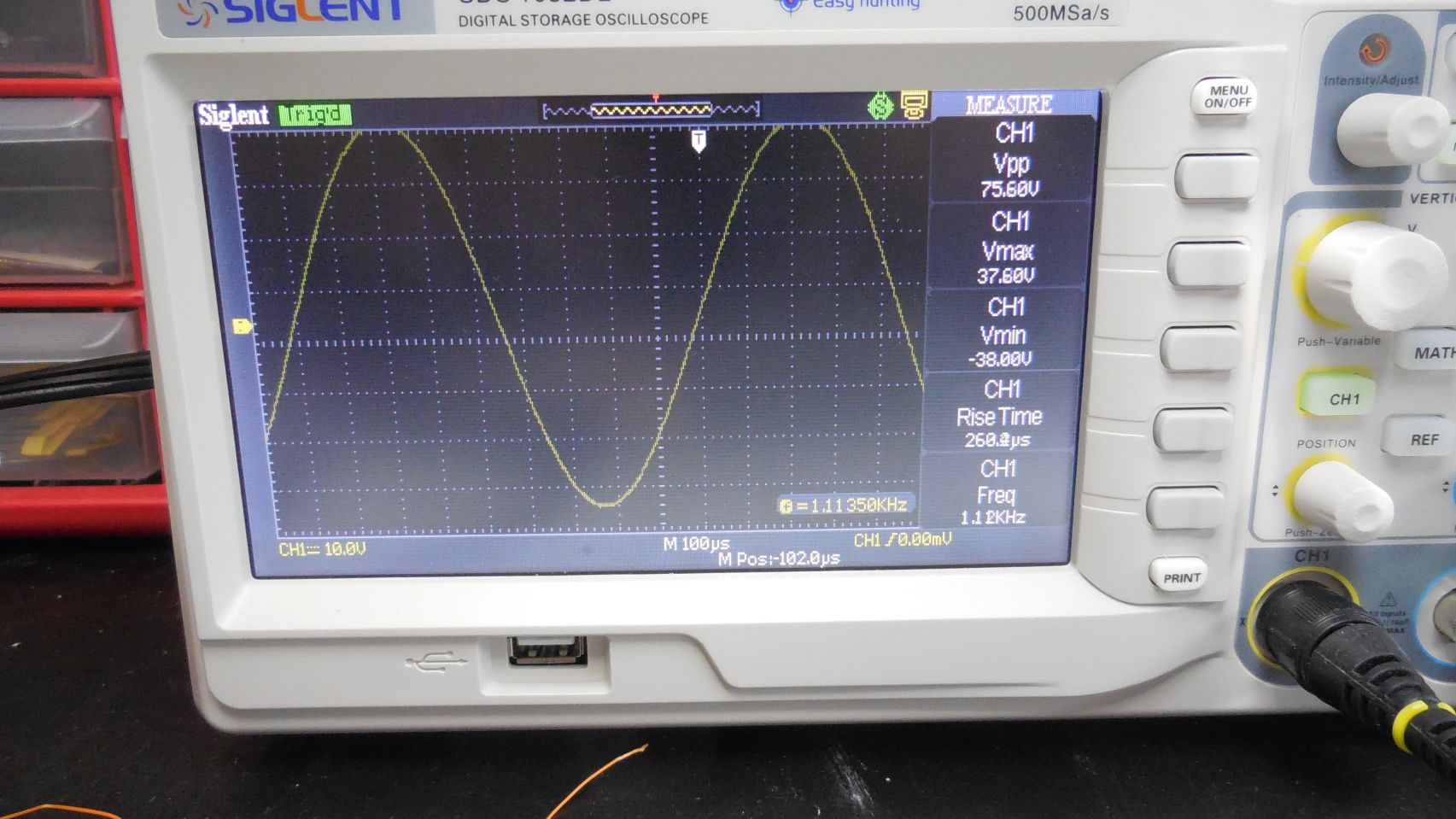

More tests completed. See screenshots.
Everything works fine.
One time I forgot to connect the thermal sensor transistor-diode wires, and bias skyrocketed to the max amperage.
Somehow the amp survived 🙂
So to prevent such events in the future, I added 9.1V Zener across the spreader. This will limit idle current to approx 300mA in case of spreader failure.
Most current sim file attached.

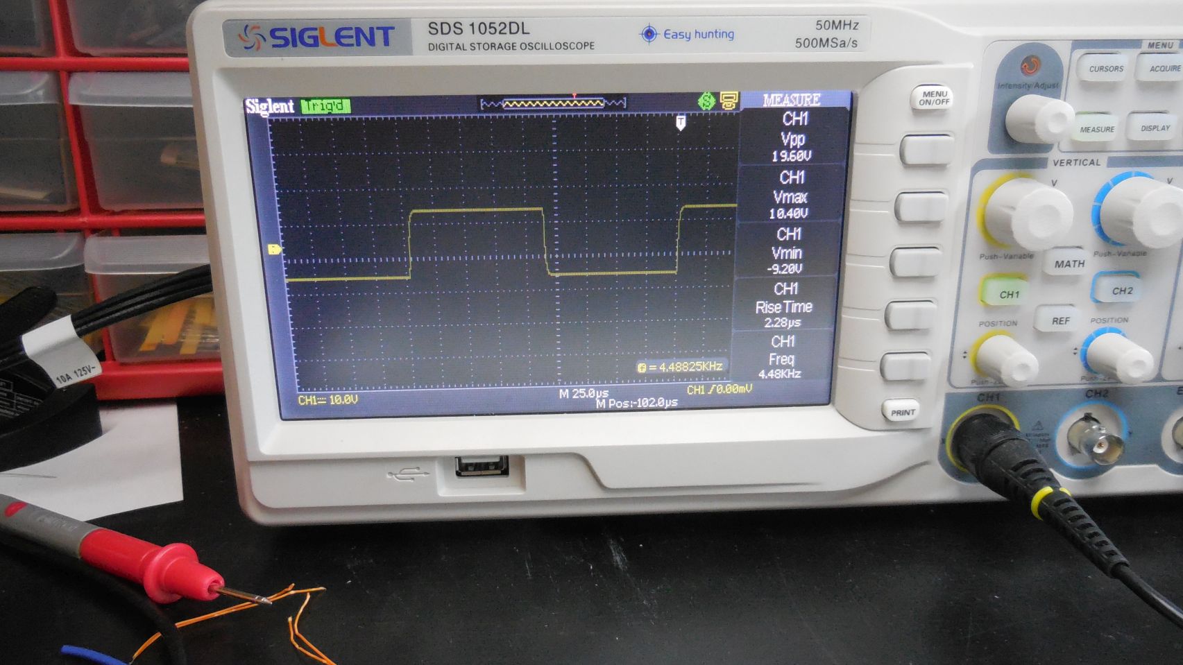

When looking at square waves, check out the 'rise_time' displayed by the oscilloscope, rather than looking at rounded edges of squares - their 'roundness' depends on Vpp and screen scale, which may not be perfect..
This amp - because of 3 pairs of output devices - is running too hot for this small test heatsink. More tests at higher power will follow, when this thing is mounted on the proper chassis with bigger heatsink.
Looking back at first LMK amp square waves results, rise_time is definitely higher - if this can be an indicator of most likely higher slew rate of this amp. Same goes for Wiederhold amp builds.
BUT - Philips amp was even faster, with higher rise_time numbers.
All in all, I went through 3 prototypes, on 3 PCBs, and I burned 1 mosfet (I touched something on the board with a screwdriver during square wave test..).
I guess this is as good as it gets.
So more tests to follow (including audio analyzer tests) after this build is finished, heatsinked, and powered by bigger PSU.
On this PSU with limited amps, I'm unable to reach real clipping behavior.
Perhaps while I have it on the test bench, I should test different op-amps. This build is using actual LT1056.

The following JFET op-amps has been tested:
LT1056 - works fine (as in the sim)
TL072 - works fine
TL2081 - works fine
TL2071 - works fine
OPA 134 - works fine
AD711 - works fine, BUT I see _possibly_ some little oscillations at the bottoms of squares
LF356 - NO
LT1357 - NO
All in all, that's pretty good. Previous builds of similar amps would NOT work with so many different op-amps (without tweaking compensation).
So I guess this suggests it's a stable amp.
I tested these other op-amps with 1kHz sinus and square and with 10kHz sinus/square.
No differences in the waves were observed, as far as I can tell, all these op-amps were behaving the same.
One more thing to mention - output DC offset starts at 10mV and settles down at 5mV.
TL072 - works fine
TL2081 - works fine
TL2071 - works fine
LF356 - NO
LT1357 - NO
