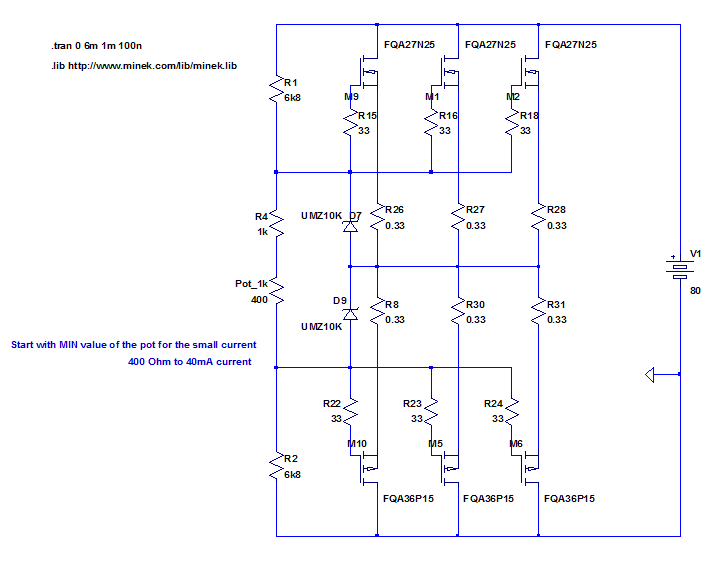

That's why I'm investigating Akulinichev spreader for Mosfets - perhaps will try to build Mosfet LMK amp (like the BJT one built as the first one in this thread),
re-using PCBs I have for the BJT version. If I can get that spreader to work, I only need to add gate stoppers, and everything else on the PCB will fit just fine.

Akulinichev's shunt was used only with BJT.
Mosfet amplifiers can have high inrush (through) currents during transient.
The amplifier may have insufficient stability margin if the correction is not optimal.

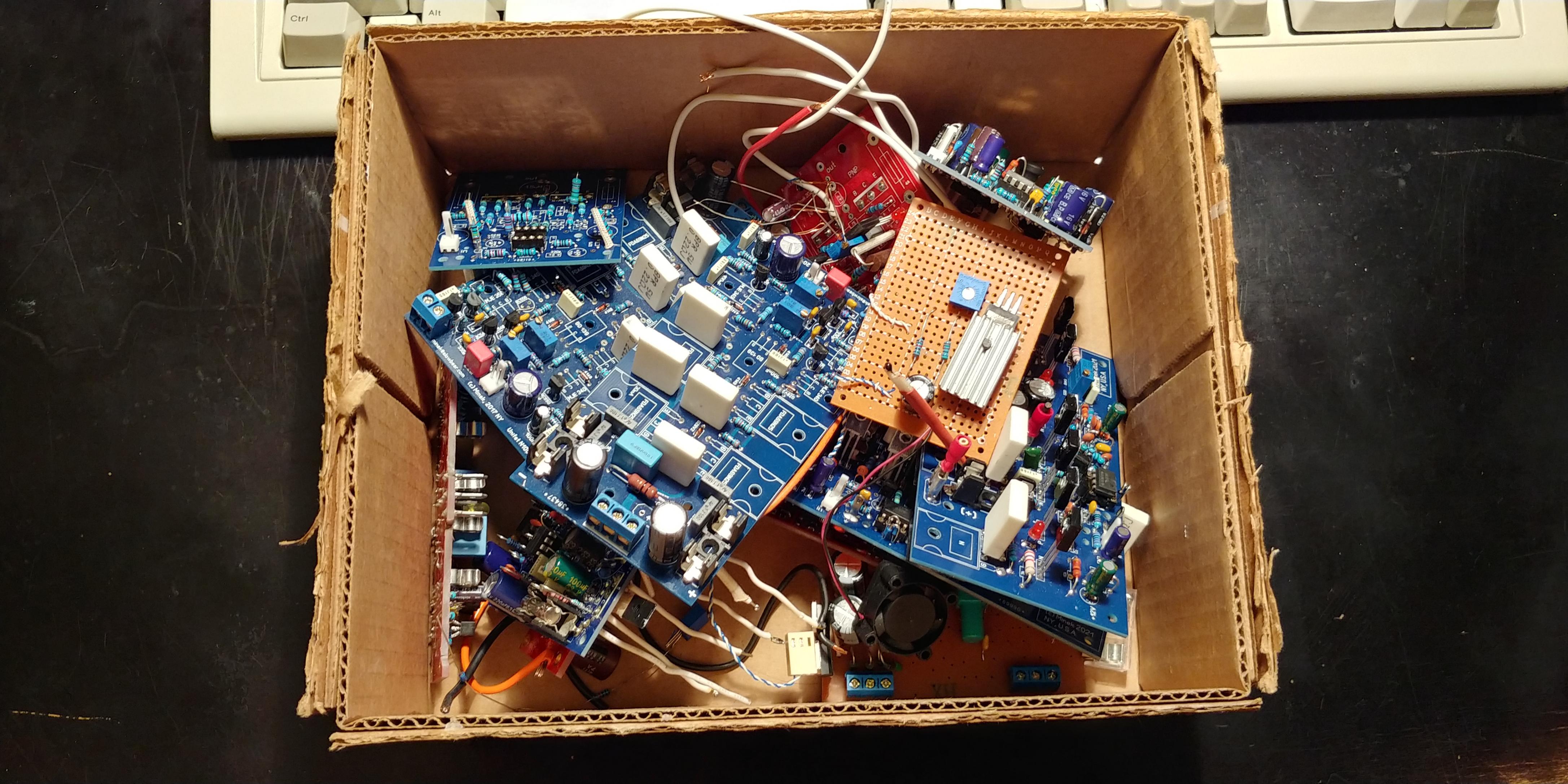

"Experience is simply the name we give our mistakes" - Oscar W.
Attached are my "experiences" from last 2 years.. This box is deeper than it looks..

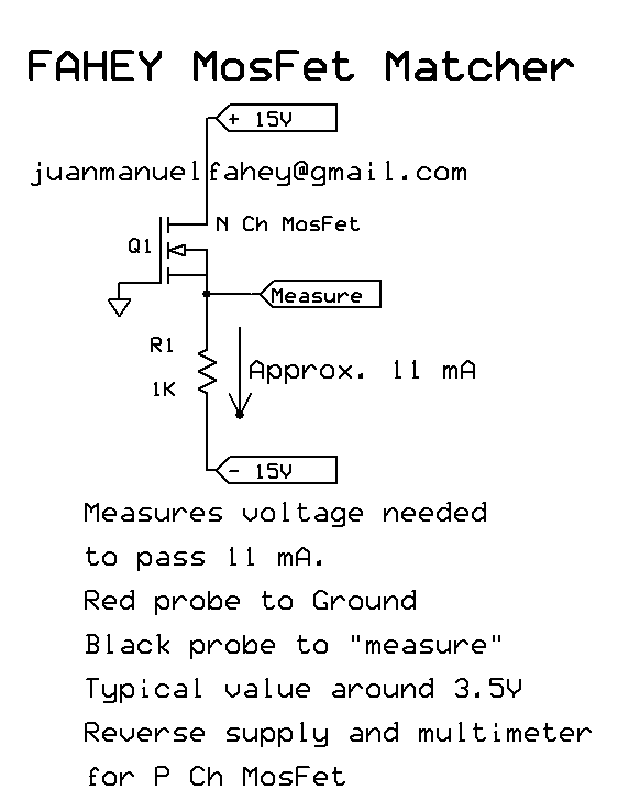

2) Fet matching was not good. When checking voltage on source resistors, differences are from 20% to 100%. These _actual_ results are totally disconnected from my matching results..
This observation is consistent with my previous experience with matching fets. Very unreliable process. When I repeated the _same_matching procedure the next day, with the same devices, the results were totally different (random??).
The method I use - attached here (I was matching at 10 and 100mA).

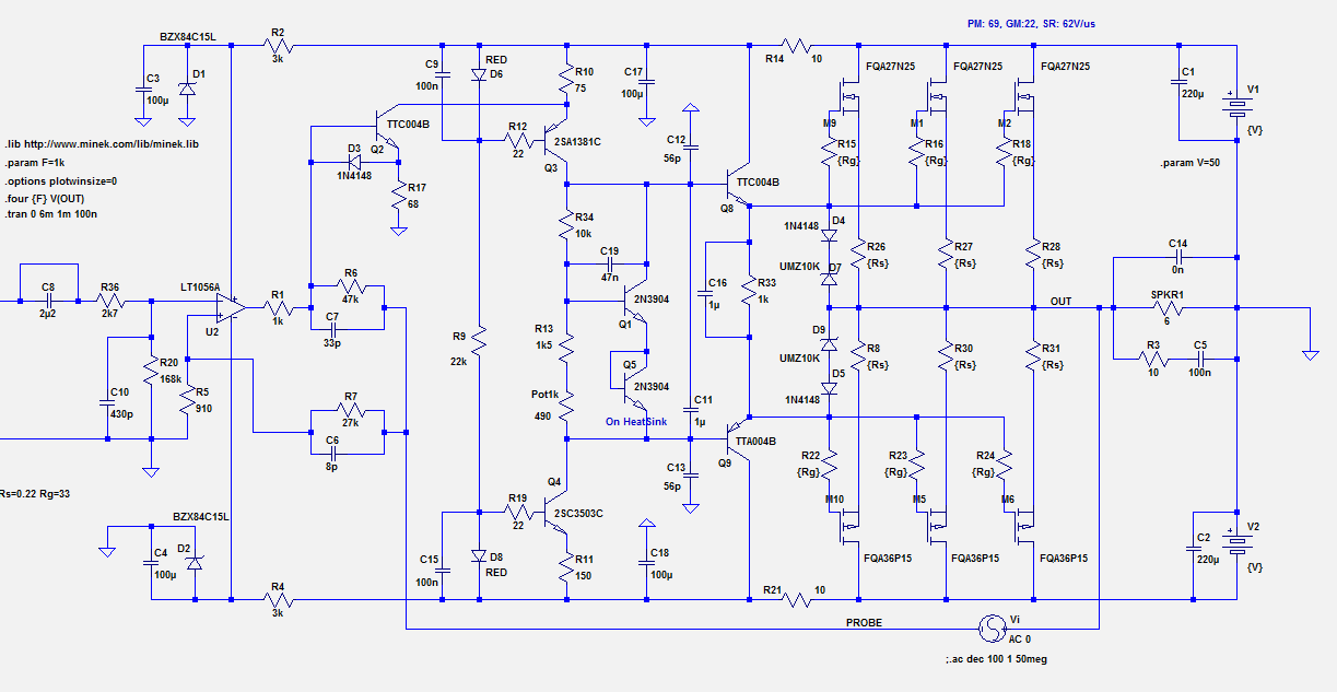

After little experimenting at different power levels (temperature) with the amp,
this biasing seems to work the best for FQA mosfets.
Idle current is kept stable at different temperatures.
Will test later on with bigger PSU, to check on higher power levels.

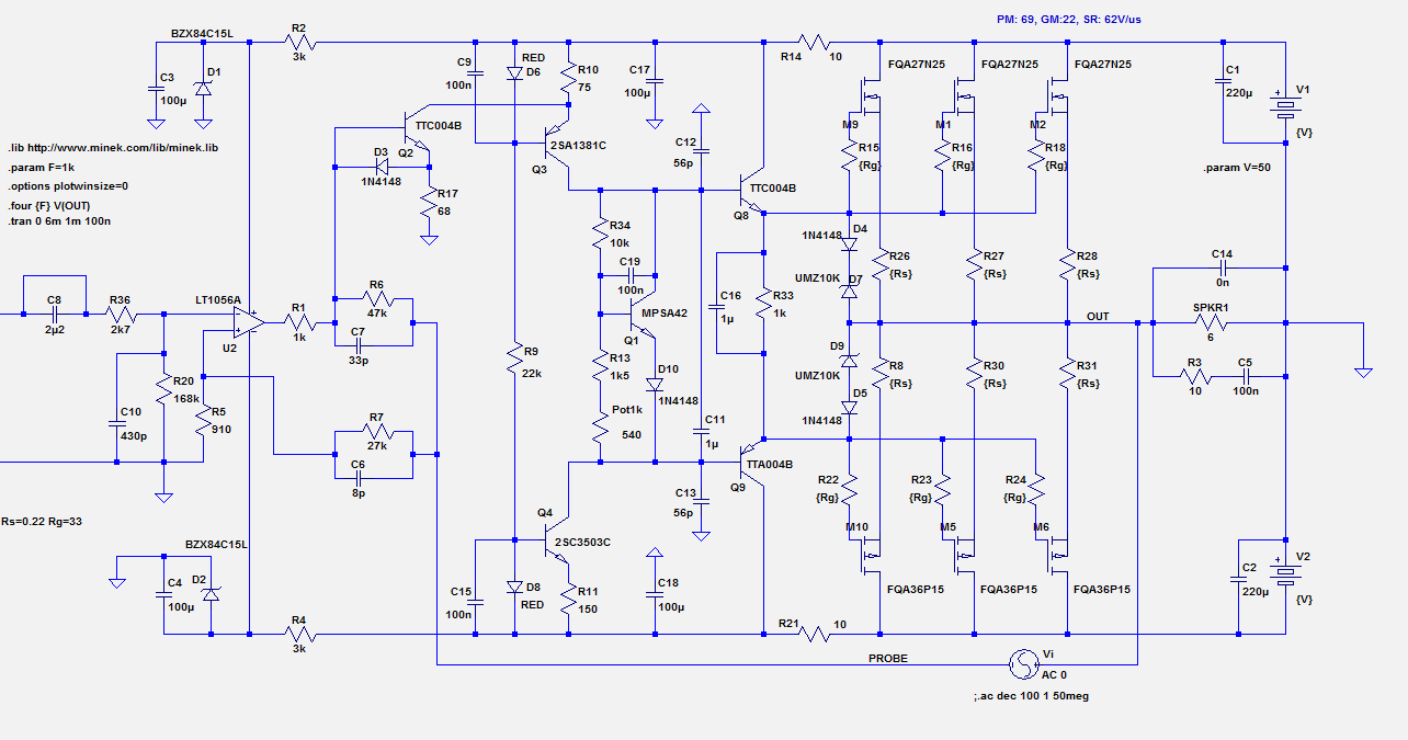

>How did you achieve 62V/us SR? Previous LMKs did not go above 20V/us.
In sim - yes.
In real amp - I didn't run tests at full amplitude yet, because mosfets are not matched yet...
In sim - yes.
I suspect previous LMK amps were underestimated as far as SR goes...
And they were built with much slower output devices...
