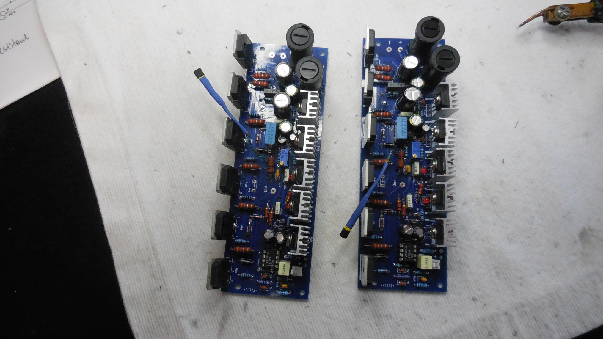

I managed to find spice model for TLE2071 - it seems like very nice and fast, new op-amp, so I decided to use it in my sim, instead of usual LT1056.
It doesn't hurt that TLE is much cheaper than LT.
I tested actual amp earlier - it works fine with TLE2071 just fine.
Sim attached - but new op-amp model needs to be added to LtSpice first, and 'Solver' needs to be changed to 'Alternate' in Tools->Control_Panel->Spice->Engine->Solver
Default solver doesn't like TLE2071's model...
Anyway - results indicate that:
1) Thd and FFT profiles are pretty much the same
2) Rise time on square waves is 15% faster
3) Compensation needs to be slightly changed to make this amp more stable:
Feedback cap C6 needs to be lower (e.g. 5pF), and C12/C13 shunts for the bases of the drivers need to be higher (e.g. 68pF).
Phase margin is slightly lower than before, but still solid. Maybe this could be improved further...
I suspect the same rules will apply to any other faster op-amp.
I run out of LT1056 op-amps, and I guess I'm going to move to TLE2071 from now on, for all new builds.

I tested 2nd channel of the amp.
Surprise - it started to oscillate somewhere under 10MGHz range, because I could see it on my oscilloscope.
I considered 2 different actions:
1) play with compensation - most likely driver's shunts 56pF need to higher, or bigger gate stoppers, etc...
2) 'downgrade' op-amp to TL071, as a brute-force quick solution
As you can guess, I went for 2) first.
I hate re-soldering this dense PCB (already did it several times) - I tested TL071, and of course everything works perfect.
Gonna leave it as is, as I spent already too much time on this amp, and I want to get this amp out of the door.
There is nothing wrong with using TL071.
All usual tests went fine.
2nd channel is built exactly the same as the 1st one with one diff:
220uF caps are different (both versions are Nichicons, but different),
and of course mosfets are differently matched - most likely this affects stability...
So I guess there is still a lot of to learn in the general subject "How to build fast mosfet amps with multiple pairs", and how to correctly match them.
Even as I spent 2 full days matching them using different methods, currents, voltages, temperatures, they are still not perfect. Acceptable, but not perfect.

>he uses 330 Ohm gate resistors.
Bigger stoppers will slow mosfets down. I wanted to try to build fast amp..
>with a single FQA pair
Hey, that's cheating 🙂 You are doing it the easy way....
12 big exposed mosfets looks much more cool than only 4 of them 🙂
🙂 Surely. Although in my 20 square meters room it's enough for my 91 dB sensitive speakers.
