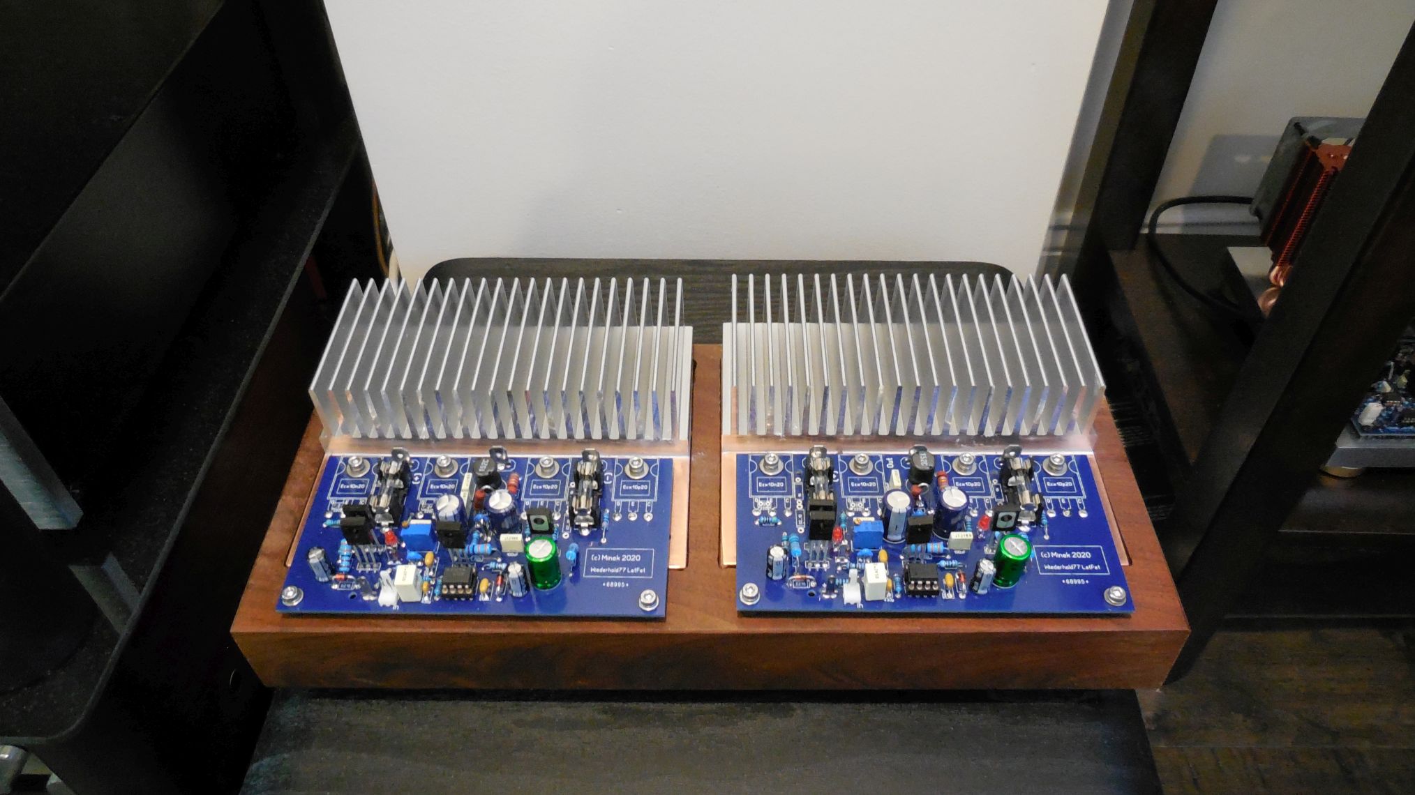

Mosfets matched, amp ready for testing. Will try to do it this weekend..
The idea is that 2 amps will be bolted to 1 heatsink, as shown, one next to each other, and - as usual - whole thing gonna be mounted on top of chassis (this time - wood (African Acacia), not Alu).
Assuming the testing will go well 🙂

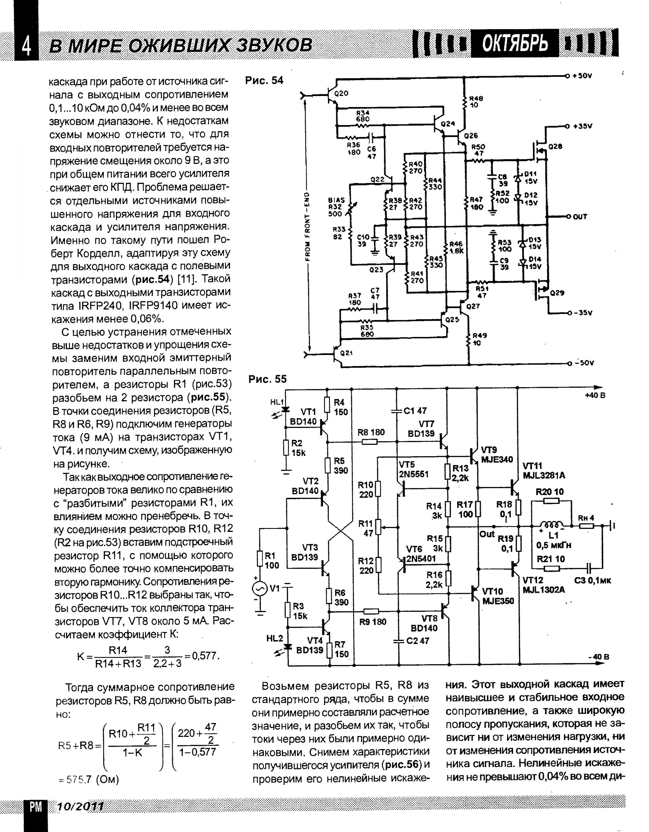

At the end of Wiederhold's article in RFE, there is a list of references. I was unable to trace some of the sources. Reduction of crossover distortion is achieved by deep overall feedback with optimal correction. Viderhold Topology: OPamp + level shifter stage (EF + CB) + Vas(CB) + kvazikomlimentarny outputstage.
"High-Impedance Drive for the Elimination of Crossover Distortion" - In the Russian radio magazine, this concept is called "transistor current control".

Sounds like the old idea that High-Z VAS will jump across the cross-over region due to the high-Z input of the drivers in that region. It works but is limited by natural CB capacitance in the VAS and prevents adding miller caps. The global feedback has to be a small loop. Maybe a cascode VAS would help.
More interesting is the variation on CFP outputs that 1: cross-couples CE outputs and 2: uses AC only local feedback.

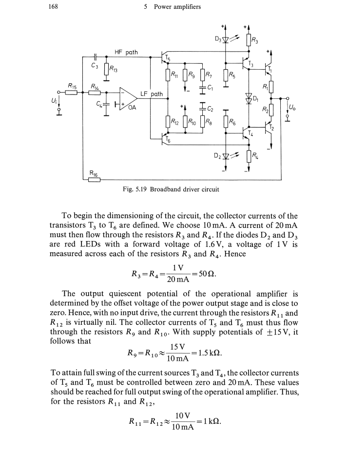

The 1st item on the "Literature" list in Wiederhold's article, is a book written 50 years ago by Tietze and Schenk: "Advanced Electronic Circuits".
As it happens, this book is still in print (I hope with updates..), and supposedly used at universities..
Authors describe this topology exactly as it is implemented in Wiederhold and Lomakin/Parshin amps. Here is page 168 attached.

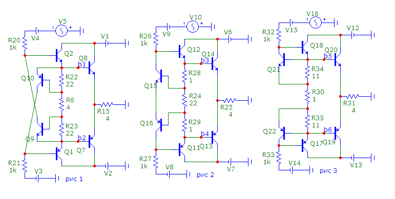

Guys, does anybody have any examples for Akulinichev bias spreader for mosfets?
Can you share them here?
Found this on vegalab. The Akulinichev bias circuit appears to be a variant of the Hawksford error correction circuit.
Thanks Egra!
Edit: not sure if this is the same thing as in the LMK amp..
Spreader in LMK (post #1) doesn't take feedback from the output, and the whole arrangement looks slightly different...
The 2nd example in your pic is more like it, but it's for BJTs. Will try to read about this Hawksford correction thing.
It would be worth simulating whether there is a visible difference. If I remember correctly OldDIY said somewhere this is not only thermal compensation, but also a tricky class B bias circuit. It stabilizes the output current and dampens switching processes.
