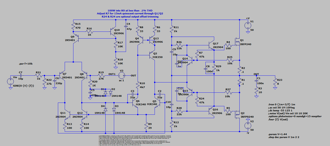

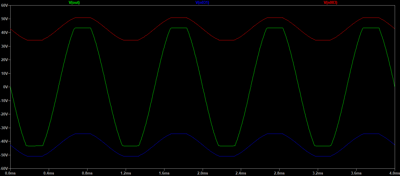

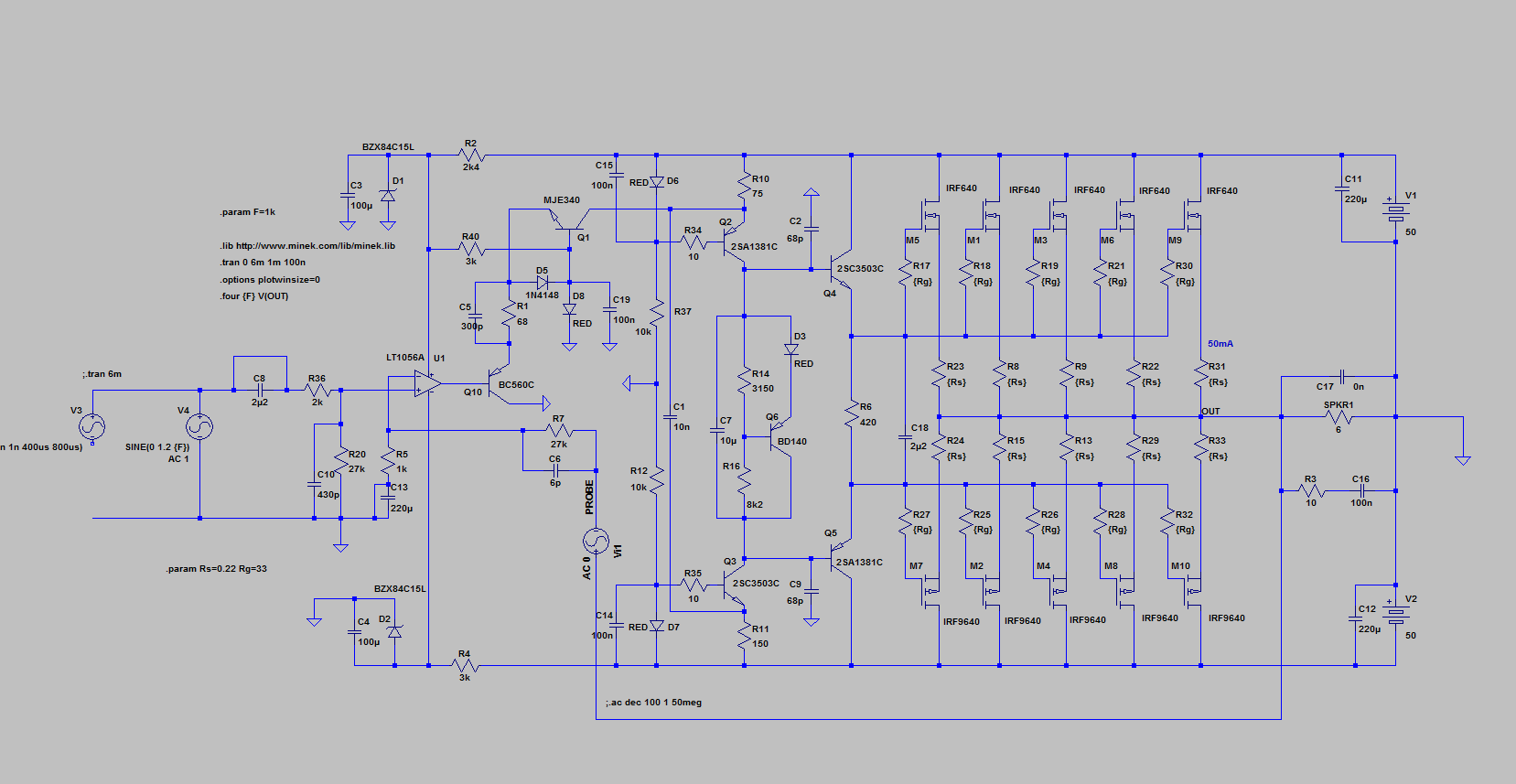

I've been working on bigger, symmetrical Wiederhold amp, described in this thread:
Symmetrical amp clipping behavior - help needed
But I'm kind of hesitating - does it make sense to go symmetrical, or not?
Results (except slew rate) are similar (see above thread for screenshots).
Symmetrical is slightly better, but that's only the sim, where all transistors are identical.. I have doubts if real build will have any advantage.

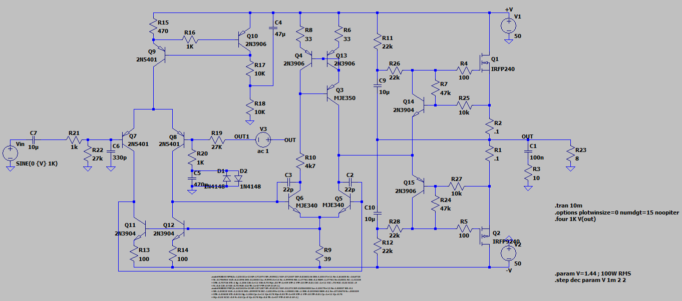

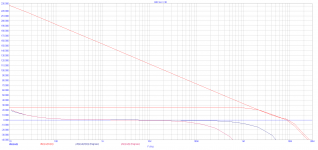

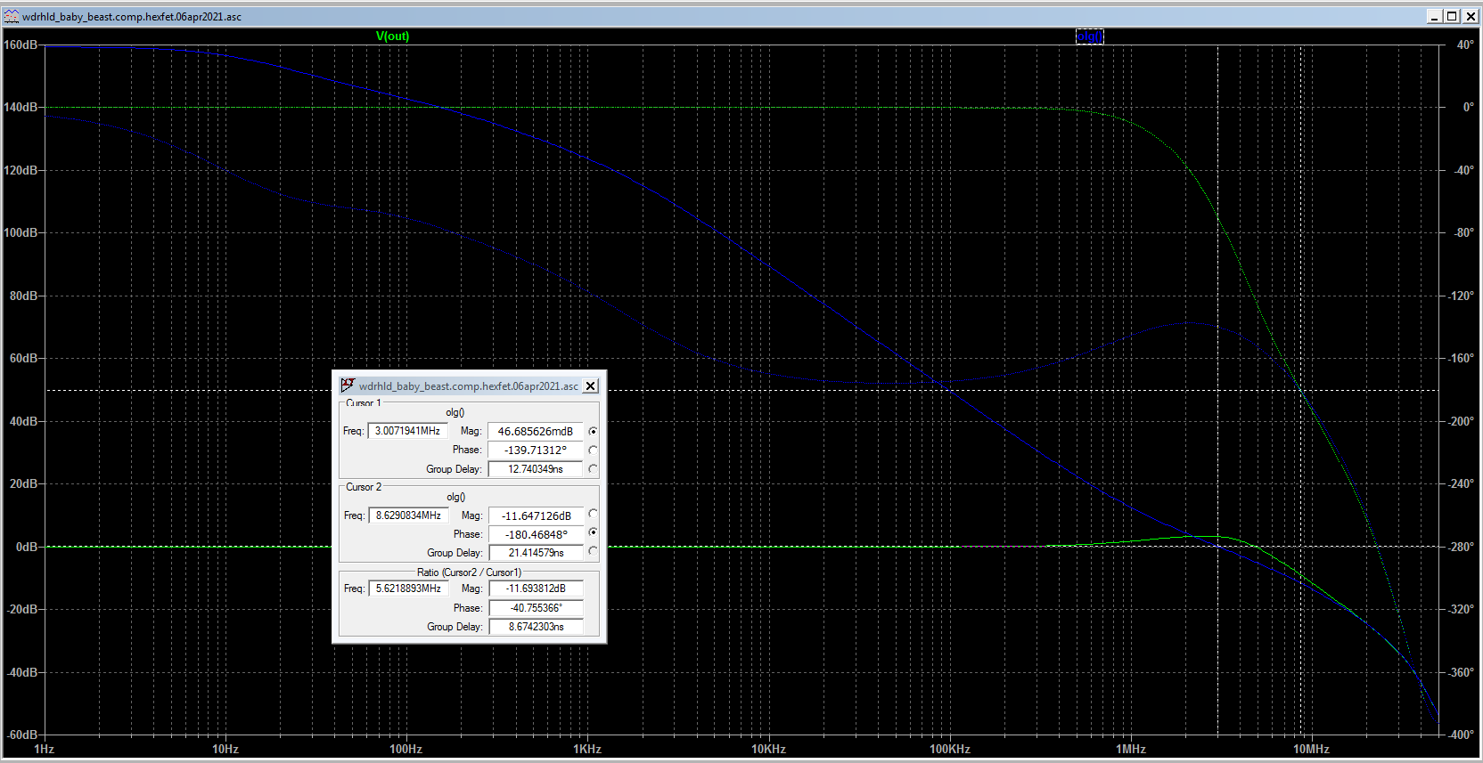

Here is non-symmetrical version, that also looks promising.
Currently trying to increase phase margin...
  • wdrhld_baby_beast.comp.hexfet.06apr2021.asc

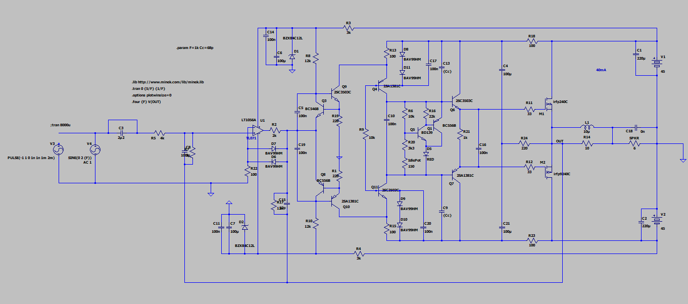

Symmetric with partial bootstrap
This is a symmetric variation that is fairly clean. I don't like (especially MOS) outputs that wastes several volts swing so this includes a partial bootstrap that reduces the output saturation to < 2V.
Note that the currents in the VAS are well defined. I would set the VAS current a bit higher than the stage before so that the VAS never reaches zero current, ie R19 > 2x R13.
I would probably add current limit if I actually built this.
BTW, IR640 are listed as obsolete.

But I have more general hesitation regarding symmetrical vs. non-symmetrical approach. Symmetrical amps usually sim very well, but are these results really achievable in real world? Transistors that are supposedly complementary, are not exactly the same, and the whole concept of symmetry is suddenly gone.
Even pairs like 2SA1381 and 2SC3503 differ a lot. You can't even buy them in the same Beta groups... In the sim it all looks great..
Symmetric IPS and P-P VAS
Typical symmetric IPS circuits, the VAS bias is inherited from the LTP rather than being defined locally, which means that part variations can mess up the bias badly.
Another issues with simulation is that supply voltage is "regulated" unless you go to the trouble to simulate supply ripple and variation in the simulation.
But P-P VAS can mean that the VAS can drive MOS outputs directly with reasonable slew rate, since you get twice the VAS current P-P for the same idle current and heat. LTC spice includes a "100W" amp example that has a P-P VAS but the bias is inherited from the LTP. The attached variation on the LTC "100W" example has a well defined VAS current and 140W @8 Ohms and much better THD from the same 50V supply.

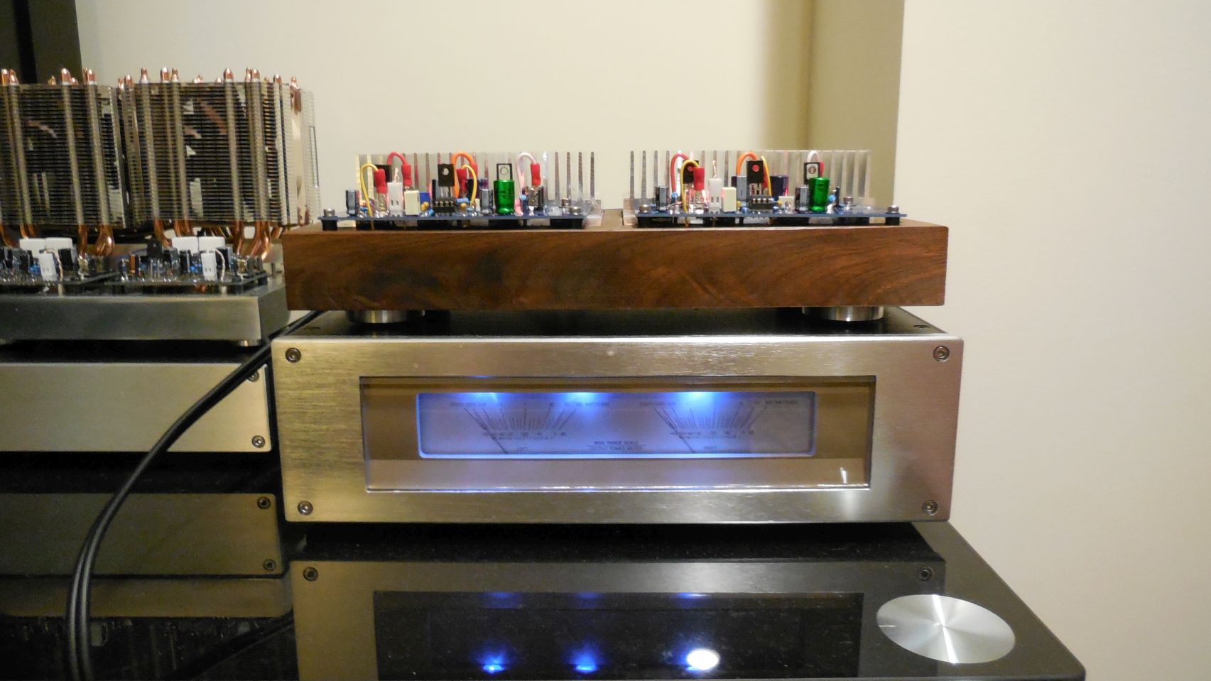

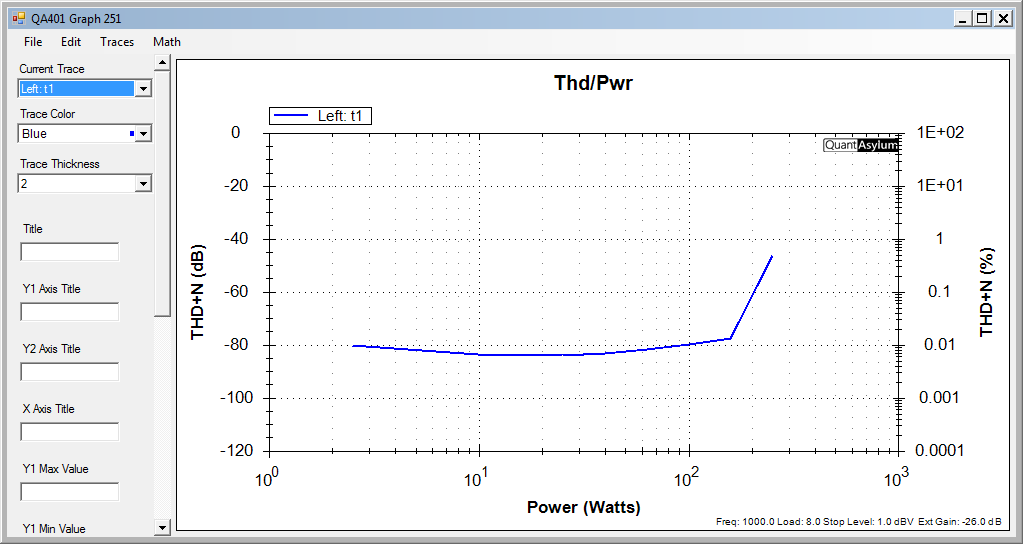

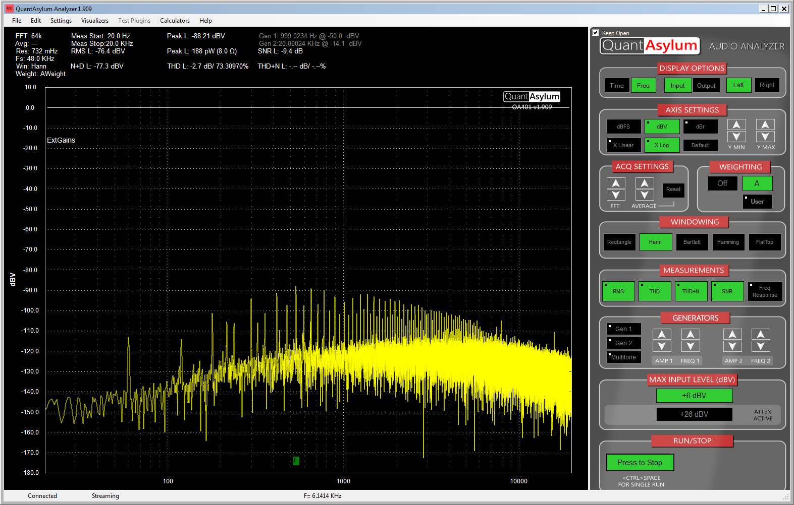

I finally managed to spend some time with QA401 audio analyzer.
First, had to build bigger 8 Ohm heatsinked 200W test load.
Still a lot to learn, but at least some results seem to make sense.
I decided to test LatFet Wiederhold amp from post #172
- at least don't need to worry about thermal runaway if it gets overheated..
This amp was designed and simulated for 100W RMS.

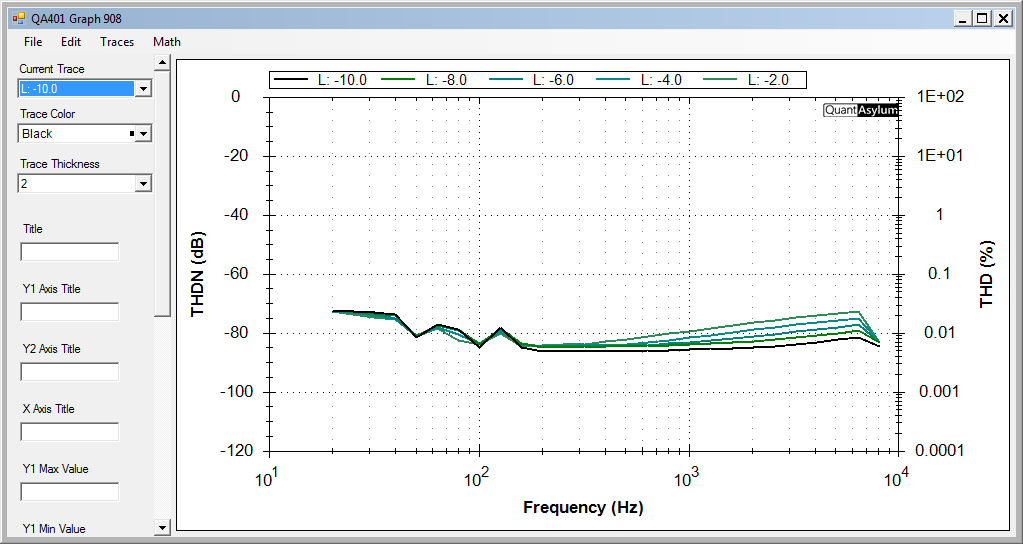

From these results looks like Thd (1kHz) is ranging from 0.0036% (2W)
to 0.0070% (25W). This is read from detailed test at each level.
Bulk test "Thd/Pwr" shows steady THD+Noise at below 0.01% until 150W (and then it starts to clip, and I can
hear the transformer buzzing slightly..)

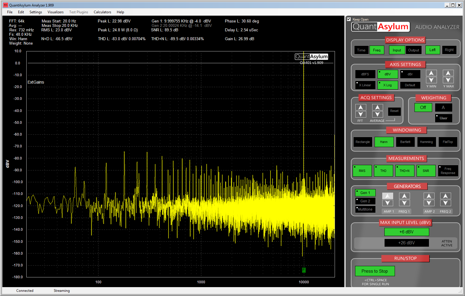

Noise levels (4th pic) are well below Yamaha and Technics amps I tried to compare it with.
5th pic - 10kHz at 25W.

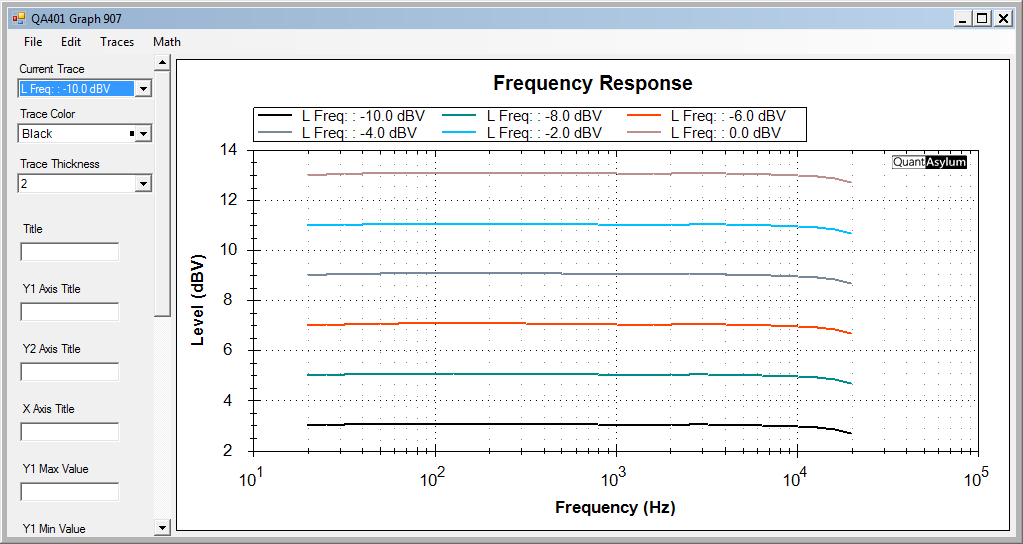

Frequency response looks very linear for all power levels (Highest plot for 0.0dBV corresponds to approx 50W).
It bends down a little close to 20 kHz.

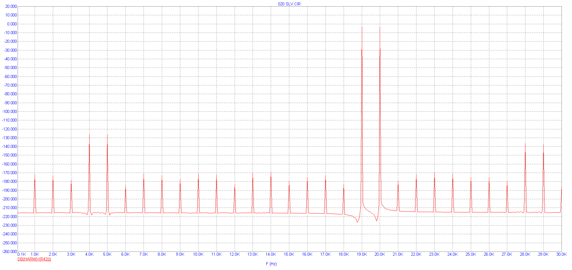

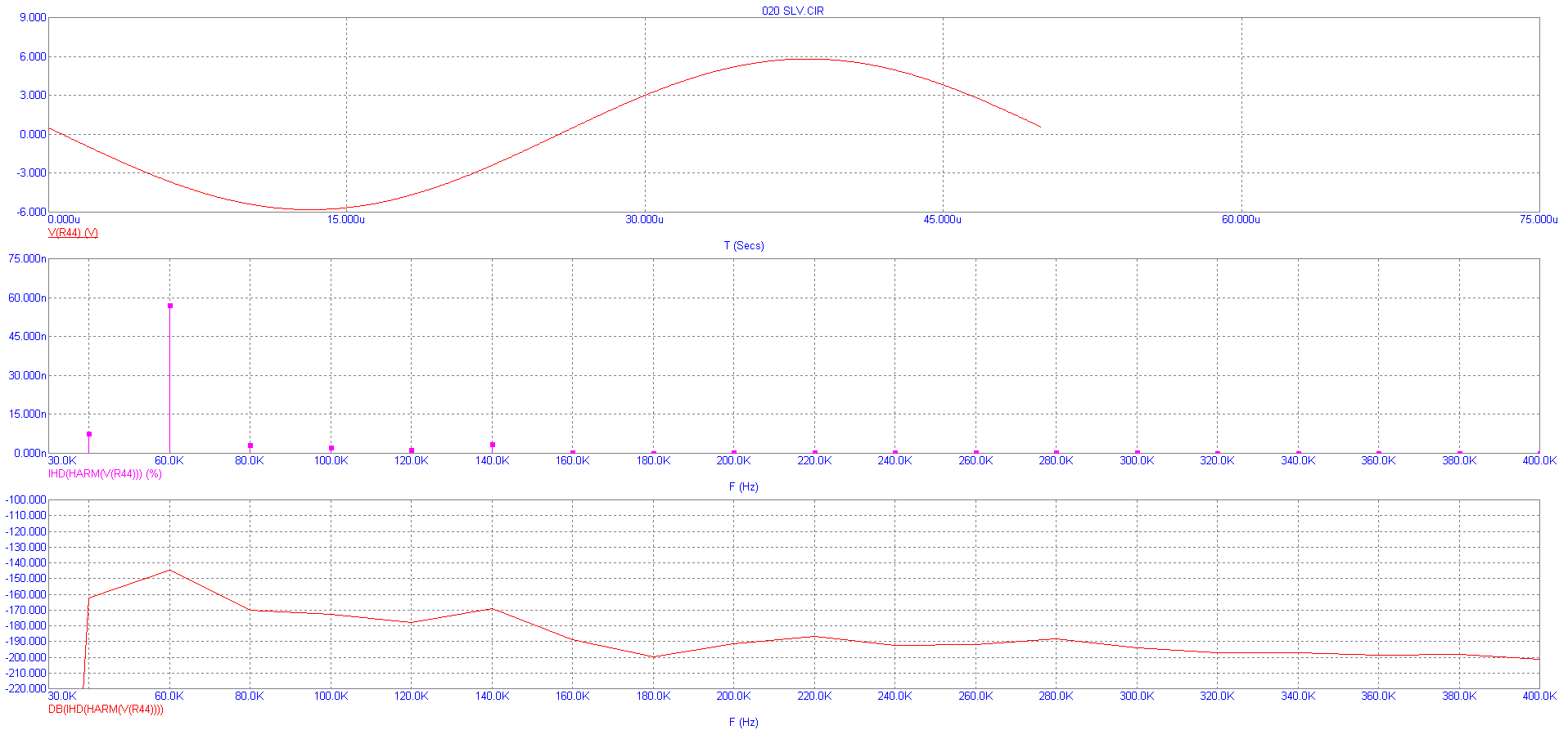

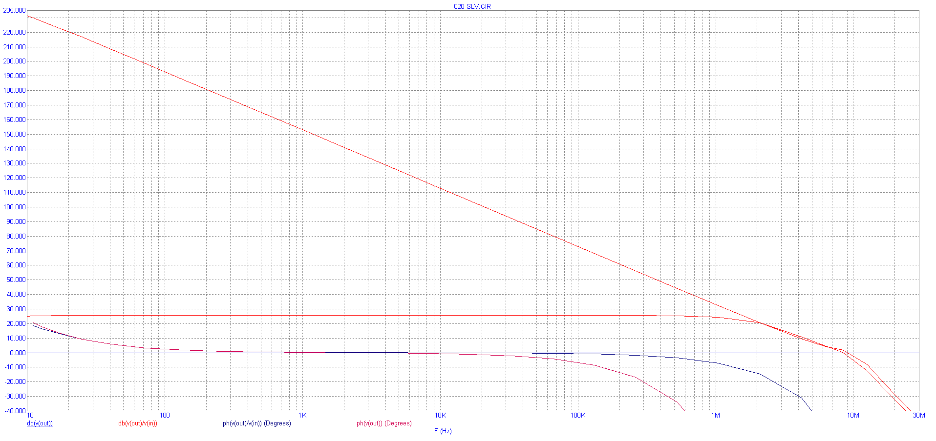

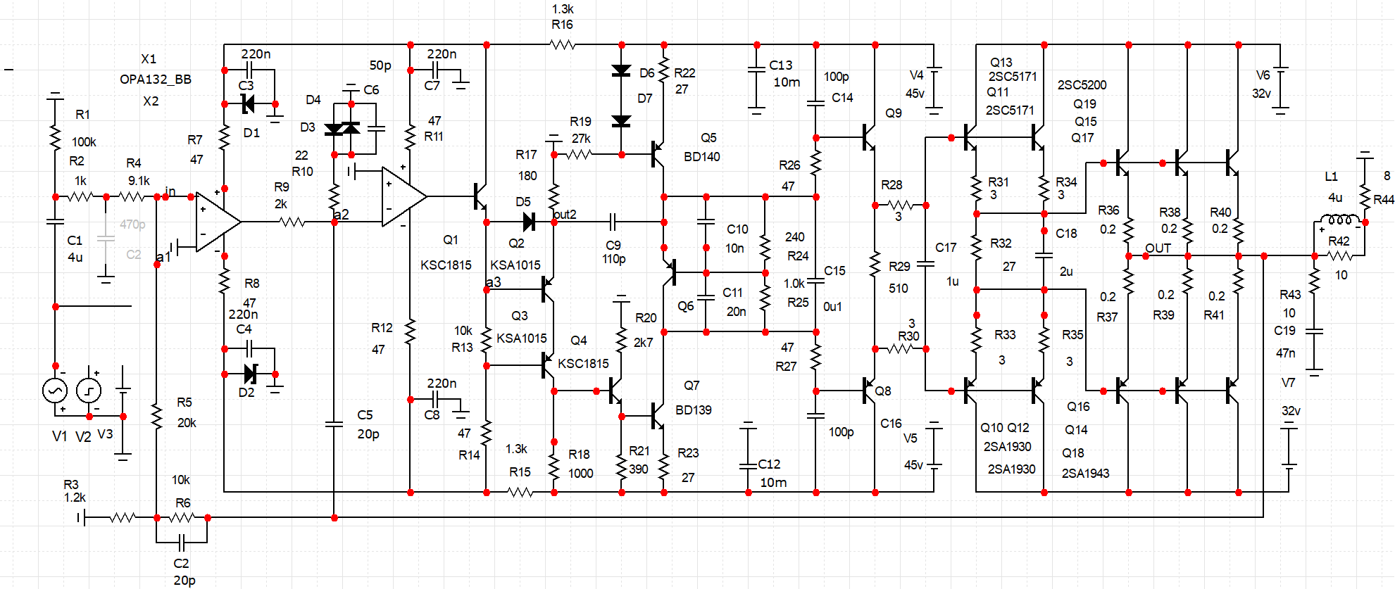

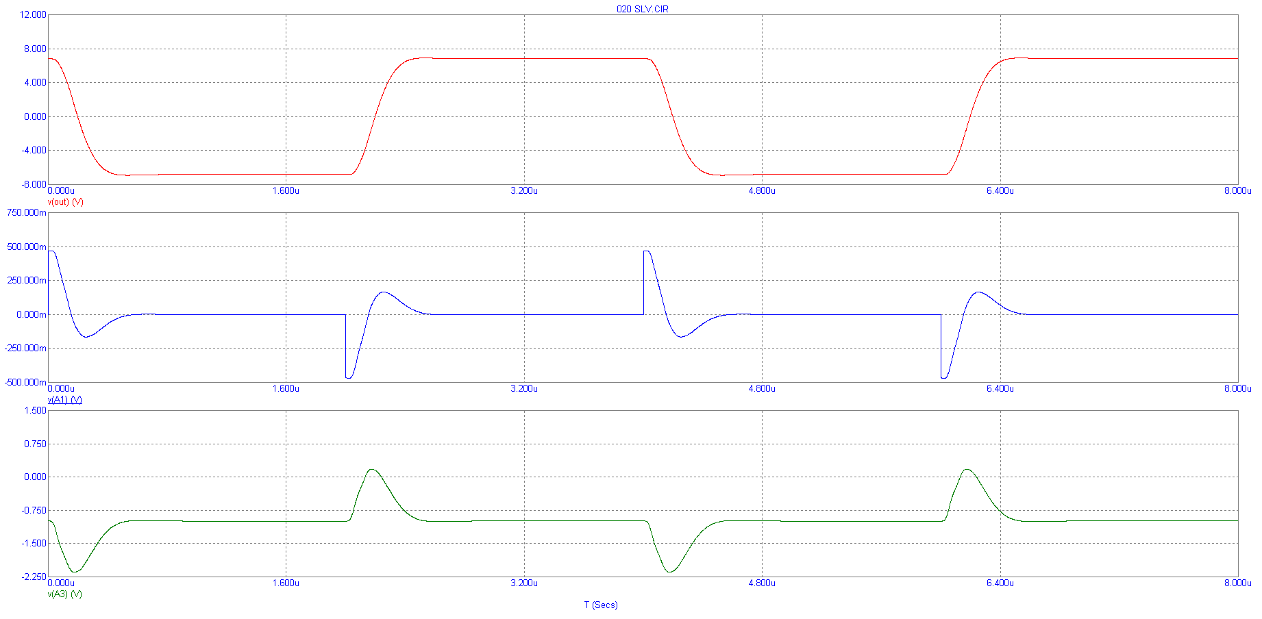

A phase-linear amplifier 020SLV with deep roots.Graphs of the analysis of the amplitude-frequency response and phase-frequency response, meander, IMD distortion of 19/20 kHz.
Looks good!
This one is not driven from rails of the 2nd op-amp, like you had it before.
That's better, I had bad experience with driving vas from op-amp rails.
Will reproduce this in LTSpice.
Выглядит неплохо! Этот не приводится в движение от рельсов второго операционного усилителя, как это было у вас раньше. Так и лучше, у меня был плохой опыт вождения ВАС с рельсов ОУ. Воспроизведу это в LTSpice.

Can you post clean schematic without voltages, so I can see all component values ?
Edit: I see you just did!
Pay attention to the phase-frequency characteristics with a closed and open common oos .First pole 2-3 Hertz. 10Hz-20kHz phase does not change
The first opump -OPA132/OPA134, the second opump-with a higher rate of rise of the output voltage.LM318 , LF357, AD744, and so on.
