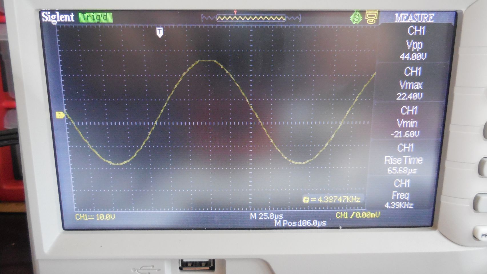

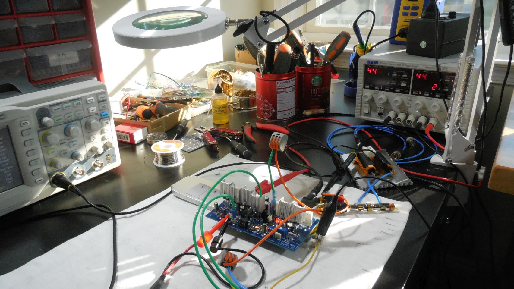

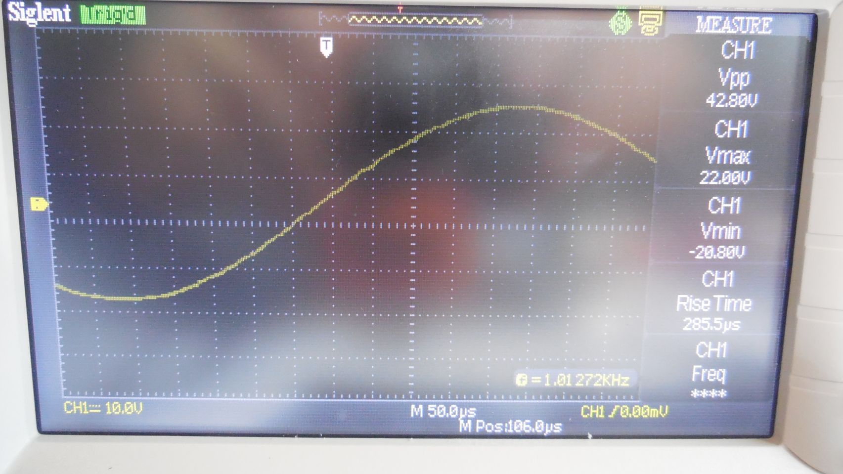

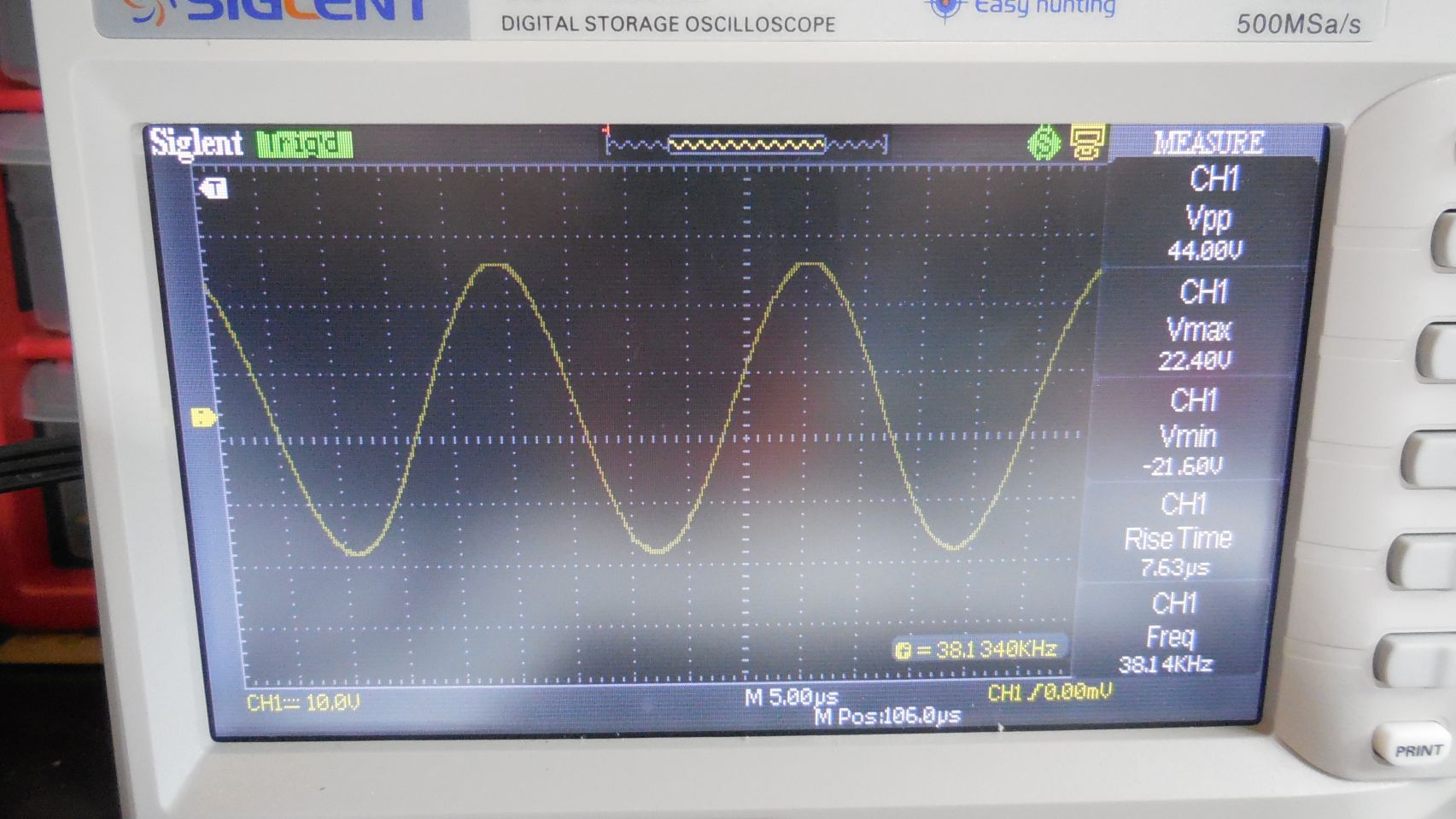

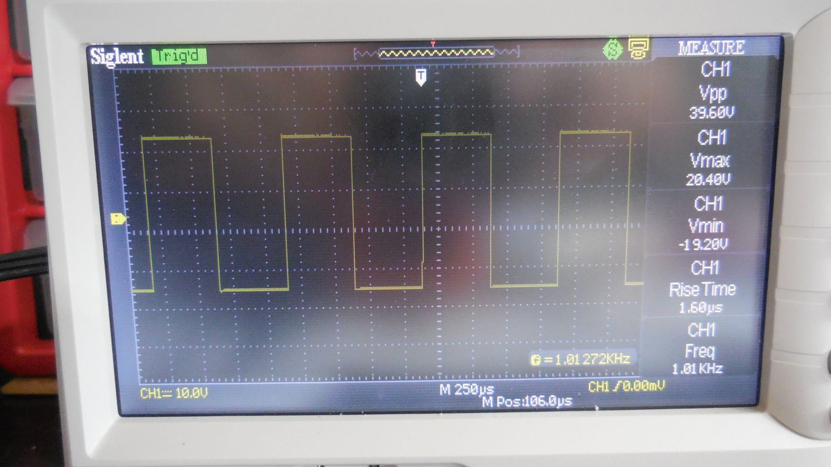

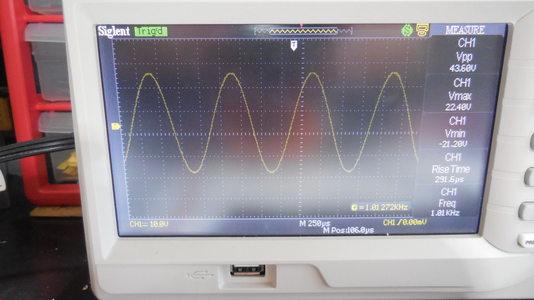

Testing of the amp from post #1020 continued:
Rails 44V, Idle current 50mA per device, no load.
2 pairs of IRFPs. TL071 op-amp.
All caps/resistors as in post #1020. D3/D4 on PCB.
1) Added resistor 68k from input (after C1 to the ground)
2) Input is not shorted to the ground
3) amp starts OK, bias stable at 50mA per device (11mV across 0.22 Ohm source resistor)
4) No load connected
5) Everything looks more or less normal - see sinus and square waves, BUT
6) It clips at 44Vpp (upper sinus), and after that goes into oscillations.
This is way too soon.
See screenshots when the top upper sinus slightly flattens out
7) Square waves show some little bumps on horizontal lines. Next time will try to zoom on these. Maybe this is oscilloscope artifact, maybe not..
8) Even in this seemingly stable state, amp is "touchy" - for example sometimes, if I try to measure voltage on source resistors, it may trigger oscillations...
9) BAD: If I connect the load (8 Ohm), it goes into oscillations immediately, even without signal, and negative rail drops from -45 to -5V. Zobel hot.
To be continued.

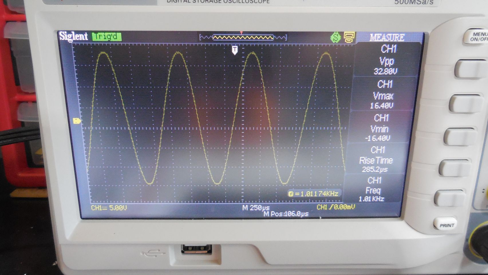

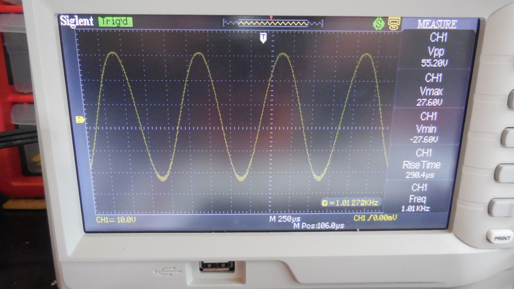

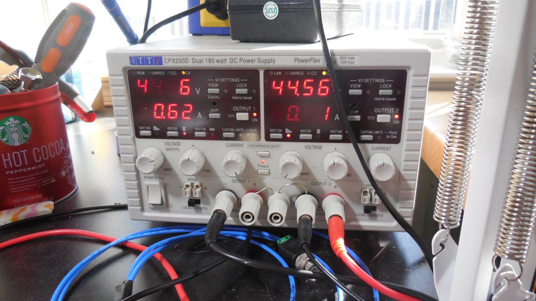

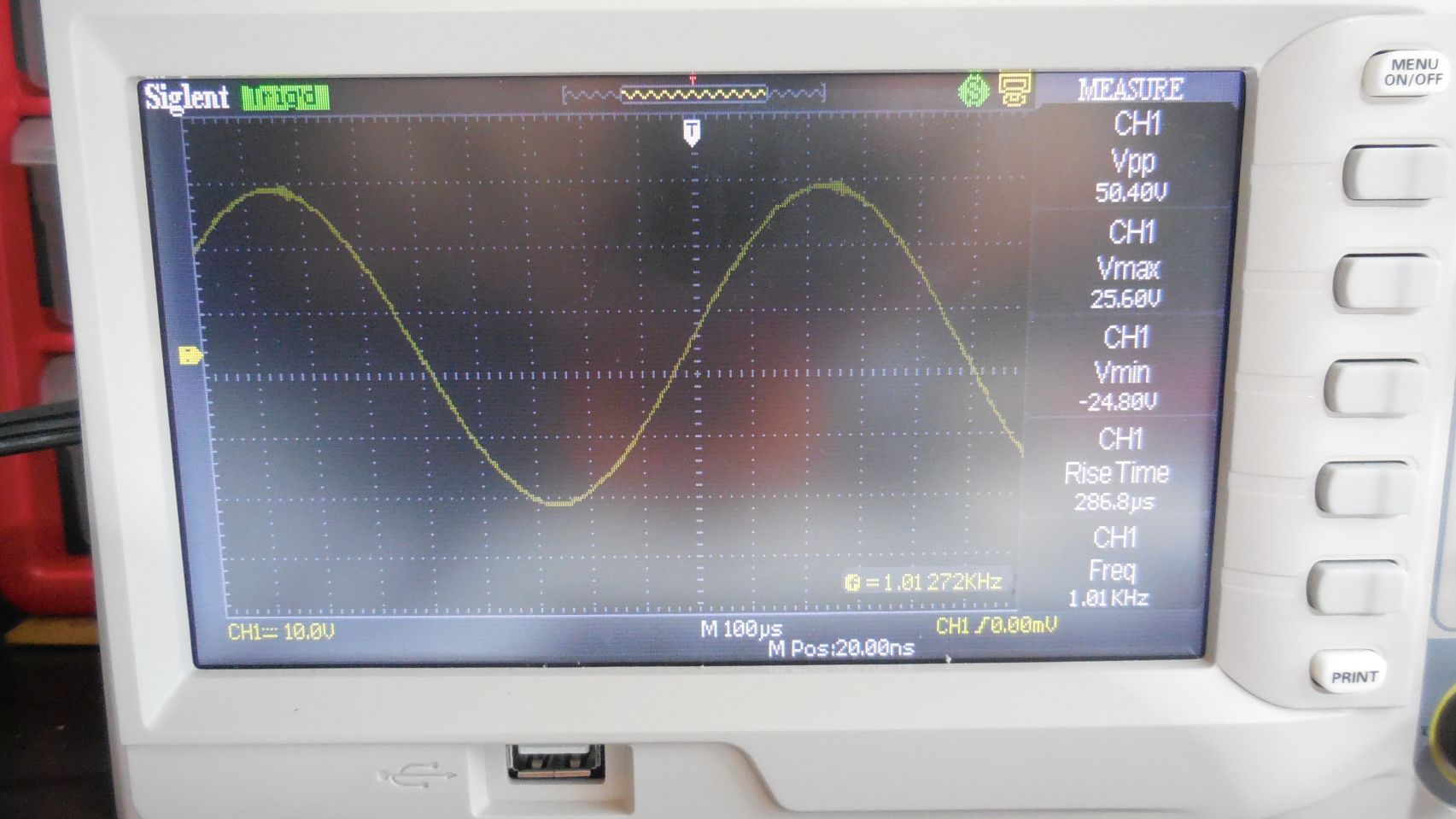

So if connect the load, and then start the amp, it will oscillate immediately.
But if I start the amp without the load, it starts fine - then I connect the load, and it works ok.
Looks like op-amp is 'latching'?
Continuing testing...
When amp is running WITH 8 Ohm load, it DOES NOT clip at 44Vpp like before (without load),
but it runs 1kHz sinus wave fine, until 56Vpp; current draw is little bit over 1A. Weird..
Small oscillation visible at the bottom of lower sinus.
Above 56Vpp on the output, negative rail drops to -5V again, and it oscillates.
Not sure if my PSU is running out of Amps at this point. It's supposed to be 180W PSU..

Похоже, операционный усилитель "фиксируется"?
Продолжаем тестирование ...
Когда усилитель работает с нагрузкой 8 Ом, он НЕ ограничивает 44Vpp, как раньше (без нагрузки), но он отлично работает с синусоидальной волной 1 кГц, до 56Vpp; ток потребления немного больше 1А. Странно ..
Небольшие колебания видны внизу нижней пазухи.
Выше 56Vpp на выходе отрицательная шина снова падает до -5V и колеблется.
Не уверен, что на данный момент у моего блока питания заканчивается ток. Предполагается, что это БП мощностью 180 Вт.
