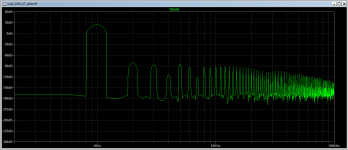

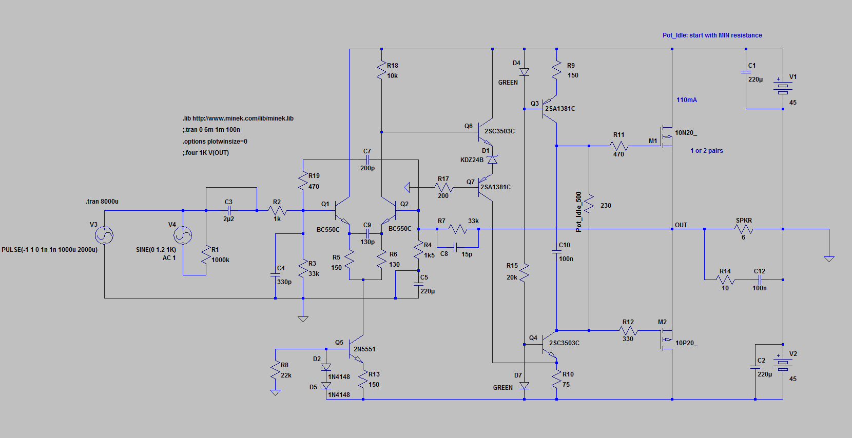

Moving on - Kletzov amp (1983)
I've been trying to make these maps little bit faster; 15V/us is OK, but would be nicer to have a faster amp.

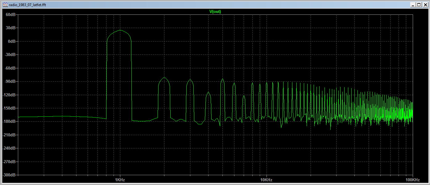

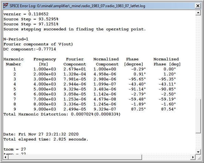

Here is an attempt: the same configuration for the output as before - Wiederhold style - but with LTP input instead of op-amp.
Thd and FFT look very good - but not as good (yet) as latest Maxim's amp..
Square waves look nearly perfect, it's much easier to tune, and more stable.
Slew Rate is about 50V/us - not too bad for such a simple amp, so this would be an improvement over op-amp based amps.
This is based on amp designed by V. Kletzov, published in Russian Radio magazine in July 1983, so it predates LMK amp.
Стр. 51 журнала <<Радио>> № 7 за 1983 год
This amp here gives better numbers than Vhex I tried to simulate couple hundred posts ago, and this is just 1st attempt.
LatFets are used here just for simplicity of the simulation.
Maxim, perhaps you see some way to make this better?
Perhaps lower LTP current to 1mA per transistor? Shift voltage in some other, better way (not using Zener)?

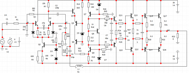

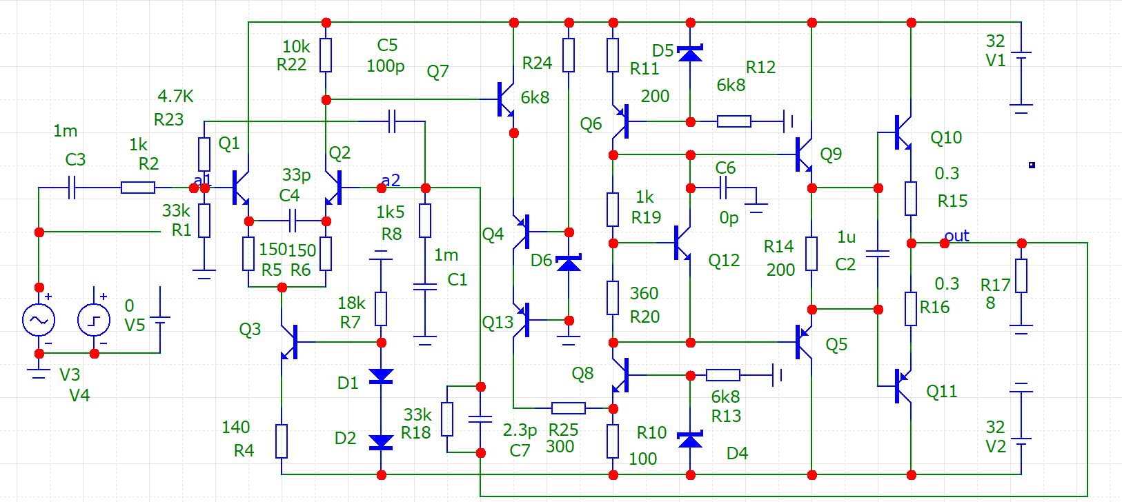

I have a model of this amp, and in real life I know how it works .I'll try to make it better. I'll show you tonight
Promised modernised Клецов .Close to the original .It seems to be a beautiful scheme turned out
R4 the selection of zero
The Rush has sufficient gain to work without IPS. See post 61.Promised modernised Клецов .Close to the original .It seems to be a beautiful scheme turned out
What's not to like about this scheme ? Sounds good ,but it might be better
1polus 35 kHz . with a loop gain of 65 dB at this frequency

Will try to play with it later today. But I think it looks promising.Somewhere like this
