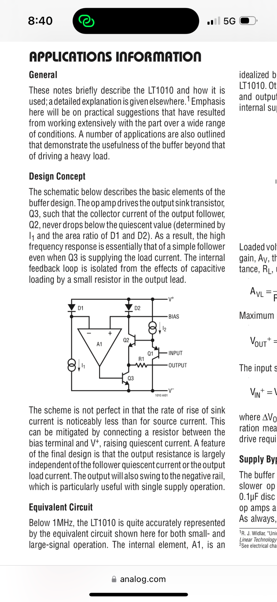

Is this buffer some variant of LT1010?

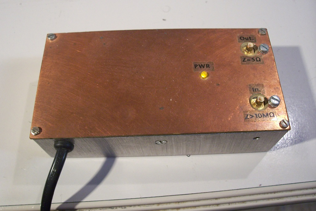

I'll post some pics of my build later

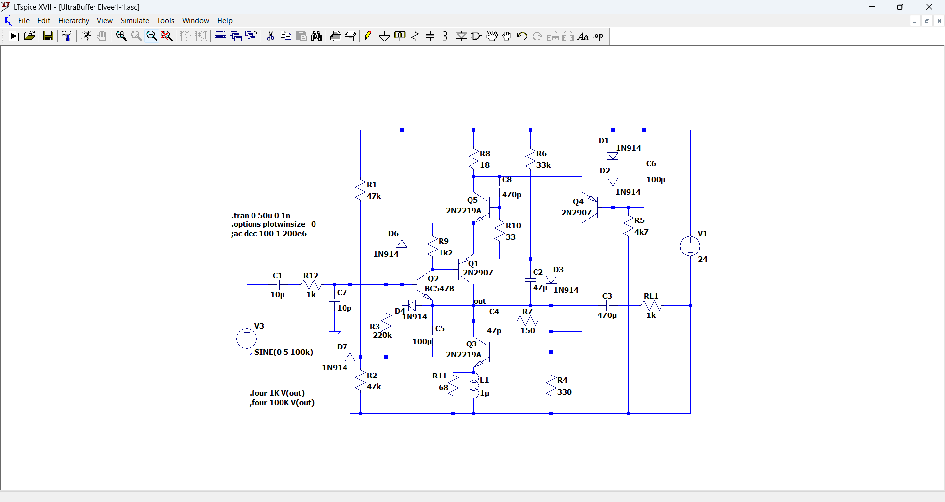

No, I mean protection diodes, at least D6 and maybe D7:

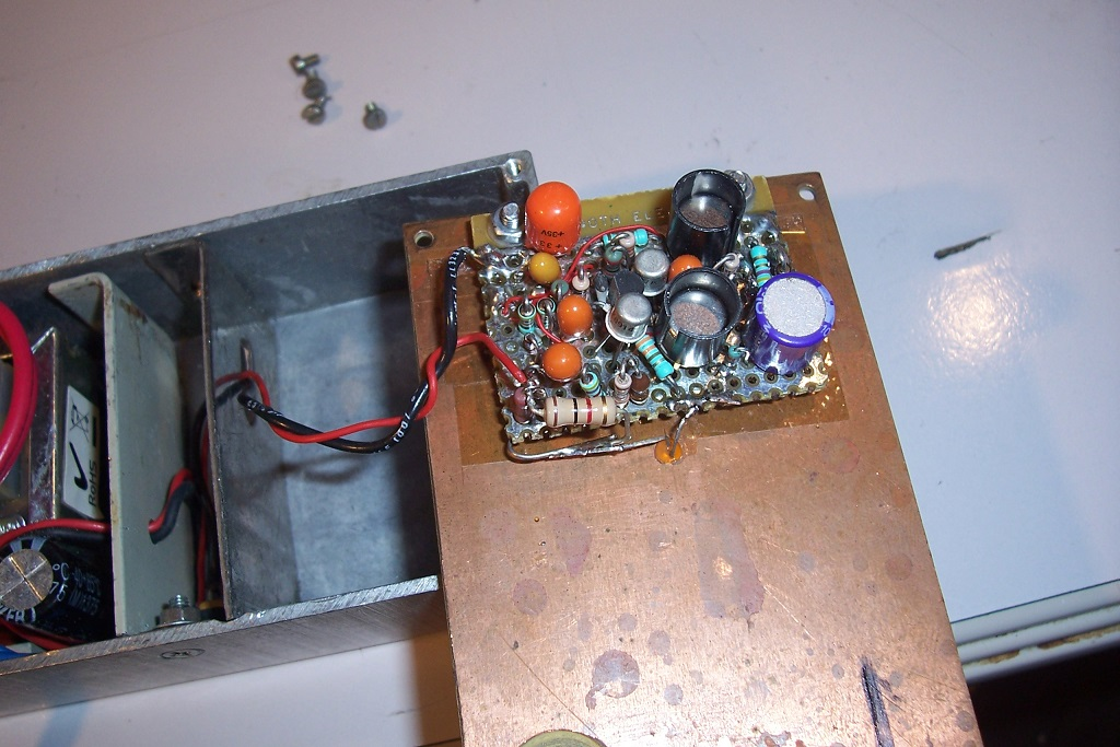

The actual OP transistors are TO5, like the ones used in HP instruments: something like 2N3866 or 5109 or 2N588-something, a fast PNP.

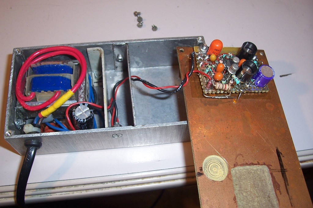

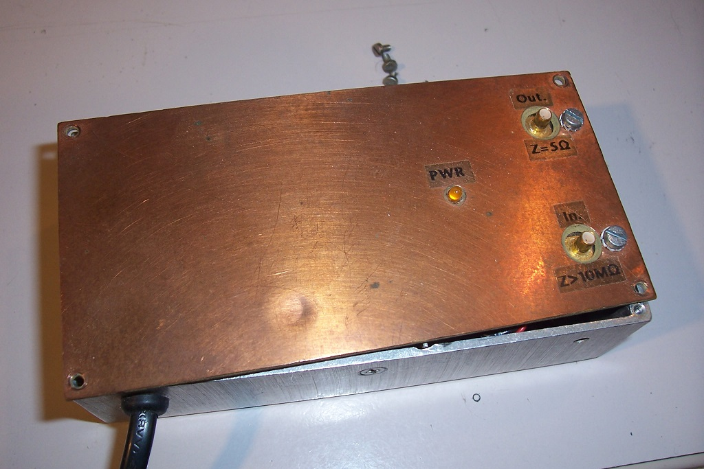

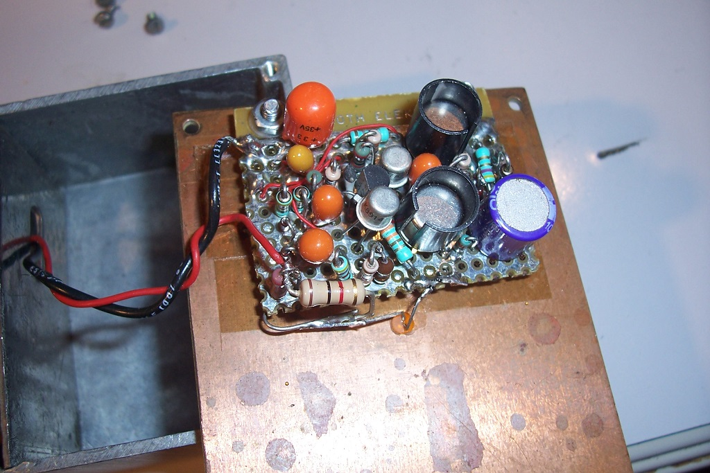

Here is how the thing looks:
Edit: IIRC the PNP output transistor could be a 2N5160; there must be a 2N588 something too, but I am too lazy to go up in my lab and look into my components drawers. Later
Reactions: petoluk
The BJT's in the sim have a lower power dissipation, which can be a problem in the real world, where the power can be much higher on a short-circuit: the device is essentially a lab accessory, meaning it has to take any abuse thrown at it

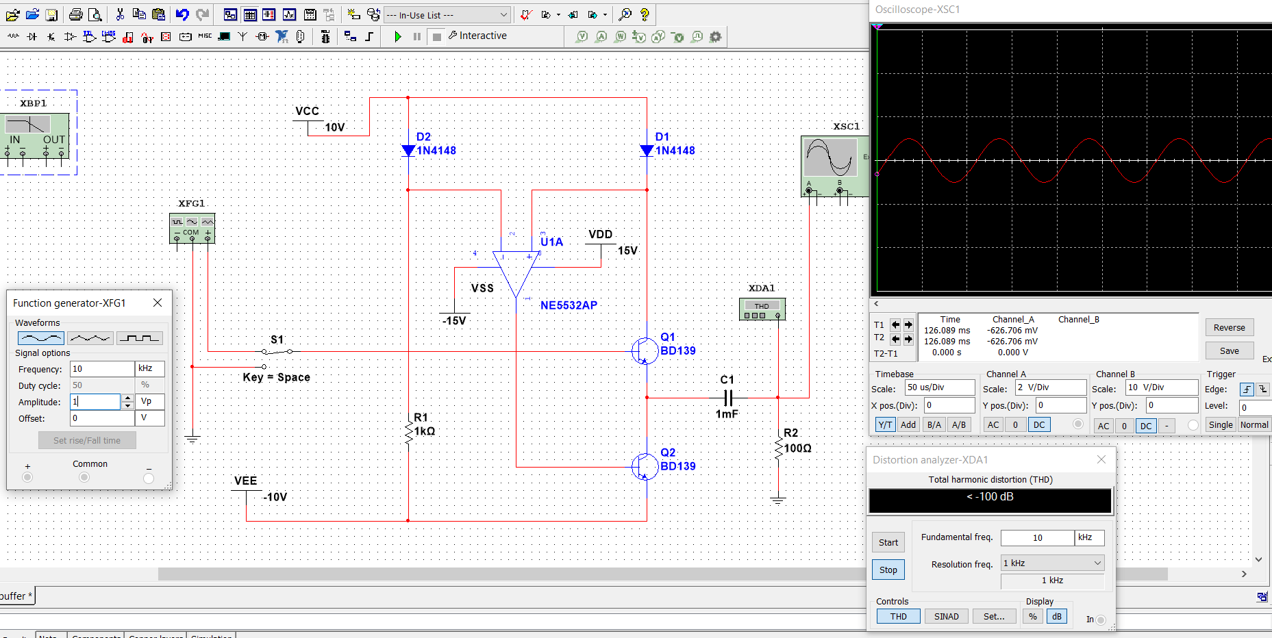

I changed to dual power supply 15VDC and modify a little bit.
This simple buffer can be achieved very low distortion and wide band. Even at 1 MHz the distortion still low enough.

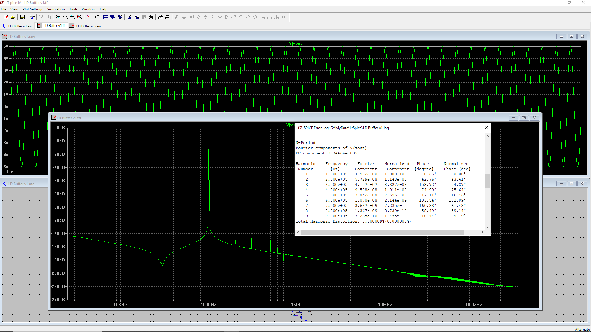

As I mentioned in the post #81, it is just a discrete implementation of the buffer chip LT1010. Here is a simulation of a simplified LT1010.
I recommend just using opamp in the position like below instead of building a discrete circuit. Thus, you don't need to figure out the stability.
@jxdking The load should 1K Ohm, not 100 Ohm for buffer. It is not for headphone amplifier. The signal frequency should use 20 kHz, the theoretical of highest frequency in audio. In my simulation, even with 100 kHz signal, 5 V peak, the THD still better using discrete. The bootstrapping should be compensated and the current source as load for the emitter follower also need compensation. The capacitor at base of emitter follower also important. The discrete is ALWAYS have possibility to have better performance than the integrated. And it make the discrete interesting.

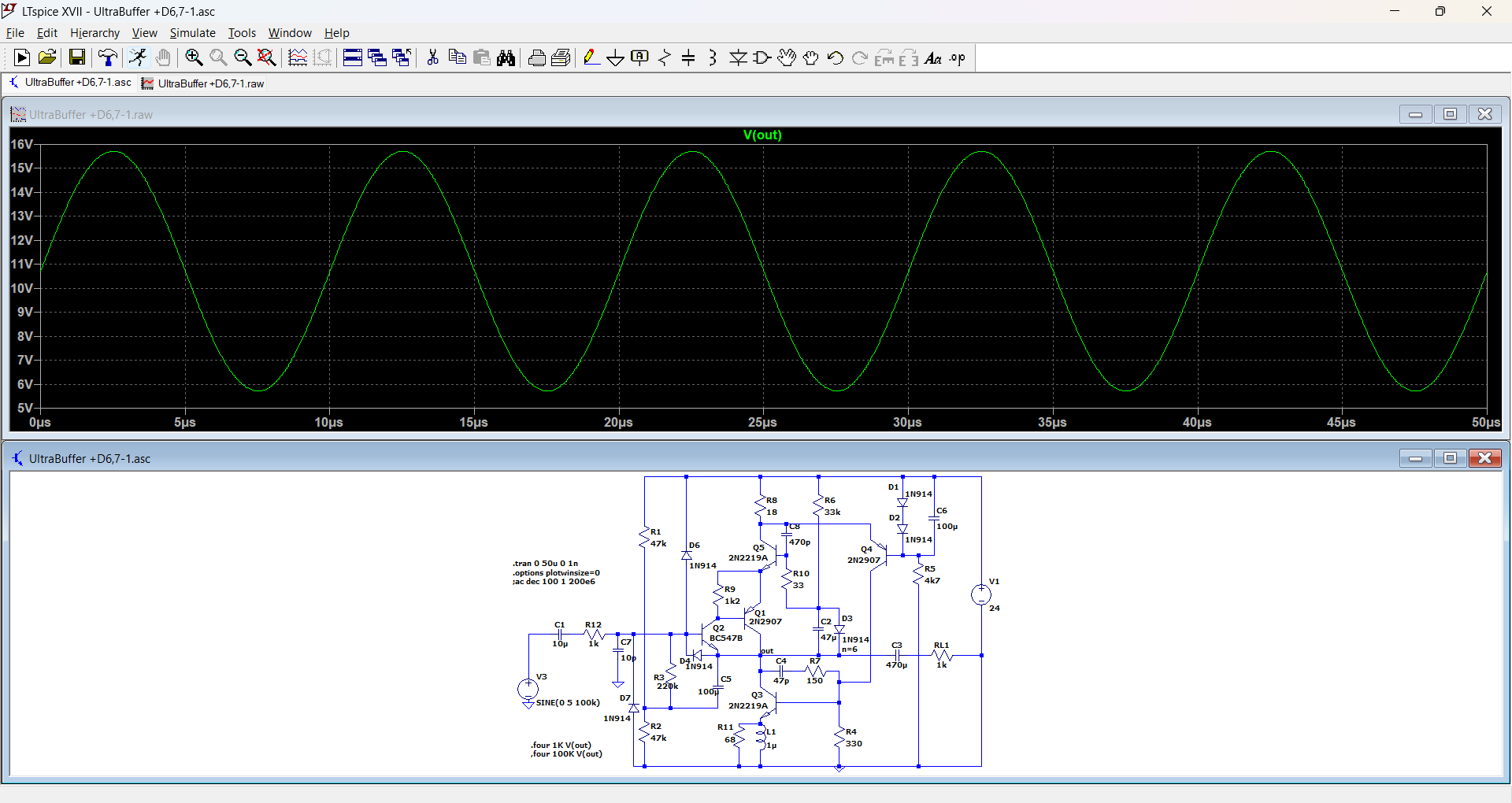

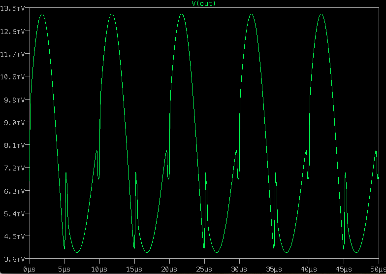

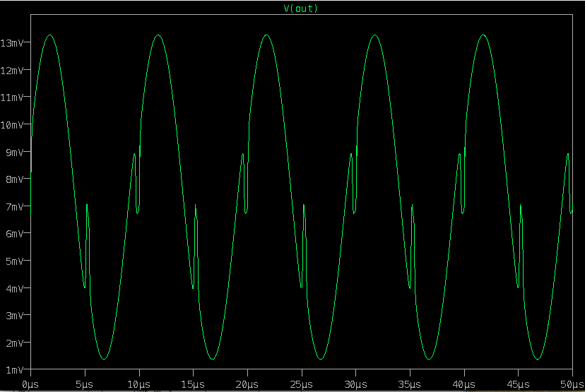

Only getting to this a few minutes at a time so no soldered progress yet but adding D6 and D7 to the asc file made for a change in the output waveform. I don't really understand what it means but It's interesting and thought it might be worth mentioning.

You have forgotten to add n=6 to the diode D3:
A random thought: if you intend to use this with an oscilloscope probe, you will have to add a resistor a little larger than 1 megohm (the bias resistor is bootstrapped and appears much larger than 220K) and increase the input capacitor to 15 or 20pF, to fall within the compensation range of the probe
Thanks for keeping watch. It's the first time I know of this way of adding series components and a reminder to me of the danger of not seeing what one doesn't already recognize. n=6 added and output trace is now beautiful in spice.
And just to be sure I understand : Your "random thought" advice above is referring to R3 and C7 ?
Many thanks !
