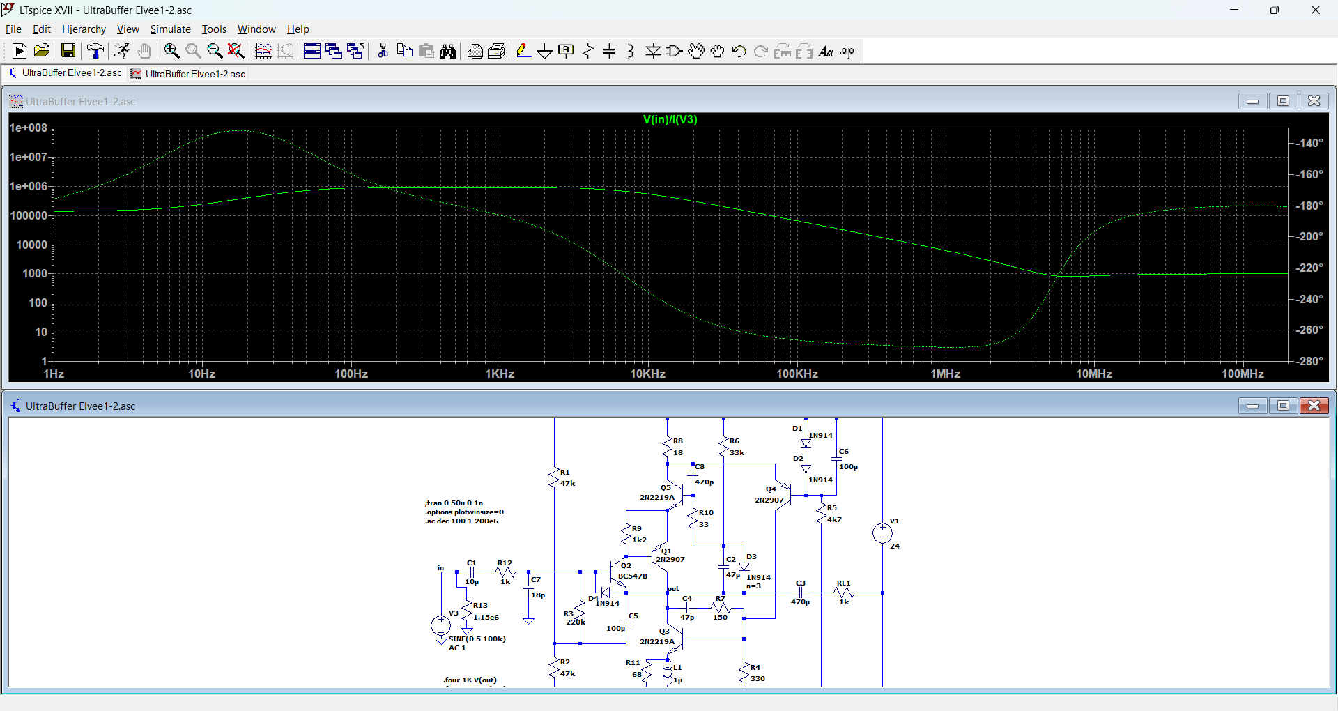

I hate to drag you into continued posts when you'd like to be done with it, but my interpretation of your words leaves huge doubt in mind. I have to check.

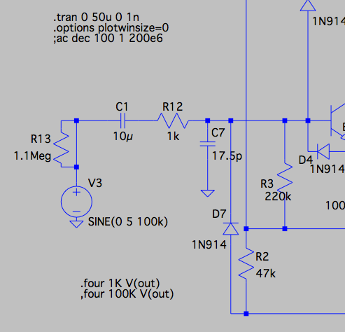

So by 1.1Meg in parallel with input and upstream, do you mean this? Input circuit revise.png I'll be surprised if you do. but this is what I hear when you say it.
No, the goal is to present a 1Meg resistive input to the probe -for low frequencies at least: at higher frequencies, the capacitance dominates-.
This is how to do it, but Ifind the VLF resistance disturbing low. The bootstrap might not work as intended in the sim. AFAIk, the physical circuit behaves as intended.
