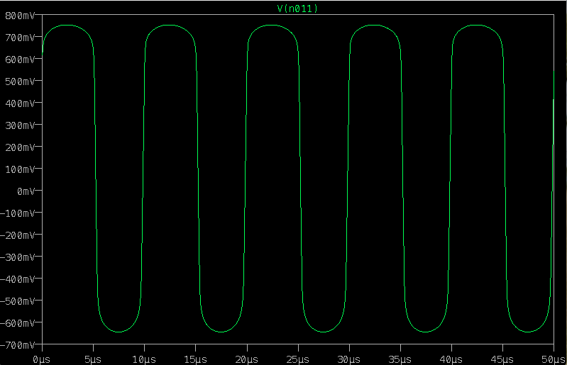

Voltwide had a good observation. I repeated his test and found:
1. disabling the cascode helped phase margin a little, but it was still kind of iffy.
2. Adding 100 pF from collector to base of Q1 gets pretty good phase margin.
Of course, if the sim and reality agree...that remains to be seen!
the sim tells you that the circuit responds to capacitance in that location.

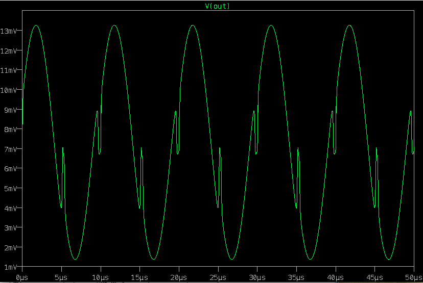

As I more or less expected, inserting an inductor anywhere near the filter has apocalyptic effects.

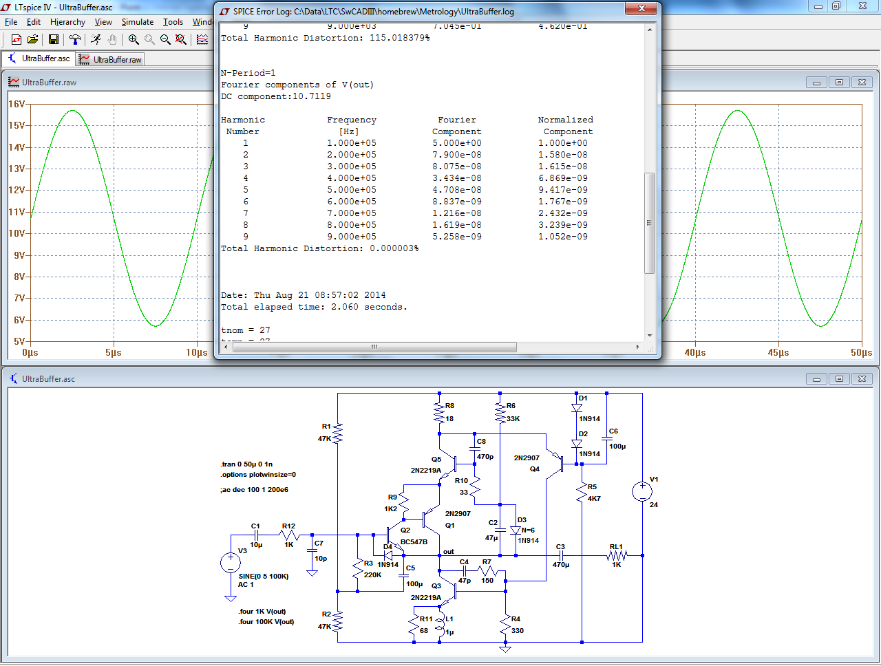

Fortunately, I have found an alternative way of compensating the cascode, which is not only stable in sim and reality, but actually manages to improve the linearity.
With this hack, the largest harmonic product of 100KHz is the third, at ~16ppb. The bandwidth is perfectly flat up to >10MHz, thus it begins to look good. That is in sim, of course, but that is the first step.
The trick was to use a Miller compensation instead of shunt. I also had to fix minor issues, like a low level instability under some conditions: a 68 ohm damping on the 1µH was sufficient to tame it.
Now that the circuit basically functions, I will be able to make more detailed checks.

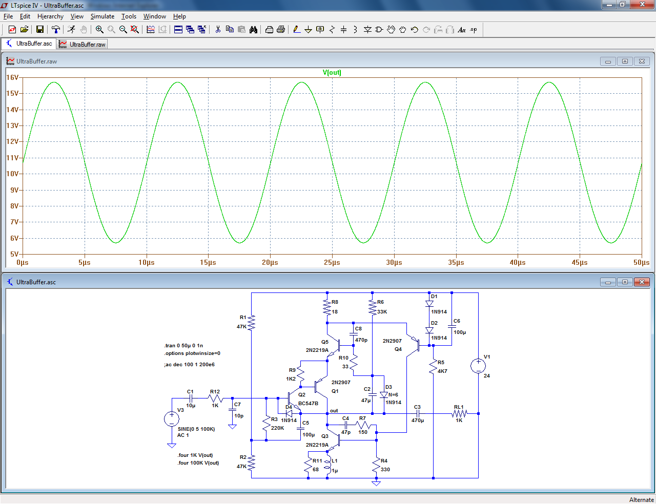

Here is the (provisionally) final circuit:
I played a bit with the circuit
Anyway, I do not like overall fb with multiple pole compensation at all.
It's wisdom. I am reminded of a professional class ( by MEAD ) that I took as a green engineer. An IC amplifier design expert from TI basically said, "just don't design circuits with more than two poles, whatever you think you are gaining from it you pay for in unreliability." But of course this is ASIC design where you have to design for +/- 30% component variation and -40C to 150C junction temperatures. So in a custom discrete design perhaps you can get away with it if you can tweak out the unpredictable parasitics.
And later as a more seasoned designer I had some intractable problems with a 3 stage high speed precision voltage error amp that just wouldn't be stable in reality, until we disabled remote sensing, despite good behavior in simulation and the best efforts of three experienced analog designers. So I am a big proponent of KISS design philosophy.
That said, as much as I want to make some suggestions to simplify this circuit's open loop transfer function, I am so intrigued by its design topology that I'll hold off on that for now... even though the inductor in the emitter of that last stage makes me so queasy.
But, this circuit evidently is trying to meet some really difficult and extreme performance criteria. Elvee, can you describe the operation and design method and/or point to some references for this topology? Can you concisely specify the requirements in a deliberate way so that we can properly consider alternatives that might be more robust against unanticipated parasitics but still meet the requirements?
These simplifications do not look advantageous: they spare a few inexpensive passives at the cost of ruining the performances and stability:
Remember, the original circuit achieves ~30ppb THD with 10Vpp ouput, and is stable: it has been tried and tested.
I am almost certain (certain in fact) that forgoing the stability components will lead to instabilities in reality, even if they don't show in sim.

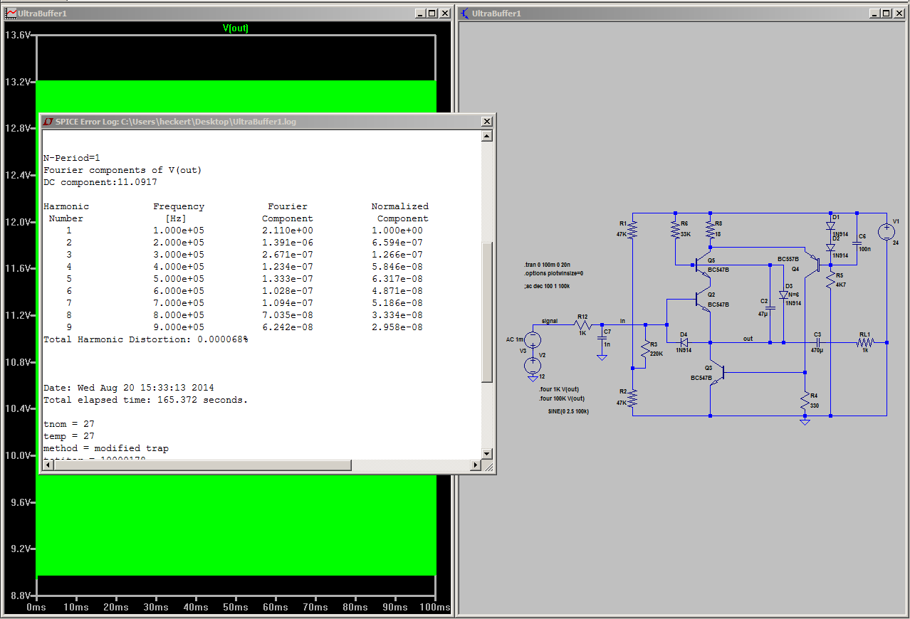

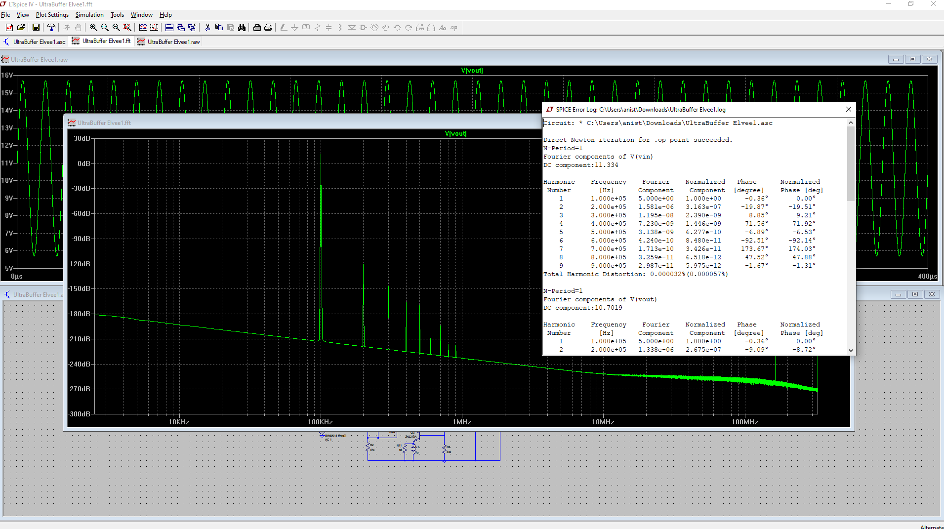

Hi Elvee,
I've been wanting to build a buffer for use with Jan Didden's AutoRanger when needing to probe higher voltages in tube circuits and finding your thread here, think your Ultra Buffer might be what I'd like to try.
I took the visible detail from the provisional final circuit you posted above, put it back into LTspice (asc below) and getting the output shown started by playing around with the resistance values of L1 , R11, which do modify the amplitude of the glitches but don't remove the little side steps. I think you might have entered other details for the various components and wondering if you can shed some light there, or at least on what you used in your working circuit.
And there I have two further questions:
First is , do I need to think about parasitic inductance of the 10uF input capacitance when choosing a real part. 10uF for 1000VDC can be pretty big. Maybe best to parallel or series smaller packages.
My other question is a bit more about your personal way of designing/drawing up the schematic. Do you tend to build your circuits with the same arrangement as in the drawing? In other words, when you're building it on a bit of perf-board, do you tend to work from the image, putting parts on the perf in the same order as in the image as you go from one edge to the other.
I don't know a lot but i almost always build circuits following using the schematic as layout and have been relatively lucky as far as oscillation goes, though I admit I don't know if there's any causal relation or not. The twitchy character of this circuit is making me wonder if you'd advise any specific cautions if using the sketch as a layout guide.

Hi Elvee,
The circuit was implemented as posted: it is the latest and current version.
But as I already mentioned, it is quite touchy and temperamental, and some minor deviations in the implementation could very well push it on the wrong side of the stability
In fact, you don't need 10µF unless you need a LF cut-of 0.001Hz: the input impedance is extremely large, and 100nF is certainly enough for the audio range, maybe even 10nF, I don't remember the exact value of Zin. For the same reason, the parasitic inductance doesn't matter
For your application, don't forget to add robust input protection components
Yes, that's the way to do it. I implemented it on a perfboard, using the schematic as a rough guide
