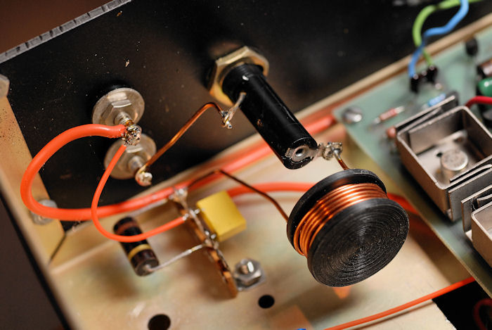

OK, here's my output inductor. I machined the bobbin out of Delrin. It has a 1" diameter by 0.375" wide winding window. I can't see exactly, but it looks like ten turns on the thing. The wire is AWG 16 solid magnet wire with single build insulation. You can't see it, but the other 10 ohm resistor is soldered directly across the back side of the inductor. For whatever reason I never had good luck with inductors wound on resistor bodies, regardless of resistor type. I think the form factor was just ineffective. This inductor measures 3.25 microhenries with a Q of 1.6 (@ 1kHz) and the DCR is about 13 milliohms, though I could be slightly off on that. (measured without the resistor on the back side) No doubt my construction is a bit wide open, but this amp was a "mule" that was taken apart and reassembled many times. I built it for development, not for compactness. Oddly, I built my first Tiger for compactness. It was impossible to service and had all sorts of oscillation problems. Had I known what I know now, I probably could have fixed it by changing the output inductor and a few other tweaks. That was many years ago and I ended up trashing the entire chassis and starting over. Too soon old, too late smart. Or at least not quite so dumb.

Conrad,
Are you saying that moving the output inductor OFF the board causes the amp to become stable??
The improvement in the inductor itself noted, but is that a requirement for stability?
Is it one or both of the above - AND - if it is the second then what exactly is causing the problem using the stock inductor??
_-_-bear
Hi Bear,
The original Tiger inductor was never on the board, but was wired from some junction to the output connector or something- you'd have to look at the links way back at the beginning to see exactly. IMO, the improvement is the high-than-normal inductor value more than anything. I seem to remember that when Tigers have problems it occurs at something like 6 MHz. The inductor shown should maintain good behavior way beyond that. Also, FWIW, I did some very fussy amps some time back and the output inductor construction is more important than sometimes thought. Any core at all, even resistor wires, increases the THD over what you get with an air core inductor on an inert form. I don't know how important damping really is, considering wire resistance, but much amplifier damping is lost to resistance in the output wiring, including the inductor. The inductor shown gives good measurements at the amp terminals, if nowhere else!

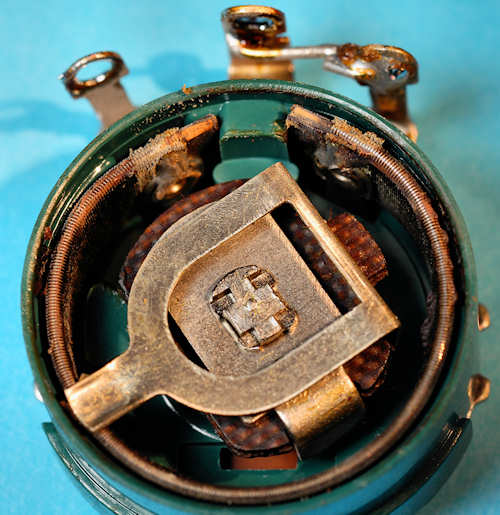

OK, I must eat my words on Tiger reliability! They do fail. The last couple times I powered the thing up, it was running hot. Measuring the bias on one channel showed several hundred mA, and the bias pot was only allowing it to be set high or near zero. After 31 years the Clarostat wire wound pot I had used for the bias adjustment failed. Actually the lubricant just hardened up and prevented contact. Photo of the guts below. I could have cleaned it, but decided to just replace the pair with new pots.
Now, you have to get up pretty early in the morning to blow up my stuff- I always install a safety resistor across my bias pots, so if they go open the amp won't be damaged by excess current. I had done so in this case and it paid off. Admittedly 31 years later, but it paid off.
BTW, I also looked at some notes from the last time I fooled with it, and I had reduced the feedback cap to 50 pF and increased the LF feedback cap to 1000 uF.
