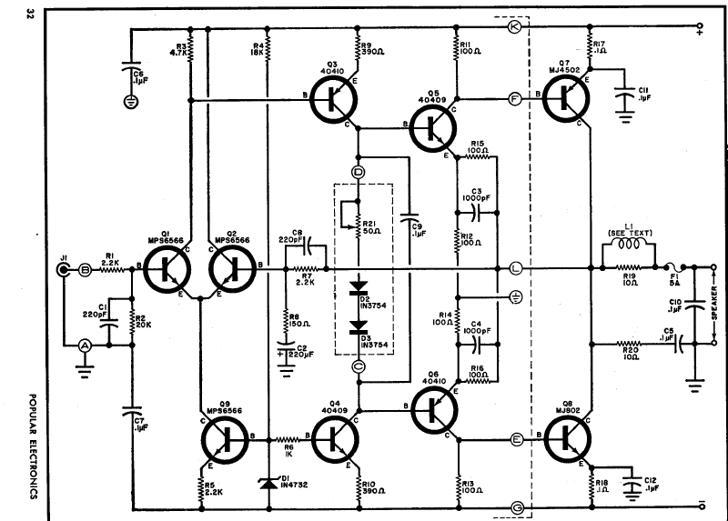

In the late 70s, my friends and I assembled 3 "Universal Tiger" amplifiers degigned by Dan Mayer and sold by SWTPC.
After a couple months of operation, they all blew their output transisters. Recently I was browsing Dr. Leach's site and read his comments regarding the design."These amplifiers were very unstable, causing them to oscillate, overheat, and blow tweeters."
I find all this strange as, at the time, the Hirsch-Houck Labs gave the amplifier very high marks for sound quality and stability
Have you experts ever looked at the schematic to determine what could have caused the problem and how it can be resolved?
I would appreciate your comments.
I attach a copy of the schematic.

Put small ceramic capacitors in each input transistor and also in the second stage.
Your oscilation will stop.

Ouch, c8=220pF, and no cdoms ? It's a wonder that it does not
oscillate permanently...
I would reduce c8 to 22pF, and add cdoms (B-C) of ~68pF to
Q3 and Q4. But these modifications will definitely change sounding.
Also, it's very likely that the amp selfdestruct with heavy clipping.
No care has been taken, that the cfp-output breaks down when
overdriven by clipping.
And what the hell does c10/c11/c12 ? Has oscillation been stopped by
applying a permanent capacitive load ?
At least c11/c12 guarantee that this amp does not oscillate very long.
And biasing a cfp-output with 2 diodes+pot ? Big nono !
If the pot get's dust, the amp will blow.
My recommendation: Do NOT build this one !
It might sound good, but at least a bit of reliability is a must.
You can redesign it, but then it's some standard ClassAB.
Mike

MikeB,
this amplifier use same output stage configuration as the ETI466/480. The output stage has voltage gain too. This is about 2. The C3/C4 make some phase compensation, and the C11/C12 do same at the highest frequencies.
The planner not use Cdom, because of the large local feedback at the VAS, which is reduce the open loop gain. This combination has some advantages, such as the peak output voltage is very close to the rail voltage.
The bias is not so critical, because of the CFP output stage, but there must be better to make some local DC feedback...
sajti
I built these amplifiers as a young kid and yes they did blow up often. They seemed to go unstable with no output load, sometimes with the input unplugged, perhaps picking up RF, perhaps if clipped too hard. Not always sure what did it. What I did notice is that often C3 and C4 (polystrene) were melted, hmm caps are not supposed to dissipate energy but also R12, R14, R15, and R16 were badly burnt and being physically close might have caused them to melt. Eventually, I did the analysis and these resistors should be over 1W each, 2W to be safe, they were 1/2 W in the original design. Higher wattage resistors here helped very much. The design has an output stage gain of 2 which means the output can be driven into saturation and "stick" before the voltage gain stage clips which is not a good thing.
Feedback from the voltage gain stage to the neg diff amp input, might help compensate the amp, but really some analysis should be done first. I would not just go tacking caps in here and there to try to stabilize the amp. I'd be really curious to hear if anyone has looked at this design in SPICE.
I doubt the designers ever did stability analysis of this design just trying to "tune" it in their prototype which did not seem to work out very well.

The article delt mainly with 2 factors, one being that in one of the amps he rebuilt, it had half the output devices were pecor brand and the other half motorola. the pecor units are/were infieriour and would cause the amp to osccilate and blow up.
secondly there is a problem with the bias resistor stack wattage rating in the original schematic. The article calculates the load and resizes the bias resistor wattages much larger and this seemed to fix the problem.
I even remember the author talking about how he had miswired the amp accdentally during testing and the output was shorted and the amp still produced 4V across a dead short (according to the author) before it blew a supply fuse.
