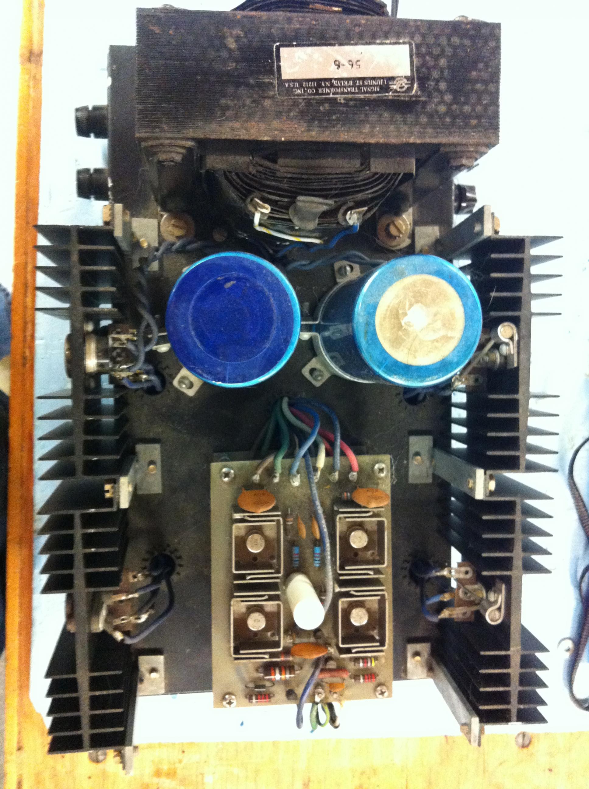

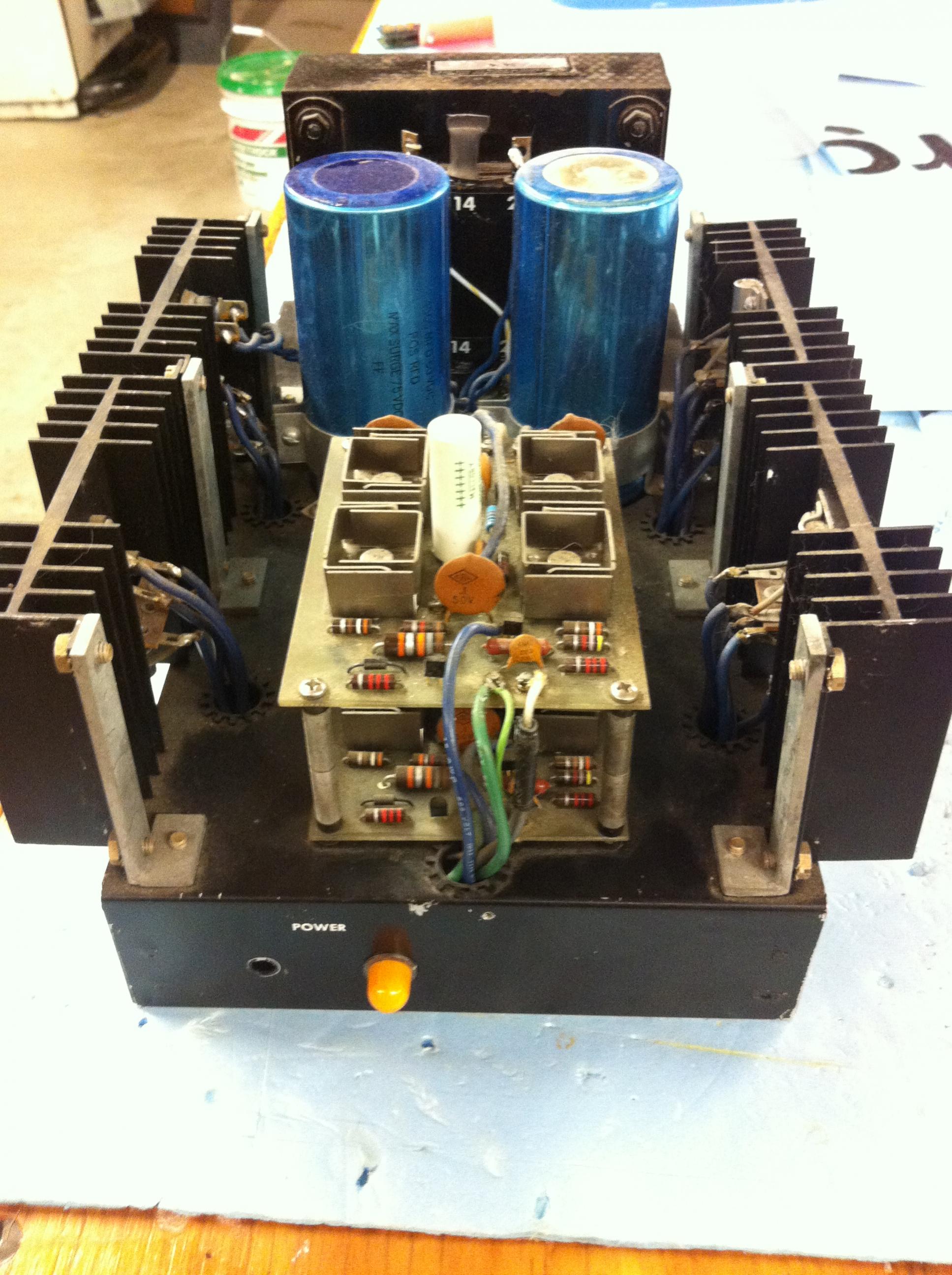

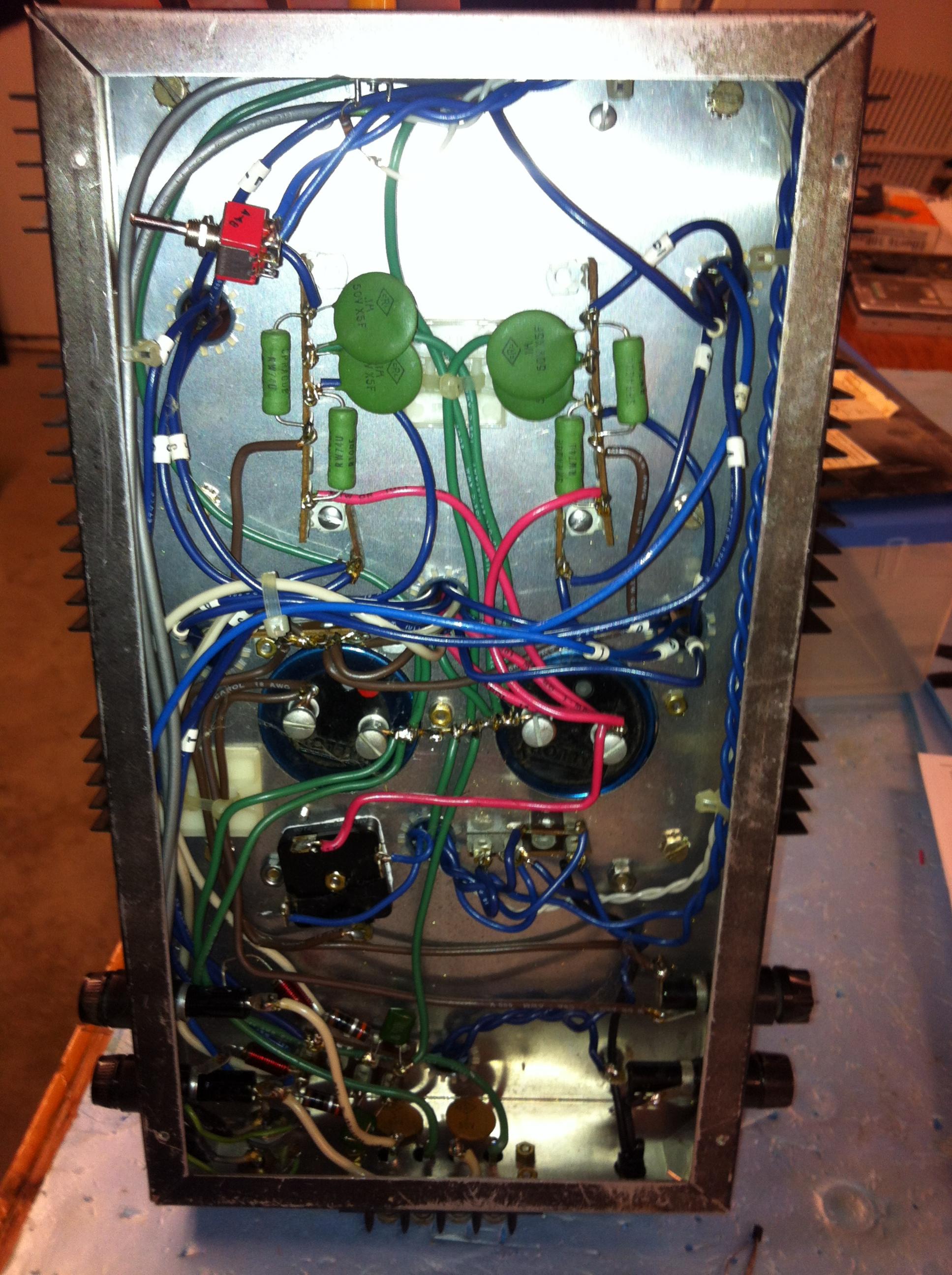

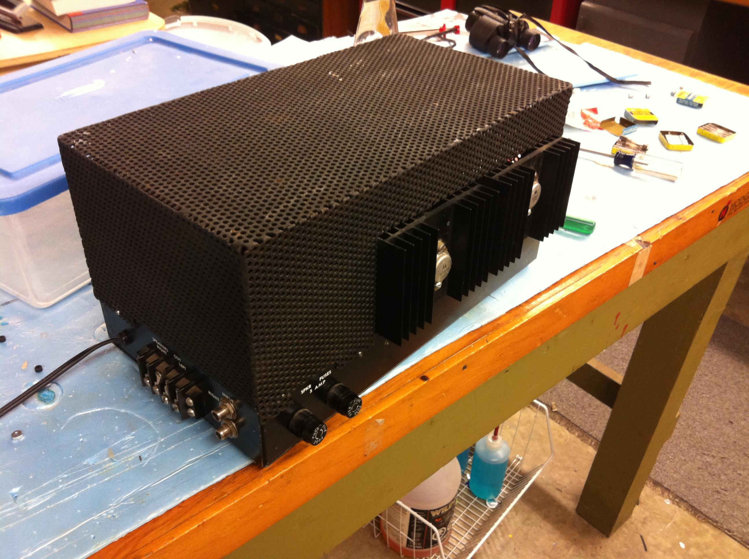

Just a few photos of mine. My father bought most of the parts for this back in '71 after the article came out. Still have the original magazine. He didn't build it until around 1986-87. Metal shop at General Motors made the case and cover. Had to replace the switch today so I took some pics of it. Just happened to google the amp and found this page...

What is *funny* is that it is still working - with the long runs to the output devices and all...
Maybe the self inductance of the longer wire and the added shunt capacitance is actually a benefit in keeping it stable?? That's contrary to all the advice I've seen given on that amps construction.
You never know.
_-_-bear
PS. nice sized xfrmr from Signal Transformer company! 😀

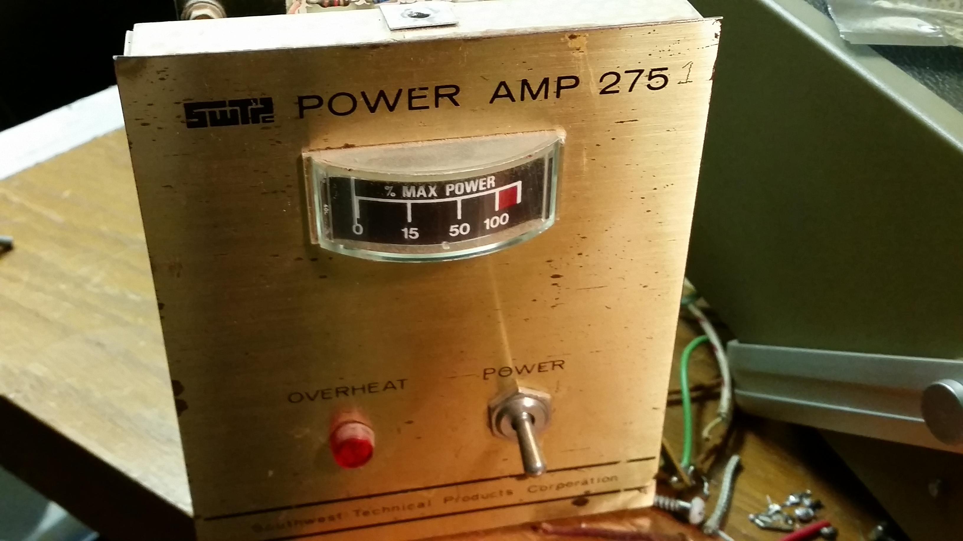

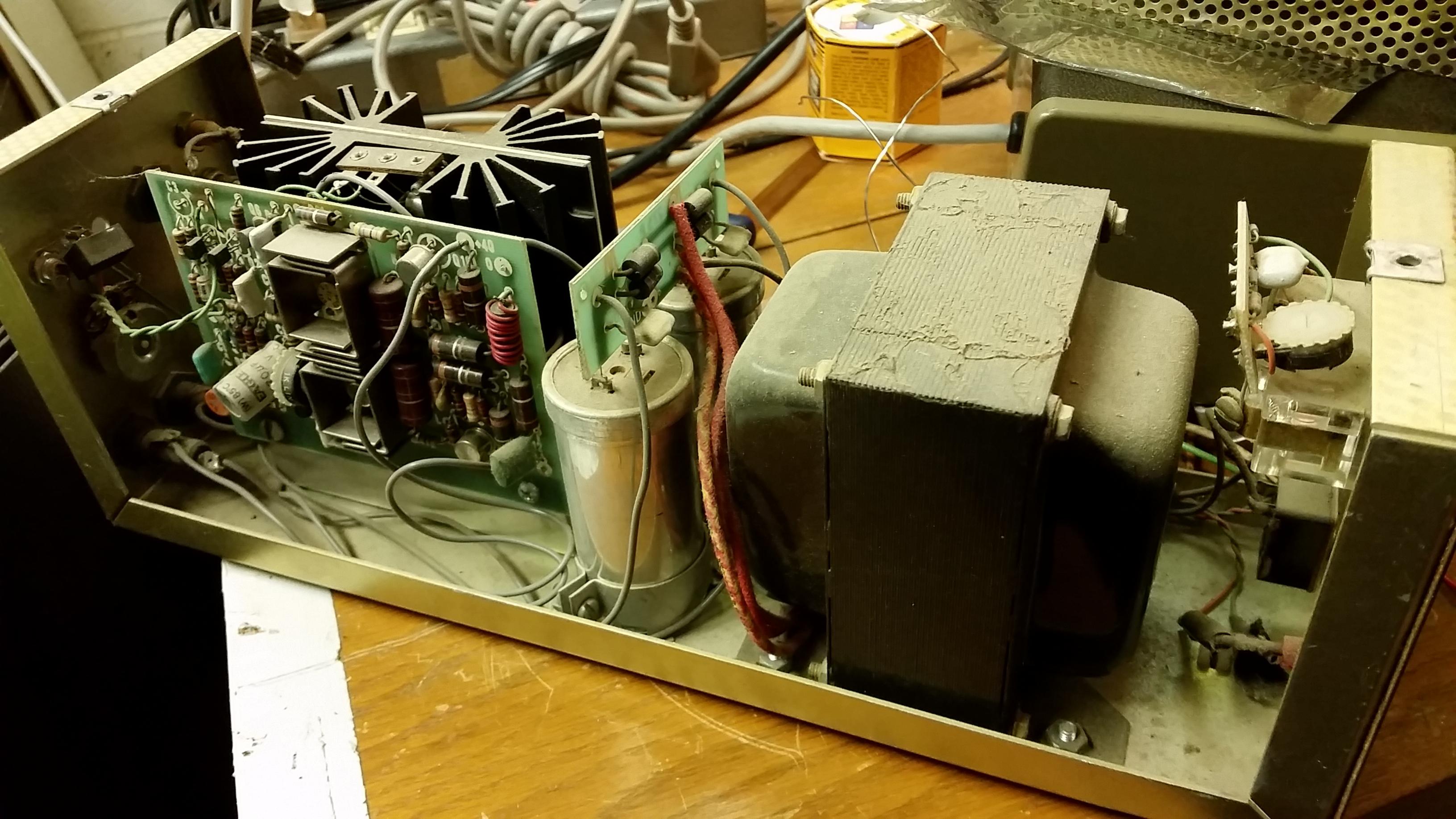

Here is a pic of one of mine. I have two. Picked them up around 1978. They survived college frat use (abuse?) and now have retired. I know one needs new PS caps. Probably both need a cap job.
I enjoy seeing these old amps but have moved on to other gear.
