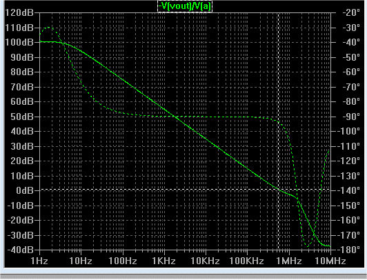

I think the original design should have had these miller compensation caps, with CFP output stage it's very easy to induce oscillations as I myself have found out in designing my own CFP output with a LME49810 input stage. If you have a look at Rod Elliots P3A , you will find some answers there also. Douglas Self's load invariant amp also follows a similar topology.An additional pair of output device might have helped, with a single pair they were exploring the limits of SOA of the devices.
I thought those miller caps would be a good idea too, but they destroyed the sound of the amplifier. I never bothered to find out exactly what the problem was- it wasn't simple response or some instability, maybe THD or a new spectral distribution of such, but it only took about 30 seconds of listening to say, "OMG, that was sure a mistake!"
What I was referring to above were strays. Unless you put in lead resistances and inductances, and probably even small capacitances to the chassis, the simulation doesn't reflect the real circuit. It certainly shows you where the weaknesses are, but I found that seemingly minor construction differences, where HF bypassing and the Zobel network were connected for example, made the difference between decent stability and constant oscillation. The value of the Zobel is also critical. The Tiger seems way more sensitive than other amps I've built, yet with the right construction it's reliable and doesn't oscillate. I assume it comes down to phase margin- make some unfortunate decisions in the physical construction and all bets are off. I built a very pretty one in a small rack chassis and it was junk. Nothing I did would cure the slight oscillation on musical peaks. I rebuilt it with the exact same components in a different physical configuration and it was stable as a stone.
Conrad, I am aware of the issues involving strays. I did SPICE sims of high speed digitial designs including package and trace transmission line effects many years ago on the job.
The simulation is showing global loop oscillations around 10 MHz under certain conditions and it seems that the lead cap is too large, have to take a closer look at the gain and phase margin. I did look at the stability far back in this thread, however I don't think that I had good device models at that time. I don't think the original Universal Tiger was ever "stable as a stone". The MKII version decreases the lead cap from 220 to 100 pF which is a step in the right direction.
Have you even run the SPICE model that I posted?

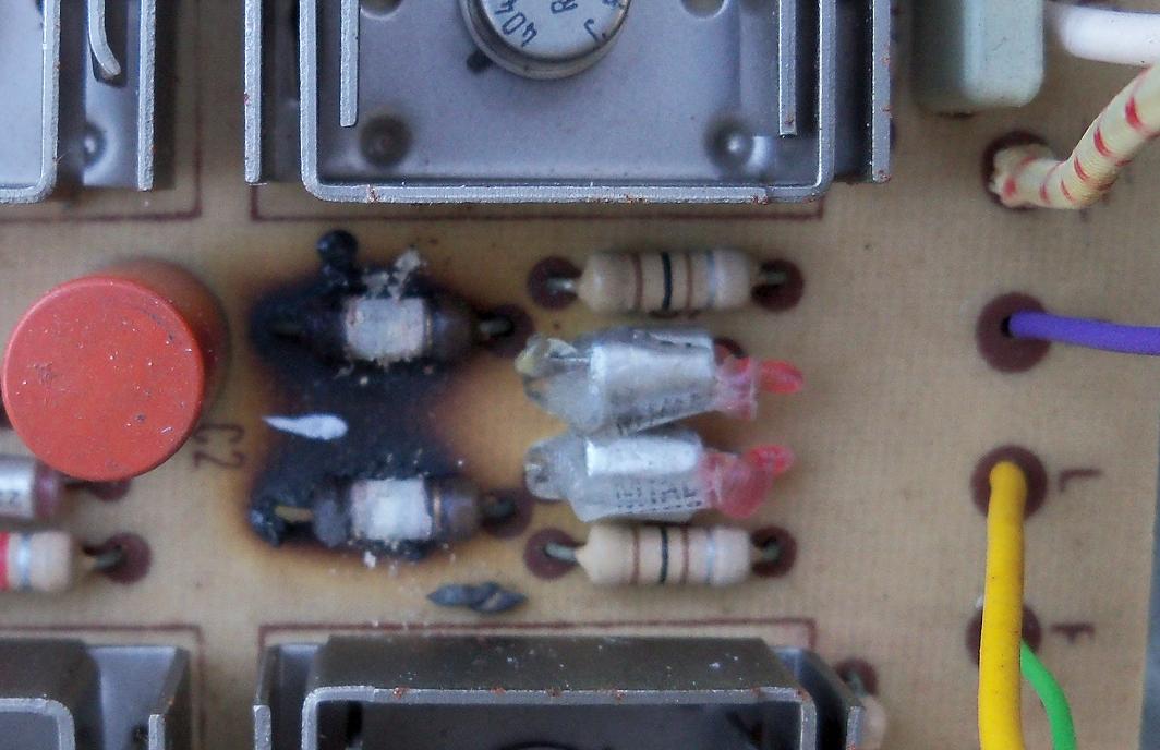

I've mentioned before that the 1000 pF polystyrene caps in the feedback path usually melt when a tiger blows up but I could not remember if they were very close to the resistors that also go up in smoke. Here is a picture of the circuit board in one of the amps that I purchased on ebay where it can be seen that the completely burnt resistors are not along side of the caps, no doubt the amp has stability issues:
People forget that capacitors have to be de-rated for high frequency use.
I doubt that that cap can handle 10V above 10Khz (where it really needs to).
The Zobel cap is usually around 0.1µF in most designs. I always check this network after repair, I couldn't tell you how many times I have found this cap open.

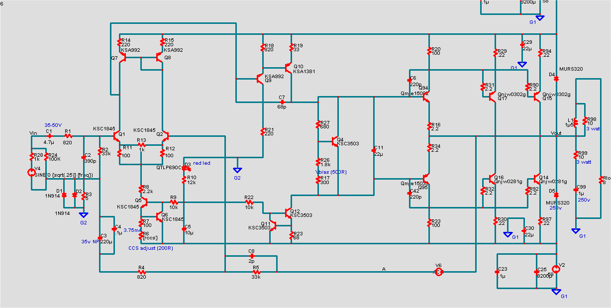

Pete, I've always built them using silver-micas for those 1000 pF caps. It's hard to hurt a silver mica. FWIW, I did run the sim, but I'm more of a practical probe-in-hand kinda guy. It bothers me that none of the models are really the original devices and I don't know if they're close or not. They can't be too far off since the sim looks a lot like the real amp at audio frequencies, but is the sim valid at 10 MHz where it wants to oscillate? I do have a supply of all the original parts and can do about every measurement under the sun, from DC to daylight, but I don't know beans about how to convert those measurements to a good model.
I did something very similar to the UT back in the 90s. Rails were +/- 55Vc. Rated output was 200W/4 ohms. After ironing out the bugs, it was stable. Actually, I quite like the sound over the conventional EF outputs.
Information at: Schematic and Parts List
Feel free to use the component values. The amp could do with more modern transistors today. They were all I had then. I agree with Nelson, it would be better for the input differential to have some degeneration.
"relaxed" 🙂 I like MTBF (stable). No burning amps. Before I moved on to triples , I tried the Szikai and had a complete workable amp that I cooked my load resistor with and did extended listening to (below 1). All modern fairchild/ON semi's and "blameless" level THD (powered by my "AX" voltage stage). C6 and especially 42 were essential to keep my zobel network from becoming slag 😀 This OP stage also required me to increase IPS degeneration to keep the same phase margin (simulated - below 2). It did , however , work as simulated (for 2 weeks in the barn).
in my experience polystyrene caps are no good choice for use in vas and feedback............
they are heat - sensitive (melt down easily) and often they do not withstand more than 30vac.........
once i built a 50w amp with a 22pf polystyrene in the vas - the cap was destroyed and the amp failed.so i changed it to the 22pf ceramic -as shown in the original schematic- and everything worked fine.
polystyrene caps are no good choice for use in vas and feedback. heat - sensitive and often they do not withstand more than 30vac.
With a capacitor that resembles a hair follicle, big surprise.
Thermal inertia equals thermal property times volumetric capacity, what to expect from a cap with lead diameters the size of a medulla that pops out of a follicle.
Polystyrene caps with regular lead sizes, that withstand higher than 30Vac, are pretty bulky, more than a high quality MP or silver-mica cap.
(tubular polystyrenes with spider-web leads are pure bunkum. not smaller, cheaper, or better than NPo's)
