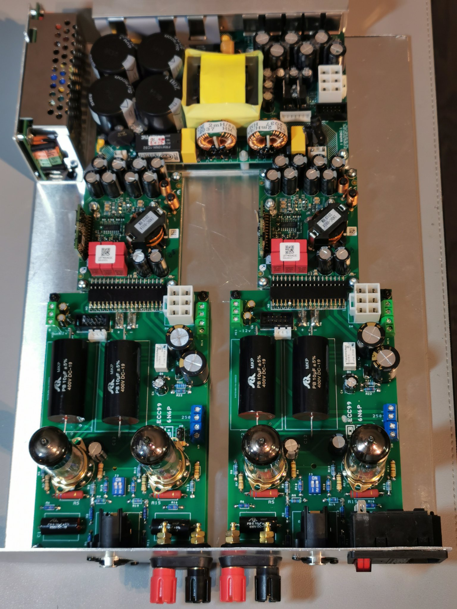

This is exactly what makes the Purifi so great for my use cases and why they're my favourite amps at the moment. I need 150w+ for my speakers and I won't be building a 1000V+ Set AMP that weighs 100kg and could be used to heat the town. Although I do own a PSE 6c33c that does put out 45w and sounds great, but too dangerous with kids. Much cheaper and efficient to use a Purifi as buffer, driven by a multitude of pre-amp that are often far less expensive than an amplifier build. One day you can listen to a massive sounding DHT amp (300b,10y etc tube pre), next day an IDHT, then a simple single ended class A design with again big power and even throw in a discrete class A pre. Choose whatever suits your music taste.
I much prefer my tube pre-amp in front of the purifi amp's than without, but that's what suits my room/music tastes etc

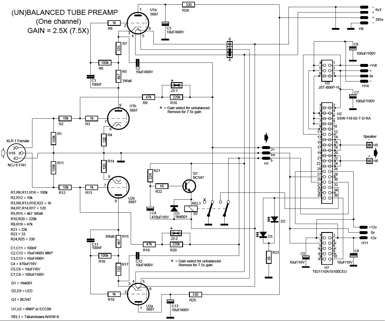

You do need a separate power supply for the tube stage. For a lot of people this is very important so they can choose between linear or smps supply.
No, it has other pinout and different specs. But it is possible to design a mu follower with the 5687.

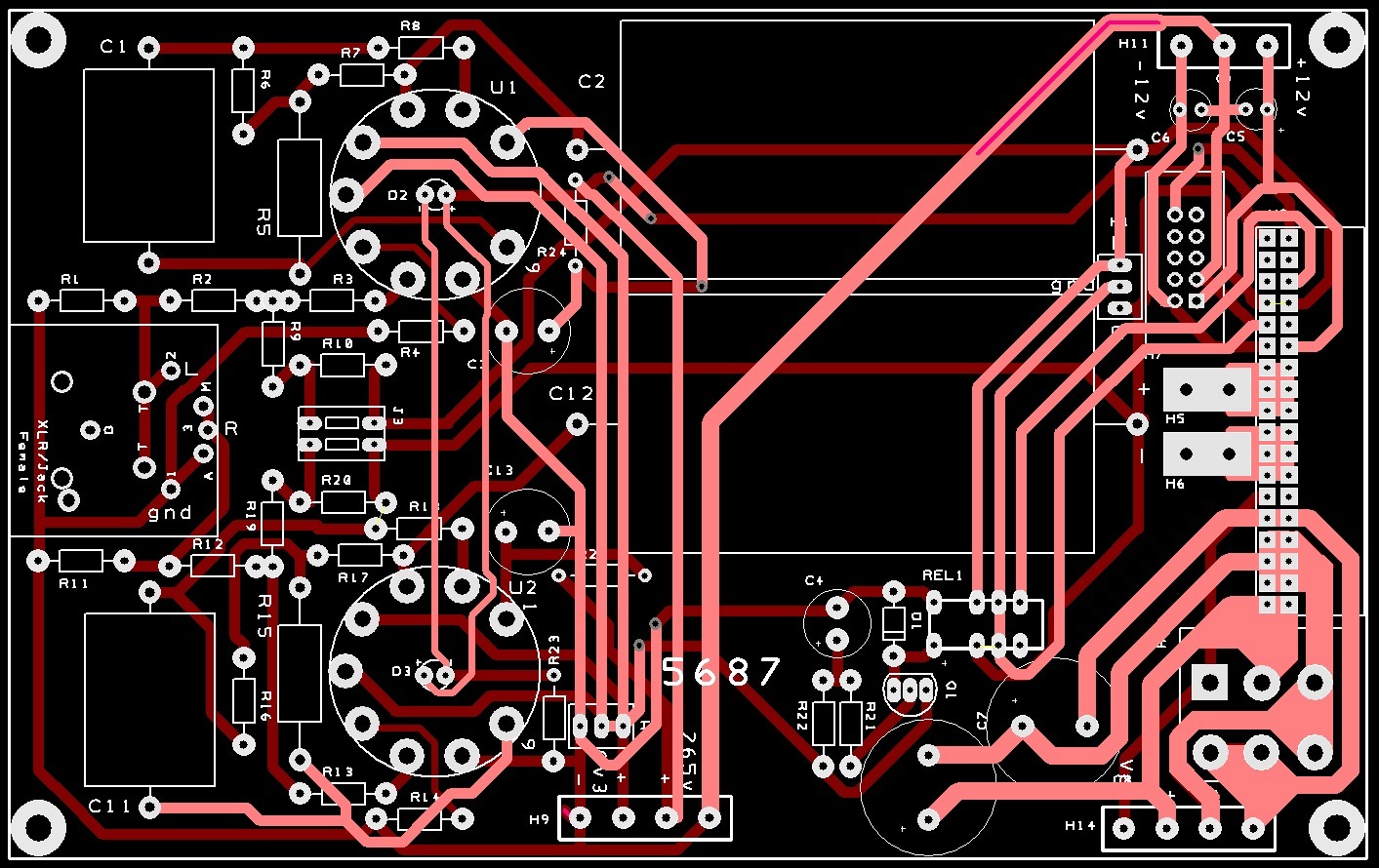

may i ask whats the size of the pcb? thanksYou do need a separate power supply for the tube stage. For a lot of people this is very important so they can choose between linear or smps supply.
Here the PCB, gerber files and schematic for the 5687 tube.
6 Resistors have a other value to meet the 5687 spec.
R4,R7,R14,R17 changed from 150 to 120 and R5,R15 changed from 5k6 to 4k7 3Watt.

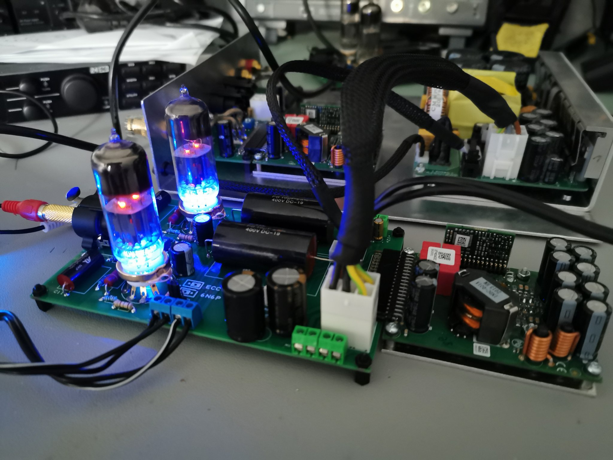

Koifarm,
I see from your PIC that you are getting close to being able to start your subjective listening tests.
Is there are reason beyond offering options that you offered up a version that uses 5687 tubes?
Incidentally I am still looking for a good source to buy a few JST B06P-VL PCB connectors. Everybody that I have contacted here in the states has zero inventory
