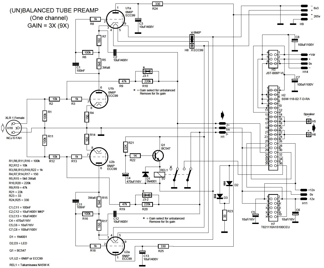

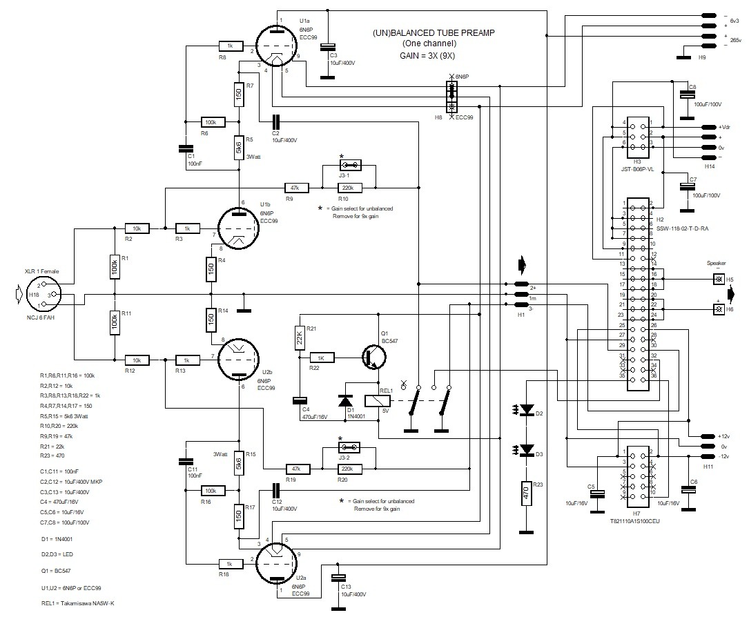

Universal PCB for Purifi 1ET400A amps

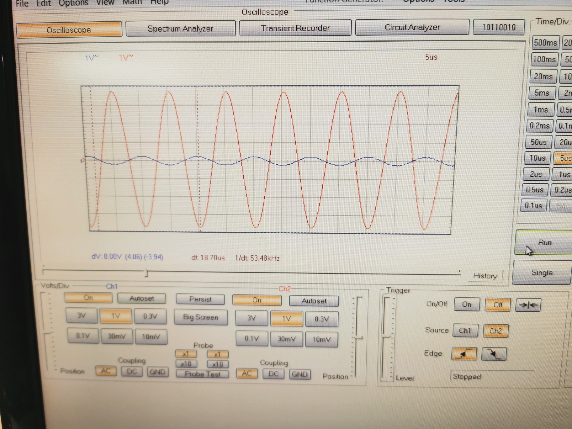

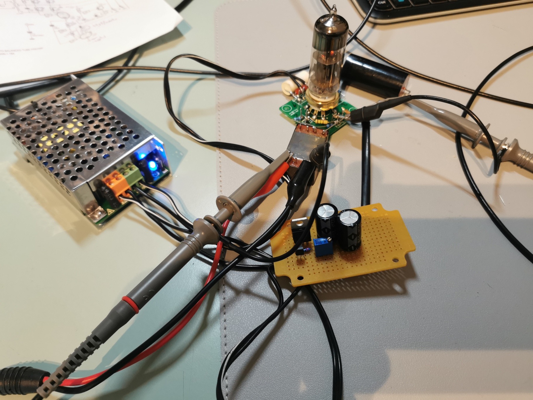

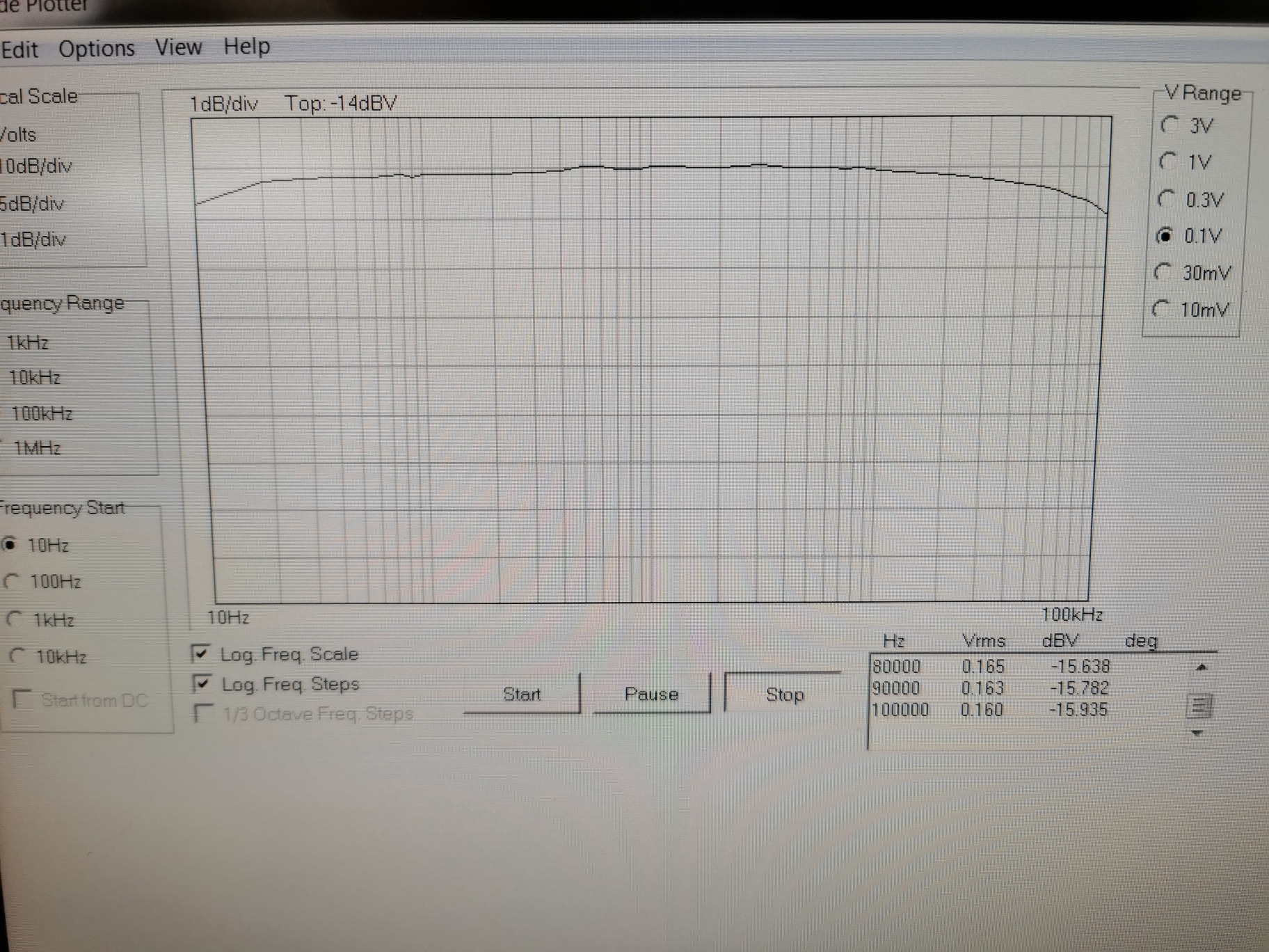

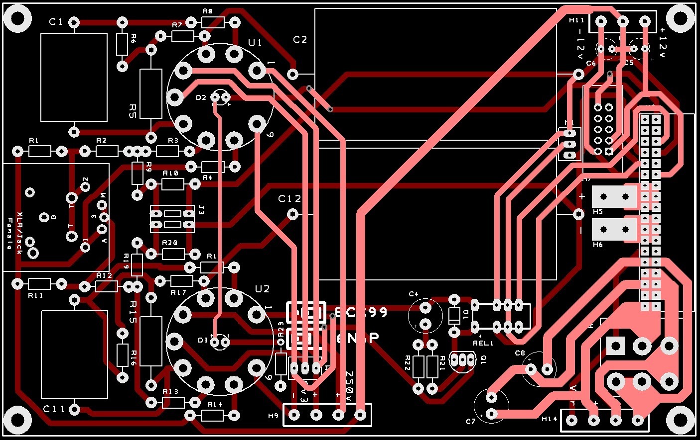

Today, did some testing with the 6n6p mu-follower in to a 2k2 load(as et400a). It had a frequency response from 10hz to 100khz within +/- 0,5db. Gain 16x.
Because of the high gain i will apply some feedback to get 3x gain for balanced and 10x gain for unbalanced operation.
Further do not use the lundahl transformeer because of high cost. I use neutrik XLR/6.3 jack input chassis part.
Schematic and PCB design will follow soon.

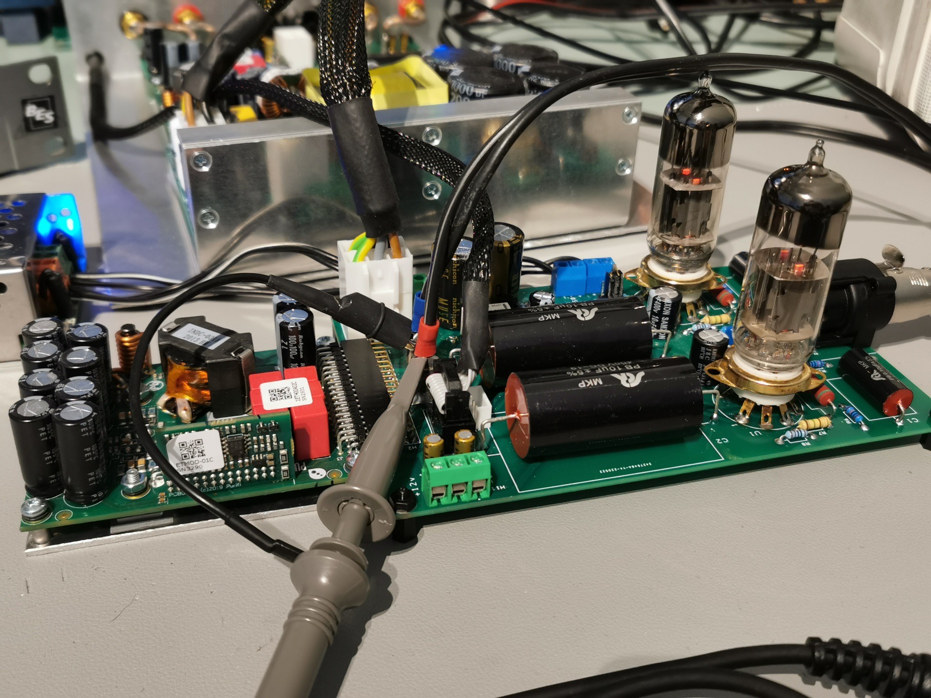

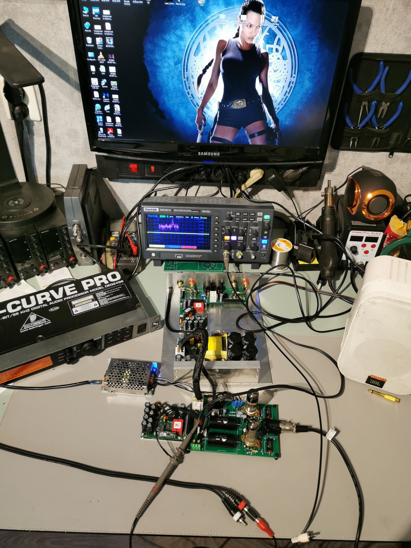

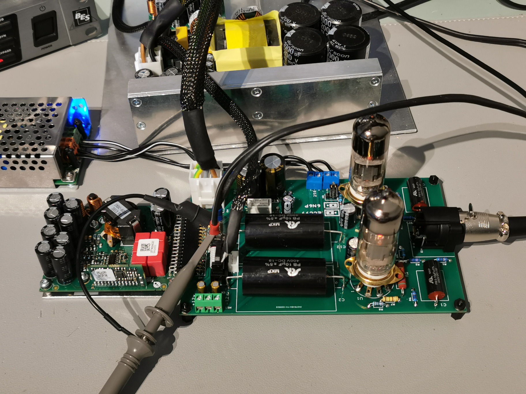

Last week received the PCB and tested it today. Best result until yet with a tubebuffer. No noise or hum. 0.0043% THD.
Next i shall build second channel and do some listening. And compare with no buffer version.
I make some optimalitions to the PCB. Publish also schematic and gerber files as build.
I am using 6n6p with 260V anode supply.. I =2 x 13,2mA. Ecc99 with same 260V runs at I = 2 x 12,5mA. ECC99 has a all over smooth sound. 6n6p is more clear with a little more punch.

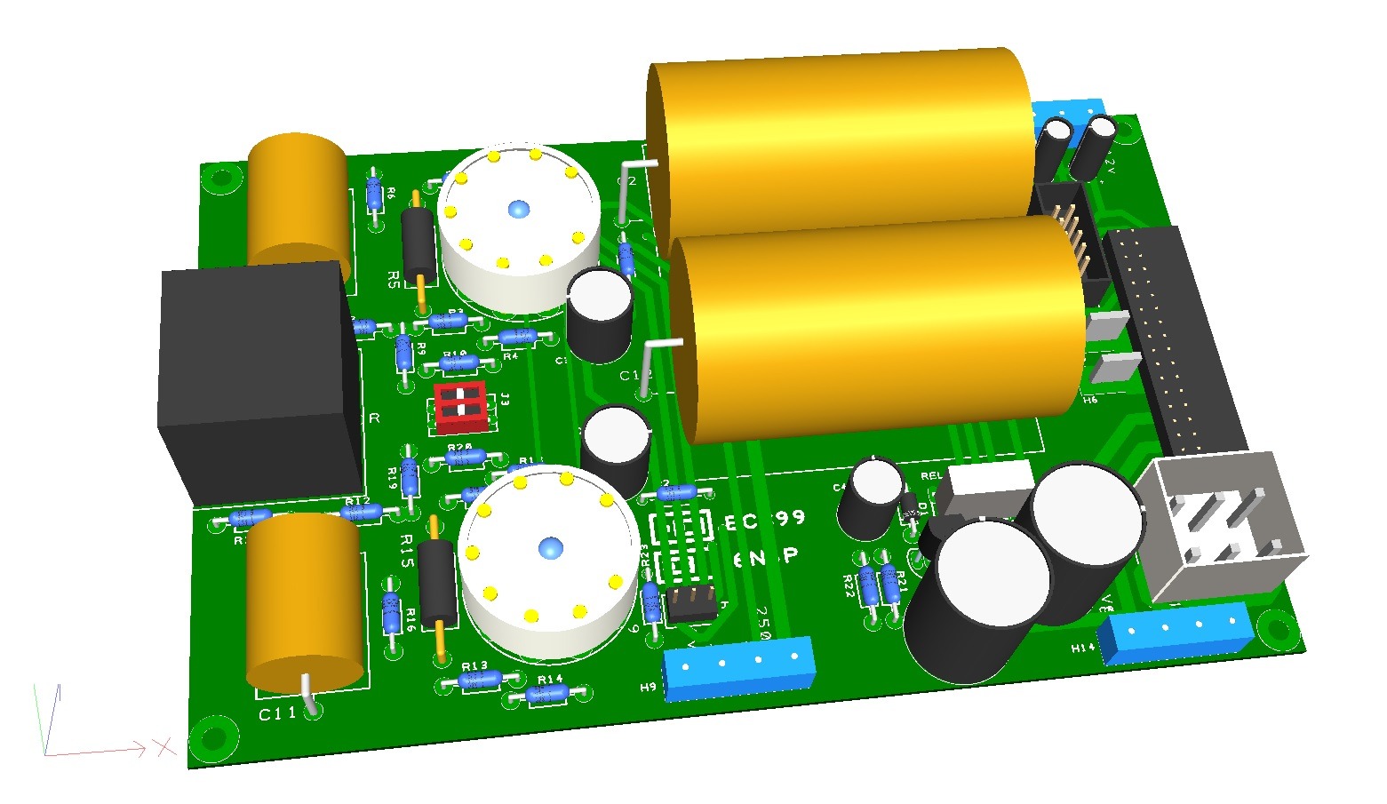

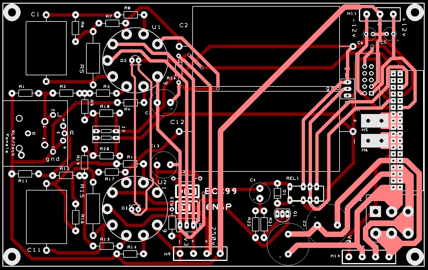

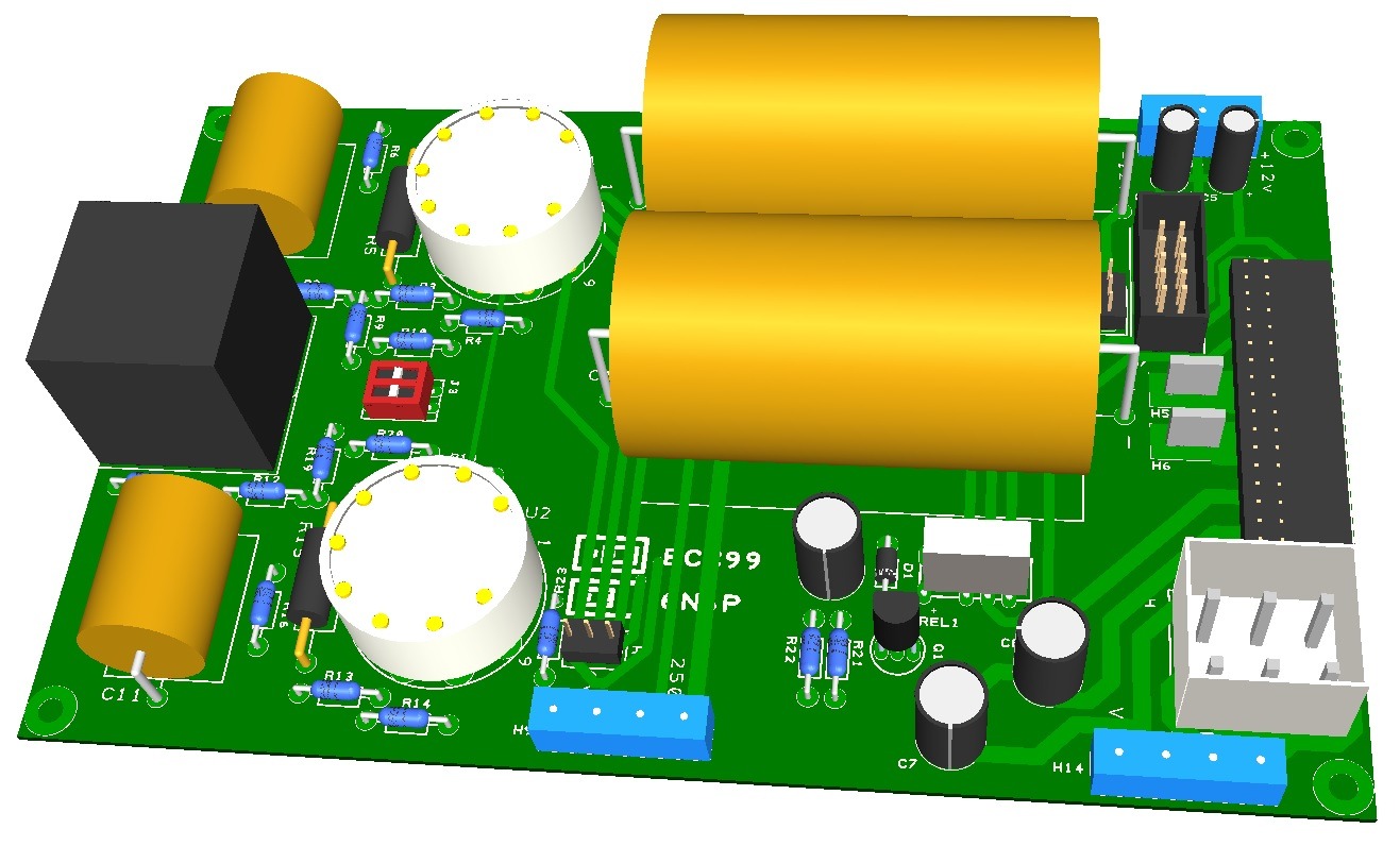

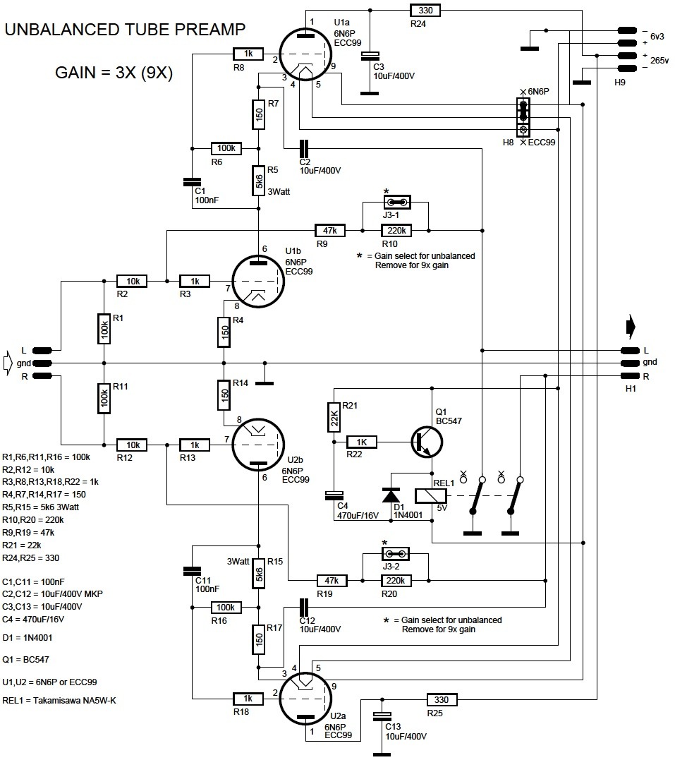

PCB has universal connectors also for standanlone preamp. 1 PCB for L+R unbalanced preamp or 2 PCB for balanced preamp.
Below schematic and gerber files as-build.
Features:
  • For Purifi 1ET400A or Hypex NC500 or universal use.
  • Balanced 6n6p/Ecc99 tube preamp.
  • Ecc99 or 6n6p heater supply jumper selectable.
  • Gain 3x or 9x jumper selectable.
  • Unbalanced input possible with RCA/Jack adapter.
  • Connectors for Hypex SMPS1200A400 supply.
  • Connectors for universal supply.
  • Amp ON detection with LED in tube socket.
  • Tube preamp ON delay.
  • Low THD = 0,0043%(just 2nd harmonic).
Tube preamps need 265V/54mA and 6V3/3A2 power supply(2 boards).
I used 265V/6.3V SMPS from aliexpress.
Total cost for 2 channels(boards) is about € 150,- inclusive PCB's, Power supply and all parts.

Well that was quick! Thank you for this I will be studying what you have posted.
Have you had a chance to do some serious listening? I am curious as to your impressions
I still have to build the second channel. Listen experience is very personal and subjective. Freq. curve is straight, distortion is low. No hum and no noise. There is a little more wider(spatial) soundstage. I already have and used the same tubebuffer together with the 1et400a. I am building the tube preamp for a friend. So we have two amps with 1et400a. One with no preamp and one with tube preamp.
